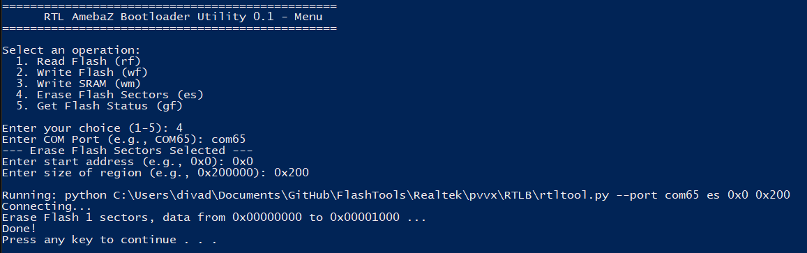

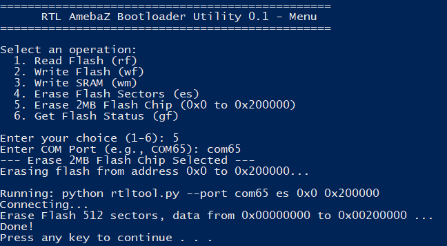

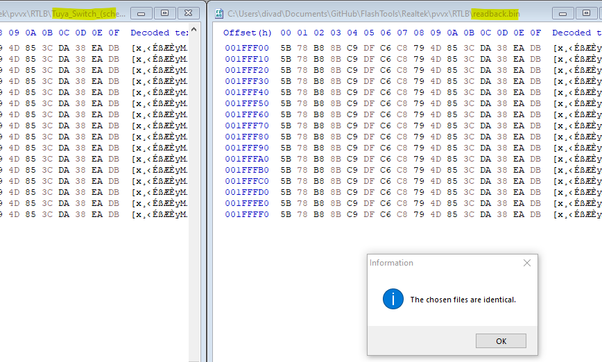

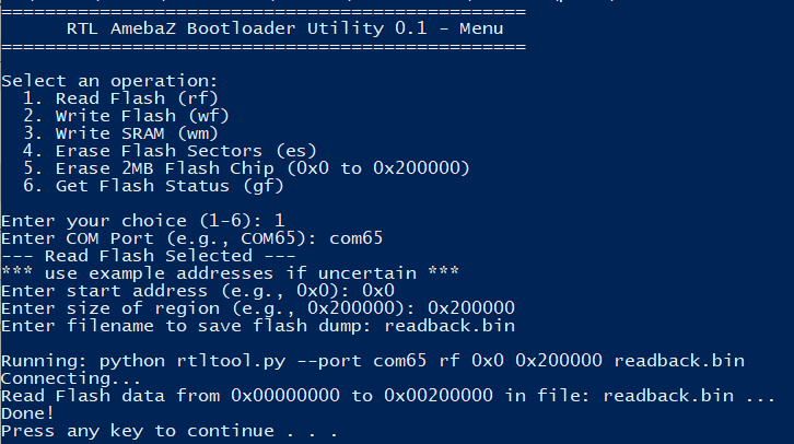

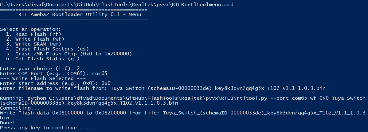

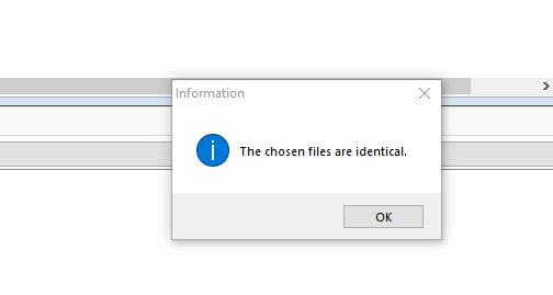

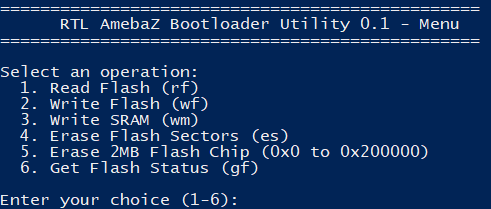

    is this any good?
    For AmebaZ.
    pvvx's rtltool but updated for Python3. Added a simple cmd run menu for most functions
    Menu of the Realtek AmebaZ Bootloader Utility version 0.1.
    I've tested reading, writing, erasing sectors, erasing whole chip. I've written Tuya RTLB fw backup using it and it boots and pairs with Tuya. I've dumped backups after flashing and compared files - identical. I've erased whole flash then dumped flash and file is FF as expected.
    The user gets to customise filenames to flash and dump to and the start and length addresses
    Screenshot of RTL AmebaZ Bootloader Utility showing a menu of operations.Screenshot of RTL AmebaZ Bootloader Utility tool with flash options menu.
    RTL AmebaZ bootloader tool screen with menu options. RTL AmebaZ Bootloader Utility 0.1 menu for flash memory management.
    Comparison of two binary files in a program window with a message about file identity
    https://github.com/divadiow/FlashTools/tree/main/Realtek/AmebaZ_FlashTool

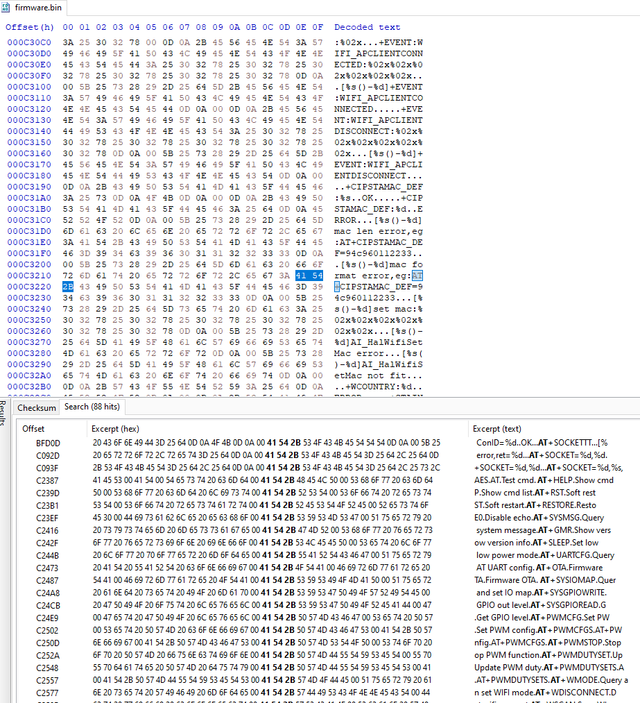

    Added after 8 [hours] 16 [minutes]:
    I've been fiddling.
    if you add printf to def WaitResp you get this as the response from DN
    that hex response converts to #Flash D
    Code: Python
    the original script is expecting 31 (CMD_RWA) (?)
    so with this as the def WaitResp
    Code: Python
    and then python .\rtltool.py --port COM49 -b 921600 rf 0x0 0x200000 firmware.bin
    starts to do something
    and the resultant file looks to be a full dump
    Fragment of a binary file displayed in a hex editor.
    • rtl8720dn_nicemcu_at_maybe.bin (2 MB) You must be logged in to download this attachment.

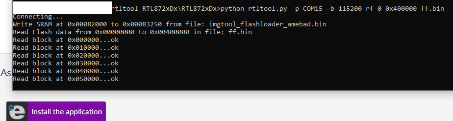

    I got a backup from bw16 without problems
    python rtltool.py -p COM7 -b1500000 rf 0x0 0x400000 bw16_rtltool.bin
    Connecting...
    Set baudrate 1500000
    Write SRAM at 0x00082000 to 0x00083250 from file: imgtool_flashloader_amebad.bin
    Read Flash data from 0x00000000 to 0x00400000 in file: bw16_rtltool.bin
    Read block at 0x000000...ok

    whaat. hmm OK.
    would you mind adding the printf bit? what response does your BW16 give?

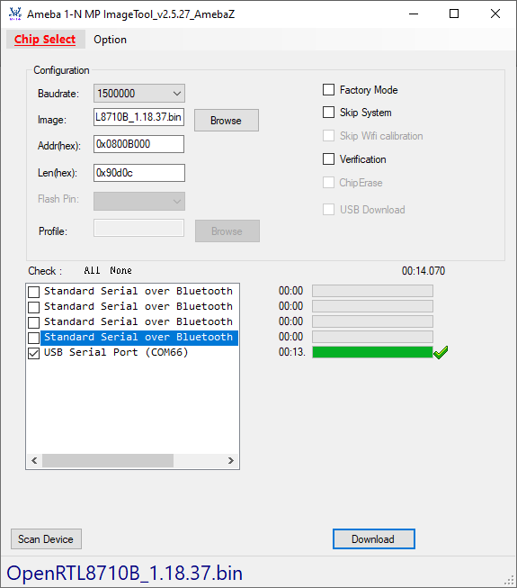

  • #200 21432608
    Posts: 5027
    Help: 438
    Rate: 891
    >>21432548

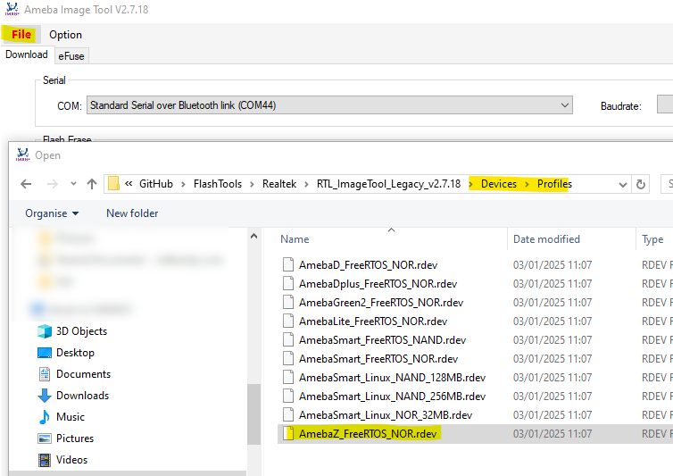

    give this tool a go: https://github.com/openshwprojects/FlashTools...tek/Ameba_MP_ImageTool_1_N_v2.5.27_AmebaZ.zip
    ref: https://www.elektroda.com/rtvforum/topic4093142-60.html#21361242
    flash the UART file to 0x0800B000 address first. You may have to flash back factory backup from 0x8000000 then the above if ltchiptool has written to some random place.
    I think this is the case, I can't check right now.
    also see this: https://www.elektroda.com/rtvforum/topic4093142-90.html#21377607
  • #201 21432622
    insmod
    Posts: 1388
    Help: 164
    Rate: 432
    There should also be a OpenRTL8710B_boot.bin file, to flash it at 0x08000000 , but it seems that workflows are not picking it up. This file should include partitions, so if a device has partitions that are different from OBK bin ones (or tuya ones), then it should either not work, or fail at/after ota.
    • OpenRTL8710B_boot.bin (4.56 KB) You must be logged in to download this attachment.
  • #202 21432631
    erdeidominik1999
    Posts: 47
    Thank you, I will test it tomorrow.

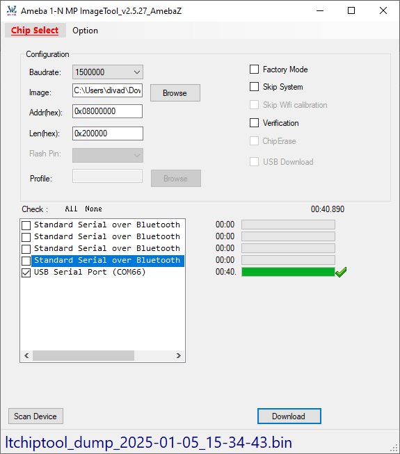

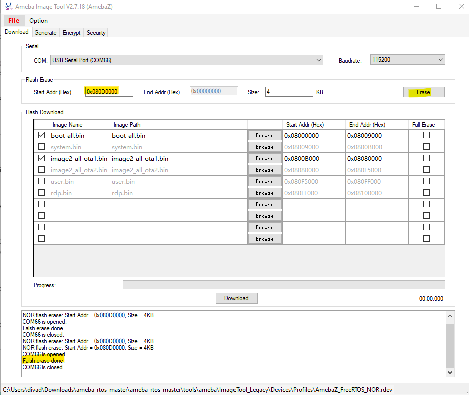

    #203 21433931
    Posts: 5027
    Help: 438
    Rate: 891
    thanks for device firmware backup @erdeidominik1999. I thought I'd switch to the public thread so there's record of what may need doing to get this working in some cases.
    Here are my steps to get it to OpenRTL:
    flashed your full backup to 0x08000000 (my test device - so I can simulate your situation)
    Screenshot of Ameba 1-N MP ImageTool v2.5.27 software showing device flashing configuration settings.
    Flash OpenRTL release to 0x0800B000
    Screenshot of Ameba 1-N MP ImageTool v2.5.27 with flash configuration.
    Erased 4k at 0x080D0000
    Screenshot of the Ameba Image Tool V2.7.18 showing flash options.
    then OBK boots and AP broadcasts. The second tool is not yet in the FlashTools repo, but is here now: https://github.com/divadiow/FlashTools/blob/main/Realtek/RTL_ImageTool_Legacy_v2.7.18.zip
    choose this profile file on initial run
    Screenshot of Ameba Image Tool V2.7.18 with a device profiles folder open.

    I've gotten BW16 NiceMCU RTL8720DN module and I see it was already discussed here, what's the current state of that? How can I read it's 2MB original flash?
  • #205 21437823
    Posts: 5027
    Help: 438
    Rate: 891
    it's be good to know what your experience with the attached is.
    • rtltool_RTL872xDx.zip (8.57 KB) You must be logged in to download this attachment.
  • #207 21437842
    Posts: 14580
    Help: 654
    Rate: 12604
    I only get this:
    python rtltool.py -p COM15 -b 1500000 rf 0 0x800000 ff.bin
    Connecting...
    Error Set Baud!
    python rtltool.py -p COM15 -b 115200 rf 0 0x800000 ff.bin
    Connecting...
    Error read data head id!
    Error Read!
    Added after 3 [minutes]:
    I added more delay here:
    Code: Python
    I get now:
    Screenshot showing the results of the python rtltool.py command successfully reading data from flash memory.
  • #208 21437847
    Posts: 5027
    Help: 438
    Rate: 891
    that explains why I was getting characters in response (as seen in previous posts) before the expected response needed to continue read
    Added after 40 [seconds]:
    so we just need flasher/reader script for Z2 now
