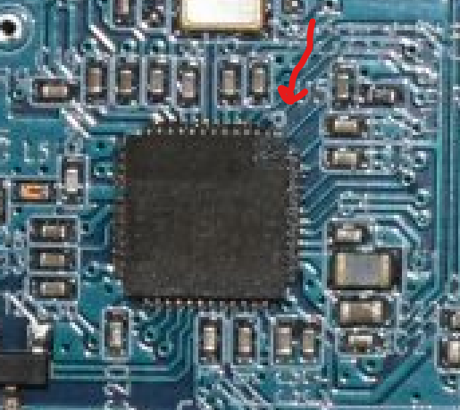

    groove6j wrote:
    I don't know which is pin1, because the top of the chip is scraped.
    pin1 marker?
    Close-up of a blue PCB with an integrated circuit and a red arrow pointing to one pin.

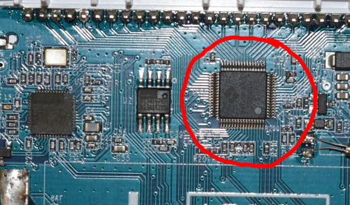

    also was it ever stated what this is marked as? I recognise the faint logo
    Photo of a circuit board with a large square integrated circuit marked in red.
    Added after 7 [minutes]:
    ah. Maybe Cmsemicon like seen here https://www.elektroda.com/rtvforum/topic4041794.html#20999418

    divadiow wrote:
    Maybe Cmsemicon
    That is BAT32G127GH 232101T. Maybe there is some other MCU chip behind LCD, but I am now unsure about that. Most likely no chip there.
    Wrong pins?
    Most likely that UART is not used at all in this variant of the board. TX and RX just stay at 3.3v and there is no voltage from the other side (which probably doesn't go anywhere). It just has these pads there, that's all. I recorded no oscillation at all. There are some other variants of that thermostat that maybe have different board setup where these pads are used.
    try more reliable approach
    That's right, I'll order one and try to figure out that protocol that goes over that SWDIO line. Which from the name of it should be SWD. Is that even possible with OpenRTL?

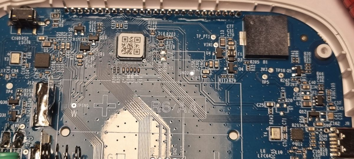

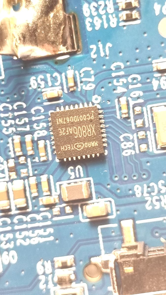

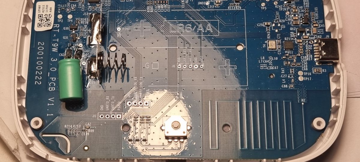

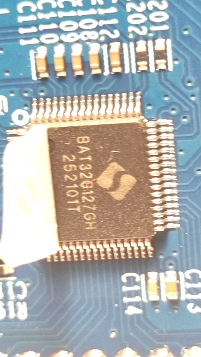

    Macro photo of a blue PCB with an integrated circuit and surrounding SMD components.
    Close-up of BAT32G12 IC on a blue PCB with SMD components
    Device PCB labeled LR6/AA with battery spring contacts inside a white housing
    It's been a while since the last post but you may find this useful. I received the T9W in a newer version. It has small modifications. Regarding the software, the previous ones had the possibility to set the hysteresis every 0.5 degrees and this one every 0.1 .
    Close-up of a blue PCB with SMD components and the marking “R6/AA”.
  • #55 21847883
    Posts: 5027
    Help: 438
    Rate: 891
    >>21847480
    interesting. an XR806 version. Did you capture boot log, dump firmware etc? What are your plans for it?

What changed in the newer XR806-based version of the T9W thermostat, and how might that affect OpenBeken/OpenRTL support compared with the older Realtek-based board?
The newer T9W revision uses an XR806-based board and changed at least one user-facing control step from 0.5 ° to 0.1 ° hysteresis. That matters because the older thread’s confirmed dump, flash, and OpenRTL8720D workflow targeted an AmebaD Realtek design, not XR806 hardware. So the older Realtek procedure does not transfer directly. A new XR806 unit needs fresh boot logs, firmware dumps, and protocol work before anyone can claim equivalent OpenBeken or OpenRTL support. [#21847480]
