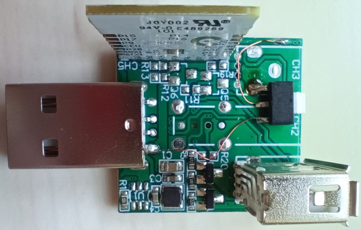

    Maybe a new device here.

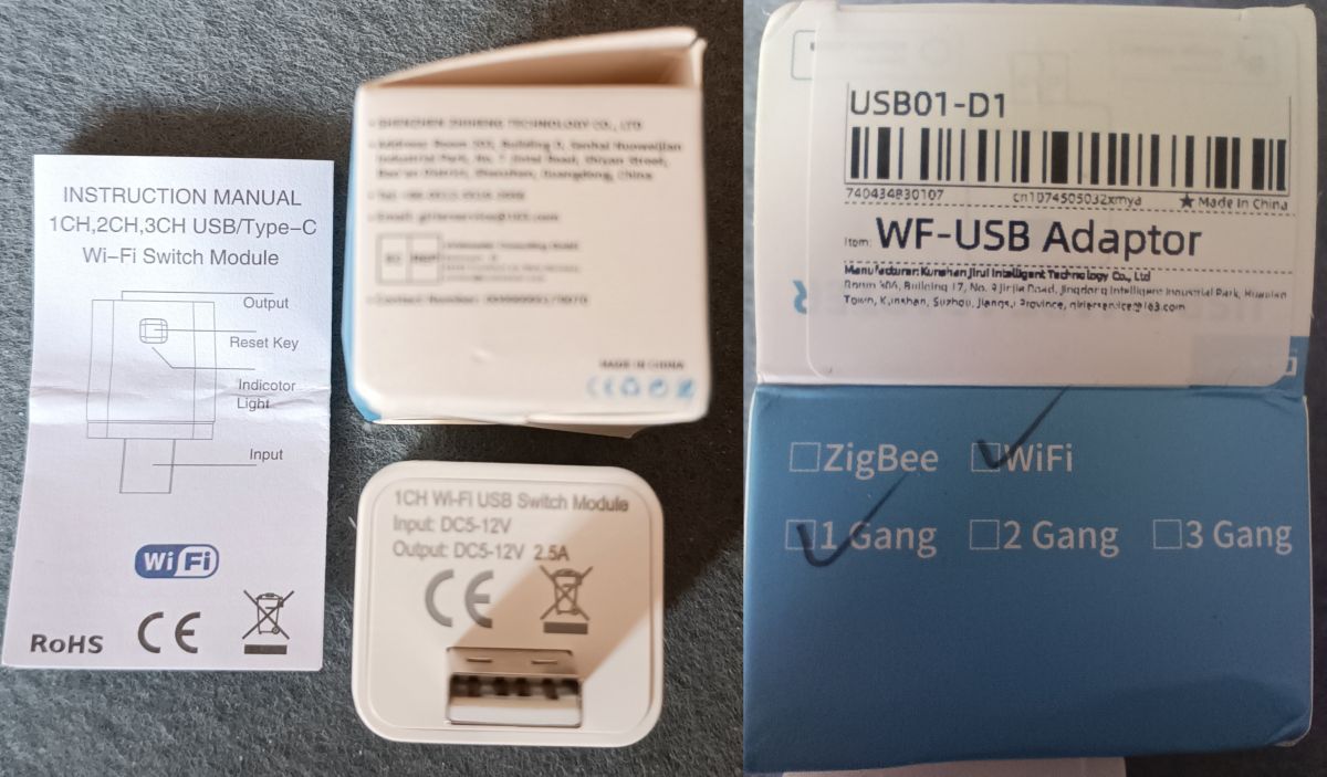

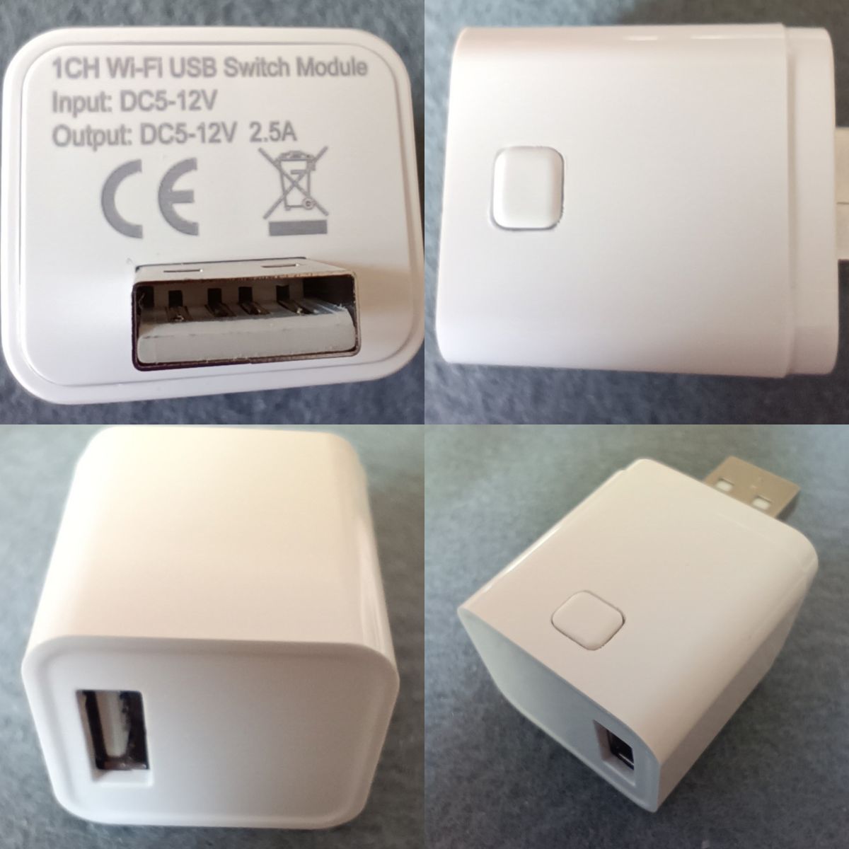

    It's a USB Wi-Fi smart switch.

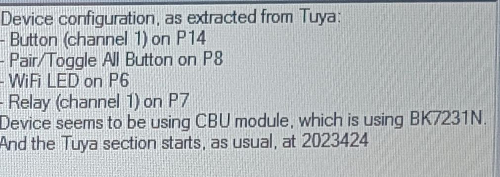

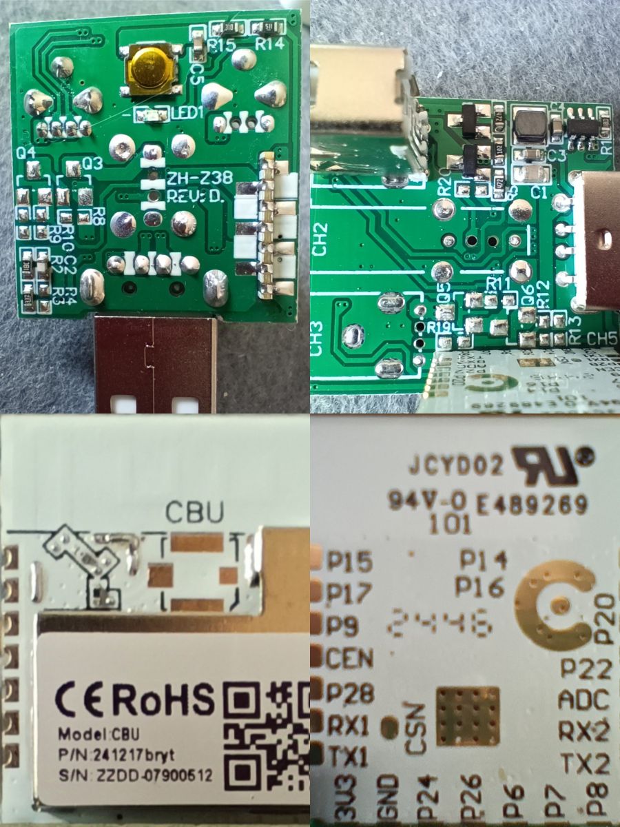

    Unfortunately, I accidentally destroyed the voltage regulator on the board, but the sub-module with the microprocessor and Wi-Fi still worked.
    This way, I was able to salvage the original firmware and the port configuration I had read.
    I was also able to successfully flash new firmware.
    Please see the port configuration in the image.
    The designation on the voltage regulator is WBSAB, which appears to be an internal designation.
    If anyone has any suggestions for an alternative voltage regulator, please let me know.

    "pins": {
    "6": "WifiLED_n;0",
    "7": "Rel;0",
    "8": "Btn;0",

    Thx, but can you attach also a JSON template of the device? It's easier to copy JSON...

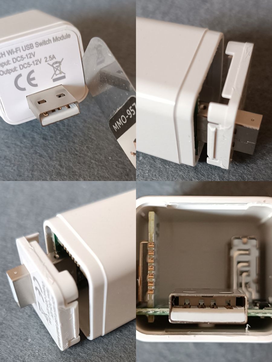

    Love these switches, I found your post looking for info on WBSAB chip. I too have wrecked 2 of my WiFi switches, driving LED panels. I was hoping to find a fuse inside but no luck. How did you power your device to verify the data was still valid? My devices are unresponsive when I plugged them in, no blue or red lights, no devices show up over WiFi. Also I opened mine using a pair of pliers to gently distort the shell so I could get a pick in to separate the cover. I was pleasantly surprised to see it wasn’t glued together,

    150219v8
    Posts: 46
    I noticed something strange about these USB Wi-Fi switches. I successfully re-flashed two of them to OBK, but both were no longer accessible after the flashing. The chip in question was defective in both. I did everything as usual, and I wondered why the voltage IC broke after flashing. Since I couldn't find either this or a replacement, I desoldered it (U1) and replaced the power supply with an AMS 1117.
