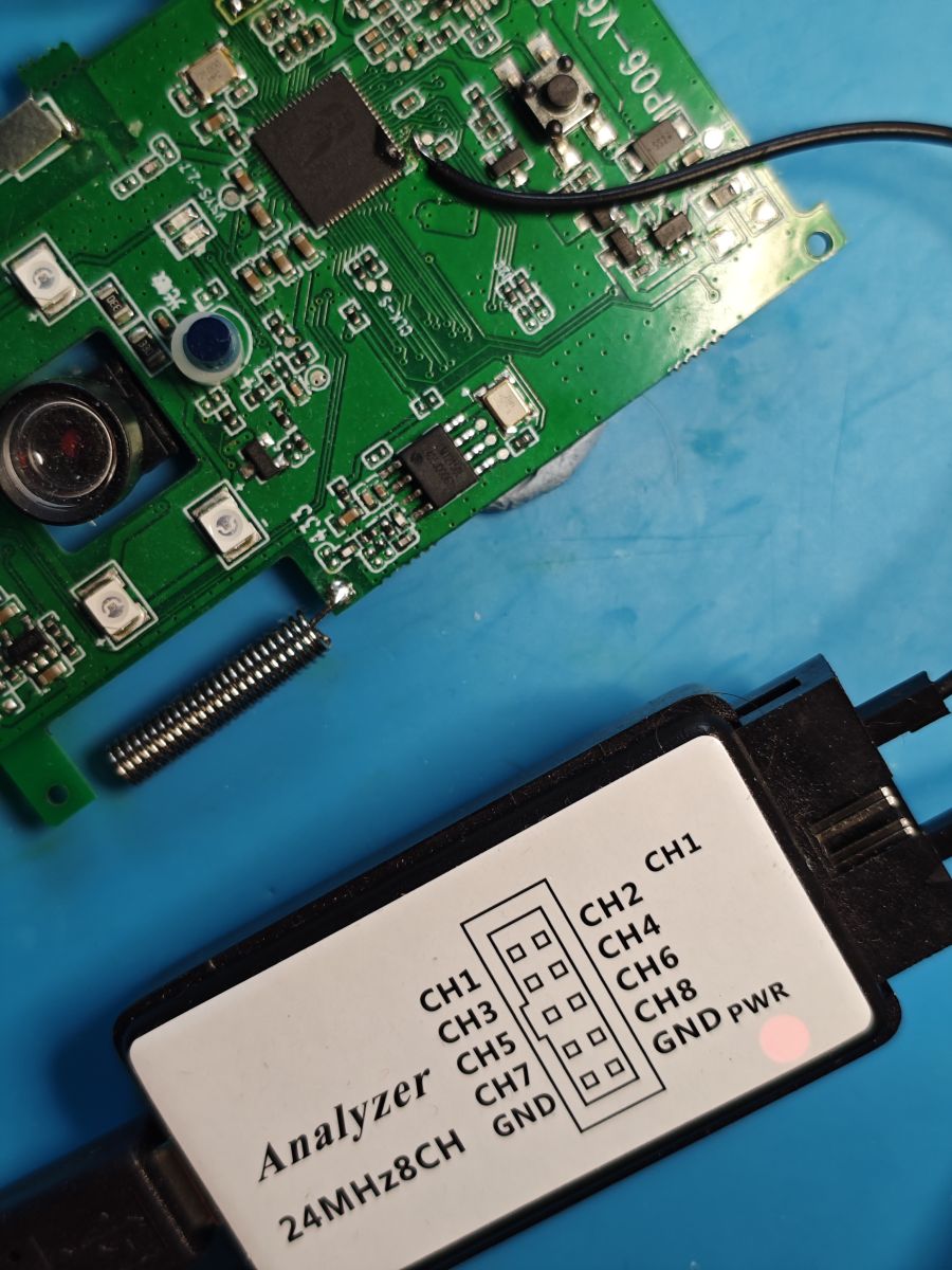

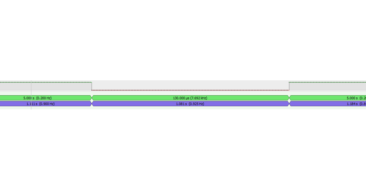

    #66 21613297
    max4elektroda
    Posts: 758
    Help: 49
    Rate: 189

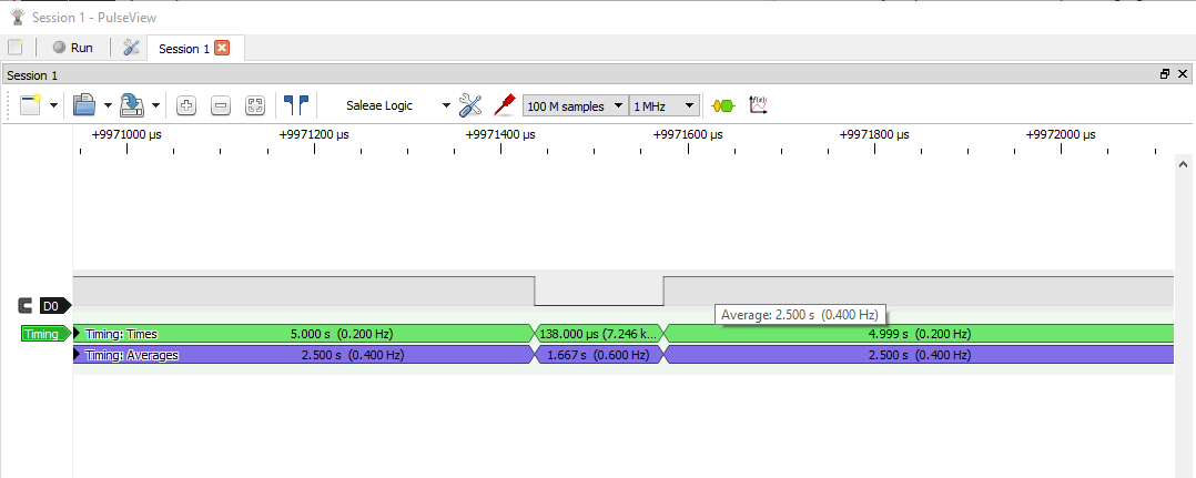

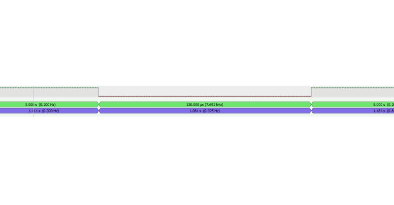

    I opened PR#1727 for the changes to Beken timing for HAL_Delay_us.
    Since I only have BK7231N and BK7238, it needs more testing.
    I'm only aware of two drivers using HAL_Delay_us (DS1820 and DHT) and I tested to work it ok for both platforms (DHT was "only" tested DHT11).
    I'm especially unsure about BK7252 - the new approach didn't compile so I switched back to "old behaviour.
    I'm unsure, because I had to change that "old" code for BK7238, to to get it working.
    I tested delayed output with logic analyzer and it looks good for BK7231N and BK7238.
    BTW should (how?) powersave on BK7238 work? I probably simply missed some description, but it looks like device is "halted" and I didn't find a hint how to "wake up".
    Sorry for my ignorance.

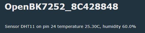

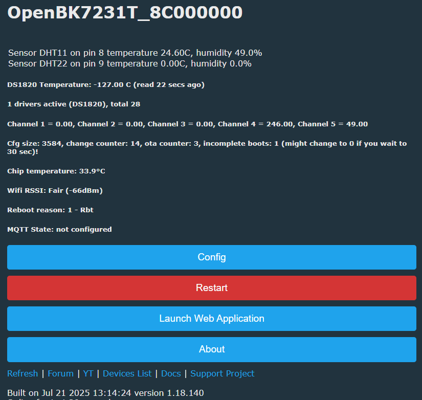

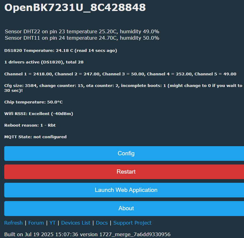

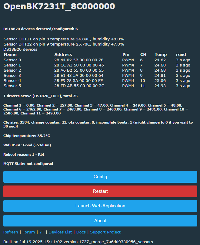

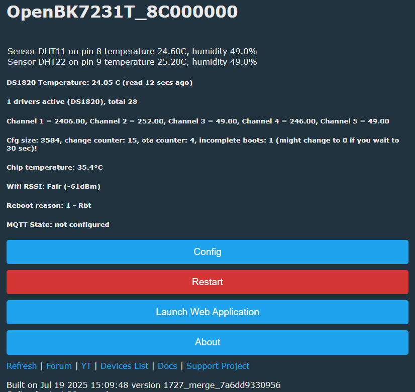

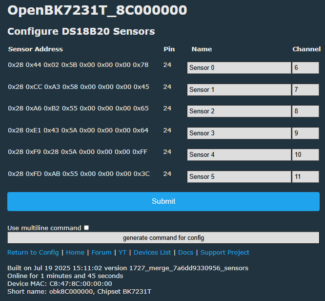

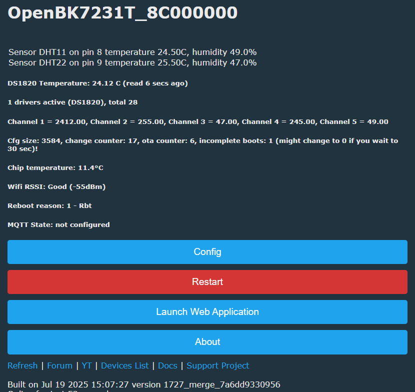

  • DHT22 works in normal release and PR 1727 builds
    #70 21615429
    Posts: 5220
    Help: 449
    Rate: 918
    confirming current operation with normal release
    OpenBK7231T interface showing sensor data from DHT11, DHT22 and DS18B20
    PR 1727 simple
    OpenBK interface showing DHT11, DHT22 sensor readings and chip temperature
    _ALT simple (doesn't have _ALT in build text but SDK 3.0.76 is seen at boot and chip temp is wrong/broken in _ALT)
    OpenBK7231T panel with DHT11, DHT22, and DS1820 sensor readings and control buttons
    _Sensors FULL
    OpenBK interface showing data from DS18B20 and DHT22 sensors with temperature and humidity

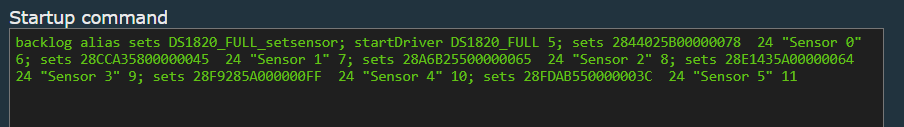

    DS18B20 sensor config screen in OpenBK7231T with six sensors and assigned channels
    Startup command with alias and DS18B20 sensor ID assignments
    nice to see DHT22 come to life

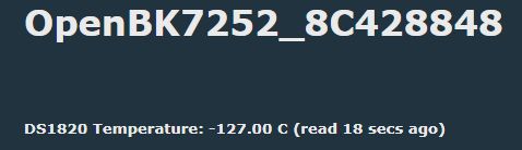

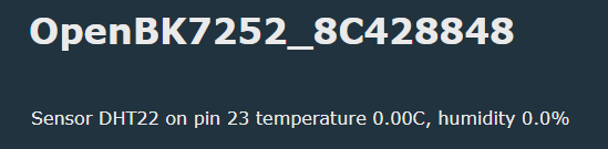

    SIMPLE
    OpenBK7231U panel showing sensor data, system status, and configuration controls
    FULL not in build

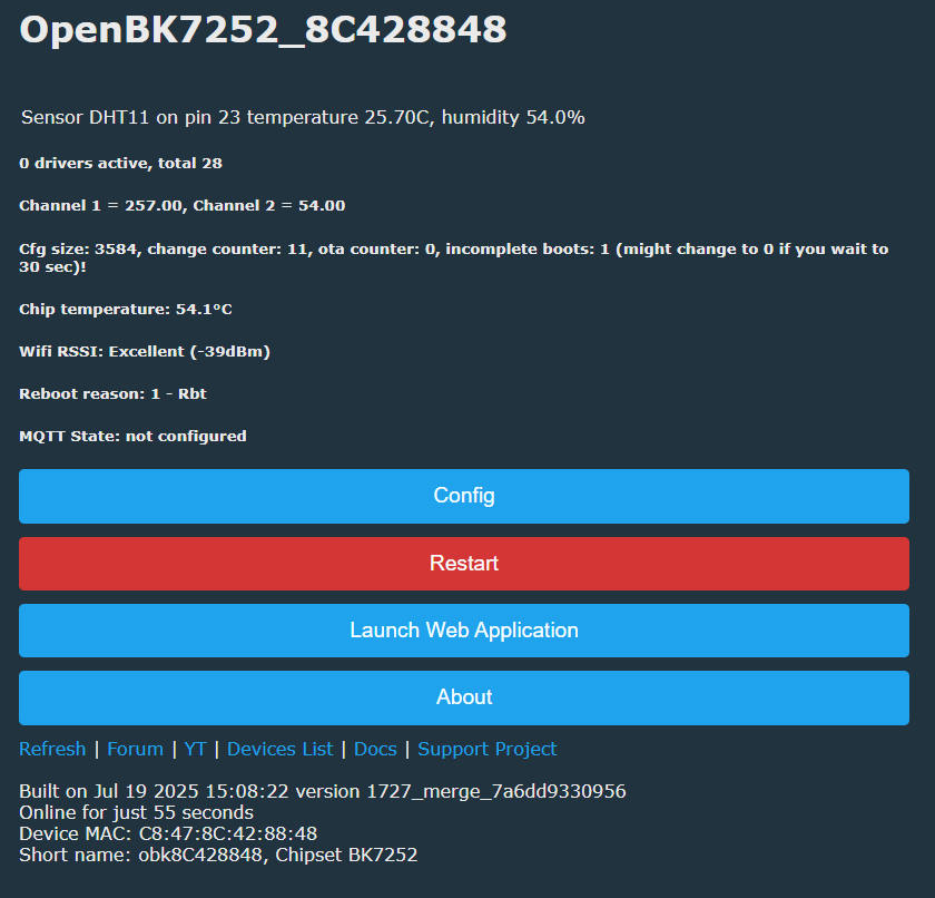

    = no need to test BK7252?
  • #73 21616088
    insmod
    Posts: 1432
    Help: 168
    Rate: 455
    BK7252 doesn't support reading from timer.
    Only BK7231T/U/S/N, BK7238 and BK7252N support it.
    Or perhaps it does, but needed defines are disabled for it.
    BK7252 needs good old nop way.

  • #79 21620499
    Posts: 5220
    Help: 449
    Rate: 918
    unless P23 is a bad choice, these are the results. single ds18b20
    OpenBK7252 interface screen showing sensor data and configuration buttons
    Screenshot of OpenBK7252 interface showing 0.00°C temperature and 0.0% humidity
    DS1820 temperature reading shows -127.00°C on interface screen
  • Logic analyzer and testus timing command

    #83 21620622
    Posts: 5220
    Help: 449
    Rate: 918
    ah i see. i see. testus with LA :D
    OK, so here's with just driver running. no testus cmd
    Screenshot from PulseView showing logic signal analysis on channel D0
    Added after 6 [minutes]:
    sr file better or do you want screenshots?
    • ds1820_bk7252u68_p23.zip (1.49 KB) You must be logged in to download this attachment.

  • #85 21620707
    max4elektroda
    Posts: 758
    Help: 49
    Rate: 189
    Sorry, can't check now, will report back tomorrow.
    First screenshot (138us) looks like it's way too short (reset should be >= 480us iirc.
  • All sensors read 130–140 after switching to P24

    yeh. they all seem to be 130-140
    Digital signal chart showing a 130 µs gap between green signal blocks

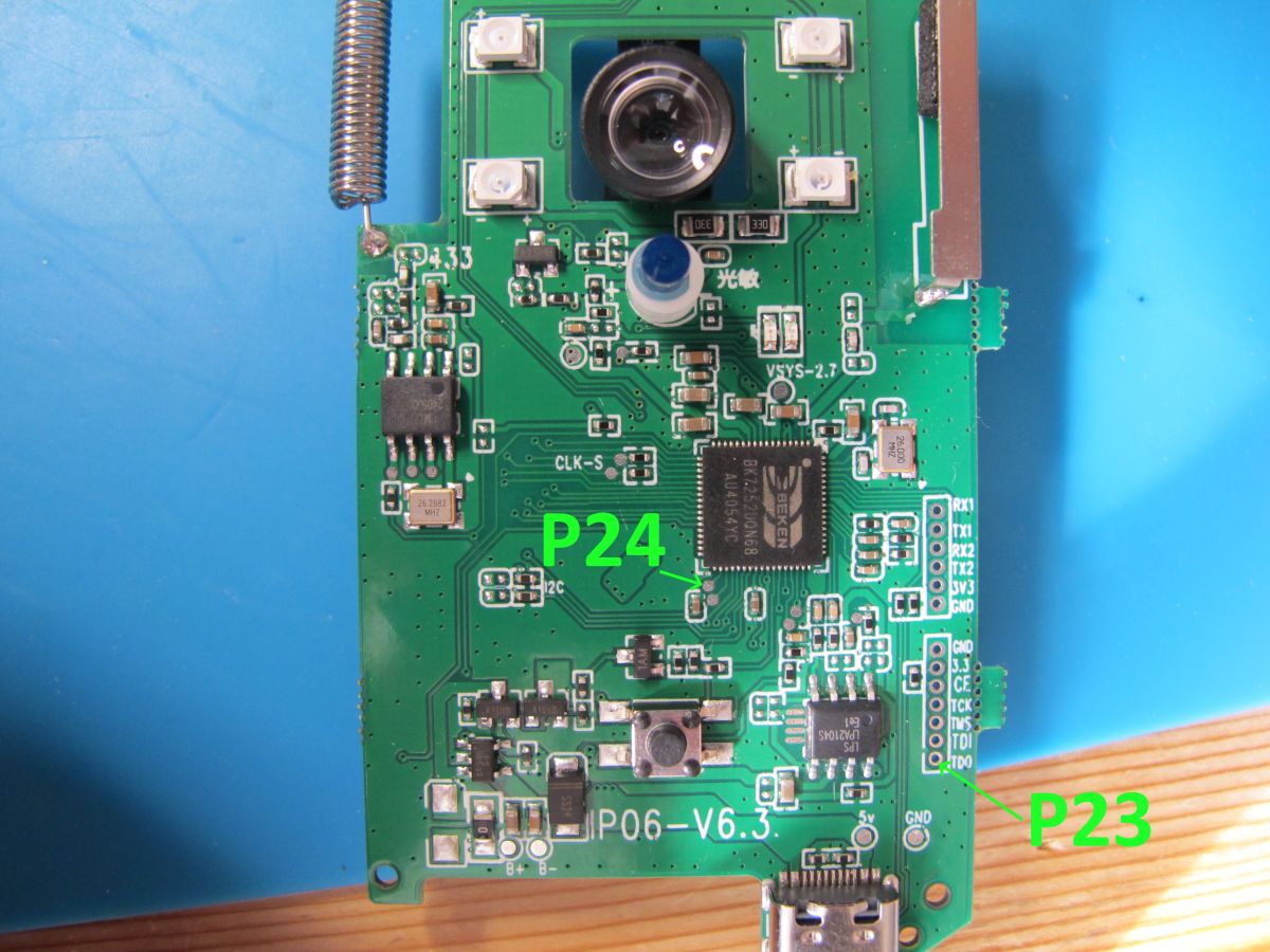

    Added after 8 [hours] 5 [minutes]:
    switching to P24 from P23
    PCB with labeled points P23 and P24, visible camera module and electronic components
    Sensor DHT11 on pin 24: temperature 25.30°C, humidity 60.0%
    DHT22 sensor message: temperature 0.00°C, humidity 0.0% on pin 24
    DS1820 temperature reading shows -127.00°C, 1 active driver out of 28
    • ds1820_bk7252u68_p24.zip (1.61 KB) You must be logged in to download this attachment.

    max4elektroda
    Posts: 758
    Help: 49
    Rate: 189
    That's much better and it seems DHT11 is very lax about timing. IIRC it used 55us, and in your data I see 14us "real" for requested 50.
    The factor is falling from higher to lower values:
    Over 4 for 500us (read 118us)
    to 1.33 for 4us (read 3us - but it also reads 3us for 6us)
    I'll try to increase the factor to 2.5 * actual one (resulting in 4.25 since we started with 1.7).
    PR is updated (latest one, first I synched to main) - builds are running.
  • #88 21622457
    Posts: 5220
    Help: 449
    Rate: 918
    1727_merge_76786986a81d
    • ds1820_bk7252u68_p24_1727_merge_76786986a81d.zip (2.01 KB) You must be logged in to download this attachment.
  • #89 21622490
    max4elektroda
    Posts: 758
    Help: 49
    Rate: 189
    Better for lower values, but for > 50us it's factor 1.6 to short.
    Maybe it even works for DS1820 from time to time with the actual version, but I mad a new try adjusting the factor according to the given value for usleep...
    I hope at least next version will work for DS1820 on BK7525...

    Cool. Will flash shortly. I hope my setup is good enough for these tests. 10cm to logic analyser
    PCB with components and a connected wire next to a 24MHz 8-channel logic analyzer
