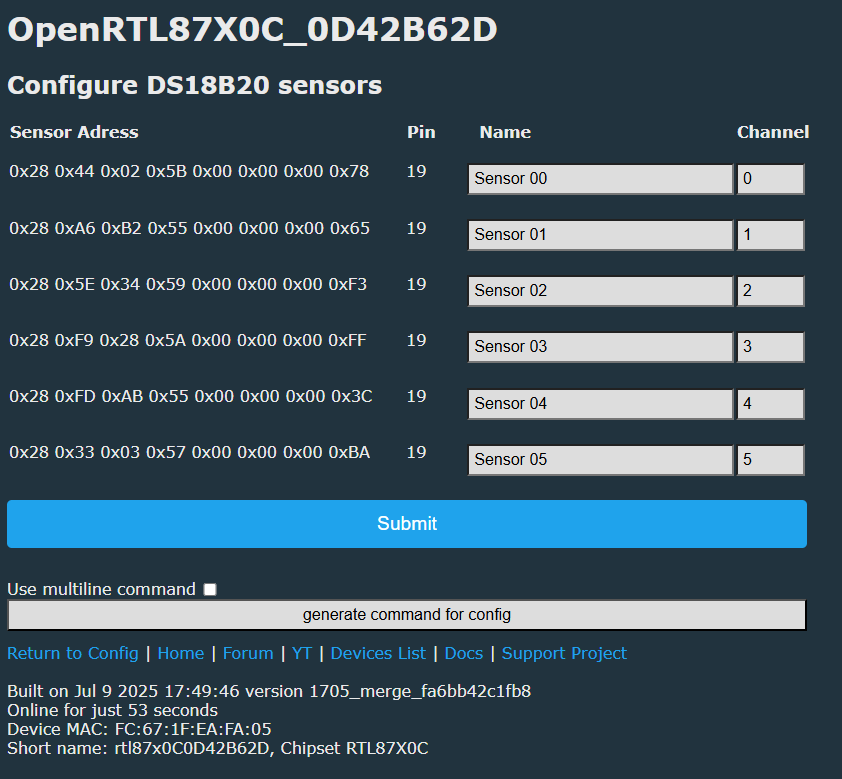

Extending DS18(B)20 driver - multiple GPIOs and multiple sensors per GPIO
max4elektroda 5931 108

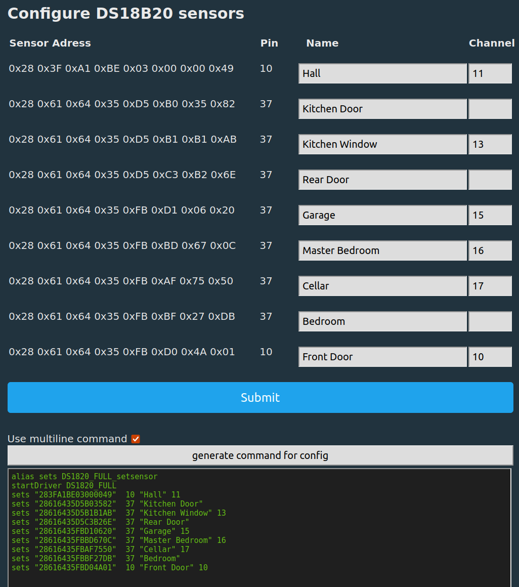

  • OpenBeken’s DS1820 full driver extends the existing DS18(B)20 code to support multiple GPIO buses and multiple sensors per bus.
  • It scans all DS1820_IO pins, discovers sensor addresses with the OneWire search algorithm, and stores per-sensor name, GPIO, channel, and last-read metadata.
  • Configuration uses commands like startDriver DS1820, DS18B20_setsensor, DS1820_SetResolution, and DS18B20_scansensors; the example backlog manages 10 sensors.
  • A simple GUI generates backlog commands so sensor names and channels persist after reboot, and the main page shows per-sensor updates.
  • The full driver adds about 6k on W800, and many clone DS18B20s ignore resolution settings and stay at 12-bit.

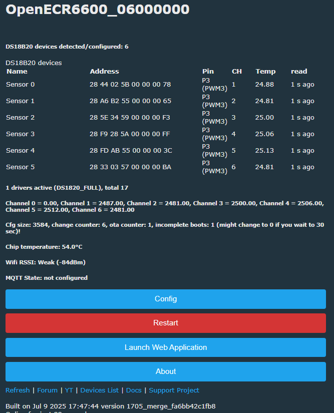

    Maybe just try command with only two or three sensors (don't know how many will fit into a command with less than 497 chars)?
    So basic function is "verified"
  • #32 21601387
    Posts: 5220
    Help: 449
    Rate: 918
    >>21601385
    yep. will do. then the focus can be on ds1820 driver and not so much the start-up command length initially.

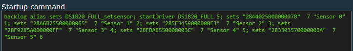

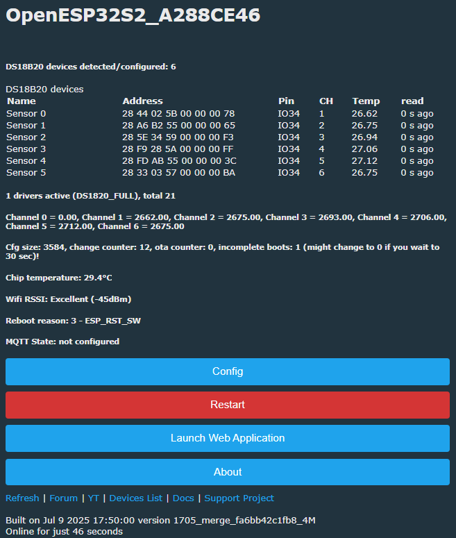

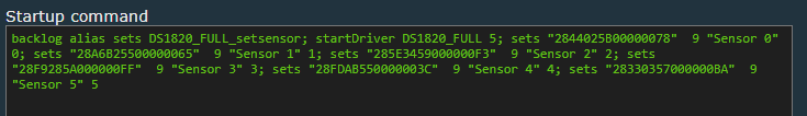

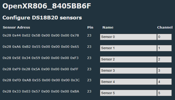

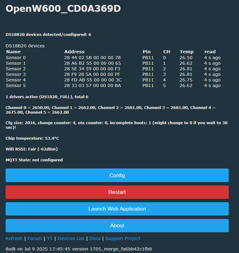

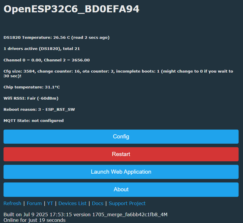

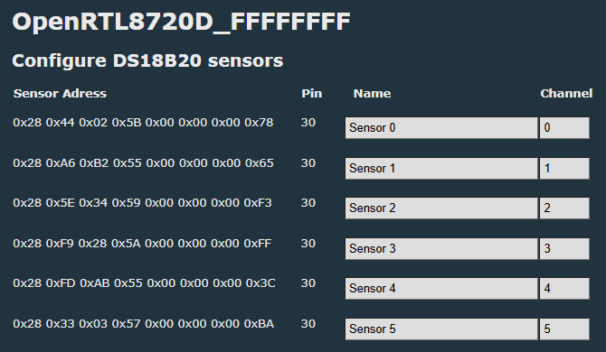

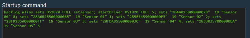

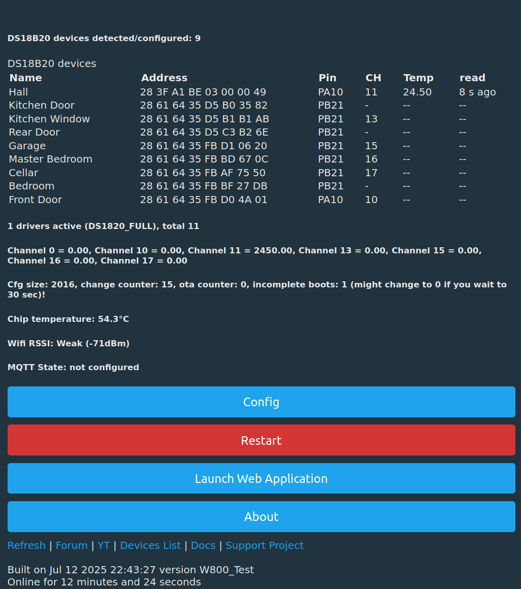

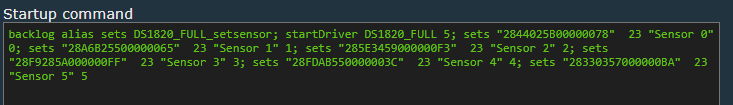

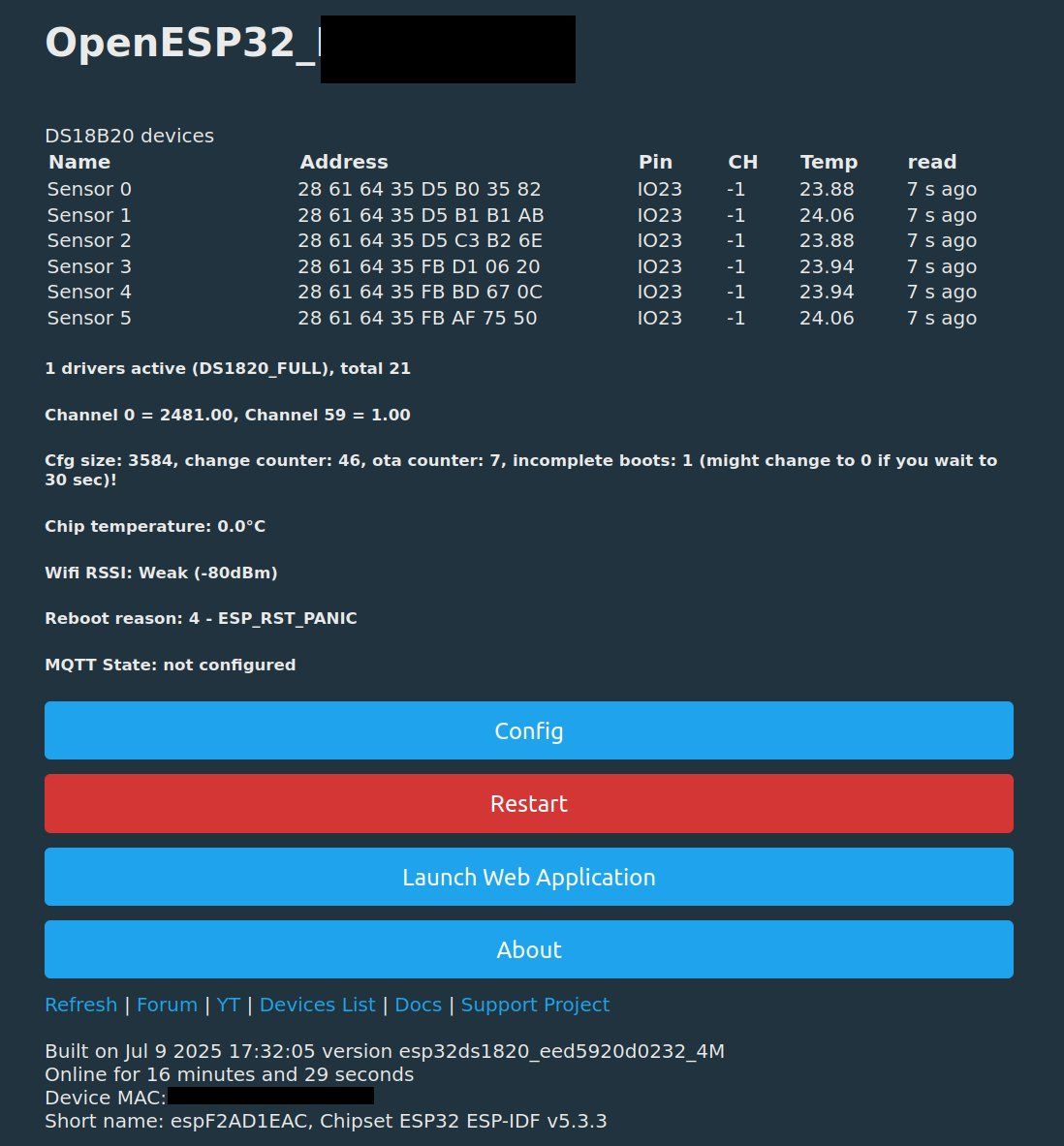

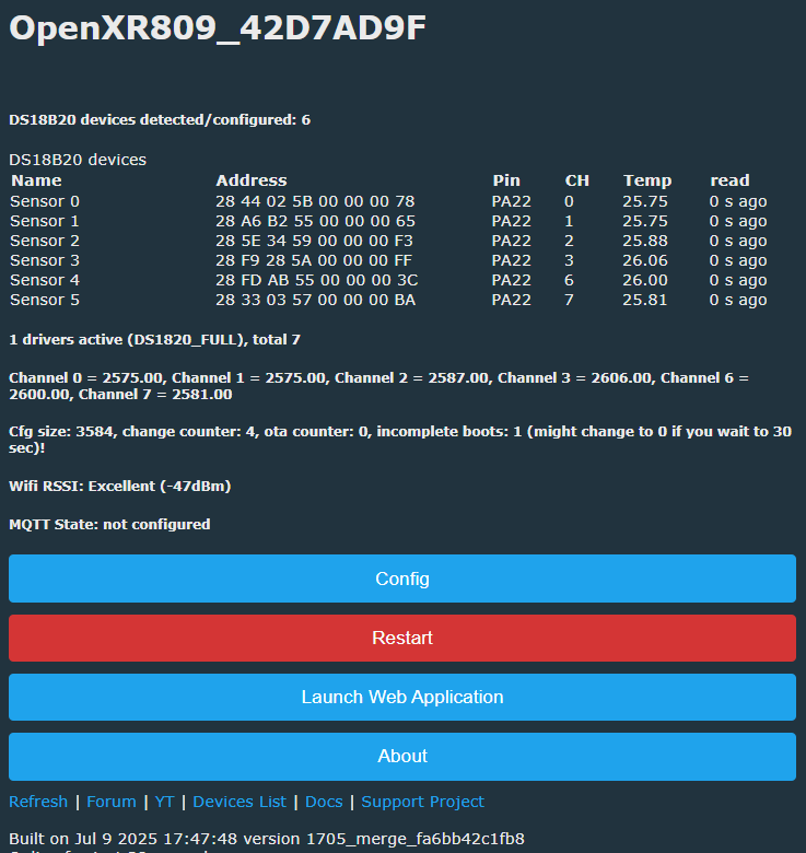

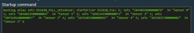

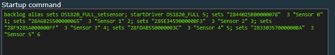

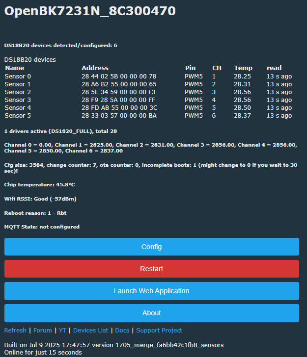

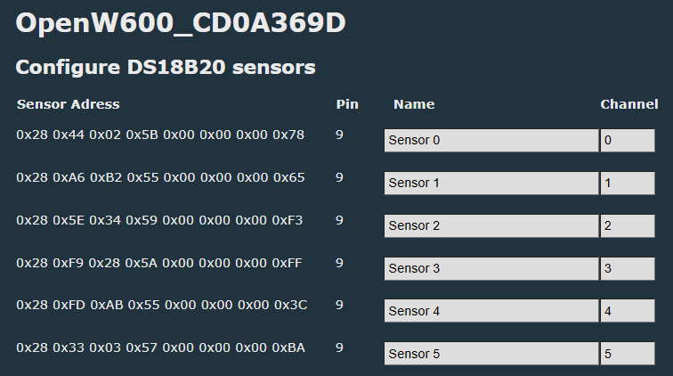

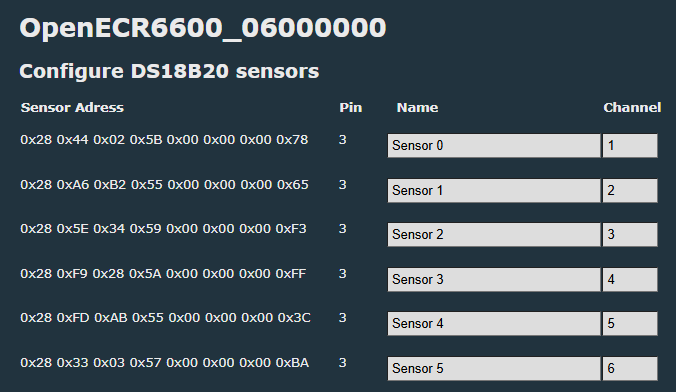

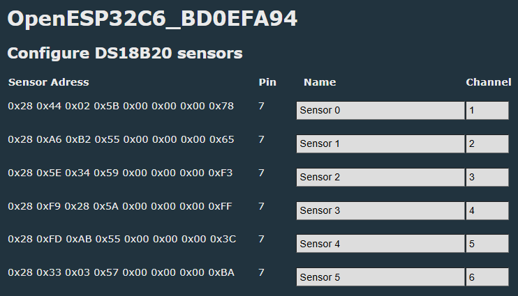

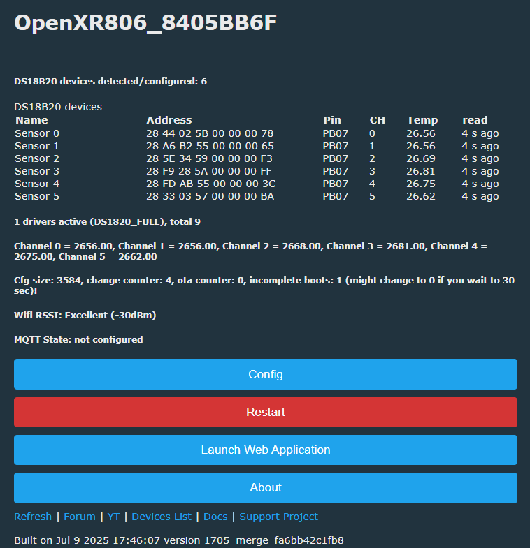

    Some feedback:
    The ESP32 issue is solved - the time without interrupt during OneWireReset was too long.
    I shortened the output for commands - address is now more compact and the command itself is shorter with usage of an alias for the quite long command "DS1820_FULL_setsensor".
    Tested o.k. here
    W800
    BL602
    ESP32S2
    ESP32

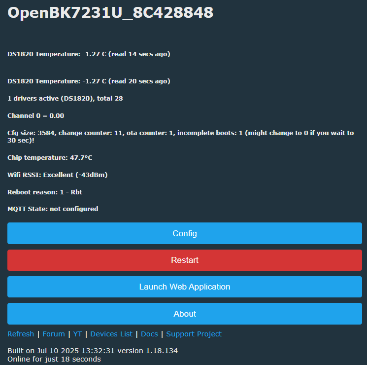

  • CRC errors and -127 readings on DS18B20 bus

    Debug:SENSOR:DS1820 - .. Pin 4 found! dsread=0
    Info:SENSOR:DS1820 - Starting conversion
    55 0x00 0x00 0x00 0x3C) reported -127.00
    Debug:SENSOR:DS1820 - Found device at index 4 - GPIO=4
    Debug:SENSOR:DS1820 - GPIO found for device - DS18B20_GPIO=4
    Error:SENSOR:DS1820 - Read CRC=ff != calculated:c9 (errcount=4)
    Error:SENSOR:DS1820 - Scratchpad Data Read: 0xFF 0xFF 0xFF 0xFF 0xFF 0xFF 0xFF 0xFF 0xFF
    Debug:SENSOR:DS1820 - ds18b20_readScratchPad returned 0 - Crc8CQuick=201 / scratchPad[SCRATCHPAD_CRC]=255
    Debug:SENSOR:DS1820 - Device not connected
    Debug:SENSOR:DS1820 - Device 4 (0x28 0xFD 0xAB 0x55 0x00 0x00 0x00 0x3C) reported -127.00

    Multiple DS18B20 sensors work on one GPIO
    Spoiler:
    Debug:SENSOR:DS1820 - .. Pin 19 found! dsread=0
    Debug:SENSOR:DS1820 - .. Pin 19 found! dsread=1
    Info:SENSOR:DS1820 - Reading temperature from 6 DS18B20 sensor(s)
    Debug:SENSOR:DS1820 - Found device at index 0 - GPIO=19
    Debug:SENSOR:DS1820 - GPIO found for device - DS18B20_GPIO=19
    Debug:SENSOR:DS1820 - ds18b20_readScratchPad returned 1 - Crc8CQuick=10 / scratchPad[SCRATCHPAD_CRC]=10
    Debug:SENSOR:DS1820 - ds18b20_Scratchpat2TempC: family=28, raw=3400 (12 bit resolution)
    Debug:SENSOR:DS1820 - Device 0 (0x28 0x44 0x02 0x5B 0x00 0x00 0x00 0x78) reported 26.56
    Info:SENSOR:DS1820 - Sensor 0x28 0x44 0x02 0x5B 0x00 0x00 0x00 0x78 on PA19 reported 26.56
    Debug:SENSOR:DS1820 - Found device at index 1 - GPIO=19
    Debug:SENSOR:DS1820 - ds18b20_readScratchPad returned 1 - Crc8CQuick=81 / scratchPad[SCRATCHPAD_CRC]=81
    Debug:SENSOR:DS1820 - ds18b20_Scratchpat2TempC: family=28, raw=3392 (12 bit resolution)
    Debug:SENSOR:DS1820 - Device 1 (0x28 0xA6 0xB2 0x55 0x00 0x00 0x00 0x65) reported 26.50
    Info:SENSOR:DS1820 - Sensor 0x28 0xA6 0xB2 0x55 0x00 0x00 0x00 0x65 on PA19 reported 26.50
    Debug:SENSOR:DS1820 - Found device at index 2 - GPIO=19
    Debug:SENSOR:DS1820 - ds18b20_readScratchPad returned 1 - Crc8CQuick=9 / scratchPad[SCRATCHPAD_CRC]=9
    Debug:SENSOR:DS1820 - ds18b20_Scratchpat2TempC: family=28, raw=3424 (12 bit resolution)
    Debug:SENSOR:DS1820 - Device 2 (0x28 0x5E 0x34 0x59 0x00 0x00 0x00 0xF3) reported 26.75
    Info:SENSOR:DS1820 - Sensor 0x28 0x5E 0x34 0x59 0x00 0x00 0x00 0xF3 on PA19 reported 26.75
    Debug:SENSOR:DS1820 - Found device at index 3 - GPIO=19
    Debug:SENSOR:DS1820 - ds18b20_readScratchPad returned 1 - Crc8CQuick=36 / scratchPad[SCRATCHPAD_CRC]=36
    Debug:SENSOR:DS1820 - ds18b20_Scratchpat2TempC: family=28, raw=3432 (12 bit resolution)
    Debug:SENSOR:DS1820 - Device 3 (0x28 0xF9 0x28 0x5A 0x00 0x00 0x00 0xFF) reported 26.81
    Info:SENSOR:DS1820 - Sensor 0x28 0xF9 0x28 0x5A 0x00 0x00 0x00 0xFF on PA19 reported 26.81
    Debug:SENSOR:DS1820 - Found device at index 4 - GPIO=19
    Debug:SENSOR:DS1820 - Device 4 (0x28 0xFD 0xAB 0x55 0x00 0x00 0x00 0x3C) reported 26.81
    Info:SENSOR:DS1820 - Sensor 0x28 0xFD 0xAB 0x55 0x00 0x00 0x00 0x3C on PA19 reported 26.81
    Debug:SENSOR:DS1820 - Found device at index 5 - GPIO=19
    Debug:SENSOR:DS1820 - ds18b20_readScratchPad returned 1 - Crc8CQuick=11 / scratchPad[SCRATCHPAD_CRC]=11
    Debug:SENSOR:DS1820 - ds18b20_Scratchpat2TempC: family=28, raw=3408 (12 bit resolution)
    Debug:SENSOR:DS1820 - Device 5 (0x28 0x33 0x03 0x57 0x00 0x00 0x00 0xBA) reported 26.63
    Info:SENSOR:DS1820 - Sensor 0x28 0x33 0x03 0x57 0x00 0x00 0x00 0xBA on PA19 reported 26.63
    Debug:SENSOR:DS1820 - ds18b20_readScratchPad returned 1 - Crc8CQuick=29 / scratchPad[SCRATCHPAD_CRC]=29
    Debug:SENSOR:DS1820 - ds18b20_Scratchpat2TempC: family=28, raw=3416 (12 bit resolution)
    Debug:SENSOR:DS1820 - Device 2 (0x28 0x5E 0x34 0x59 0x00 0x00 0x00 0xF3) reported 26.69
    Info:SENSOR:DS1820 - Sensor 0x28 0x5E 0x34 0x59 0x00 0x00 0x00 0xF3 on PA19 reported 26.69
    Debug:SENSOR:DS1820 - ds18b20_readScratchPad returned 1 - Crc8CQuick=37 / scratchPad[SCRATCHPAD_CRC]=37
    Debug:SENSOR:DS1820 - ds18b20_Scratchpat2TempC: family=28, raw=3440 (12 bit resolution)
    Debug:SENSOR:DS1820 - Device 4 (0x28 0xFD 0xAB 0x55 0x00 0x00 0x00 0x3C) reported 26.88
    Info:SENSOR:DS1820 - Sensor 0x28 0xFD 0xAB 0x55 0x00 0x00 0x00 0x3C on PA19 reported 26.88
    Error:SENSOR:DS1820 - Read CRC=b != calculated:71 (errcount=1)
    Error:SENSOR:DS1820 - Scratchpad Data Read: 0xAA 0x03 0x7F 0x80 0x7F 0xFF 0x06 0x10 0x0B
    Debug:SENSOR:DS1820 - ds18b20_readScratchPad returned 0 - Crc8CQuick=113 / scratchPad[SCRATCHPAD_CRC]=11
    Debug:SENSOR:DS1820 - Device 5 (0x28 0x33 0x03 0x57 0x00 0x00 0x00 0xBA) reported -127.00
    Spoiler:
    Debug:SENSOR:DS1820 - .. Pin 9 found! dsread=1
    Debug:SENSOR:DS1820 - Found device at index 0 - GPIO=9
    Debug:SENSOR:DS1820 - GPIO found for device - DS18B20_GPIO=9
    Debug:SENSOR:DS1820 - Device 0 (0x28 0x44 0x02 0x5B 0x00 0x00 0x00 0x78) reported 26.62
    Info:SENSOR:DS1820 - Sensor 0x28 0x44 0x02 0x5B 0x00 0x00 0x00 0x78 on PB11 reported 26.62
    Debug:SENSOR:DS1820 - Found device at index 1 - GPIO=9
    Debug:SENSOR:DS1820 - Device 1 (0x28 0xA6 0xB2 0x55 0x00 0x00 0x00 0x65) reported 26.69
    Info:SENSOR:DS1820 - Sensor 0x28 0xA6 0xB2 0x55 0x00 0x00 0x00 0x65 on PB11 reported 26.69
    Debug:SENSOR:DS1820 - Found device at index 2 - GPIO=9
    Debug:SENSOR:DS1820 - Device 2 (0x28 0x5E 0x34 0x59 0x00 0x00 0x00 0xF3) reported 26.88
    Info:SENSOR:DS1820 - Sensor 0x28 0x5E 0x34 0x59 0x00 0x00 0x00 0xF3 on PB11 reported 26.88
    Debug:SENSOR:DS1820 - Found device at index 3 - GPIO=9
    Debug:SENSOR:DS1820 - ds18b20_readScratchPad returned 1 - Crc8CQuick=51 / scratchPad[SCRATCHPAD_CRC]=51
    Debug:SENSOR:DS1820 - ds18b20_Scratchpat2TempC: family=28, raw=3448 (12 bit resolution)
    Debug:SENSOR:DS1820 - Device 3 (0x28 0xF9 0x28 0x5A 0x00 0x00 0x00 0xFF) reported 26.94
    Info:SENSOR:DS1820 - Sensor 0x28 0xF9 0x28 0x5A 0x00 0x00 0x00 0xFF on PB11 reported 26.94
    Debug:SENSOR:DS1820 - Found device at index 4 - GPIO=9
    Info:SENSOR:DS1820 - Sensor 0x28 0xFD 0xAB 0x55 0x00 0x00 0x00 0x3C on PB11 reported 26.81
    Debug:SENSOR:DS1820 - Found device at index 5 - GPIO=9
    Debug:SENSOR:DS1820 - Device 5 (0x28 0x33 0x03 0x57 0x00 0x00 0x00 0xBA) reported 26.69
    Info:SENSOR:DS1820 - Sensor 0x28 0x33 0x03 0x57 0x00 0x00 0x00 0xBA on PB11 reported 26.69
    Debug:SENSOR:DS1820 - .. Pin 9 found! dsread=0
    Info:SENSOR:DS1820 - Sensor 0x28 0xFD 0xAB 0x55 0x00 0x00 0x00 0x3C on PB11 reported 26.88

    Added after 7 [minutes]:
    max4elektroda wrote:
    Tested o.k. here
    W800
    BL602
    ESP32S2
    ESP32
    checking, BK-N/T needs doing?
    Added after 17 [minutes]:
    Spoiler:
    Debug:SENSOR:DS1820 - .. Pin 14 found! dsread=0
    Debug:SENSOR:DS1820 - .. Pin 14 found! dsread=1
    Debug:SENSOR:DS1820 - Found device at index 0 - GPIO=14
    Debug:SENSOR:DS1820 - GPIO found for device - DS18B20_GPIO=14
    Debug:SENSOR:DS1820 - ds18b20_readScratchPad returned 1 - Crc8CQuick=245 / scratchPad[SCRATCHPAD_CRC]=245
    Debug:SENSOR:DS1820 - ds18b20_Scratchpat2TempC: family=28, raw=3296 (12 bit resolution)
    Debug:SENSOR:DS1820 - Device 0 (0x28 0x44 0x02 0x5B 0x00 0x00 0x00 0x78) reported 25.75
    Info:SENSOR:DS1820 - Sensor 0x28 0x44 0x02 0x5B 0x00 0x00 0x00 0x78 on PA22 reported 25.75
    Debug:SENSOR:DS1820 - Found device at index 1 - GPIO=14
    Debug:SENSOR:DS1820 - Device 1 (0x28 0xA6 0xB2 0x55 0x00 0x00 0x00 0x65) reported 25.75
    Info:SENSOR:DS1820 - Sensor 0x28 0xA6 0xB2 0x55 0x00 0x00 0x00 0x65 on PA22 reported 25.75
    Debug:SENSOR:DS1820 - Found device at index 2 - GPIO=14
    Debug:SENSOR:DS1820 - ds18b20_readScratchPad returned 1 - Crc8CQuick=217 / scratchPad[SCRATCHPAD_CRC]=217
    Debug:SENSOR:DS1820 - ds18b20_Scratchpat2TempC: family=28, raw=3312 (12 bit resolution)
    Debug:SENSOR:DS1820 - Device 2 (0x28 0x5E 0x34 0x59 0x00 0x00 0x00 0xF3) reported 25.88
    Info:SENSOR:DS1820 - Sensor 0x28 0x5E 0x34 0x59 0x00 0x00 0x00 0xF3 on PA22 reported 25.88
    Debug:SENSOR:DS1820 - Found device at index 3 - GPIO=14
    Debug:SENSOR:DS1820 - ds18b20_readScratchPad returned 1 - Crc8CQuick=86 / scratchPad[SCRATCHPAD_CRC]=86
    Debug:SENSOR:DS1820 - ds18b20_Scratchpat2TempC: family=28, raw=3336 (12 bit resolution)
    Debug:SENSOR:DS1820 - Device 3 (0x28 0xF9 0x28 0x5A 0x00 0x00 0x00 0xFF) reported 26.06
    Info:SENSOR:DS1820 - Sensor 0x28 0xF9 0x28 0x5A 0x00 0x00 0x00 0xFF on PA22 reported 26.06
    Debug:SENSOR:DS1820 - Found device at index 4 - GPIO=14
    Debug:SENSOR:DS1820 - Device 4 (0x28 0xFD 0xAB 0x55 0x00 0x00 0x00 0x3C) reported 26.06
    Info:SENSOR:DS1820 - Sensor 0x28 0xFD 0xAB 0x55 0x00 0x00 0x00 0x3C on PA22 reported 26.06
    Debug:SENSOR:DS1820 - Found device at index 5 - GPIO=14
    Debug:SENSOR:DS1820 - ds18b20_readScratchPad returned 1 - Crc8CQuick=216 / scratchPad[SCRATCHPAD_CRC]=216
    Debug:SENSOR:DS1820 - ds18b20_Scratchpat2TempC: family=28, raw=3304 (12 bit resolution)
    Debug:SENSOR:DS1820 - Device 5 (0x28 0x33 0x03 0x57 0x00 0x00 0x00 0xBA) reported 25.81
    Info:SENSOR:DS1820 - Sensor 0x28 0x33 0x03 0x57 0x00 0x00 0x00 0xBA on PA22 reported 25.81
    Multiple DS18B20 sensors read correctly on PA5
    #39 21603278
    Posts: 5220
    Help: 449
    Rate: 918
    Spoiler:
    Debug:SENSOR:DS1820 - .. Pin 1 found! dsread=0
    Debug:SENSOR:DS1820 - .. Pin 1 found! dsread=1
    Debug:SENSOR:DS1820 - ds18b20_readScratchPad returned 1 - Crc8CQuick=182 / scratchPad[SCRATCHPAD_CRC]=182
    Debug:SENSOR:DS1820 - ds18b20_Scratchpat2TempC: family=28, raw=3600 (12 bit resolution)
    Debug:SENSOR:DS1820 - Device 0 (0x28 0x44 0x02 0x5B 0x00 0x00 0x00 0x78) reported 28.12
    Info:SENSOR:DS1820 - Sensor 0x28 0x44 0x02 0x5B 0x00 0x00 0x00 0x78 on PA5 reported 28.12
    Debug:SENSOR:DS1820 - ds18b20_readScratchPad returned 1 - Crc8CQuick=160 / scratchPad[SCRATCHPAD_CRC]=160
    Debug:SENSOR:DS1820 - ds18b20_Scratchpat2TempC: family=28, raw=3608 (12 bit resolution)
    Debug:SENSOR:DS1820 - Device 1 (0x28 0xA6 0xB2 0x55 0x00 0x00 0x00 0x65) reported 28.19
    Info:SENSOR:DS1820 - Sensor 0x28 0xA6 0xB2 0x55 0x00 0x00 0x00 0x65 on PA5 reported 28.19
    Debug:SENSOR:DS1820 - ds18b20_readScratchPad returned 1 - Crc8CQuick=153 / scratchPad[SCRATCHPAD_CRC]=153
    Debug:SENSOR:DS1820 - ds18b20_Scratchpat2TempC: family=28, raw=3624 (12 bit resolution)
    Debug:SENSOR:DS1820 - Device 2 (0x28 0x5E 0x34 0x59 0x00 0x00 0x00 0xF3) reported 28.31
    Info:SENSOR:DS1820 - Sensor 0x28 0x5E 0x34 0x59 0x00 0x00 0x00 0xF3 on PA5 reported 28.31
    Debug:SENSOR:DS1820 - ds18b20_readScratchPad returned 1 - Crc8CQuick=142 / scratchPad[SCRATCHPAD_CRC]=142
    Debug:SENSOR:DS1820 - ds18b20_Scratchpat2TempC: family=28, raw=3640 (12 bit resolution)
    Debug:SENSOR:DS1820 - Device 3 (0x28 0xF9 0x28 0x5A 0x00 0x00 0x00 0xFF) reported 28.44
    Info:SENSOR:DS1820 - Sensor 0x28 0xF9 0x28 0x5A 0x00 0x00 0x00 0xFF on PA5 reported 28.44
    Debug:SENSOR:DS1820 - ds18b20_readScratchPad returned 1 - Crc8CQuick=152 / scratchPad[SCRATCHPAD_CRC]=152
    Debug:SENSOR:DS1820 - ds18b20_Scratchpat2TempC: family=28, raw=3632 (12 bit resolution)
    Debug:SENSOR:DS1820 - Device 4 (0x28 0xFD 0xAB 0x55 0x00 0x00 0x00 0x3C) reported 28.38
    Info:SENSOR:DS1820 - Sensor 0x28 0xFD 0xAB 0x55 0x00 0x00 0x00 0x3C on PA5 reported 28.38
    Debug:SENSOR:DS1820 - ds18b20_readScratchPad returned 1 - Crc8CQuick=180 / scratchPad[SCRATCHPAD_CRC]=180
    Debug:SENSOR:DS1820 - ds18b20_Scratchpat2TempC: family=28, raw=3616 (12 bit resolution)
    Debug:SENSOR:DS1820 - Device 5 (0x28 0x33 0x03 0x57 0x00 0x00 0x00 0xBA) reported 28.25
    Info:SENSOR:DS1820 - Sensor 0x28 0x33 0x03 0x57 0x00 0x00 0x00 0xBA on PA5 reported 28.25
    Added after 15 [minutes]:
    Spoiler:
    Debug:SENSOR:DS1820 - .. Pin 26 found! dsread=0
    Debug:SENSOR:DS1820 - .. Pin 26 found! dsread=1
    Debug:SENSOR:DS1820 - Found device at index 0 - GPIO=26
    Debug:SENSOR:DS1820 - GPIO found for device - DS18B20_GPIO=26
    Debug:SENSOR:DS1820 - Device 0 (0x28 0x44 0x02 0x5B 0x00 0x00 0x00 0x78) reported 28.31
    Info:SENSOR:DS1820 - Sensor 0x28 0x44 0x02 0x5B 0x00 0x00 0x00 0x78 on PWM5 reported 28.31
    Debug:SENSOR:DS1820 - Found device at index 1 - GPIO=26
    Debug:SENSOR:DS1820 - ds18b20_readScratchPad returned 1 - Crc8CQuick=176 / scratchPad[SCRATCHPAD_CRC]=176

    Added after 27 [minutes]:

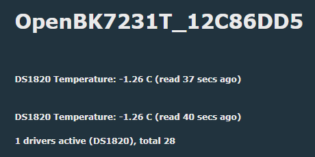

    not getting any sensors detected on BK7231T. Tried most GPIOs
    Does DS1820 work on T with release firmware?
    Beken timing for usleep used to be kind of unreliable, but I don't recall in detail.
    There are some other changes to Beken timing possible, but I wanted to do only changes to DS1820 code here ...
  • #41 21603354
    Posts: 5220
    Help: 449
    Rate: 918
    Hmm. Actually can't remember. Bear with
    Added after 21 [minutes]:
    weird. no. shows twice. tried 4 IOs. 1.18.134
    startdriver ds1820 in startup command and DS1820_IO set in config/reboot each time.
  • DS1820 driver still shown as static entry
    #42 21603506
    max4elektroda
    Posts: 758
    Help: 49
    Rate: 189
    That's true for all simple drivers in release. When the command for HTTP output was extended to display something before or inside the state div, we forgot the DS1820 driver, so it's displayed (wrongly) as a static entry once before the part where the updates are shown.
    The main information is I didn't break the behavior, it (doesn't) work, as it was doing before.
    Let's focus on getting this merged and then try another fix for Beken timing.
  • CRC errors on DS18B20 scratchpad reads on GPIO34
    #43 21603535
    Posts: 5220
    Help: 449
    Rate: 918

    Added after 22 [minutes]:
    ESP32-C6 I don't seem to get any detections on on any of the GPIOs I've tried - maybe 6 or 7
  • #44 21603592
    max4elektroda
    Posts: 758
    Help: 49
    Rate: 189
    Nothing at all or CRC failures with read values != FF ?
    This is an indication if timing only "bad" (so it's reading something, but with many errors) or is it totally out of range (we'll read only FF on the line).
    If it's not too much, could you again try with release in this case?
  • #45 21603597
    Posts: 5220
    Help: 449
    Rate: 918
    ah yes. I didn't give enough info re C6. 0 sensors detected, not just read fails. Will do C6 properly

  • Single- and multi-sensor DS18B20 driver release
    #48 21604374
    Posts: 5220
    Help: 449
    Rate: 918
    single sensor general release
    single sensor simple. PR
    multi sensor full. PR
    Spoiler:

    C6 false alarm! :D
    also, has this changed? I've not tried it much, but C6 and some other platform it didn't work
    Added after 13 [minutes]:
    like T, U detects no sensors with GA or PR release, single and multi sensor - full/simple.

  • HTML-only driver update with empty unset channels
    #53 21605080
    max4elektroda
    Posts: 758
    Help: 49
    Rate: 189
    I changed the "FULL" driver (only HTML output, so no need to test on multiple platforms).
    Do you think it's better now?
    On main page, unset channels are "-":
    on the config page, they are "empty":
    Also you should no longer be able to assign a channel already in use

    Nice, but why quotation marks for ID hex string?
    It's the aftermath of the older approach when it was a string of hex in form "0x01 0x02 ...".
    Since there are no more whitespaces it should work without, too.

    cool

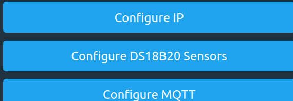

    looks good. couple of things. address has two Ds
    and for consistency a capital S in menu?

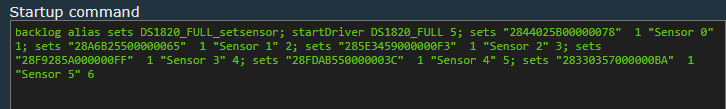

    As last action, I would disable "FULL" driver as default for all platforms using DS1820 and enable it in only in "sensors" build?
    Added after 50 [minutes]:
    OK, did change obk_config accordingly.
