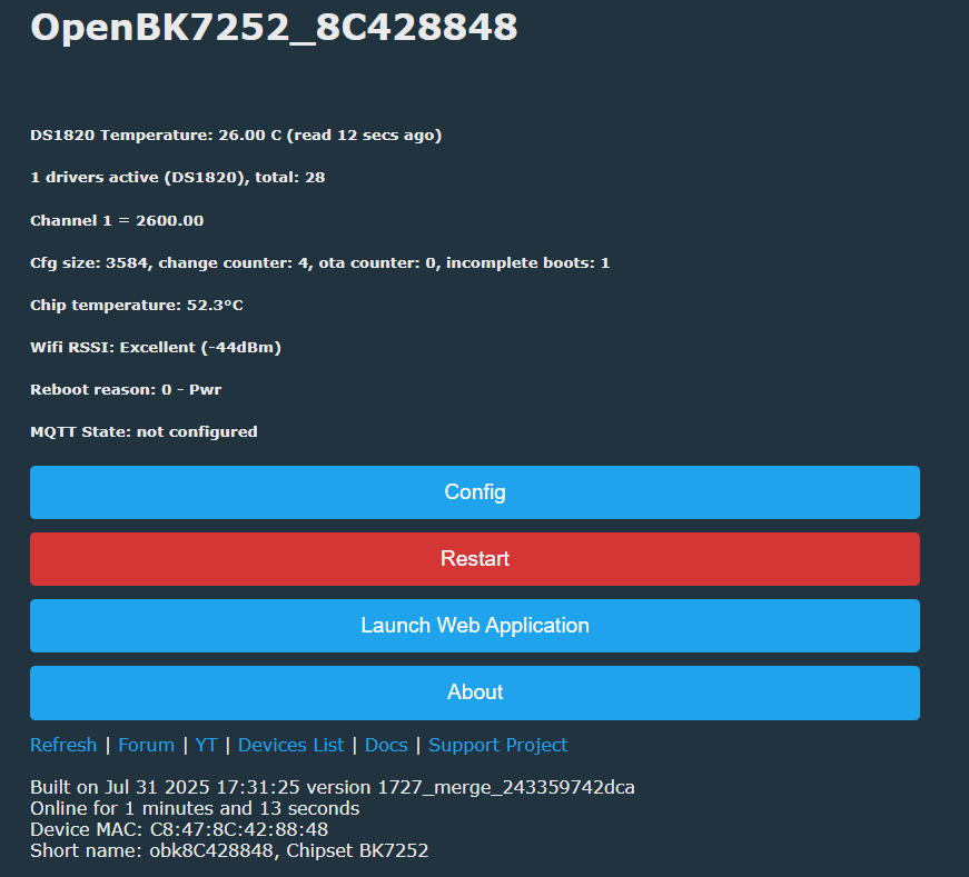

    OpenBK7252 web interface showing DS1820 temperature sensor and system stats
    • ds1820_bk7252u68_p24_1727_merge_243359742dca.zip (2.09 KB) You must be logged in to download this attachment.

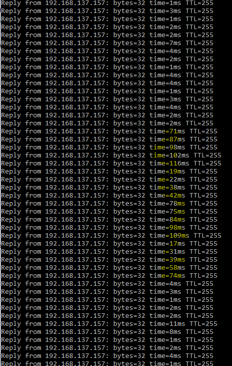

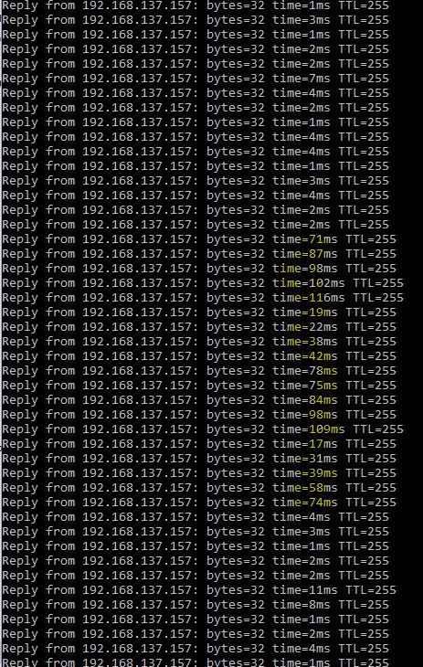

    max4elektroda wrote:
    I almost forgot: is PowerSave possible for BK7525?
    appears to. powersave 0 = 0.11A. Powersave 1 = ~0.2A
    these higher-latency pings are powersave 1
    Ping results to 192.168.137.157 with times ranging from 1ms to 116ms

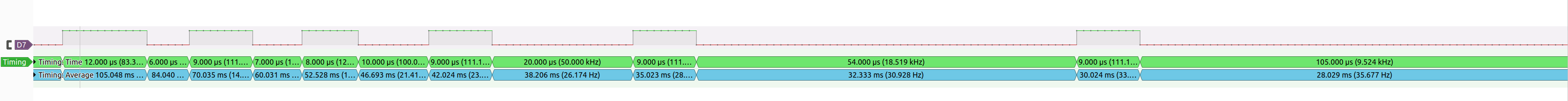

    BK7238 will need some powersave-adjustment, added the code.
    As soon as @insmod s PR fixing powersave is merged, it should work after syncing this PR

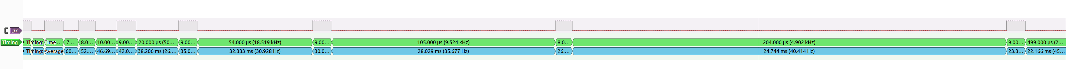

    Logic analyzer screenshot of signal on pin D7 with timing and pulse duration measurements
    Screenshot from logic analyzer showing D7 line signal timings and pulse durations
    I saw some timeouts and a few CRCs, but generally its working o.k. with powersave:
    Info:SENSOR:DS1820[9] - Temp=25.00
    Info:MAIN:Time 667, idle 61945/s, free 115104, MQTT 0(42), bWifi 1, secondsWithNoPing 601, socks 2/24 POWERSAVE
    Info:MAIN:Time 668, idle 64117/s, free 113928, MQTT 0(42), bWifi 1, secondsWithNoPing 602, socks 2/24 POWERSAVE
    Info:MAIN:Time 669, idle 57772/s, free 115088, MQTT 0(42), bWifi 1, secondsWithNoPing 603, socks 3/24 POWERSAVE
    Info:SENSOR:DHT start, pin is 7
    Info:MAIN:Time 670, idle 55622/s, free 123992, MQTT 0(42), bWifi 1, secondsWithNoPing 604, socks 2/24 POWERSAVE
    Info:SENSOR:DS1820[9] - Starting conversion
    Info:MAIN:Time 671, idle 61380/s, free 115688, MQTT 0(42), bWifi 1, secondsWithNoPing 605, socks 2/24 POWERSAVE
    Info:MAIN:Time 672, idle 64249/s, free 123408, MQTT 0(42), bWifi 1, secondsWithNoPing 606, socks 3/24 POWERSAVE
    Info:MAIN:Time 673, idle 49489/s, free 115688, MQTT 0(42), bWifi 1, secondsWithNoPing 607, socks 2/24 POWERSAVE
    Info:MAIN:Time 674, idle 61657/s, free 115688, MQTT 0(42), bWifi 1, secondsWithNoPing 608, socks 2/24 POWERSAVE
    Info:MAIN:Time 675, idle 27978/s, free 115688, MQTT 0(42), bWifi 1, secondsWithNoPing 609, socks 2/24 POWERSAVE
    Info:SENSOR:DHT timeout waiting for start signal high pulse.
    Info:MAIN:Time 676, idle 51902/s, free 114016, MQTT 0(42), bWifi 1, secondsWithNoPing 610, socks 2/24 POWERSAVE
    Info:MAIN:Time 677, idle 68400/s, free 115600, MQTT 0(42), bWifi 1, secondsWithNoPing 611, socks 2/24 POWERSAVE
    Info:MAIN:Time 678, idle 60156/s, free 115584, MQTT 0(42), bWifi 1, secondsWithNoPing 612, socks 2/24 POWERSAVE
    Info:MAIN:Time 679, idle 59934/s, free 115600, MQTT 0(42), bWifi 1, secondsWithNoPing 613, socks 2/24 POWERSAVE
    Info:MAIN:Time 680, idle 69868/s, free 115688, MQTT 0(42), bWifi 1, secondsWithNoPing 614, socks 2/24 POWERSAVE
    Info:MAIN:Time 681, idle 62448/s, free 115688, MQTT 0(43), bWifi 1, secondsWithNoPing 615, socks 2/24 POWERSAVE
    Info:MAIN:Time 682, idle 64128/s, free 115080, MQTT 0(43), bWifi 1, secondsWithNoPing 616, socks 2/24 POWERSAVE
    Info:MAIN:Time 683, idle 60101/s, free 114056, MQTT 0(43), bWifi 1, secondsWithNoPing 617, socks 2/24 POWERSAVE
    Info:MAIN:Time 684, idle 62179/s, free 115688, MQTT 0(43), bWifi 1, secondsWithNoPing 618, socks 2/24 POWERSAVE
    Info:MAIN:Time 685, idle 62701/s, free 110968, MQTT 0(43), bWifi 1, secondsWithNoPing 619, socks 3/24 POWERSAVE
    Info:MAIN:Time 686, idle 67751/s, free 111352, MQTT 0(43), bWifi 1, secondsWithNoPing 620, socks 3/24 POWERSAVE
    Info:MAIN:Time 687, idle 60005/s, free 114144, MQTT 0(43), bWifi 1, secondsWithNoPing 621, socks 2/24 POWERSAVE
    Info:MAIN:Time 688, idle 60500/s, free 114016, MQTT 0(43), bWifi 1, secondsWithNoPing 622, socks 2/24 POWERSAVE
    Info:MAIN:Time 689, idle 64545/s, free 115688, MQTT 0(43), bWifi 1, secondsWithNoPing 623, socks 2/24 POWERSAVE
    Info:MAIN:Time 690, idle 45499/s, free 115088, MQTT 0(43), bWifi 1, secondsWithNoPing 624, socks 3/24 POWERSAVE
    Info:MAIN:Time 691, idle 101536/s, free 115688, MQTT 0(43), bWifi 1, secondsWithNoPing 625, socks 2/24 POWERSAVE
    Info:MAIN:Time 692, idle 58883/s, free 115104, MQTT 0(43), bWifi 1, secondsWithNoPing 626, socks 3/24 POWERSAVE

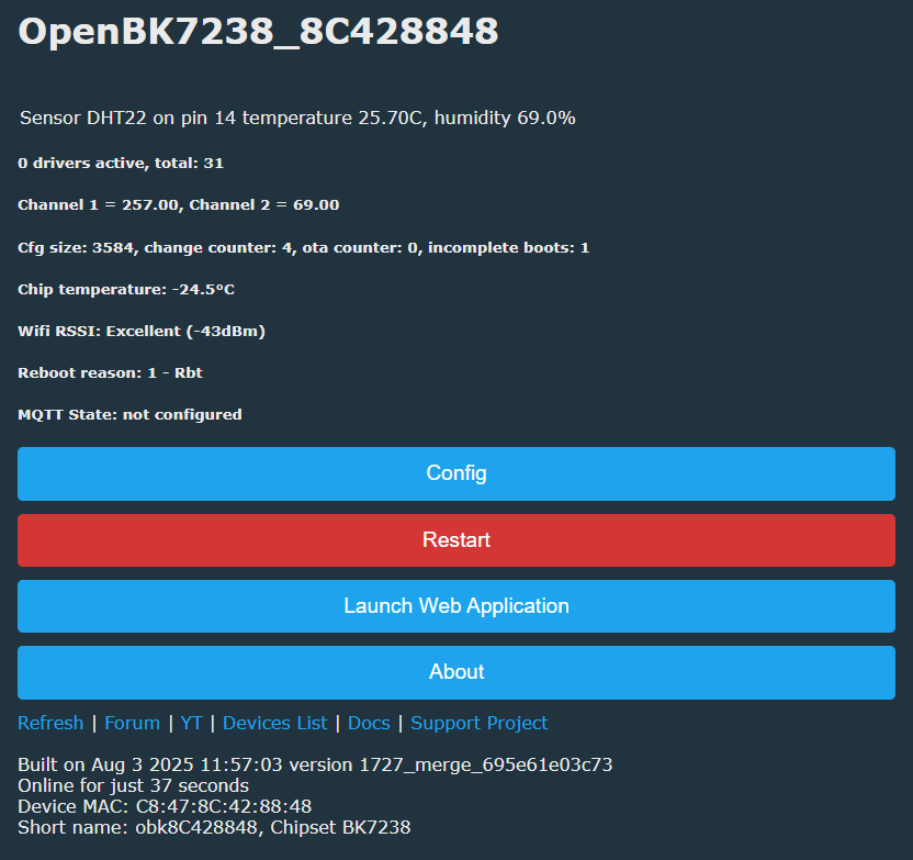

  • #104 21624810
    Posts: 5065
    Help: 438
    Rate: 893
    powersave 1
    OpenBK7238 interface showing chip temperature -24.5°C and DHT22 sensor readings
    chip temp isn't quite right on BK7238

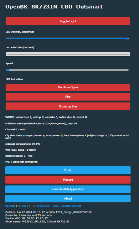

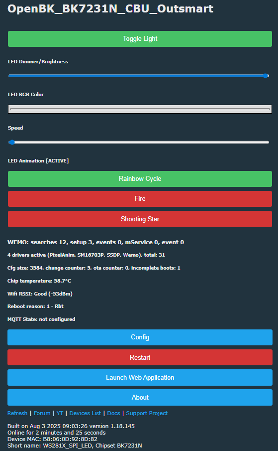

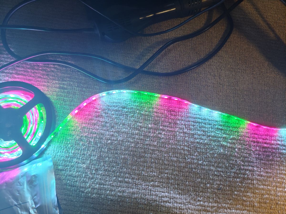

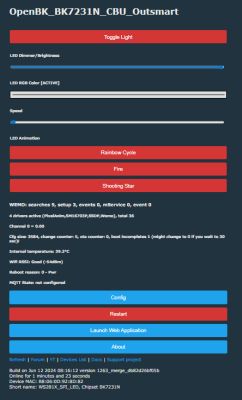

    insmod wrote:
    The only untested thing is spi on BK7231U/T_ALT and BK7238/N_ALT.
    dug this out
    LED control panel with RGB settings, animation modes, and system diagnostics
    4m/60 WS2812B. OTA to latest _ALT
    LED control panel with animations, RGB color, and system information display
    SPI/PixelAnim works but the colours are off. Less noticeable when the animation, especially rainbow, is running, but here's the starting RGB at power-on.
