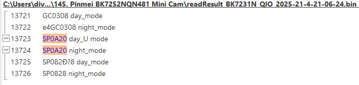

Mini 1080p wifi camera from Aliexpress, how to use without app (FtyCamPro)?
Wuppiduppi 73494 202
How can I use this AliExpress mini Wi‑Fi camera without the FtyCamPro app?

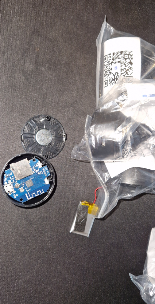

Open the case, identify the chip, and replace the vendor firmware with an open build; for TXW817-810 cameras the thread settled on OpenTXW81X, flashed with a C-SKY/CK-Link style programmer via an STM32F103 “blue pill,” after first making a backup of the original flash. [#20946151] [#20946175] [#20946214] After flashing, the camera creates its own AP (typically 192.168.4.1); connect to it in the browser, set your Wi‑Fi settings, and start the stream with `startdriver TXWCAM`. [#21645812] [#21645938] The live feed is then available as RTSP at `rtsp://{ip}:7070/webcam`, and at least one user confirmed the camera sensor worked with the open firmware. [#21695014] [#21645946] If your board turns out to be the BK7252UQN48 variant instead, there is a separate open firmware project for that chip. [#20946175] [#20946214]
    Linux flashing via XuanTie DebugServer

    d1nuc0m wrote:
    Thanks, I'll try it ASAP, my Windows box is KO actually... Is it somehow possible to flash these chips under Linux? (Just a small hope, I know it's closed hw+source)
    I only see a Windows version of C-SKY Flash Programmer, but the XuanTie DebugServer should be able to do it too - command line though. I've done a backup/flash before with it I think but don't see a record of it.
    Here can be seen debug server use example https://www.elektroda.com/rtvforum/topic4120455.html#21643718
    • XuanTie-DebugServer-linux-x86_64-V5.18.5-20250612.sh.tar.gz (2.33 MB) You must be logged in to download this attachment.
  • Boot log shows flash erase and rewrite cycle

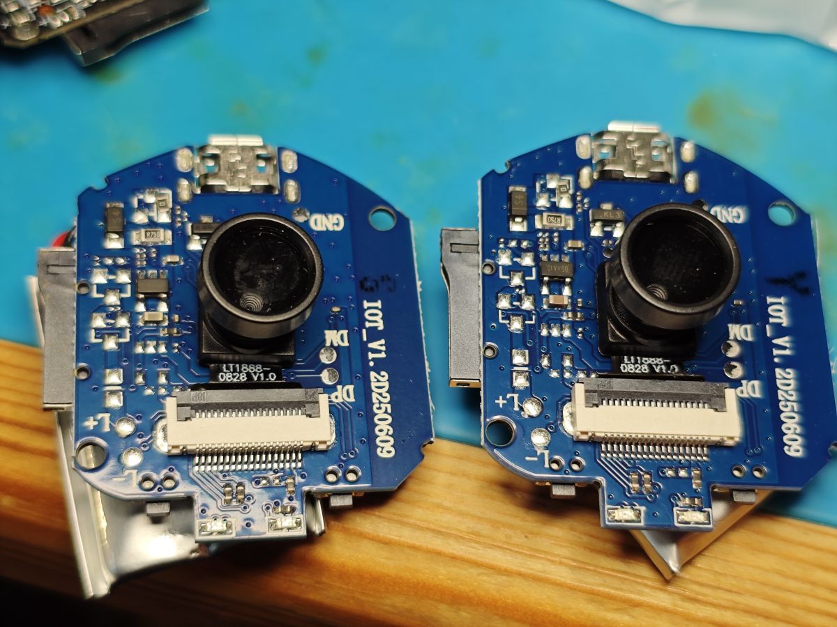

    Boot log from IOT_v1.2 D250609 from DP pin

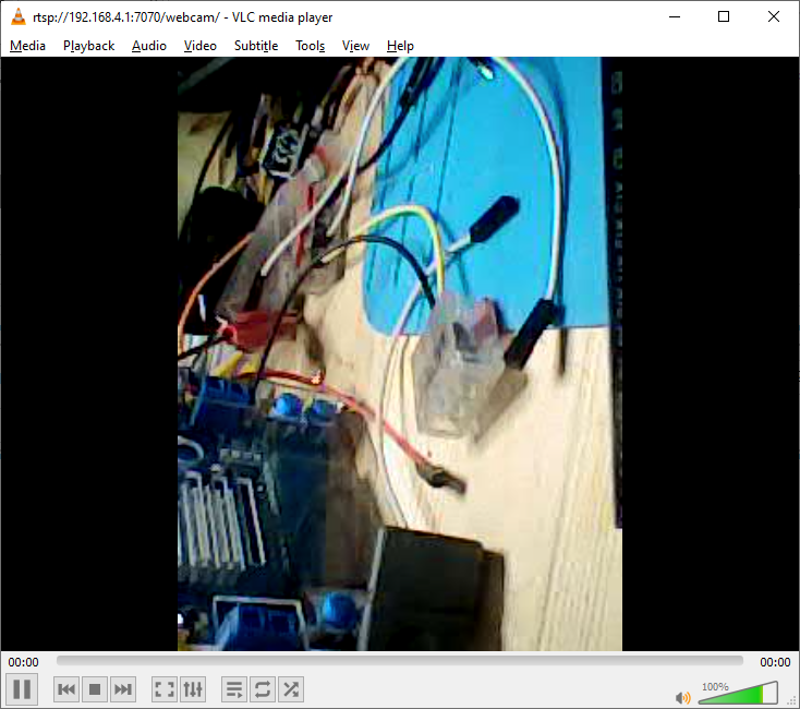

    [30]erase flash, 1 sectors ...
    [34]write flash, 512 bytes ...
    [37]verify flash ... OK

    [59]main:384 ------------------TX817_D firmware version:TXW817_D_V1.0.0.10 -----------------!!!!!

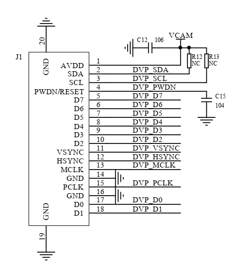

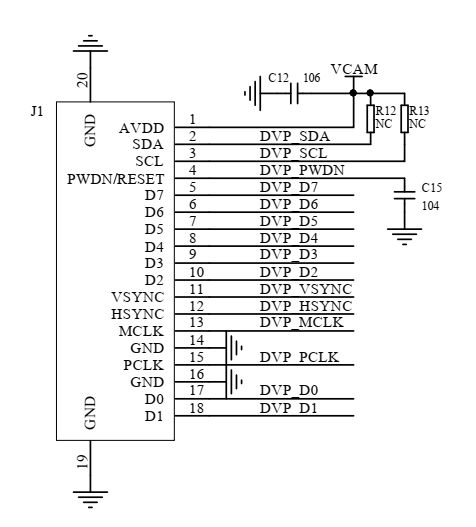

    [102]csi_test start,iic init
    [104]iic init finish,sensor reset & set sensor clk into 6M
    hgdvp_set_baudrate:clock:480000000
    mate:clock:480000000
     Check sensor id

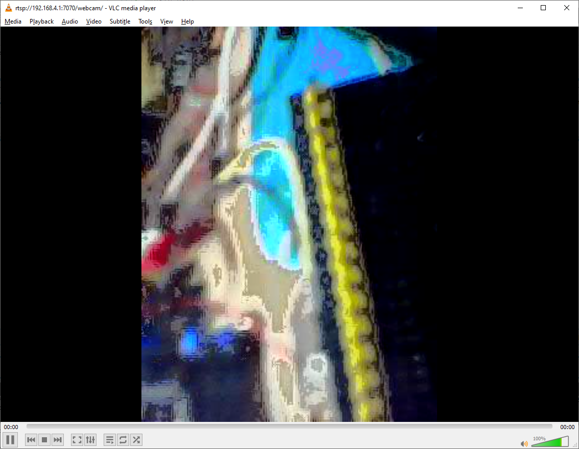

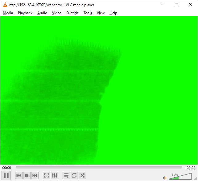

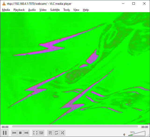

    [119]sensorCheckId:1035 -----read addr:00, read id:ff, sensor id:9B!!!!!
    [126]sensorCheckId:1035 -----read addr:00, read id:ff, sensor id:A0!!!!!
    [132]sensorCheckId:1035 -----read addr:fffffff0, read id:ff, sensor id:BB!!!!!
    [140]sensorCheckId:1035 -----read addr:fffffff1, read id:ff, sensor id:10!!!!!
    [147]sensorCheckId:1035 -----read addr:02, read id:0c, sensor id:0C!!!!!
    [153]id =c num:4
    [155]Auto Check sensor id finish
    [158]mclk:24000000MHz
    [163]init:180655a0 u8Addrbytnum:1,u8Databytnum:1
    [167]SENSER....init
     byt[237]init table num:444
    [239]SENSR ident ok:240*320

    [287]hardware_init:176 ------------------ sensor init ok -----------------!!!!!

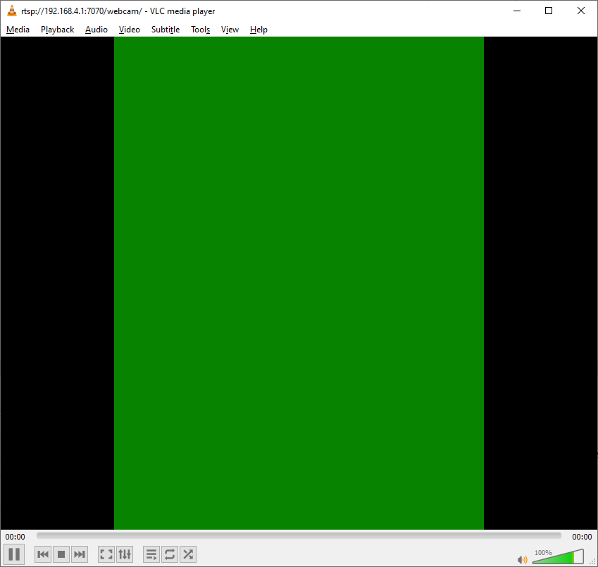

    port:7070   fd:3
    [2925]set_video_track:364
    [2928]set_video_track source->track[t]:0   rtp:20027F64

  • SP0828 still not outputting after SDK changes
    #154 21704529
    insmod
    Posts: 1432
    Help: 168
    Rate: 455
    @divadiow
    Flash programmer messed something up, and first 0x10000 of flash was erased before i succeeded at taking a backup.
    Btw, how did you get SP0828 to output anything?
    With your changes imported on top of my SDK, i get
    hgdvp_close...............................................................
    [53031]fv
    [53031]sip reset DVP
    I tried with and without dvp_set_exchange_d5_d6 and dvp_set_size
  • 24 MHz sensor init works, 6 MHz still unexplained

    Posts: 5202
    Help: 446
    Rate: 914
    looks like I have it now anyway

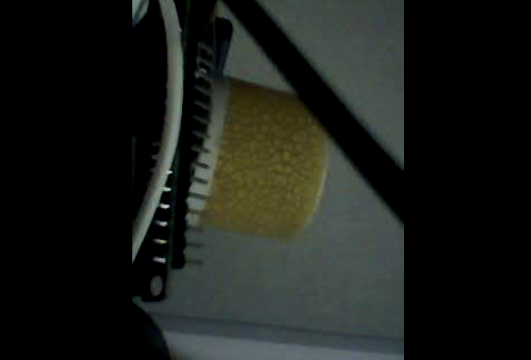

  • #158 21704601
    insmod
    Posts: 1432
    Help: 168
    Rate: 455
    I got normal image
    • sensor_sp0828.c (4.54 KB) You must be logged in to download this attachment.
  • #159 21704605
    Posts: 5202
    Help: 446
    Rate: 914
    ha! very good very good. building now
    Added after 8 [minutes]:
    there's colour at least. I'll try other SP0828. does yours look better?
  • #160 21704630
    insmod
    Posts: 1432
    Help: 168
    Rate: 455
    >>21704605
    Mine looks as any other camera and no colour problems.

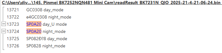

  • SP0a20 sensor identified on TXW camera
    #166 21711021
    Posts: 5202
    Help: 446
    Rate: 914
    oh. I have a sensor we don't have driver for on TXW
    will try to make
  • #168 21711104
    Posts: 5202
    Help: 446
    Rate: 914
    >>21711099
    cheers. it's 2B
    no support in XF16 dumps. but it is seen in Pinmei BK7252N
    List of image sensor modes labeled SP0A20, GC0308, and SP0828
  • #171 21713677
    insmod
    Posts: 1432
    Help: 168
    Rate: 455
    >>21713664
    Where did you get that init table though?
    Logic analyzer?
    Why not from link i posted earlier?
  • #172 21713680
    Posts: 5202
    Help: 446
    Rate: 914
    I couldn't get anything out of that table from GitHub, but maybe I don't understand how much of it needs to be used.
    The one giving green in link if from pinmei dump. Or should be. So many tries.
    Added after 4 [minutes]:
    I'll focus on that GH table solely in next try
  • Firmware init table may reveal I2C sensor commands
    #173 21713902
    Posts: 14750
    Rate: 12866
    Init table determines what is sent via I2C, it could be captured from a hardware.
    Code: C / C++
    Interestingly enough they have a marker for making a delay.
    Added after 53 [seconds]:
    Maybe we could search for those tables in firmware dump?
  • #174 21713918
    Posts: 5202
    Help: 446
    Rate: 914
    yeh. have done that. it's in a few. I'm not quite nailing SOMETHING. It's either no image or green/magenta
    a few tries this morning - copies of or variations on the github driver linked above: https://github.com/divadiow/txw81xcam/commits/opentxw81x_2/
    TXW817 sensor ID and audio noise logs
    #175 21714856
    Posts: 5202
    Help: 446
    Rate: 914
    the 722 pairs from TXW817 A9_HQT6_V3.0_D250305_(GreenPCB)_White_Case.bin
    🚨audio noisy🚨
    https://github.com/divadiow/txw81xcam/blob/af...1be0da/sdk/lib/bus/iic/sensor/sensor_sp0a20.c
    Added after 9 [hours] 17 [minutes]:
    https://github.com/NonPIayerCharacter/OpenTXW81X/pull/2

    Camera connector circuit diagram with DVP signals and VCAM power
    • TXW817-810_IPC DEMO V1.0_20230928.pdf (83.33 KB) You must be logged in to download this attachment.
