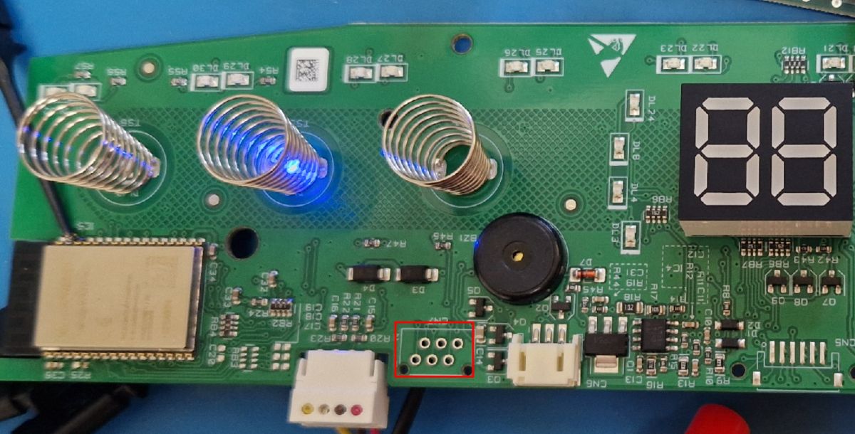

    By the way, I wonder what it is:
    PCB section with coils, LED display, and solder pads highlighted in red box .
    Looks like the leads under the connector.
  • #32 21721082
    Przemcio
    Posts: 2419
    Help: 196
    Rate: 257
    Not far away is the CN5 - under probably an FFC connector for a fussy display
    future-proof. If there is Wi-Fi you will be able to YT yourself on the heater ;) .

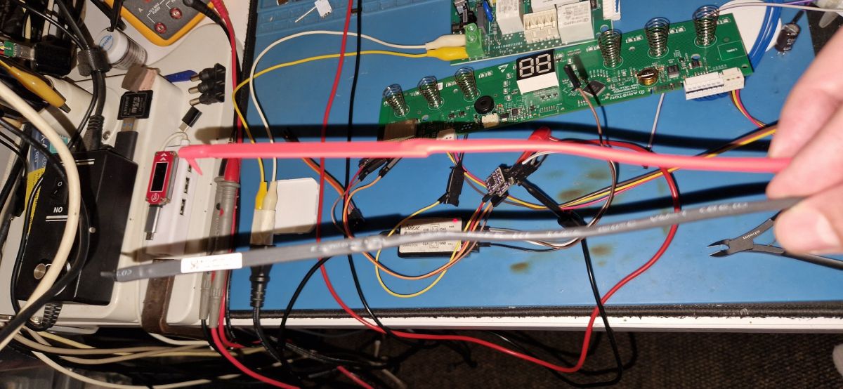

    There are 2 sensors connected to the MCU board, one is on the cold intake tank and the other is in the warm or outlet tank, probably something to do with shower count feature (maybe)
    Close-up of electronics workbench with PCB board, wires, and testing probes
    Also there appears to be some some sort of a clock transmitted between MCU and WiFi module as there an RTC crystal and backup battery (super cap) on board, so that will probably make our life easier in decoding the signal structure.
    Main thing for me is to decode the intermediate frames as I can then focus on the actual commands as the buss is supper chatty and I have to filter that communication out first.

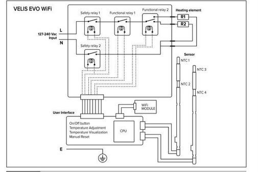

    Wiring diagram of Velis EVO WiFi heater with relays and temperature sensors .
    >>21721427 The diagram shows two sensors per tank and interchangeable heater switching. That is, it probably heats the output tank first and then the input tank. Dale is probably already choosing which heater to heat depending on the temperature drop in the individual tanks.
    I assume that, depending on the ΔTemperature, the controller is able to calculate the water flow through the tank and determine the appropriate operating algorithm in order to maintain a constant temperature at the outlet, which is effectively helped by two tanks and two heaters of 1.5kW each (switched interchangeably).

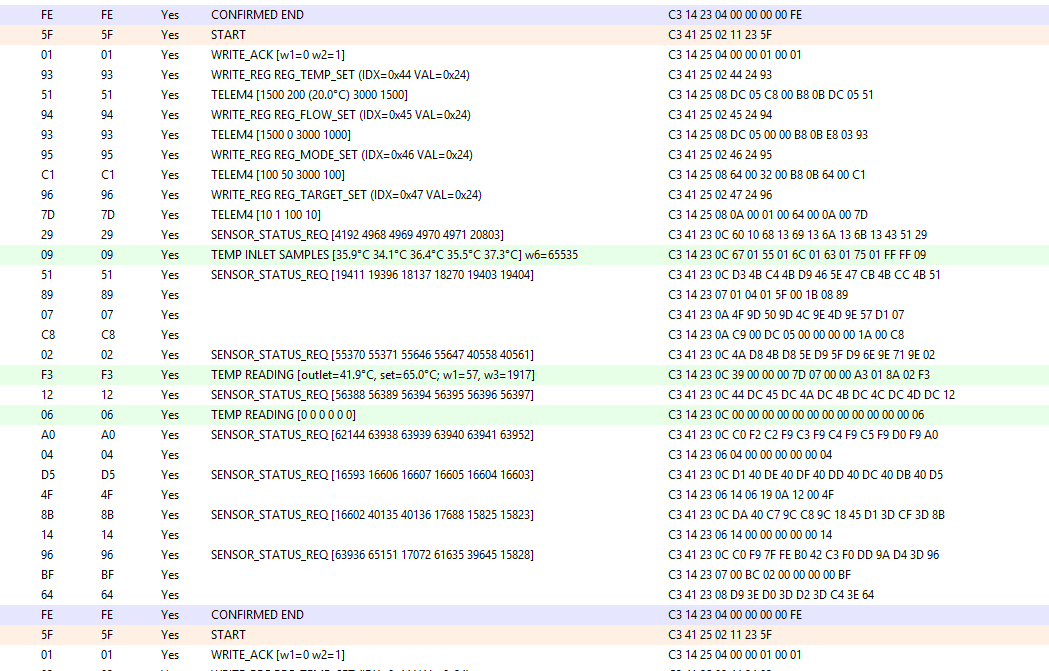

    Some progress on the decoding front... one reporting packet isolated with some values decoded.
    Capture of communication data in hexadecimal and decoded text format
    Managed to figure out inlet and outlet temperature readings and set temperature from the traffic... more to come as soon as some time is available.

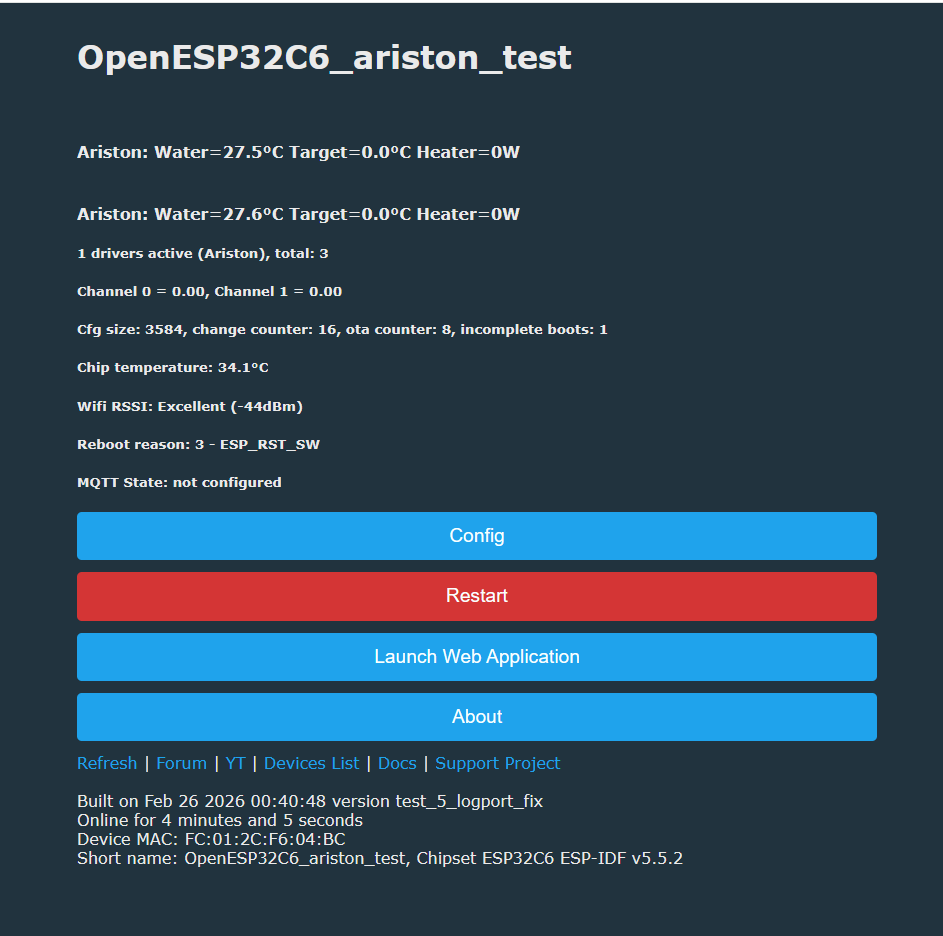

    clanfavorite
    >>21797570 I've started experimenting with my boiler. Have you had any success with the protocol?
  • #40 21800334
    DeDaMrAz
    Posts: 621
    Help: 34
    Rate: 130
    @clanfavorite
    I am creating a remote logger based on RPi Zero W to log the traffic when I mount the boiler as I can't simulate all the data on the table. Protocol is somewhat simple but is supper chatty and requires lot of work. So far I managed to get the temperature reporting from the MCU and 1 or 2 commands but it's a chore - will require more time...
  • #41 21800348
    Posts: 14770
    Rate: 12913
    @clanfavorite can you share information about your Ariston, some photos, maybe protocol capture?

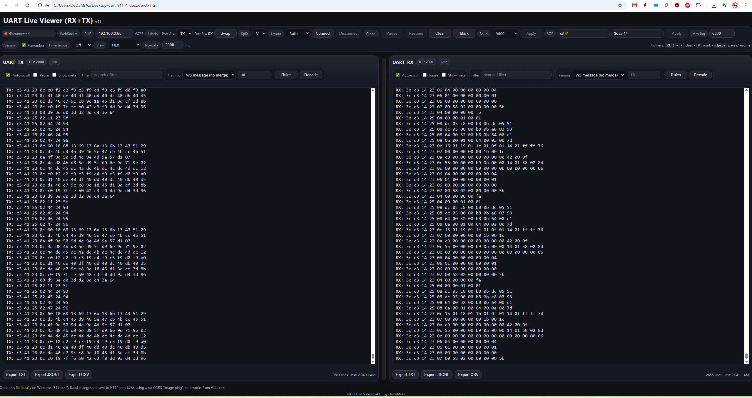

    Screenshot of UART Live Viewer software showing RX and TX data in HEX format.
    Final version of the RPi Zero W image will be uploaded soon together with wiring diagram and the HTML logger that works locally (not a server)....
    Weird timing issues should be resolved but I'd like to test it first on my own HW first and only then will I post everything.
    If anybody wishes to use this prerequisites are - RPi Zero W and CH342 board attached to OTG port and optionally ADUM1200 for isolation.

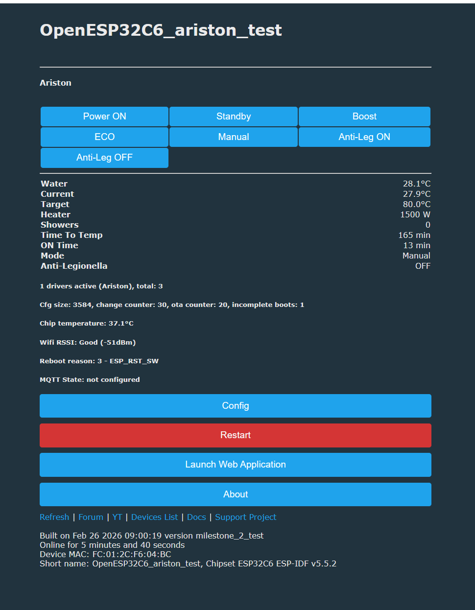

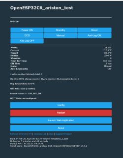

    #47 21804926
    DeDaMrAz
    Posts: 621
    Help: 34
    Rate: 130
    I got a descent amount of data decoded, still working on verifying it but what I have for sure now are
    - power toggle
    - temp change (set temperature)
    - reading current temp value (value on the appliance screen)
    - reading set value
    - reading from both temperature probes (inlet tank - outlet tank)
    - time to set temp
    - number of showers counter
    - at least one heater state
    More to come....
    Figured I need to provide example:
    C3 41 33 04 79 2D B2 02 95 -> set temp command
    broken down it looks like this:
    C3 41 -> frame header
    33 -> WiFi CMD designator
    04 -> data length
    79 2D -> set/change temperature command
    b2 02 -> u16 based LE temp/10 -> 2b2/10=69.0
    95 -> checksum

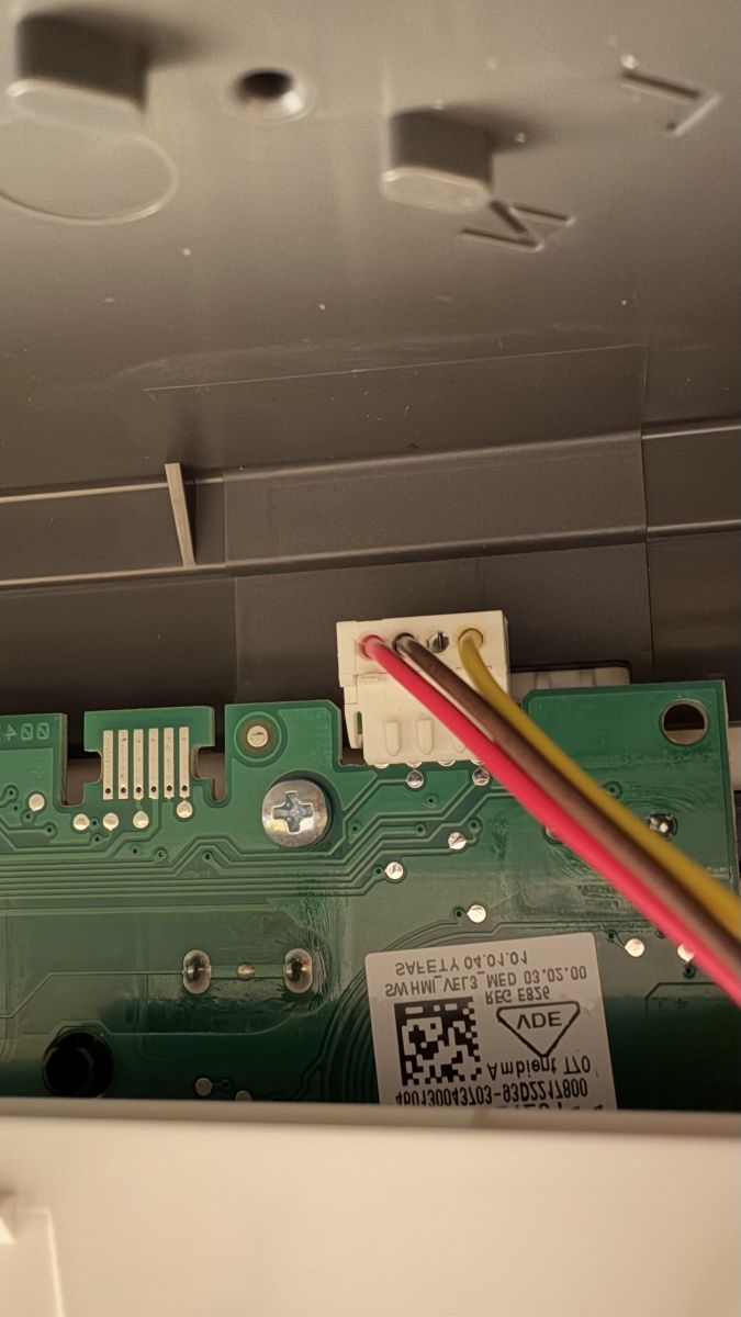

  • Suggests the non-Wi‑Fi Velis board may share the same serial interface
    #48 21847065
    n1bs
    Level 4  

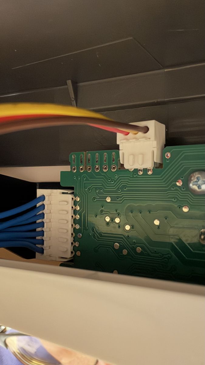

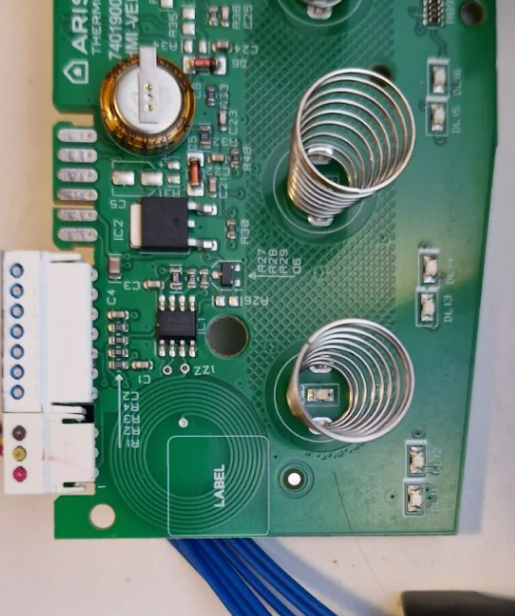

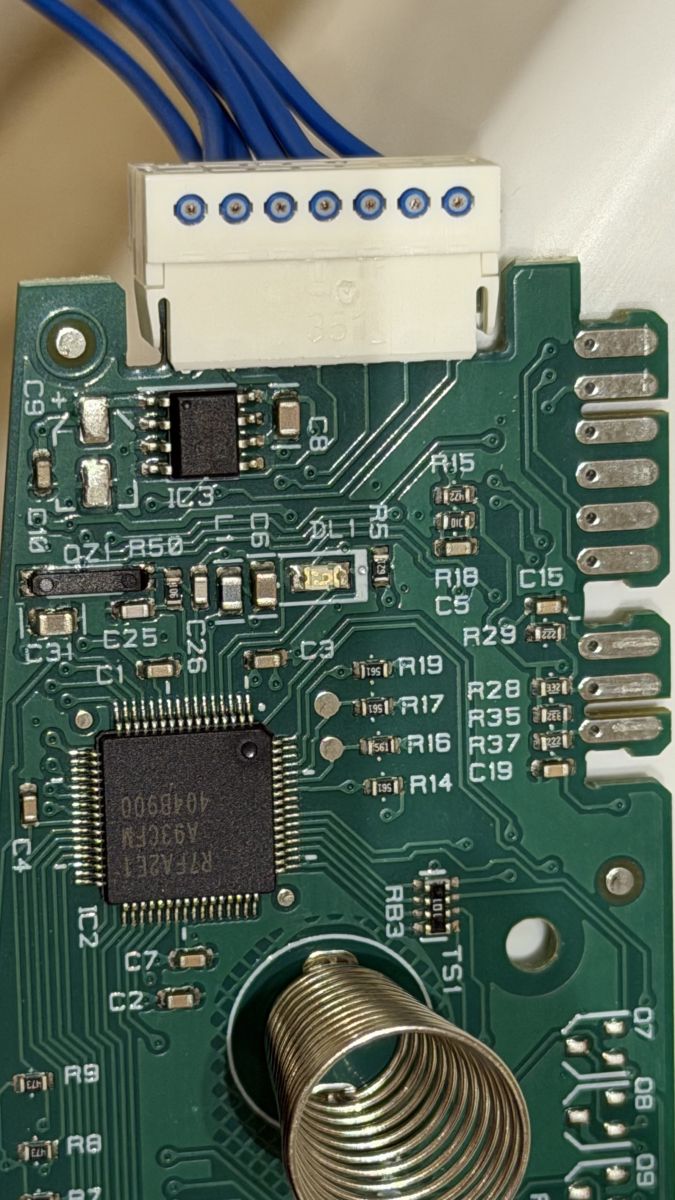

    Posts: 8
    >>21804926 Hello! Thank you very much for all your hard work! It's amazing how modern technologies can work for good things... and not good - dedicated closed clouds / separate app for each device in your home....
    I found this thread when was looking for potential automation for my boiler VELIS PRO 50 EU. This one has no wifi, and it's very different from past generation - boards are now split into "brain" and "power switches/relays". This boiler (NO WIFI) has pretty similar sensor board with 4 buttons and 2 indicators, same CPU and almost same sockets - just little bit different location.
    I suspect that this serial interface can be the same (and firmware internally should be the same), and I hope it can be present on 2 "unused" sockets :
    Close-up of a PCB with a connector and three wires: red, brown, and yellow. Close-up of a PCB with white connectors and colored wires inside a device housing Close-up of a PCB with ICs, a white connector, blue wires, and a metal coil spring
    Looking at MCU - pins 9/10 are hidden, so I will need to trace them tomorrow, or can just solder into these pins directly to see if any traffic is happening there.
    Maybe you have some working script to set temperature (or read it directly) through this serial port ? I see your commands/dumps and will probably write up some quick and dirty script to verify if it's possible to get any data from my version of mainboard, but if you already have something working - would appreciate to see example.
    I have analyzer / spare esp32 / orange pis / etc / bunch of usb-ttl converters to play.
    Hope to give some good news tomorrow!

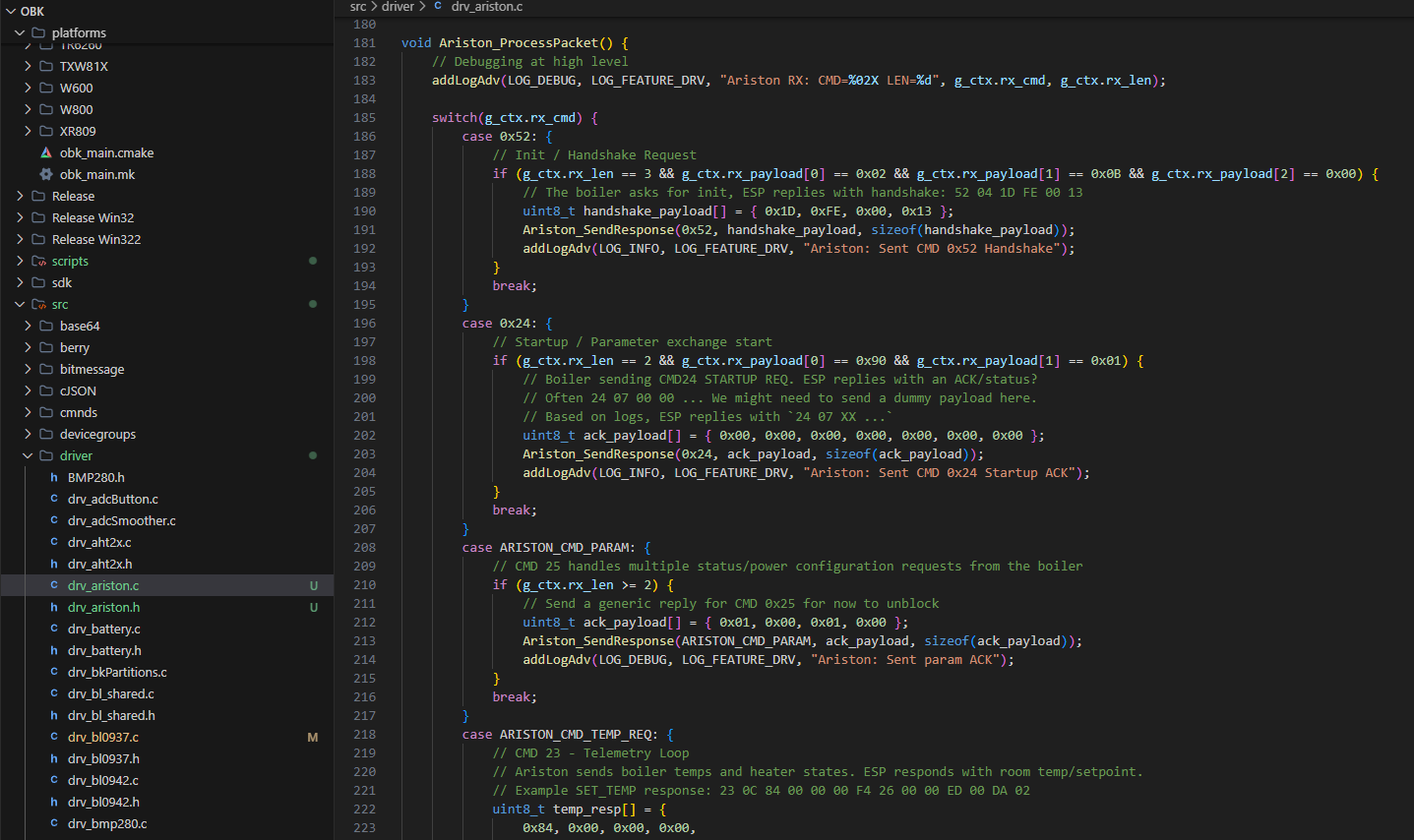

    And I just now started writing the driver for OBK, literally this moment 😁
    Welcome to the party I guess. Form your pictures I don't see the entire board but what you can do is use your phone, power up NFC and bring it close to the board (usually near the edges) and read the NFC tag form it, that will tell you if that MCU has WiFi "talking capabilities".
  • Empty connectors may expose MCU pins 9/10 or UART

    >>21847071 I'm pretty sure that it will not expose wifi through NFC info since there is no such device attached, and firmware would most probably pretend "as empty as possible".
    I'll open up case once again tomorrow to verify if these 2 empty connectors can be connected to MCU pins 9/10. I keep hope that one of these two ports would be service port for official diagnostic tools, and there must be UART exposed as well :)

    It's obvious from the capture that some of these values can be seen in the captured traffic but I am yet to corelate them and understand their meaning.
    See this post, even the older models have the NFC tag in them, I got "rubber buttons" one and a newer model with touch controls and both have the NFC in it and no wifi
    This is the content of mine, where "WIF" 1 is wifi "stack" is enabled and "MAC" and "WSN" are module related, look for that as the easiest "win".
    Added after 4 [minutes]:
    Screenshot of a code editor showing drv_ariston.c with a project tree on the left
    i will play around with the driver as soon as time permits but I at least started, still waiting for some HW to move on to real tests.

  • Custom ESP32 control board suggested for boiler integration
    #56 21848596
    n1bs
    Level 4  
    Posts: 8
    >>21847942 I'm starting to think that it can be worth to implement custom control board for this boiler and just leave power board on place. I love the idea to control native/certified pcb, but if that would be impossible or would require serious modification - it can be worth to just do custom board connected to esp32 and that would natively work with home assistant.
    Can't wait to hear your ideas :)
  • ESP replacement now reads Ariston heater telemetry

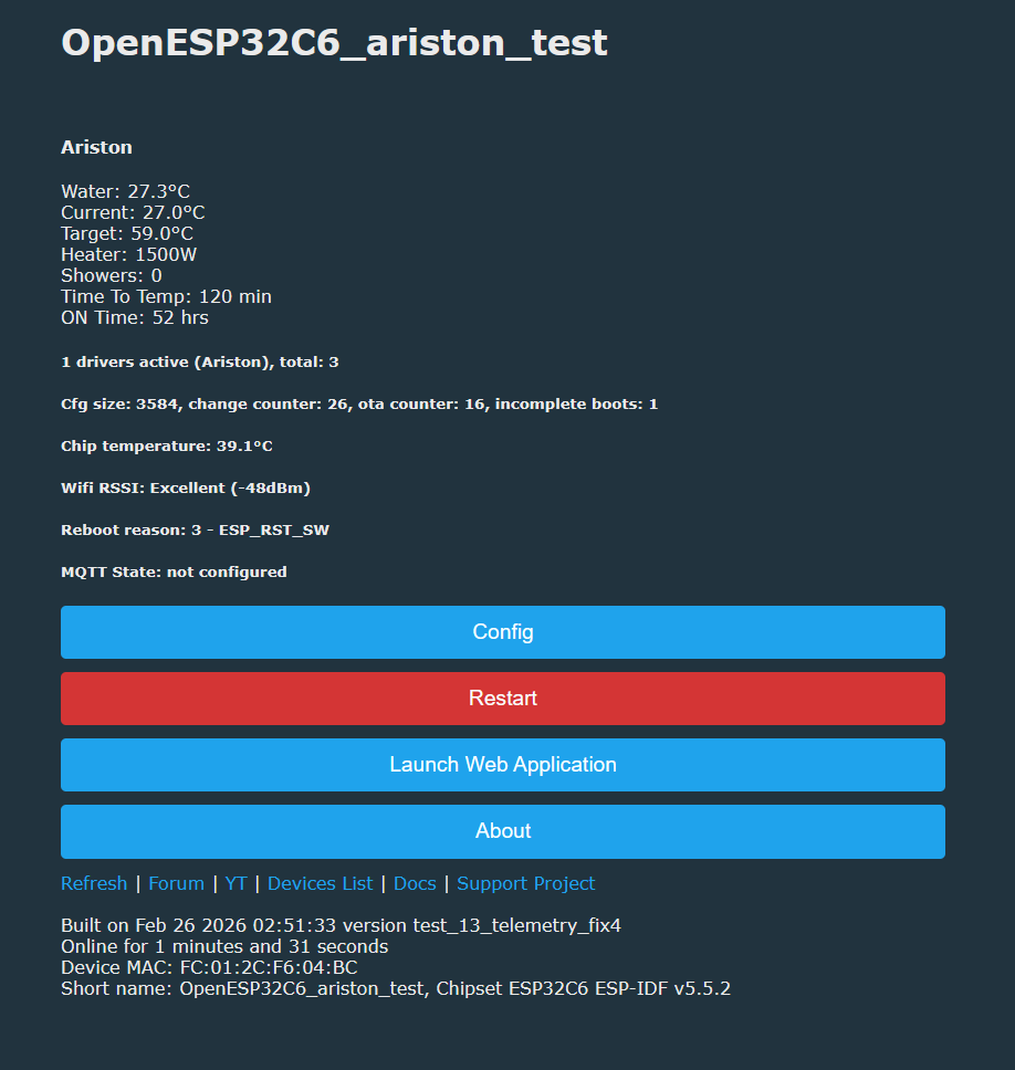

    #57 21848993
    DeDaMrAz
    Posts: 621
    Help: 34
    Rate: 130
    OpenESP32C6_ariston_test status screen with temperature readings, Wi‑Fi RSSI, and Config/Restart buttons
    Initial startup is done, onboard MCU now recognizes my ESP replacement and is giving me a basic reading.... to be continued...
    Screenshot of OpenESP32C6_ariston_test status page with temperature readings and Config/Restart buttons
    Info:CMD:[WebApp Cmd 'logfeature 1 0' Result] OK
    Info:DRV:Ariston: Target=59.0°C, Current=25.6°C
    Info:DRV:Ariston: Showers=0, TimeToTemp=120
    Info:DRV:Ariston: Heater power=1500W
    Info:DRV:Ariston: On Time=58
    Info:DRV:Ariston: Water temp=27.2°C
    Initial readings are working, next would be to get some actions in there and ON/OFF button for example... stay tuned...
    @insmod any particular reason logport change was not implemented in ESP as well as dual (concurrent) UART's?

  • #59 21849142
    DeDaMrAz
    Posts: 621
    Help: 34
    Rate: 130
    first iteration test
    Screenshot of OpenESP32C6_ariston_test dashboard with control buttons and temperature readouts
    Control plain is being implemented and tested now. UI test and commands work, what is left to do is just to polish the driver, figure out correct feature implementation and publish that to HA....
