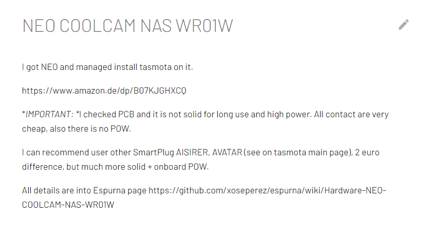

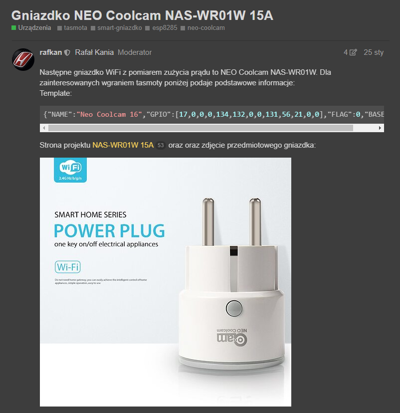

    On the internet you can read that these specific sockets are implemented on ESP8266.
    Socket plug with energy measurement NAS-WR01W and NAS-WR07W [BK7231/BL0937/BL094
    Unfortunately, that has already changed. The manufacturer switched to BK7231. According to their distributor, you can no longer order fresh portions of these sockets for ESP.

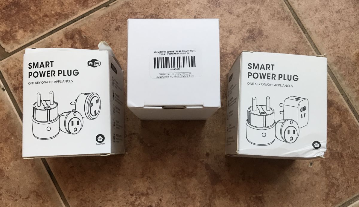

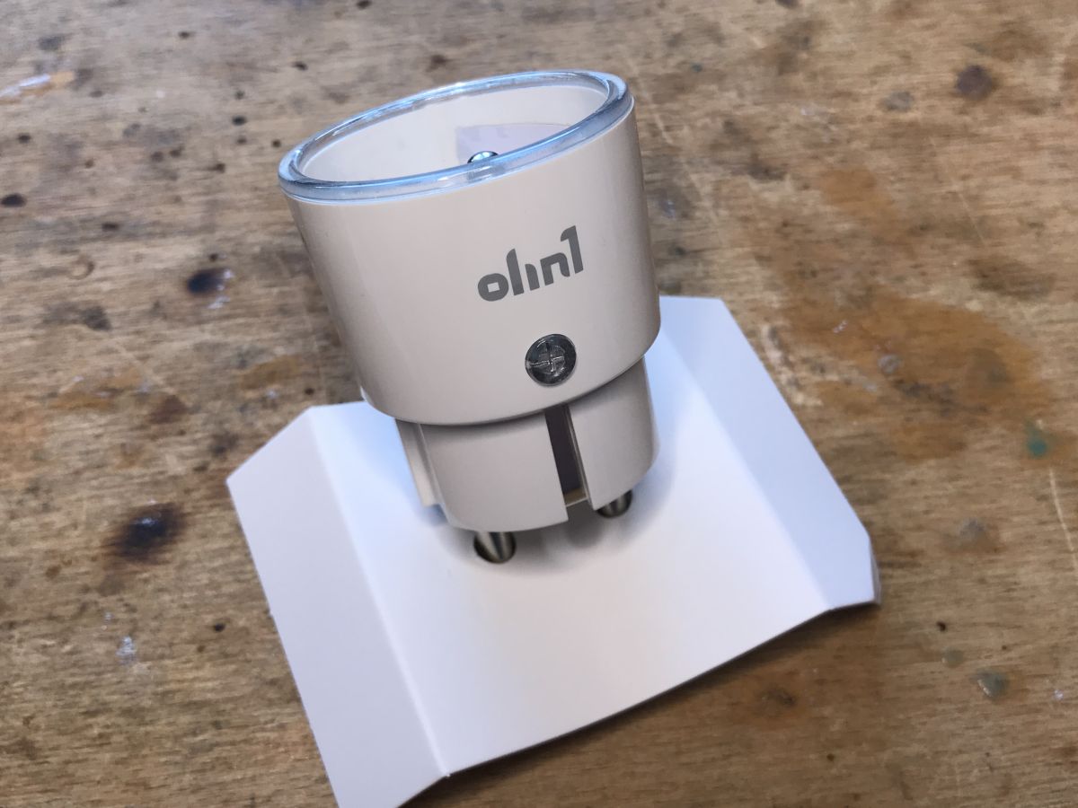

    This is what the set I got looks like (the third socket, Mycket PE-01E IP44, I will discuss another time):
    Socket plug with energy measurement NAS-WR01W and NAS-WR07W [BK7231/BL0937/BL094 Socket plug with energy measurement NAS-WR01W and NAS-WR07W [BK7231/BL0937/BL094

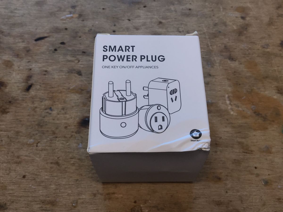

    First Packing:
    Socket plug with energy measurement NAS-WR01W and NAS-WR07W [BK7231/BL0937/BL094 Socket plug with energy measurement NAS-WR01W and NAS-WR07W [BK7231/BL0937/BL094 Socket plug with energy measurement NAS-WR01W and NAS-WR07W [BK7231/BL0937/BL094 Socket plug with energy measurement NAS-WR01W and NAS-WR07W [BK7231/BL0937/BL094 Socket plug with energy measurement NAS-WR01W and NAS-WR07W [BK7231/BL0937/BL094
    Contents:
    Instruction:
    The instruction of the second one is identical, so I omit it, as well as the tests with the Tuya/SmartLife app that have already been performed many times.

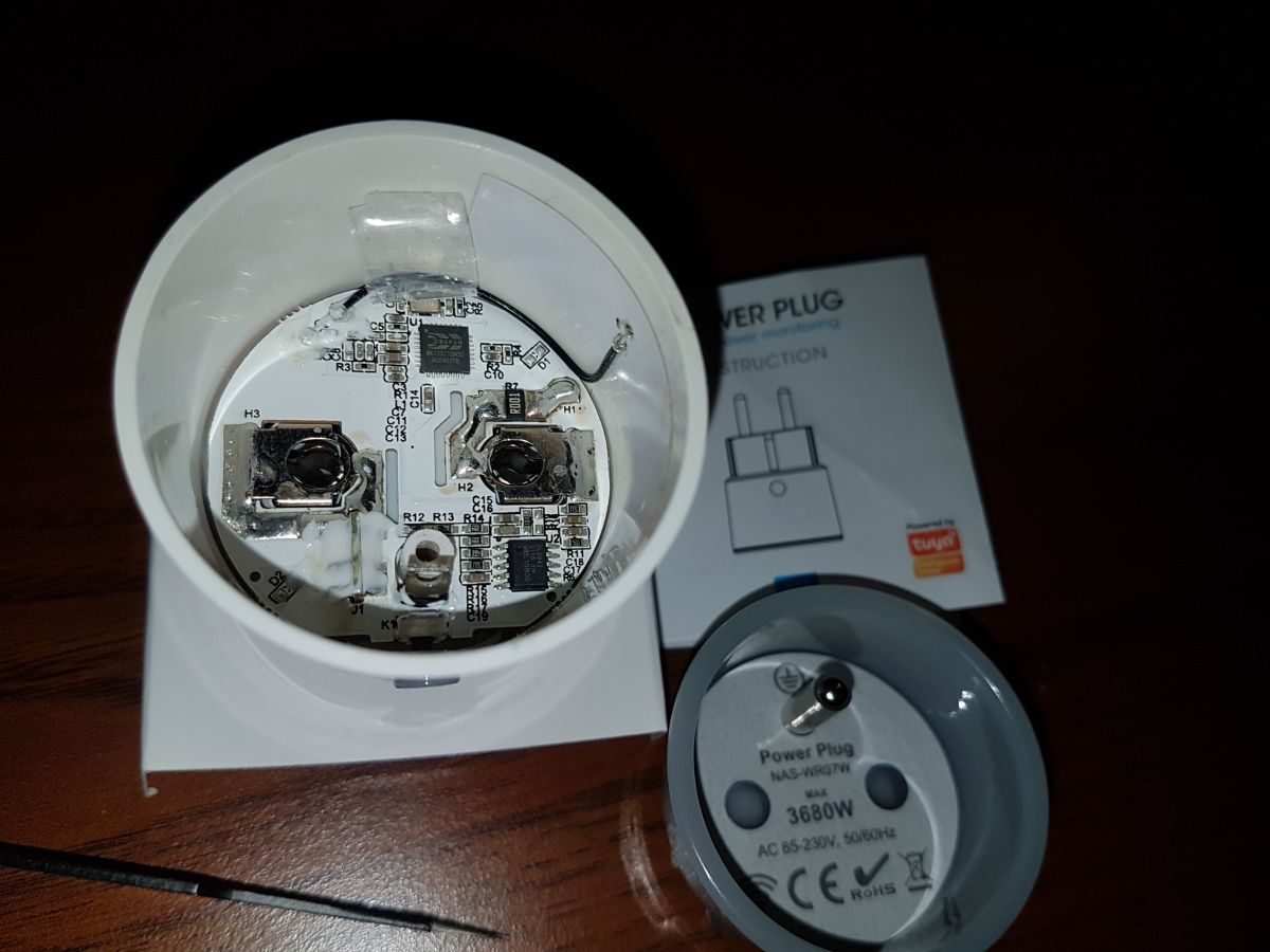

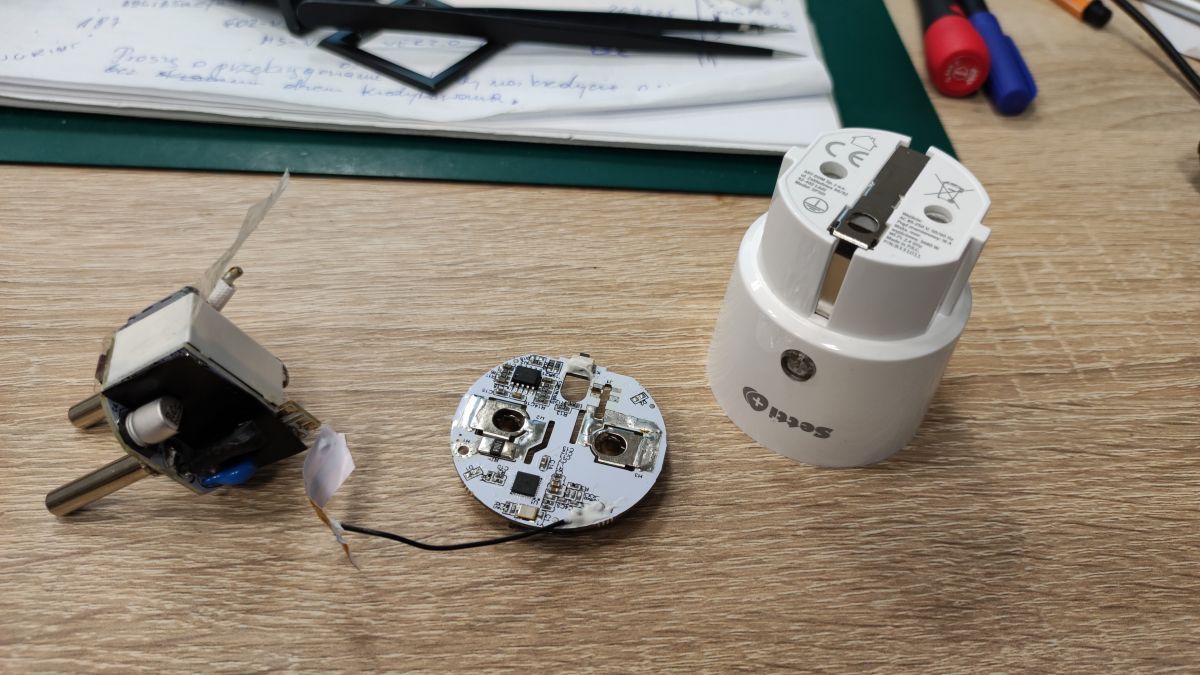

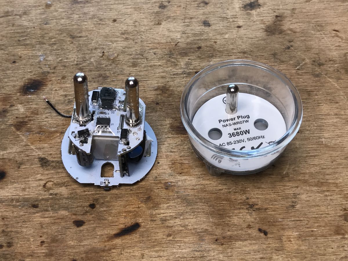

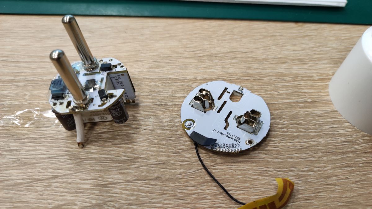

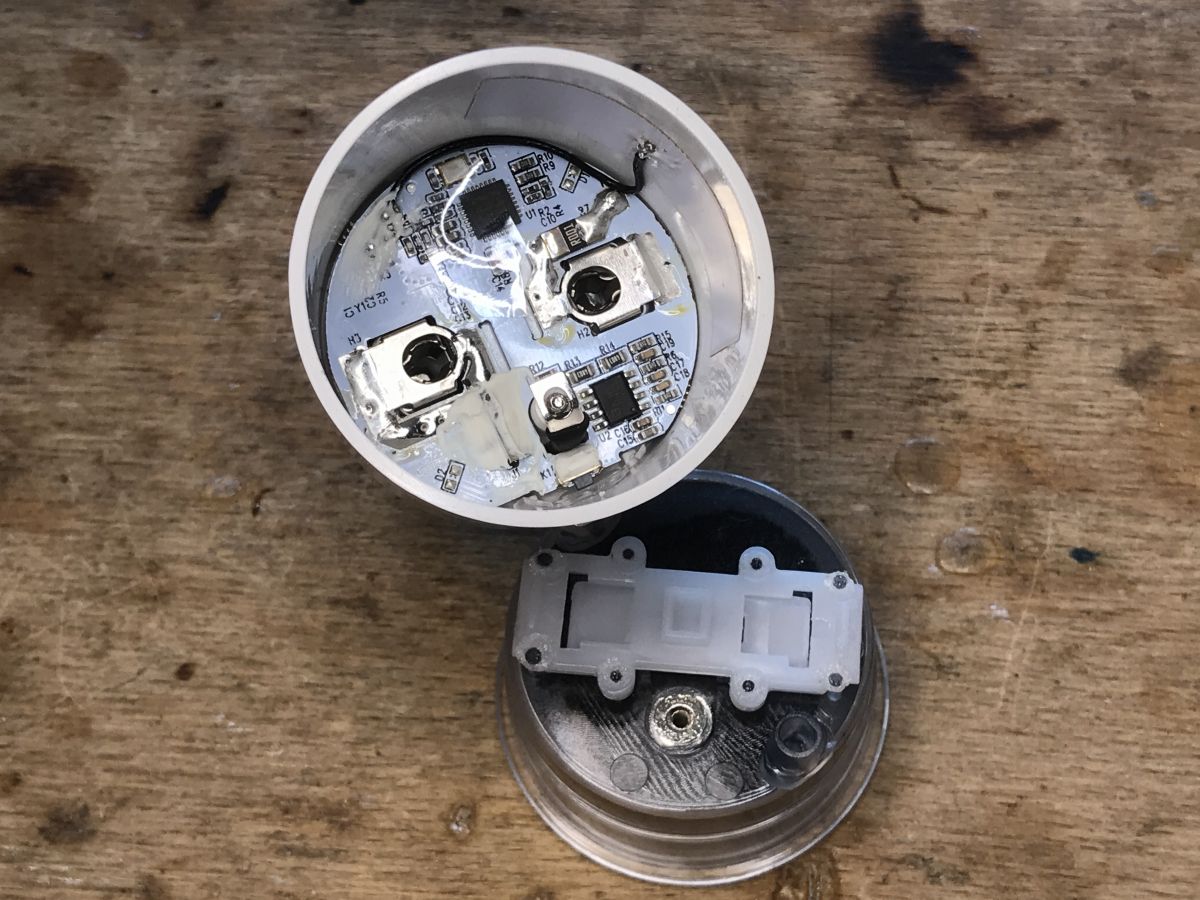

    The inside of the NAS-WR07W
    As in the BW-SHP6, you need to unscrew one hidden screw:

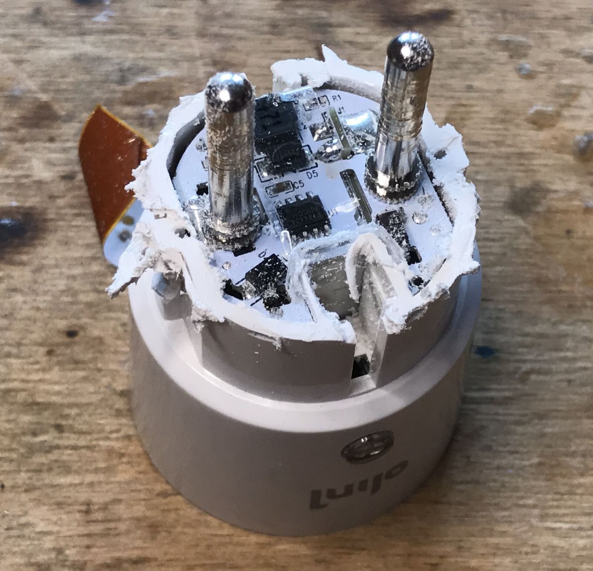

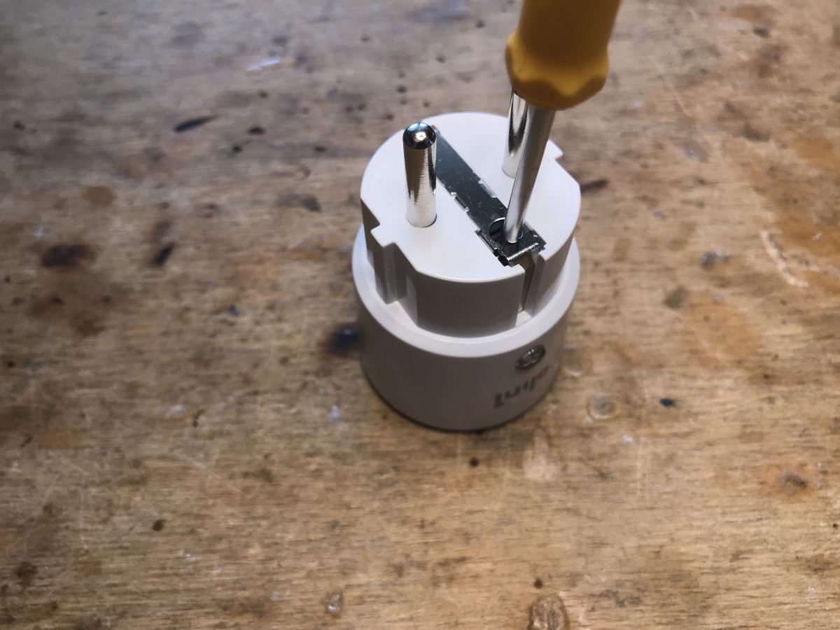

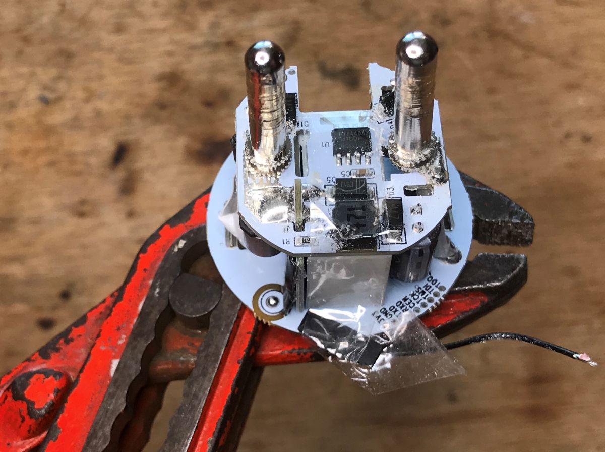

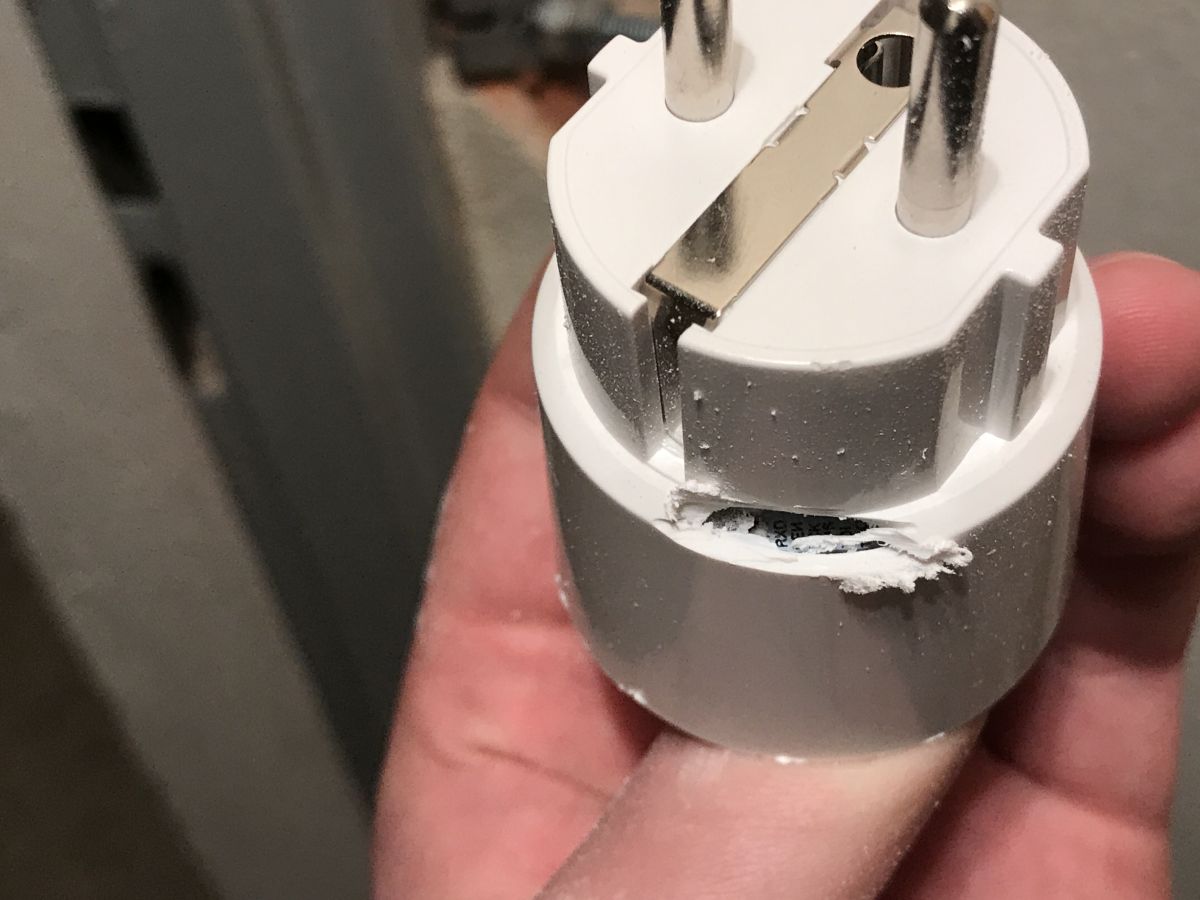

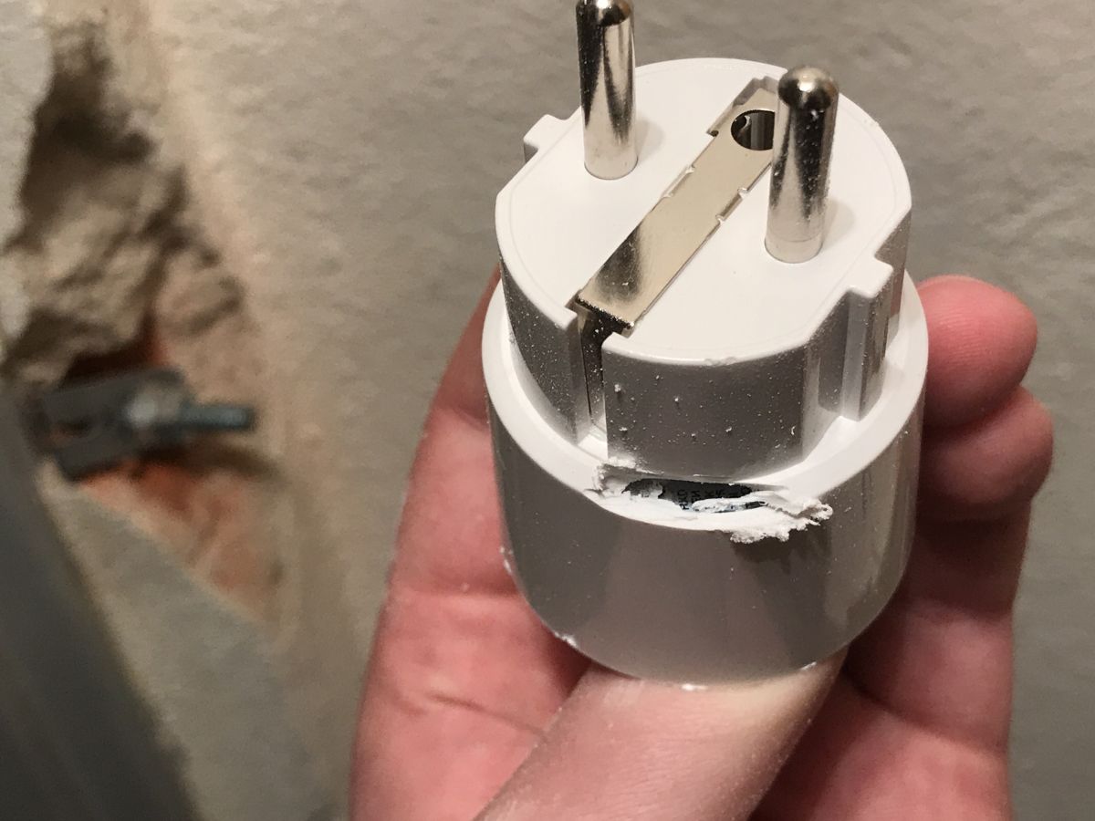

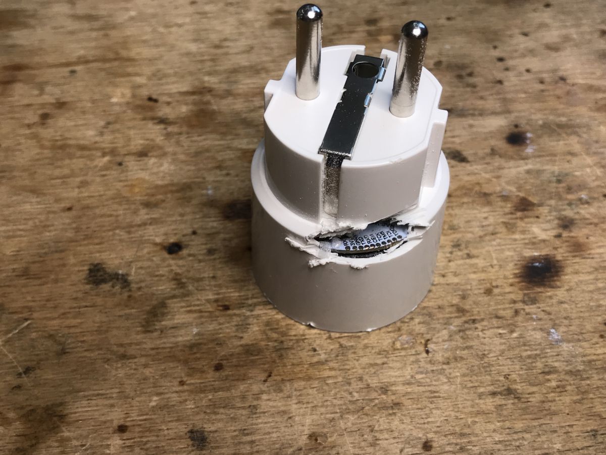

    Now it should be possible to remove the plate, but I had a serious problem with it. In this case, the pins of the plug blocked the possibility of removing the PCB. I decided to use the brute force method (later I will show a better way to physically connect the programmer, and there is also a tuya-cloudcutter to upload the batch via WiFi).
    I also tried unscrewing the pins, in vain.
    Finally, the mini-grinder went into action:
    Ready:

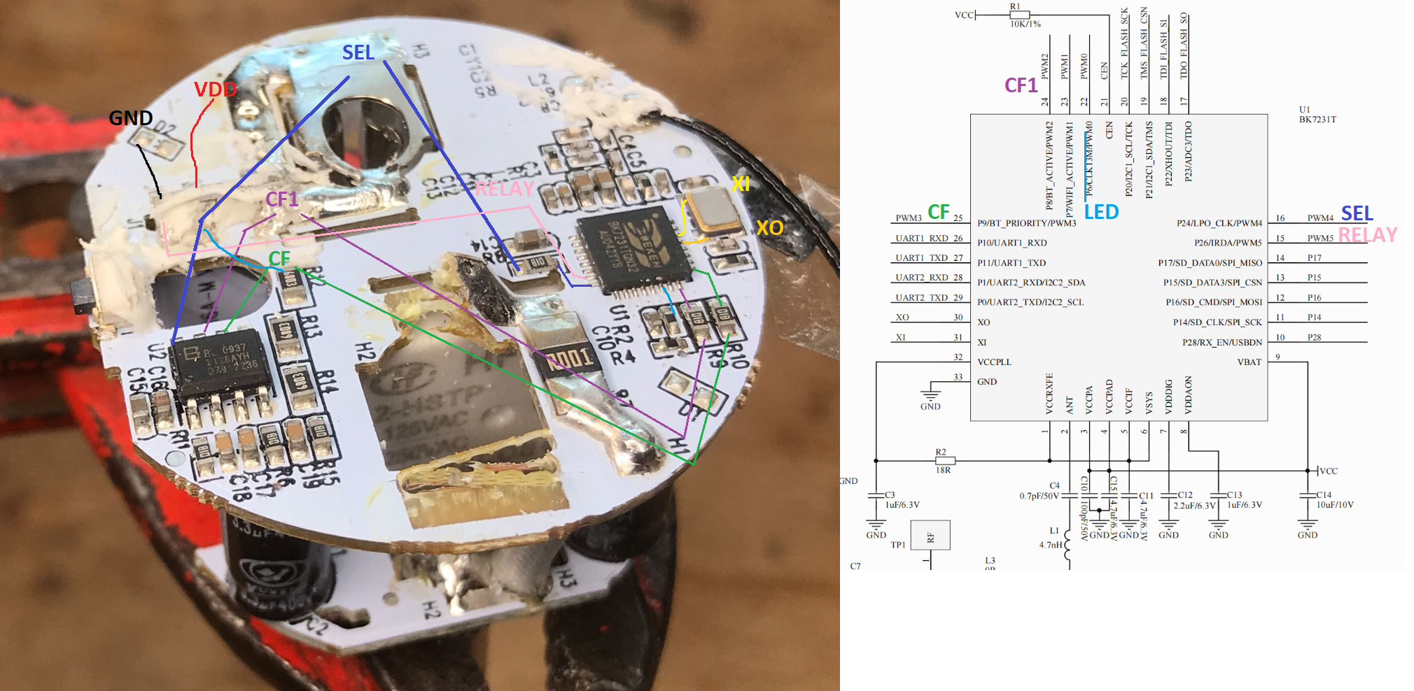

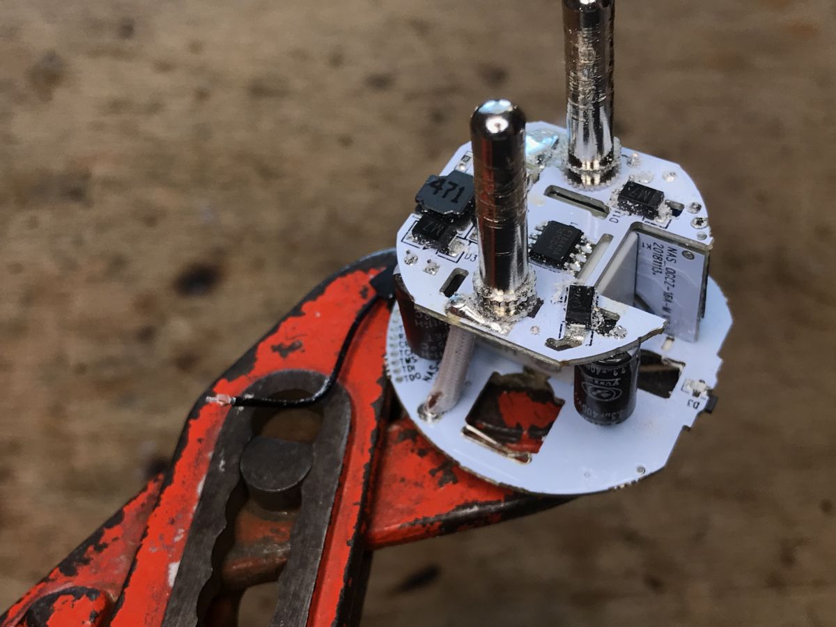

    You can see BK7231T and BL0937:
    (Yes,I know, the PCB was slightly damaged when opening)
    The BK7231T is directly on the PCB, not as a WB2S, WB3S or similar module.

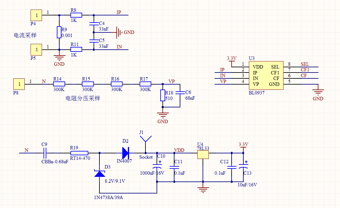

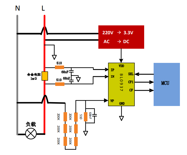

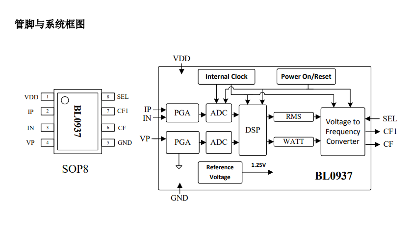

    BL0937 is an energy measurement system. It is identical to the already discussed BL0942, with the difference that BL0942 reports the results via UART, and BL0937 converts them to signals of a given frequency.
    The SEL pin selects the mode (voltage or current). Pin Cf is the frequency which represents the power. Pin Cf1 is either voltage or current selectable. To convert the resulting signals into actual numerical values, count the number of signals on a given pin per unit of time (preferably by interrupting) and multiply them by the calibration constant.

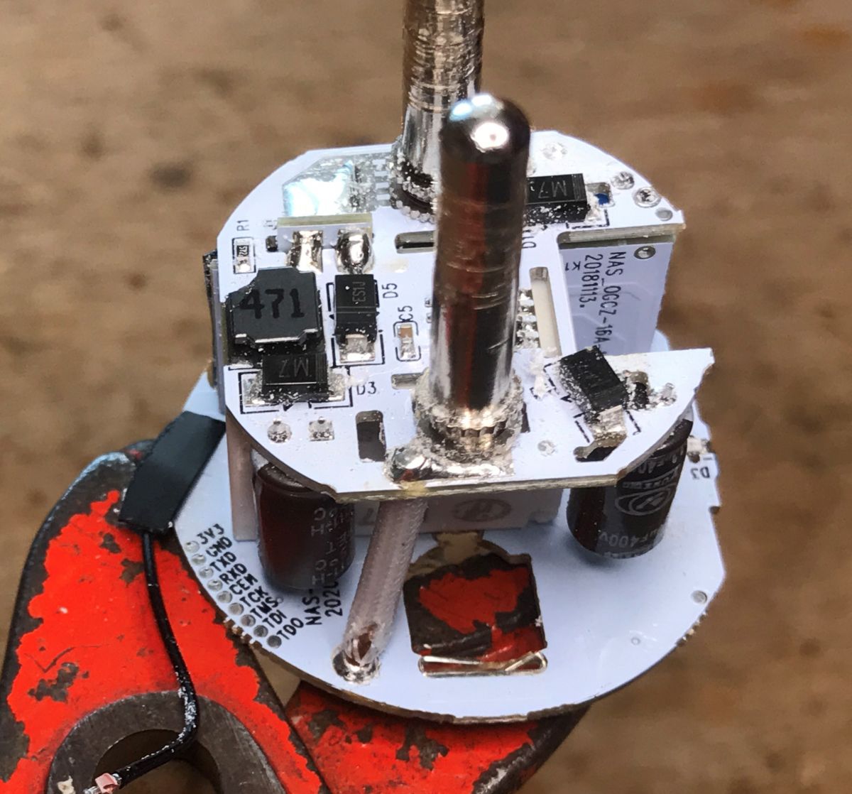

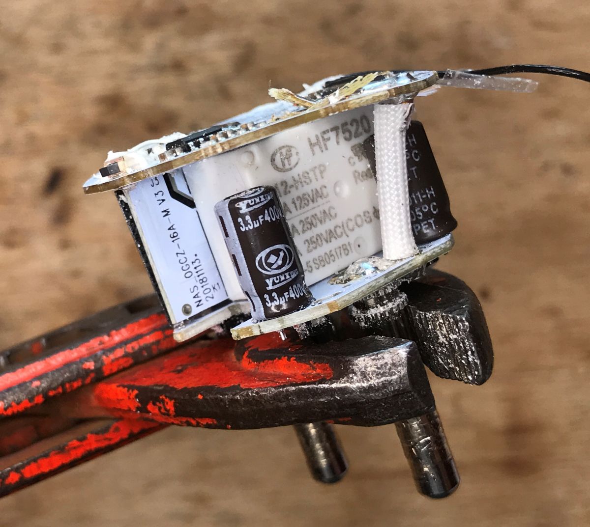

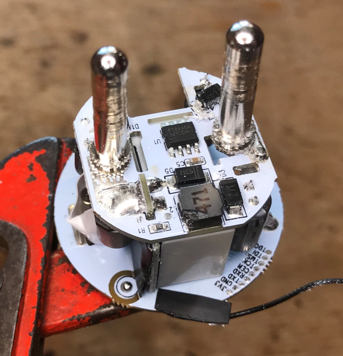

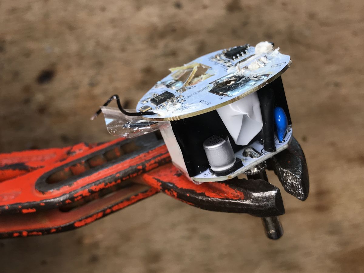

    Everything, including the relay, is cleverly packaged:
    The FT8440A is a transformerless power supply system. There is no flyback converter here, it is a buck converter (so there is also no galvanic isolation from the mains):
    ft8440/8441 is a high performance, high precision, low cost non-isolated buck power converter. it contains a dedicated current-mode pwm controller and a high-voltage power mosfet. the built-in error amplifier is optimized to ensure superior dynamic response. the high-precision internal divider resistor and reference voltage, and stable closed-loop feedback enable the ft8440/8441 to obtain a stable and high-precision output voltage within the full voltage input range.
    ft8440/8441 adopts ultra-high voltage technology with internally integrated high voltage start circuit, high voltage power mosfet switch, and current sampling resistor, which reduces external components and greatly simplifies system application. the built-in frequency jitter and soft drive design can effectively improve emi performance.
    the internal integrated functions also include: vcc under-voltage protection (uvlo), vcc over-voltage protection (ovp), over-temperature protection (otp), cycle-by-cycle over-current protection (ocp), output short-circuit protection (scp). the perfect protection function ensures the reliability of the system.
    The relay is HF7520.

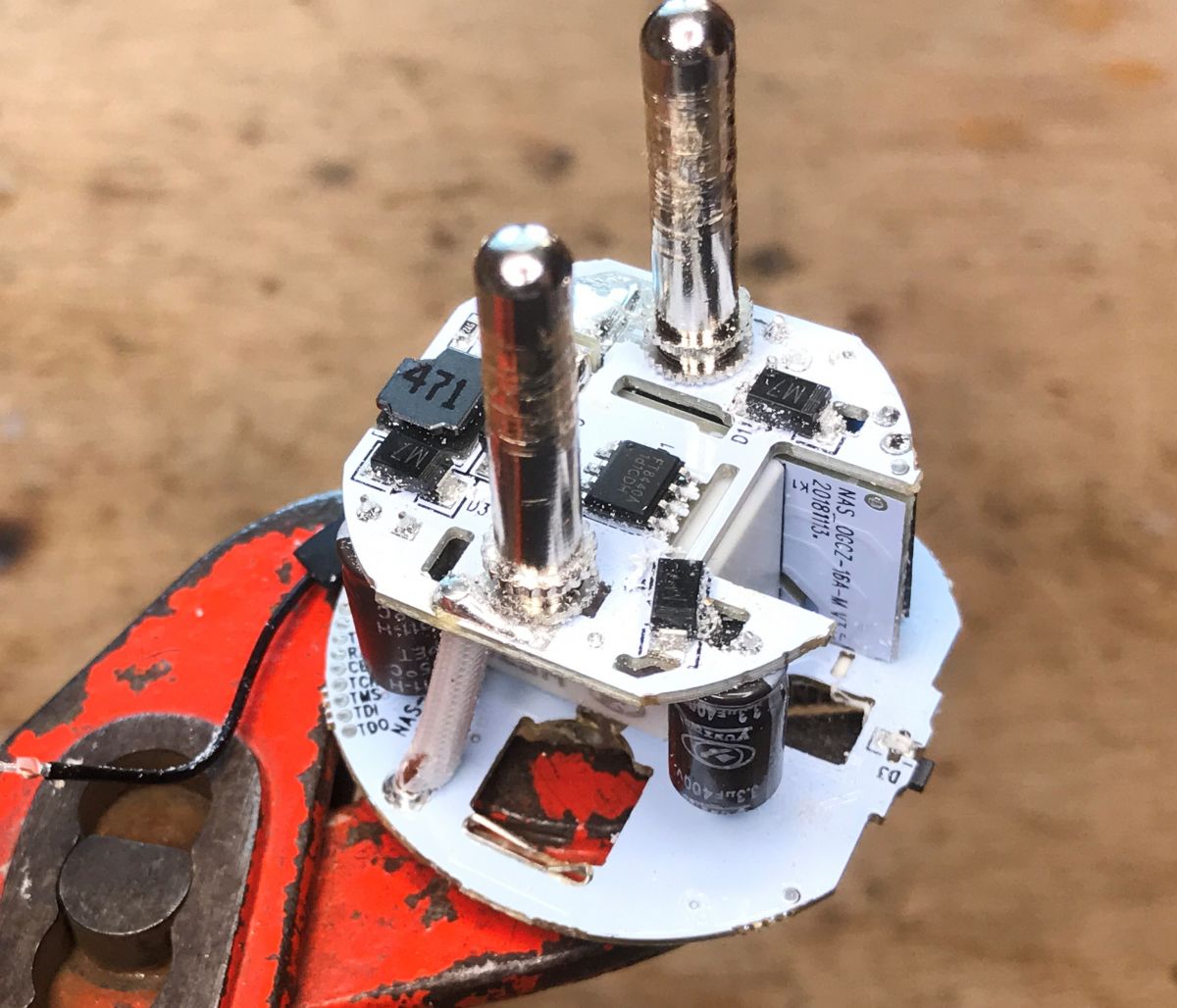

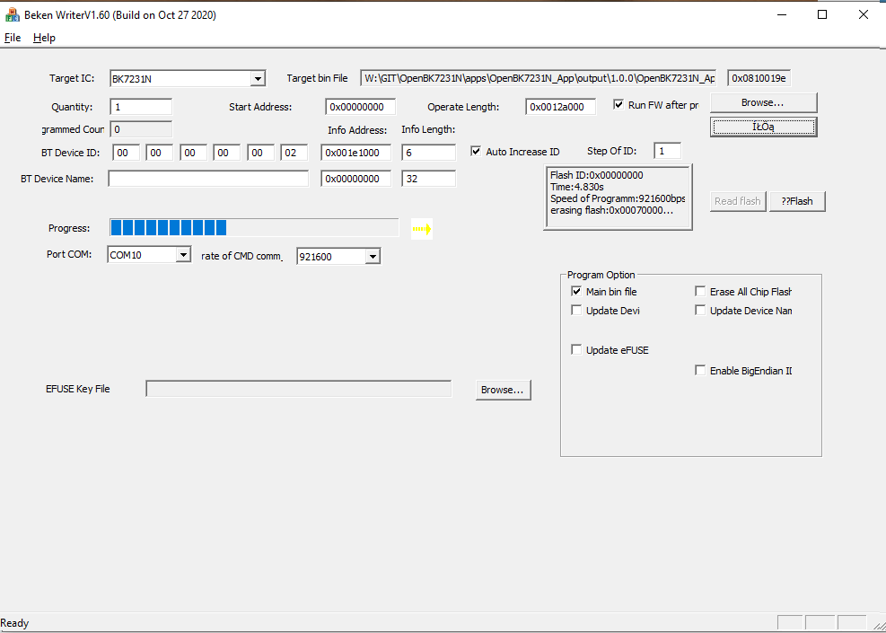

    In the photo below you can see the pads for programming:
    You will need 3.3V, GND and TX and RX, and a UART converter with 3.3V levels. I reset/reboot by cutting off the power. Everything is similar to other topics about BK7231:

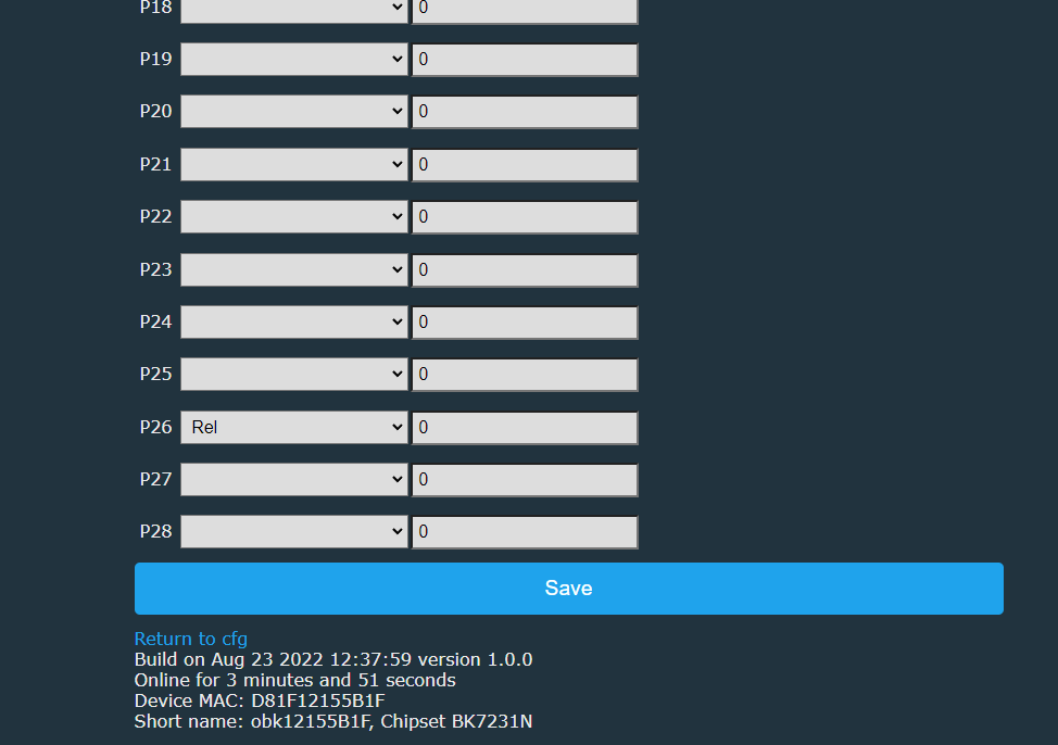

    NAS-WR07W pinology
    Below I wrote down the necessary pins, especially those from BL0937:
    P6 is LED, P26 is relay.
    The button is on P9.

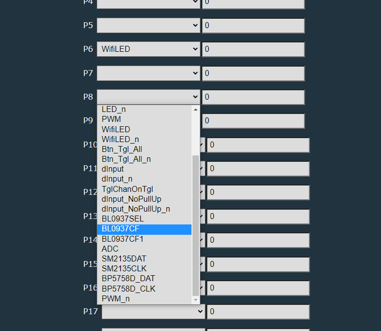

    BL0937 CF is on P0, CF1 is on P8 and SEL is on P24.
    In OpenBeken it is set here:

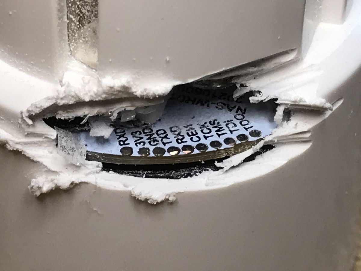

    NAS-WR01W plugs and a smarter way to program
    For the NAS-WR01W twin product, I tried a different approach and only cut the plastic at the programmer signals alone:
    In this way, wires can be soldered there and programmed without removing the rest of the housing by force, but of course then you need to protect the damaged housing.

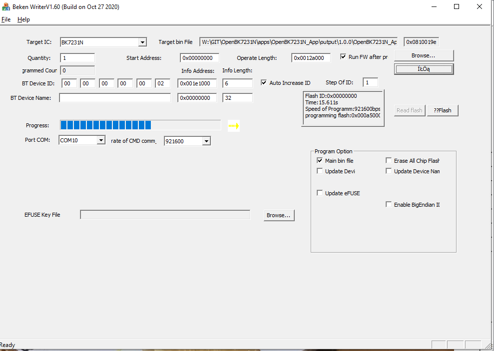

    And now attention - this plug has BK7231N and BL0942 inside. It's better to use hid_download_py, but this time I managed to upload the batch with bkWriter:

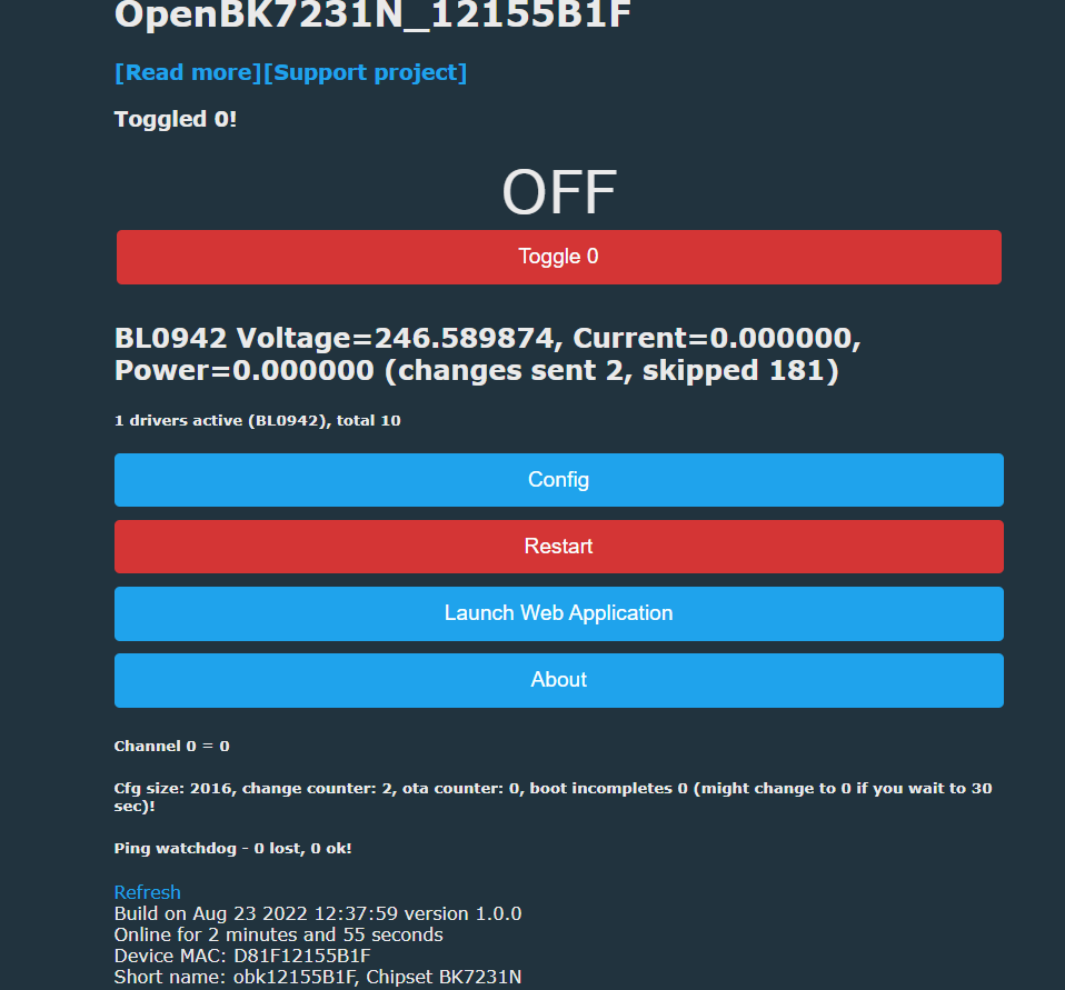

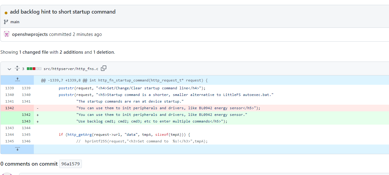

    Configuration and calibration of BL0937/BL0942
    Please follow this topic:
    Electrical socket with energy measurement LSPA9 - we program our own firmware
    For BL0937, we just start the BL0937 driver instead of BL0942.

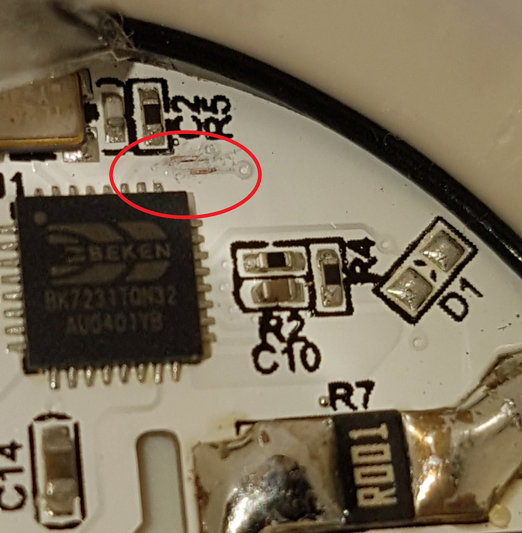

    I picked up a similar socket from the parcel locker today, model NAS-WR07W marked as IG007FR on the package (Type F socket, the whole cost of PLN 63.96 on a well-known auction site - smart sockets with a schuko plug were even cheaper)
    Inside, based on the BK7231T QN32, the BL0942 is responsible for measuring the current anyway I wonder which UART is used for programming: UART1 or UART2? This is my first contact with uploading this firmware, I did not find direct information in google. Hence the questions: does the BL0942 use the same UART as the bootloader, it would be easier to solder to the legs of the soic-8 without cannibalizing the case :idea:
    Finally, if you need to connect to UART1, I will try to solder to the tracks in the coming days and test it experimentally, here is a photo of the inside of this plug, I have already scratched off the insulation:

    I found a connection in your other topic "Qiahip Smart Switch - BK7231N/CB2S - interior, programming":
    Connecting the programmer
    (...)(BK7231T). USB to UART converter and only connect TX1 and RX1:
    If I find time, I will set up the environment and prepare the batch, unless you share the finished batch just to use BKwriter and limit my frustration at the first attempts :)

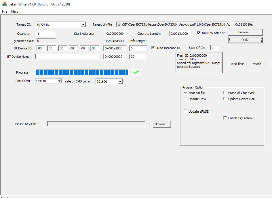

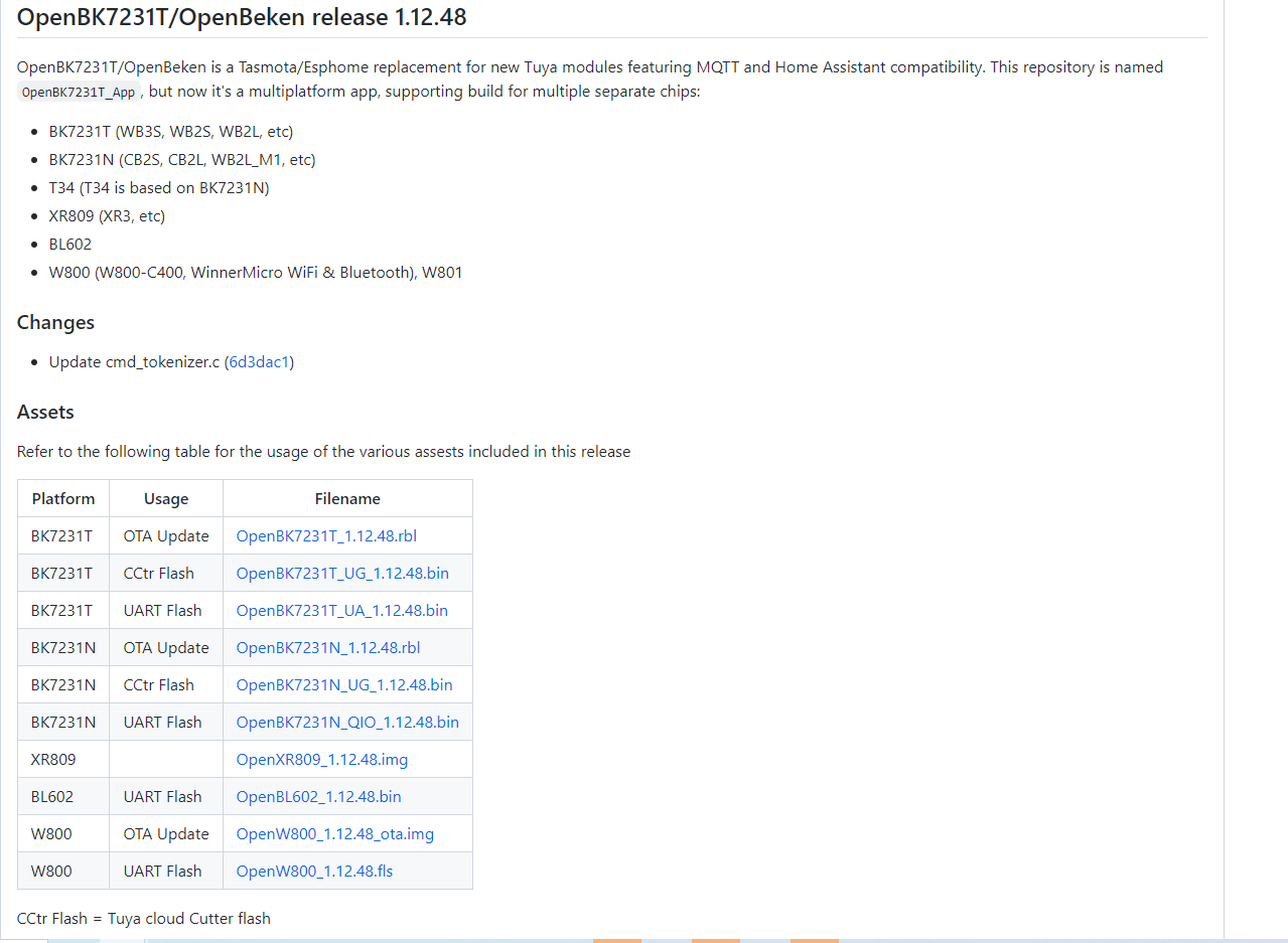

    Automatic builds for the BK7231T, BK7231N (T34), XR809, BL602 and W800/W801 platforms are here:
    https://github.com/openshwprojects/OpenBK7231T_App/releases/tag/1.12.48

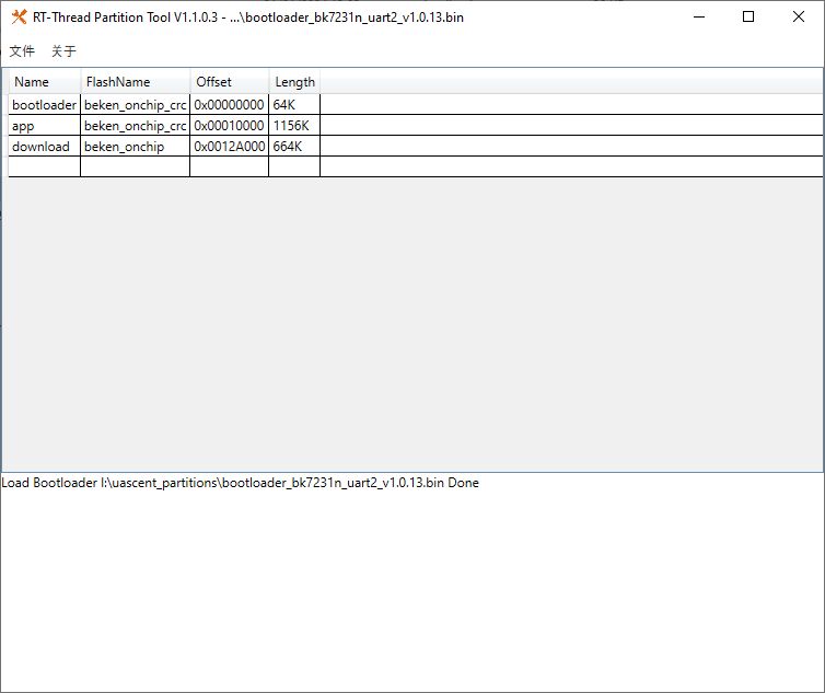

    On BK7231T you upload UA batch with default offset by bkWriter 1.60.
    On BK7231N you load the QIO batch at offset 0x0.
    RBL is OTA via OpenBeken form.
    UG is for BK7231 as you use Tuya-Cloudcutter.
    before uploading the batch, make a copy of the entire 2MB (enter 2MB in length) of the batch and you can also send it to the gentlemen from tuya-cloudcutter

    And as for disassembly, there is no problem, maybe a little more difficult than the famous SP111, but it does the trick :)
    After unscrewing the screw under the sticker and removing the plastic cover, you need to gently knock out these pins together with the plates with a hammer, but first you need to peel off the antenna.
    Above desoldered and removed from the housing without damage.
    My socket is Setti+ SP301.
    I had a problem with uploading OpenBeken, it kept crashing Unlocked Failed.
    Only the 6th time it surprised me.
    Regards
    S

    @SławekSS can you tell me what layout you have inside (BK7231N or T and BL0937 or BL0942) and show the pin configuration? I would add this socket to the list of supported devices/templates.
  • #6 20323155
    SławekSS
    Posts: 726
    Help: 34
    Rate: 80
    BK7231N, BL0942. Board marked as NAS-WR01W6-T V7
    Pins:
    P9-button
    P26-relay
    P6-WiFiLed
    I assigned the configuration the same as in the topic regarding NAS-WR01W and it worked.
    startDriver BL0942 took care of the measurement indications.
    Now it's time to calibrate and try to assign to domoticz :) As I am a preschooler (well, maybe 1st grade SP) in this topic it will take a while :)
    edit:
    Is it possible to somehow set the LED to flash when there is no WiFi and / or when trying to connect, and how to connect it so that it lights up when the relay is on and goes out as if it is off?

    As in the tape: backlog a; b; c;
    Or in the Web Panel in autoexec.bat freely in LittleFS
    Edit: I added a hint on how to use the backlog to the page:
