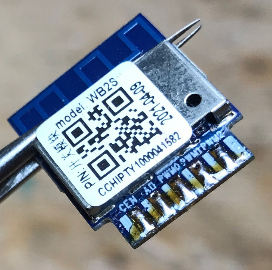

Hello, here I will present the progress report of my work on the open firmware for BK7231T. This topic will be written in the form of a tutorial, I will present here step by step how I developed my own, cross-platform (running on Windows and BK7231T) mini HTTP server, pin configuration system via the web panel and how I connected it with MQTT and ultimately with Home Assistant. Of course I will attach here full source code for download and a Visual Studio project for those who want to play with my server under Windows.
First part of the story
This topic is a continuation of this thread:
https://www.elektroda.pl/rtvforum/topic3850712.html
Official repository
As per users requests, here is public repo:
https://github.com/openshwprojects/OpenBK7231T
Topic content
In this topic, I will present:
- how to write your own simple C-language HTTP mini-servers on Windows
- how to prepare this server to be multi-platform and run it on WB2S / BK7231T
- how to organize cleverly a pin configuration for the BK7231T in Tasmota style
- how I finally organized the pin configuration and MQTT support for my open firmware for BK7231T
- as in the case of the current version of the project, run my firmware on my own system from the BK7231T series (WB2S, WB3S, maybe others) and connect it to the Home Assistant via MQTT

We moved away a bit from the WB2S / BK7231T topic, but now it's time to come back to it.
Let's think - how can we organize our server to run on Windows and WB2S at the same time?
A cut has to be made - we separate Windows stuff into one place, HTTP stuff into another.
From now on, my old main.c file (where the winsock code is) is called win_main.c and it contains:
Code: C / C++
The HTTP_ProcessPacket function is in another file, it takes the input packet and the output buffer as arguments (yes, then you need to add a check if you are not exceeding the range).
The HTTP_ProcessPacket function is now in a new file - new_http.c:
Code: C / C++
Of course you also need to make a header (.h, header file and be able to #include it) - but I assume we know C ...
Code: C / C++
This feature allows us to use our server on any platform, including the BK7231T.
On the BK7231T we connect to the TCP code (just set it to listen on port 80) like this:
Code: C / C++
For convenience, I added detection of how many fields have actually changed.
NOTE: All of the above (including switching channel / relay values) can be tested in my batch in the Windows version! You don't even have to have WB2S to develop it and work on it. Very comfortable.
Connecting the pins for BK7231
My pin configurator and the HTTP server work fully on Windows. This is possible because the pin handler associated with BK7231T is appropriately separated in the new_pins.c file:
Code: C / C++
However, the change of the channel value itself is independent of the platform:
Code: C / C++
Yes, one int represents the channel values - one bit equals one channel. Therefore, the limit of the number of channels is now 32.32 bits in an integer on a 32-bit platform.

What does the WB2S module require to run?
I wasn't quite sure where I should put this paragraph, so I'll just leave it here.
I received from @PIXELO some desoldered WB2S modules, which are as found for testing.
I checked that such a module does not require any external connections except a 3.3V power supply to work. It can also be easily programmed.
Below is a photo report from soldering / commissioning:
The module prepared in this way works, one UART is used for programming, the other is for receiving the log.
I do not describe the connections themselves, because I described them in the first topic of the series.
