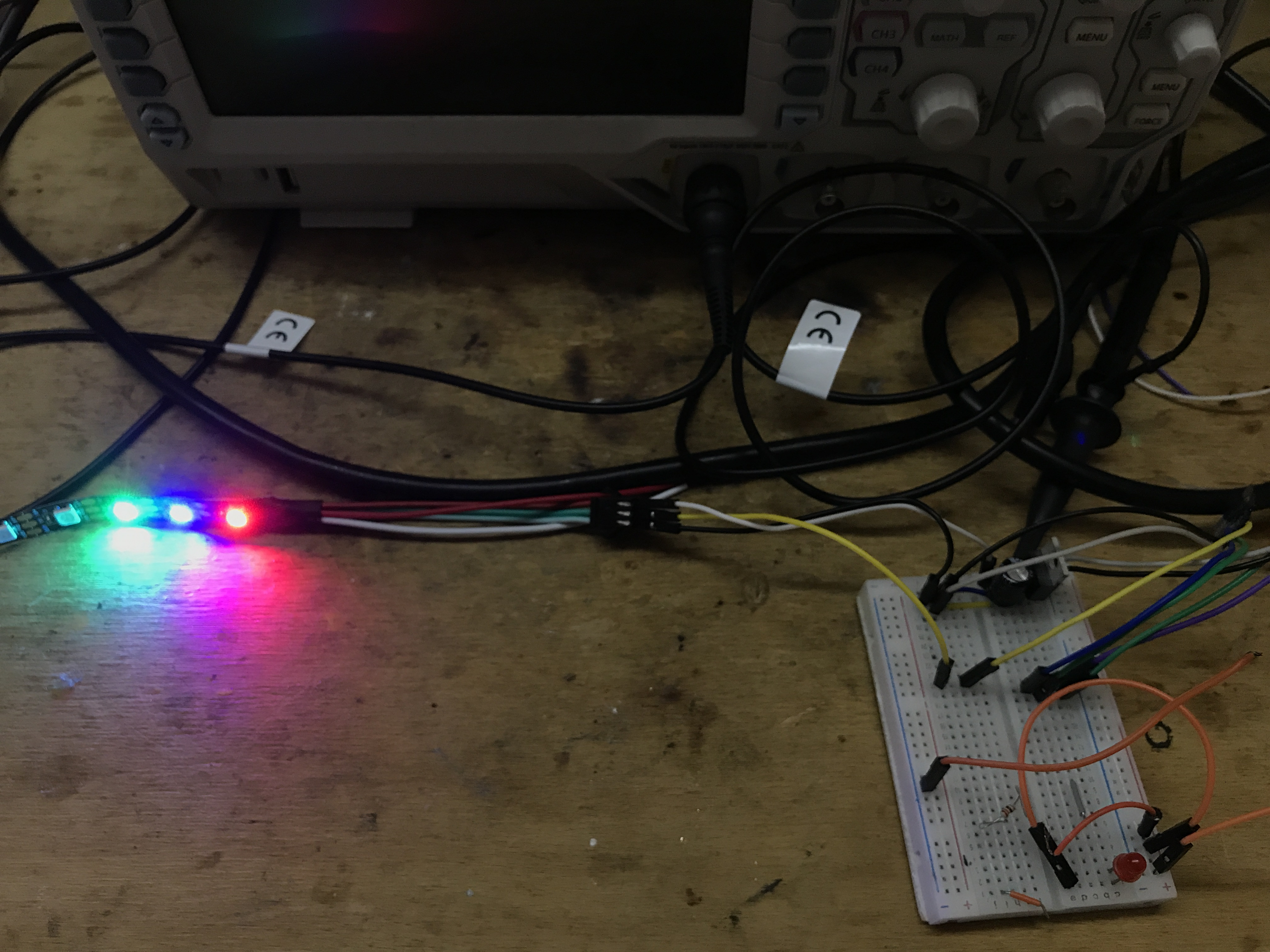

My testing environment I don't have any IoT device with individually adressable LEDs, so I just used a CB2S with routed out P16 pin (as in the guide which I mentioned earlier) with the WS2812B strip connected:
Sample - RGB test Ok, so let's create a sample script. For now, we will just lit two LEDs, just to check if the strip is working. Here's how it looks like on my side:
Here's full script:
The script is using SM16703P commands, but the same works for WS2812B. It's just that we have first developed SM16703P driver and then discovered that timings are also matching classic WS diodes.
Result:
Sample - Full strip Single Color For this example, we can set all the pixels to a single color. There are two ways to do it. First one is to use a loop:
Sample - Full strip RGB A simple loop can be also used to set RGB colors. First red, then green, then blue, but the order of colors can be different if your strip is, for example, GBR standard.

I tried to repeat my test from last year with WS2812B strip and came up with this slightly modified script:
startDriver SM16703P
// Channel for number of LEDs
setChannel 5 16
// init
SM16703P_Init... [Read more]
18 Feb 2024 18:41
@jkwim , I suspect that you are incorrect. The raw data is not the hex data you provided. Raw data is the data for the SPI, where we split each byte into 4 bytes for the SPI DMA transfer:
static uint8_t... [Read more]
jkwim
18 Feb 2024 18:47
Ok. Now I understand.
I tried a normal WS2812B strip and also a WS2812B Ring.
Same observation of LED 0,1,2 (2 lighting up very briefly) and then 3 & 4 getting lit at the same time and then 5 ...
... [Read more]

I tried to repeat my test from last year with WS2812B strip and came up with this slightly modified script: startDriver SM16703P // Channel for number of LEDs setChannel 5 16 // init SM16703P_Init... [Read more]
@jkwim , I suspect that you are incorrect. The raw data is not the hex data you provided. Raw data is the data for the SPI, where we split each byte into 4 bytes for the SPI DMA transfer: static uint8_t... [Read more]
Ok. Now I understand. I tried a normal WS2812B strip and also a WS2812B Ring. Same observation of LED 0,1,2 (2 lighting up very briefly) and then 3 & 4 getting lit at the same time and then 5 ... ... [Read more]
Can you make a video of my script running on your strip? Do you have PowerSave on? [Read more]
Tried your script on both versions of LEDs. Same issue is there. Changed power supply also (I did the latest test plugging in to laptop USB port) just to eliminate one more variable. If there was... [Read more]
This is just a debug text, I will remove it in the next build. I think we need more tests. Or maybe you're running something in the background, like IR interrupt? [Read more]
I am really sorry for dragging this on. The issue was with having the wrong version of FW. I was expecting to download the latest version and picked the topmost item which was actually 451 on that... [Read more]
So everything is working and you just had older version of firmware? That's a very good news! By the way, if you want to drive a really long LED strip, you can change the size of DDP buffer in the following... [Read more]
