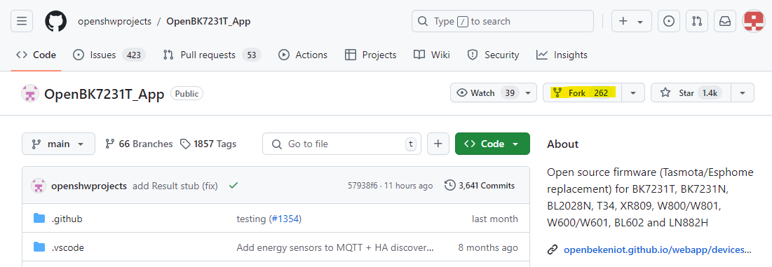

Create your own custom build on the latest code
-Register for a GitHub account and login
-Navigate to https://github.com/openshwprojects/OpenBK7231T_App and create your own fork of the main app
GitHub interface for the OpenBK7231T_App repository
-Customize your fork name or stick with the original
GitHub screen for creating a fork of the OpenBK7231T_App repository.
