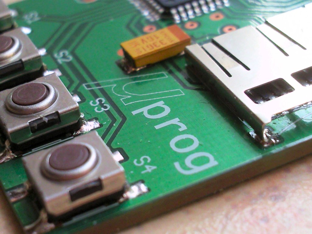

    Dla tych co nie wiedzą jak co lutować : Kondensator C5 -paskiem w stronę klawiszy S
    Hasn't my colleague gone too far in his advice? C5 should be just the opposite (tantalums have a different marking than regular electrolytes). Photos from the first post mannequin show the proper soldering of this capacitor.
  • #183 9826229
    krzycho123
    Posts: 1867
    Help: 135
    Rate: 106
    Exactly, in tantalum, the dash on the housing is PLUS and not a minus as in other elements. If you soldered the other way round, the system will not fire.
  • #184 9826236
    tmf
    Posts: 14318
    Help: 2090
    Rate: 2206
    It will fire, it will fire, only literally. Tantalums give very effective firings :)

    I should buy such a socket:
    uProg - small, fast, portable AVR programmer with SD
    But unfortunately I bought these:
    and I had to solder centimeter conductors - fortunately not all of them :) 8.
    It is worth noting that not all of them are needed. I recommend soldering to the socket first. The first pin of the socket and on the board is free. We solder the next 6. We don't need the rest.
    In addition, we bend the metal "legs" of the housing so that everything can be soldered to the PCB. Three without a problem, but this foot next to the capacitor burns the most because you have to bend it to match the GND mass.
    It's best to buy a suitable socket right away than to have a problem like me afterwards.
    The photo shows that everything is at a distance from each other and the February sockets do not close to the PCB. However, the soldered conductors have insulation on them, which has its diameter, so the socket sticks out a bit. Soldered, it reaches the height of the capacitor, so everything is OK. There will be no hassle with the display :) . It's best if the tile also had space for the second unfortunate socket.
    PS.
    Besides the difficulty of soldering, I report the need for this programmer to be also in the version programming ARM7 (JTAG) processors. Not that this ISP also has JTAG functionality, but second albeit a similar design for ARM programming.

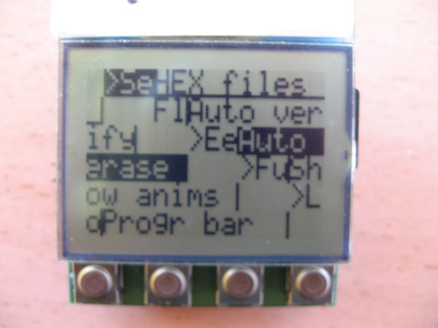

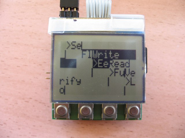

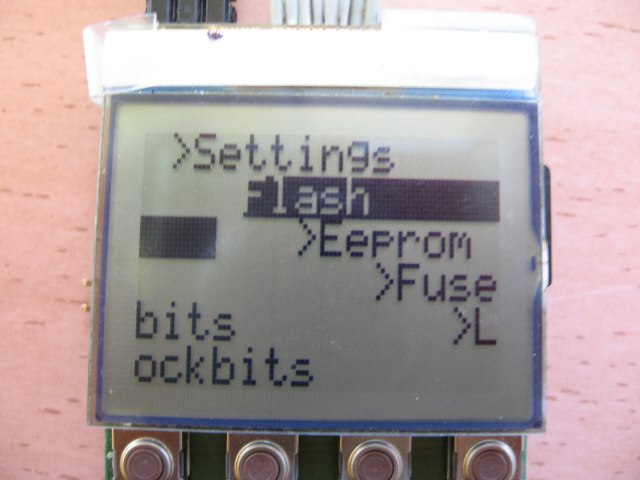

  • Incorrect LCD configuration caused shifted characters
    #191 9843817
    jajen
    Posts: 469
    Rate: 1258
    I read, it says that the sdhc card is not working, but there is nothing that every 4gb card is sdhc. There is nothing written on mine except the company and capacity. But now I understand that all cards over 2 GB will not work.
    OK, I got the card but there was another problem. What is the cause of shifted characters on the display? Pictures below.
    In addition, the startup logo is not displayed, but the menu appears immediately.
    uProg - small, fast, portable AVR programmer with SD uProg - small, fast, portable AVR programmer with SD uProg - small, fast, portable AVR programmer with SD
    OK, I am answering to myself. The reason was a bad LCD organization in the config.
  • Editing config file controls programmer and LCD settings
    #192 9853564
    krzysiekdg
    Posts: 132
    Rate: 33
    You need to edit in notepad the file on the memory card simplify it in the system folder called config. when you open it with a notebook, it should look like this:
    : 00011111
    ||||||| + ---- bit0 - programmer clock from osccal, programmer clock from osccal byte (1 = speed from OSCCAL byte, 0 = fabric 8MHz) (1 = speed from OSCCAL byte, 0 = factory speed)
    |||||| + ----- bit1 - AUTO VERIFY (1 = autoverify flash or eeprom after flashing)
    ||||| + ------ bit2 - AUTO ERASE (1 = erase the chip before programming flash memory)
    |||| + ------- bit3 - SHOW ANIMS (1 = play animations after failed programming)
    ||| + -------- bit4 - PROGRESS BAR (1 = enabled-slower programming, 0 = disabled-normal programming)
    || + --------- bit5 - HEX FILES (1 = hex, 0 = bin)
    | + ---------- bit6 - Slower SPI clock for LCD, slower clock for LCD (1 for 2MHz, 0 for 4MHz)
    + ----------- bit7 - LCD organization, LCD organization (1 = 48 * 102 (chinese), 0 = 48 * 84 (normal))
    : AF = lcd contrast, contrast (HEX)
    80 - converter off, converter turned off
    81 to FF - contrast voltage from min to max, inverter voltage from min to max
    : 14 = lcd bias, multiplexing (HEX)
    10 to 17 - see PCD8544 datasheet, see note
    : 8 = programming speed start, initial programming speed (DEC)
    8 - 8MHz (default, default)
    7 - 4MHz
    6 - 2MHz
    5 - 1MHz
    4 - 500kHz
    3 - 250kHz
    2 - 125kHz
    : FF = osccal value, osccal value (HEX)
    00 to FF - internal oscilator calibration from 4MHz to 16MHz, internal oscillator calibration from 4MHz to 16MHz
    Programmmer use values preceded by a colon. Rest of the text can be freely modified. Do not put any colon chars.
    The programmer uses values preceded by a colon. The rest of the text can be freely changed. Colons should not be used.
    Save your changes and you're done.
  • Display bit7 selects original versus replacement hardware

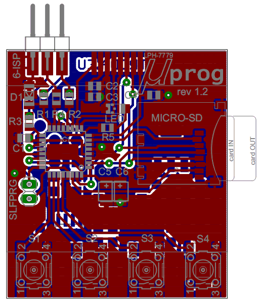

  • Revision 1.2 adds status LED and expansion pads
    #194 10030257
    manekinen
    Posts: 1629
    Help: 76
    Rate: 2362
    Hello. In the attachment there is a design of the board in the 1.2 . Changes from 1.1:
    -added LED in housing 0805 or 1206 + resistor for it, this LED will flash during some operations, e.g. when switching on or counting the size of the HEX file. It is partially supported in the last firmware, in the next I will add some simple debugging, so that if something with the system is wrong, the LED will tell us about it :)
    -added pads on the bottom side of the board, for any elements in 0805, SO8, and SOT223 housings. Thanks to this, the programmer can be expanded with its own stabilization and charging system, or add your own converter, e.g. on dedicated systems - who needs what. A very nice solution was suggested by a colleague MatygaD , now such a layout can be made without an additional tile :)
    - VCC, ADC, and PWM (round) pads are also derived from the bottom side, if in the future there will be some functions using these pins, you will be able to modify the board without any problems :)
    -removed CR2032 battery pads because they were too weak to use the system practically - working time 10-15 minutes.
    From (I hope) Monday I am starting work on adding Xmega support - if someone has several models and can test the system, I invite you to PW. I mean a beta tester who would find some time to check the operation with subsequent versions of the program - for such a person I can send a 1.2 plate and a display as a gift :)
    • ÂľProg_pcb 1.2.rar (184.07 KB) You must be logged in to download this attachment.
    Hmm, it's a pity that instead of one SO8 there is no layout under the MCP73113, when the fields are to facilitate the construction of, for example, a charging bag based on this system :cry: .

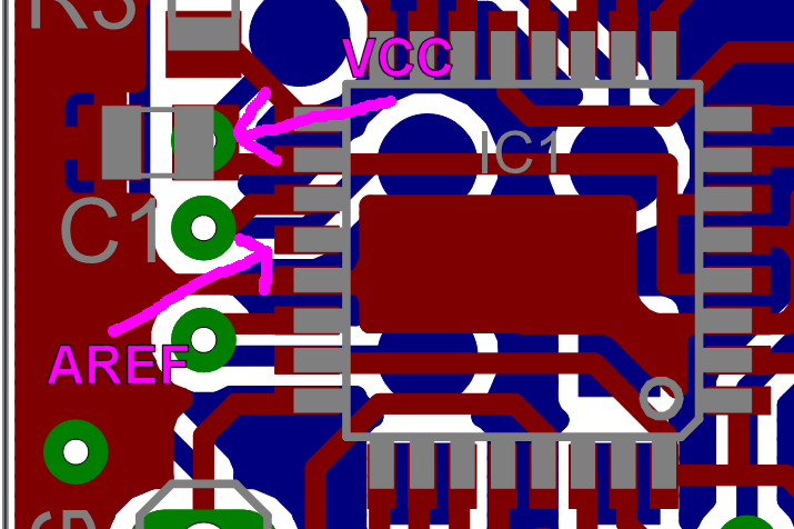

  • #198 10063941
    marlech
    Posts: 21
    Hello and welcome !!!
    I have a problem, namely the system powered by 3.3 V, while the display shows 1.1 V, the uProg seems to be working properly. What could be causing this.
    greetings
  • #199 10064030
    manekinen
    Posts: 1629
    Help: 76
    Rate: 2362
    Do you have a 1.2 tile? I disconnected the reference voltage of the AREF foot on it so that it can be selected programmatically, in all batches that have been there so far, the voltage is set from this foot. In the next program, it will be software-selected, and it will work with the 1.2 and earlier boards.
    Heh, I completely forgot about it :oops: It does not bother you in programming, well the fact that the system will not measure the voltage and it will turn on even if we give 5V - you have to remember about it.
    My intention was also to add temperature measurement and battery charging current measurement (programmed charging, which I gave up because it was not very safe) and this required an internal reference voltage of 1.1V.
    If you want to restore the measurement until the next update, connect the AREF pin to the system's power supply:

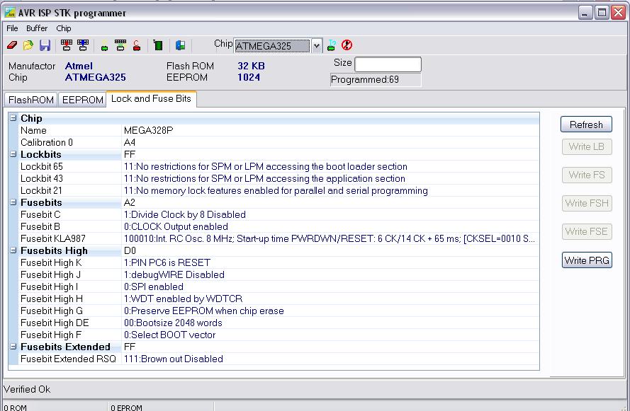

    Rate: 345
    Could someone post a screen on how to set up fusebits in bascom. :cry:
  • #205 10115225
    garlinski
    Posts: 68
    Use the online fuse-bit calculator: www.engbedded.com/fusecalc (you have to choose ATMega 328P and enter fuse bits in hex form), or install eg Burn-O-Mat, there you can enter fuse-bits directly in hex form), and programming is much faster.
    PS: The programmer is great, it has already made my life easier several times.
    Regards.
  • ATmega328 missing from avrdude and uProg hangs
    #206 10116045
    marcin44430
    Posts: 233
    Rate: 345
    I have avrdude and burn-o-mat overlay, but I get a bug that I don't think it supports Atmege328. Because it is not even on the list of supported microprocessors in avrdude.
    Added after 1 [hours] 47 [minutes]:
    I set the Fusebits as shown in the picture below, but the Uprog does not work, i.e. when turned on, only the horizontal dash on the display blinks and nothing. :cry:
  • #207 10116389
    manekinen
    Posts: 1629
    Help: 76
    Rate: 2362
    Marcin, it will work even if you don't set these leaves - only 16 times slower.

What’s the typical failure after reverse-biasing C5?
Tantalum C5 stripe denotes +. Reversed part shorts the SD rail, overheats, and can burn the PCB within 3 s [Elektroda, krzycho123, post #9826229]
