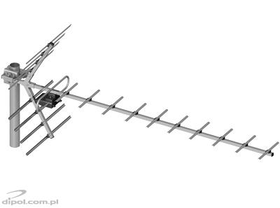

    Will the antenna shown in the picture be better than a handmade dipole made of copper pipes? 150-170 MHz band. If so, please provide a better alternative. How to use RTL-SDR on a cheap USB DVB-T tuner for HF and 64–1700 MHz?

    To my eye it is an antenna for DVB-T UHF, i.e. above 470 MHz. Mounted on the picture will not let you listen to anything, because what we are interested in works in vertical polarization.
    Buy Radmor 32812/1.

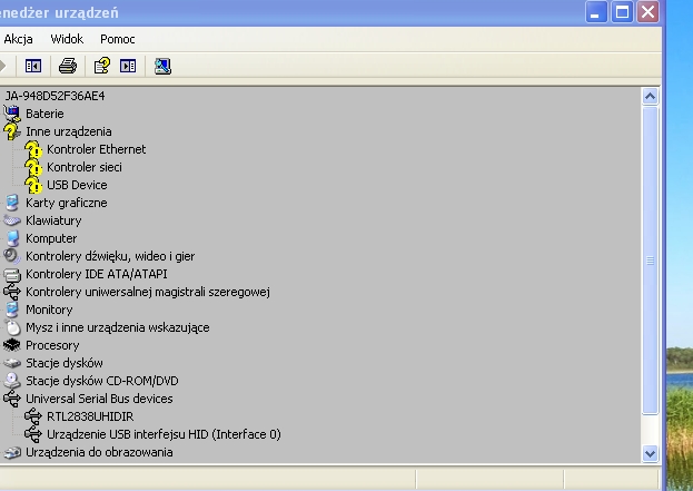

    Do you have the same as mine, i.e. on "xp" -ku sdrsharp program crashes?
    Say, did the drivers upload the Zadig well?
    • How to use RTL-SDR on a cheap USB DVB-T tuner for HF and 64–1700 MHz? bez_tytu3u.JPG (87.87 KB) You must be logged in to download this attachment.
