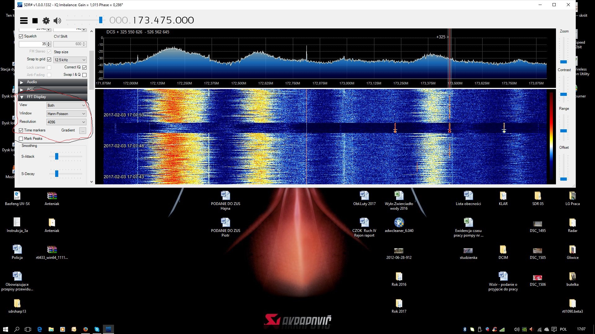

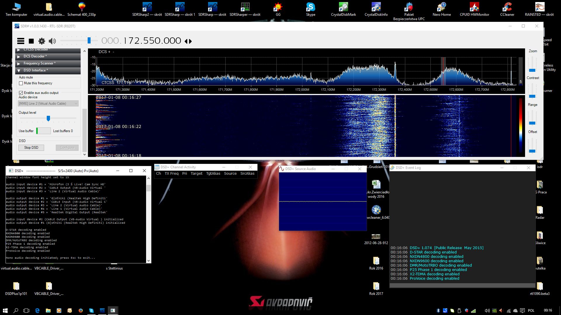

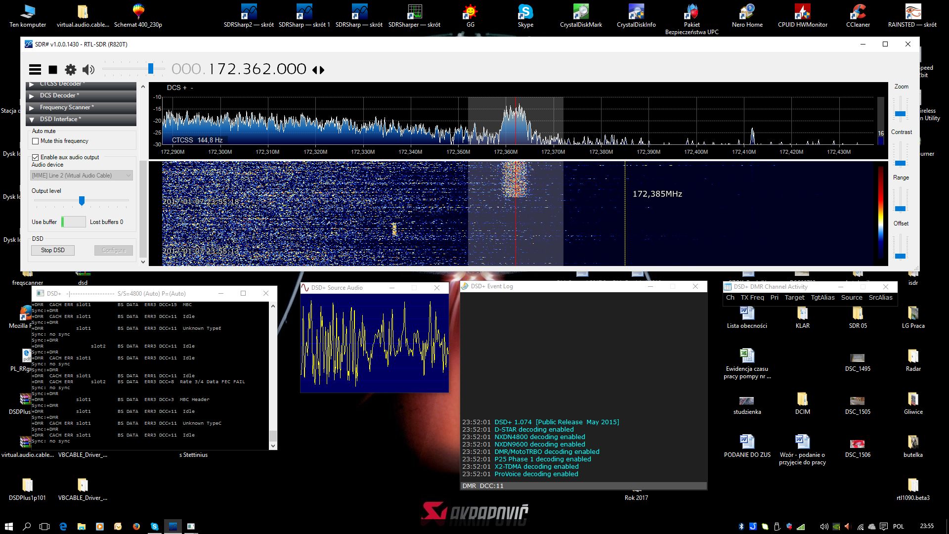

  • #1053 16181711
    Hajna
    Posts: 478
    Help: 69
    Rate: 145
    Asking colleagues if I did everything right when it comes to dsd + in RTL-SDR, I attach screenshots after switching DSD on and during work, but I still hear a whirr. How to use RTL-SDR on a cheap USB DVB-T tuner for HF and 64–1700 MHz? How to use RTL-SDR on a cheap USB DVB-T tuner for HF and 64–1700 MHz? unless something is wrong?

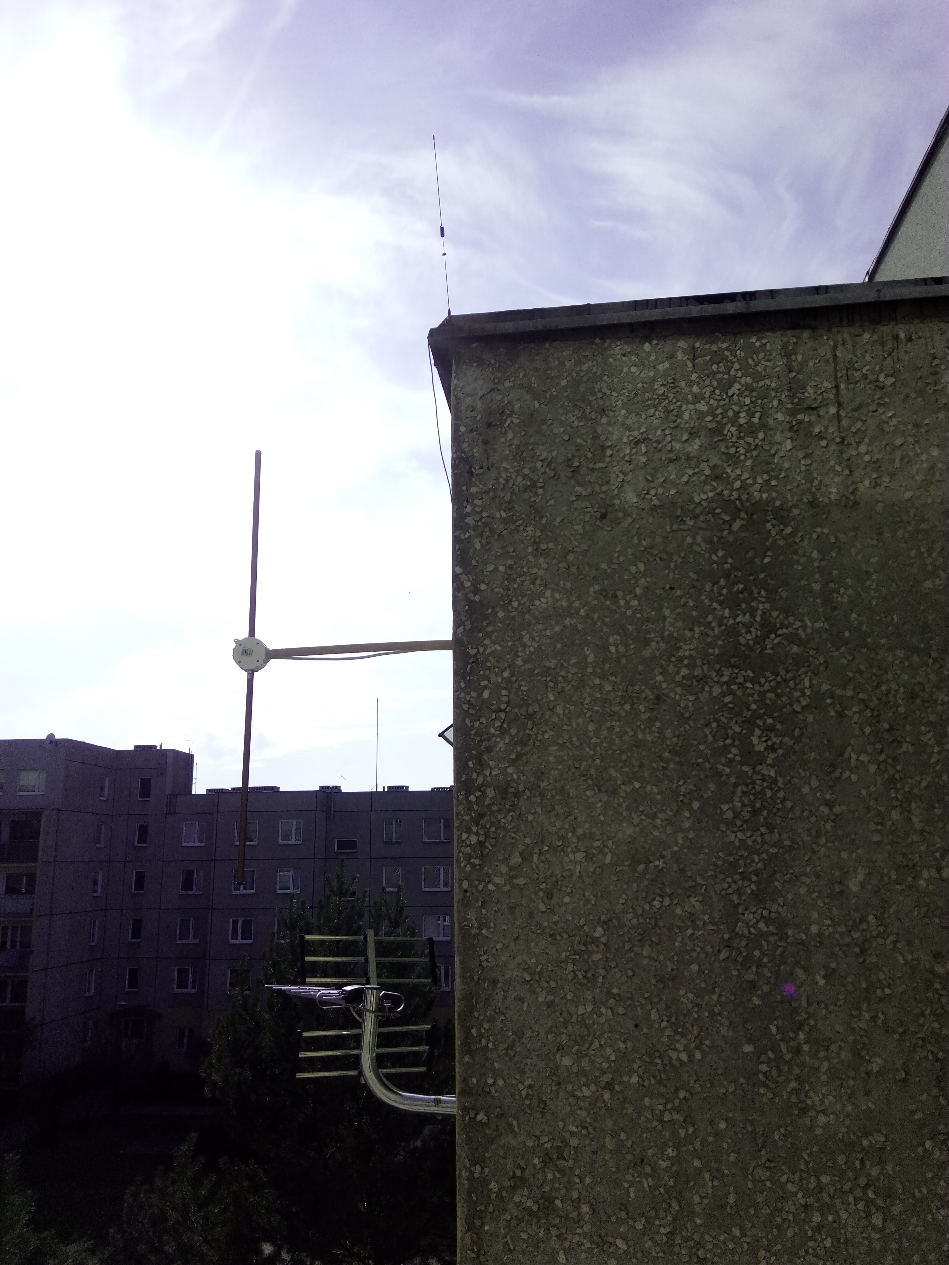

  • #1070 16236915
    endriu2712
    Posts: 127
    Rate: 24
    Hello, I will join the topic. So I have an SDR tuner in a blue housing, and an antenna constructed according to the Czakos post No. 768, with a 75ohm cable. I live in the village and the antenna is placed in the attic. I would like to replace the antenna with a better one to improve the range. So what kind of antenna do you suggest, colleagues?
  • #1071 16237110
    internick
    Level 36  
    Posts: 3081
    Help: 273
    Rate: 555
    I do not know what this structure is, but ... maybe start by elevating it above the roof?
  • #1072 16237121
    endriu2712
    Posts: 127
    Rate: 24
    but the attic is empty
    made as in the photo
  • #1073 16237171
    internick
    Level 36  
    Posts: 3081
    Help: 273
    Rate: 555
    Buy a Radmor 32812/1 and hang it over the roof.
    Although on this dipole it should be better if you expose it to the world.
  • #1074 16237351
    endriu2712
    Posts: 127
    Rate: 24
    Thanks for the advice to show it outside. And at a height of 3m, it is enough because it is impossible to get to the roof, there is no way to enter
  • #1075 16237381

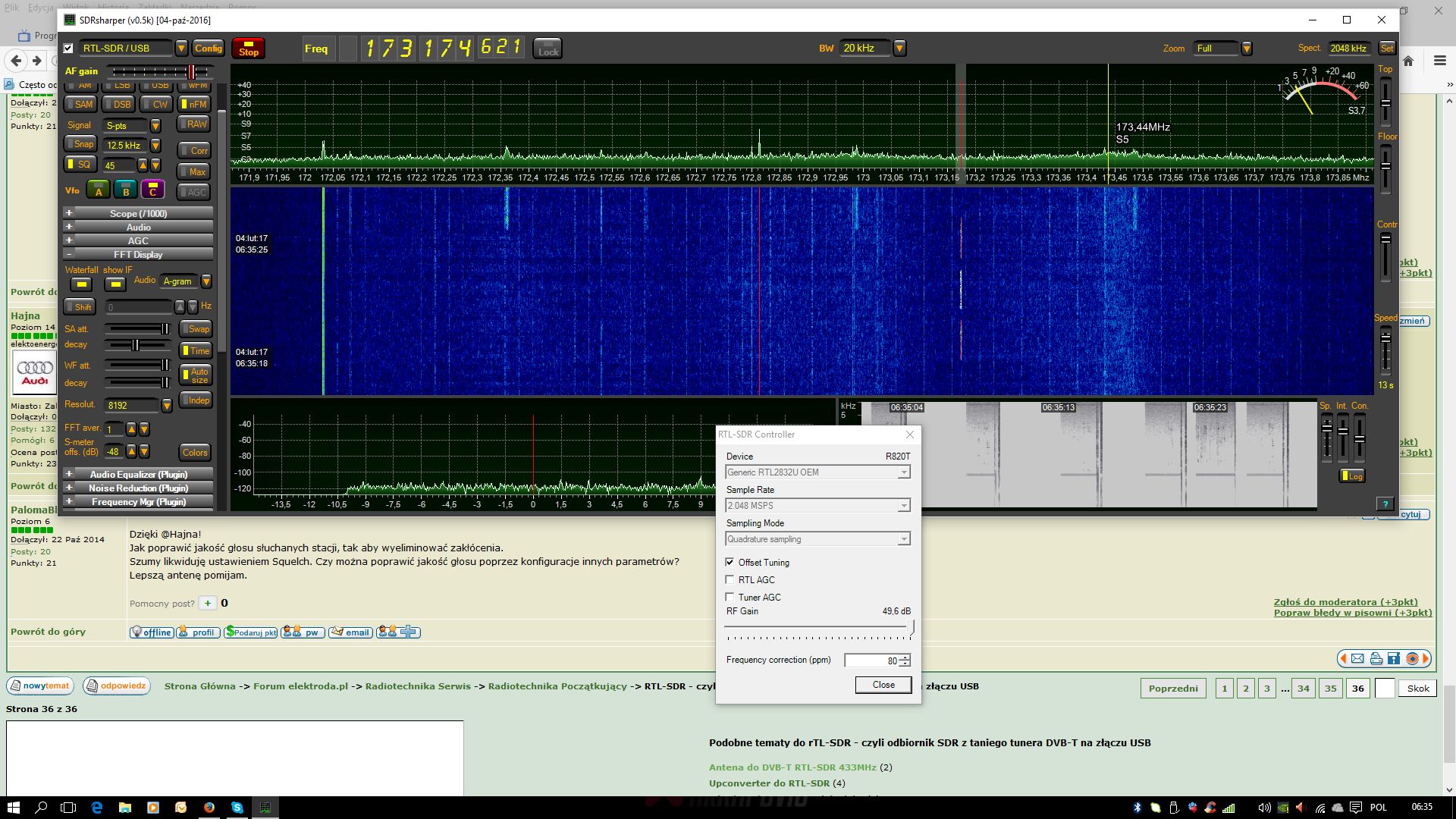

  • #1078 16250343
    Hajna
    Posts: 478
    Help: 69
    Rate: 145
    Marked in the picture How to use RTL-SDR on a cheap USB DVB-T tuner for HF and 64–1700 MHz?
  • #1079 16250845
    PalomaBlanka
    Posts: 32
    Thanks @Hajna!
    How to improve the voice quality of the stations you are listening to so as to eliminate interference.
    I eliminate the noise with the Squelch setting. Can the voice quality be improved by configuring other parameters?
    I skip the better antenna.
  • #1080 16251506
    Hajna
    Posts: 478
    Help: 69
    Rate: 145
    PalomaBlanka, add the city in which you live to your profile, take a RTL screenshot, also try the program in the attachment and the picture.
