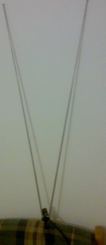

    Attached is my antenna. It was added to the set with the 1985 Otake color TV set that is still operating today. Unfortunately, only in a few days I will be able to test its cooperation with the dongl, because only then will I have the MCX-> RF adapter. The telescopes are adjustable in length from 24.5 cm to 112 cm. Unfortunately, for example, in the case of receiving digital TV in Warsaw, this antenna works poorly - it only allows the reception of MUX3 and with cuts. And planes on 1090 MHz I managed to pick up even on this "stick" attached to the dongle - and without exposing it to the outside.
    How to use RTL-SDR on a cheap USB DVB-T tuner for HF and 64–1700 MHz?
    However, I repeat the question from my post # 963 - maybe someone has already successfully decoded their own calls and SMSs using the SDR dongle and airprobe software?

    I will not tell you anything about intercepting your conversations or SMS, because it is beyond the scope of my interests. So I just raise your question from the post above.
    As for the dipole from telescopes, I just wanted to add that when using it, you should spread its arms to the full width so that they are in line.
    The second thing is whether you will put it, for example, behind a balcony or window, vertically or horizontally. As for the display, make the boom a meter or two away from the wall. Forget about receiving something from the antenna at home.
    and the most important thing is to tune this antenna to the range you want to receive.
    And it looks like this: -7300- you divide the frequency in -MHz- and you get the length of one arm of your antenna in -centimeters-
    So you want to receive 172MHz ;) is 7300: 172 = 42.4cm each arm.
    The dipole is quite broadband, so 1-3cm accuracy is enough.
    The antenna tuned in this way will have better efficiency, even if it turns out that the arms must be 10cm each. Longer is not better :D
    the antenna is to be in resonance at a given frequency and matched with impedance to the "cable" and the receiver.
    Good luck

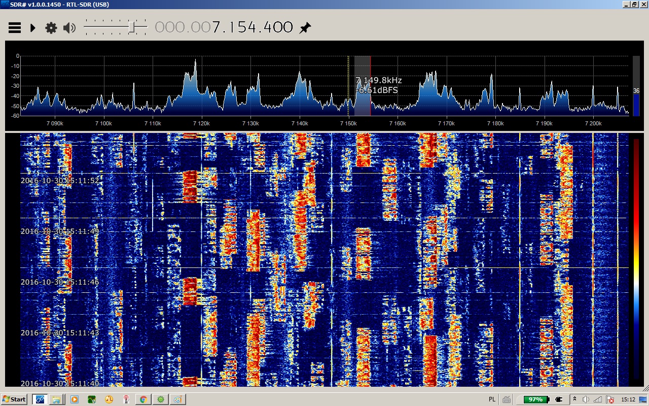

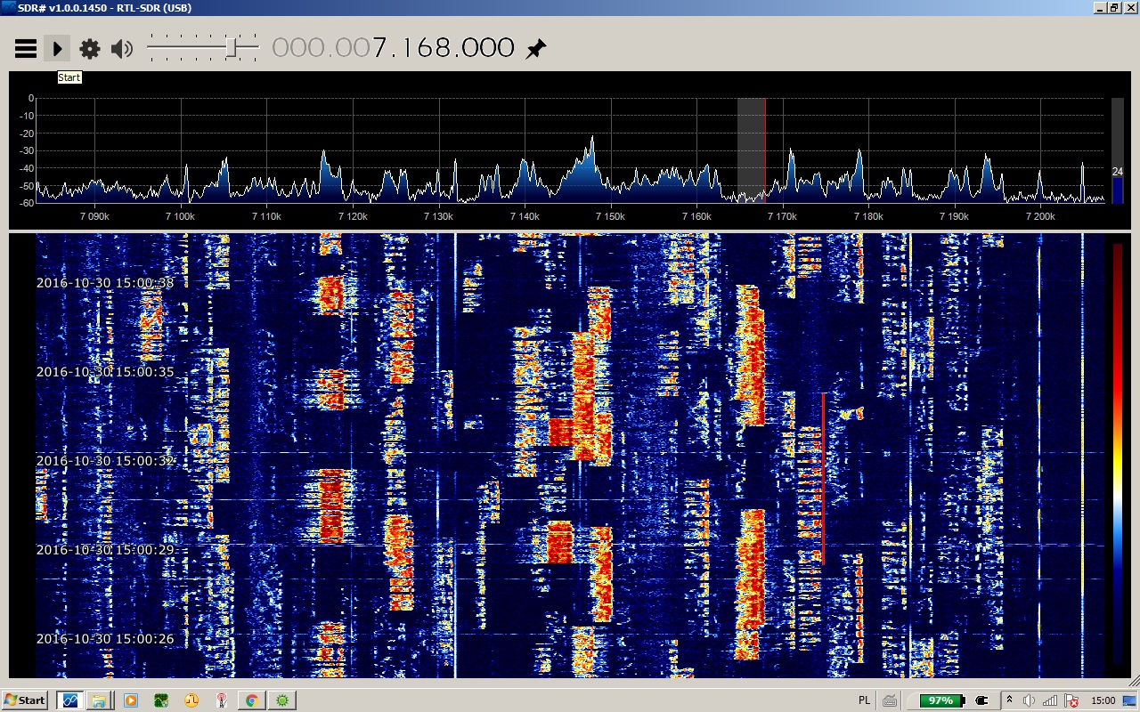

    The transmission I received today is attached.
    In my opinion, this is the US military, but it would be nice if some experienced ham radio confirmed it. I keep saying "thank you", "one, five", "delta". Transmission takes place (continuously) at a frequency of approx. 7.19132 MHz in the LSB.
    The joy of receiving this transmission is so great that I did not have to use any dedicated antennas or upconverters. The tuner itself with the R820T2 head and the antenna from post # 991 was enough (the length of the telescopes was selected experimentally, I did not even have to put it outside, it stood in the middle of the room in my apartment on the outskirts of Warsaw).

    It's not an army :D
    The range 7 to 7,200 MHz is the range of the amateur shortwave band, 40 meters to be precise.
    The amateur radio competition is currently underway and will last until midnight today.
    When working on this and other bands, English abbreviations are used.
    It's crowded there today. Station next to the station.
    If you had a piece of longer wire as an antenna and a HF converter, you would see what is going on there. I will take a screenshot in a moment and you will see how many stations are there.
    This can be heard very poorly in your recording. It should thunder.

    A screenshot from before ...
    Regards, SP5MET ;)
