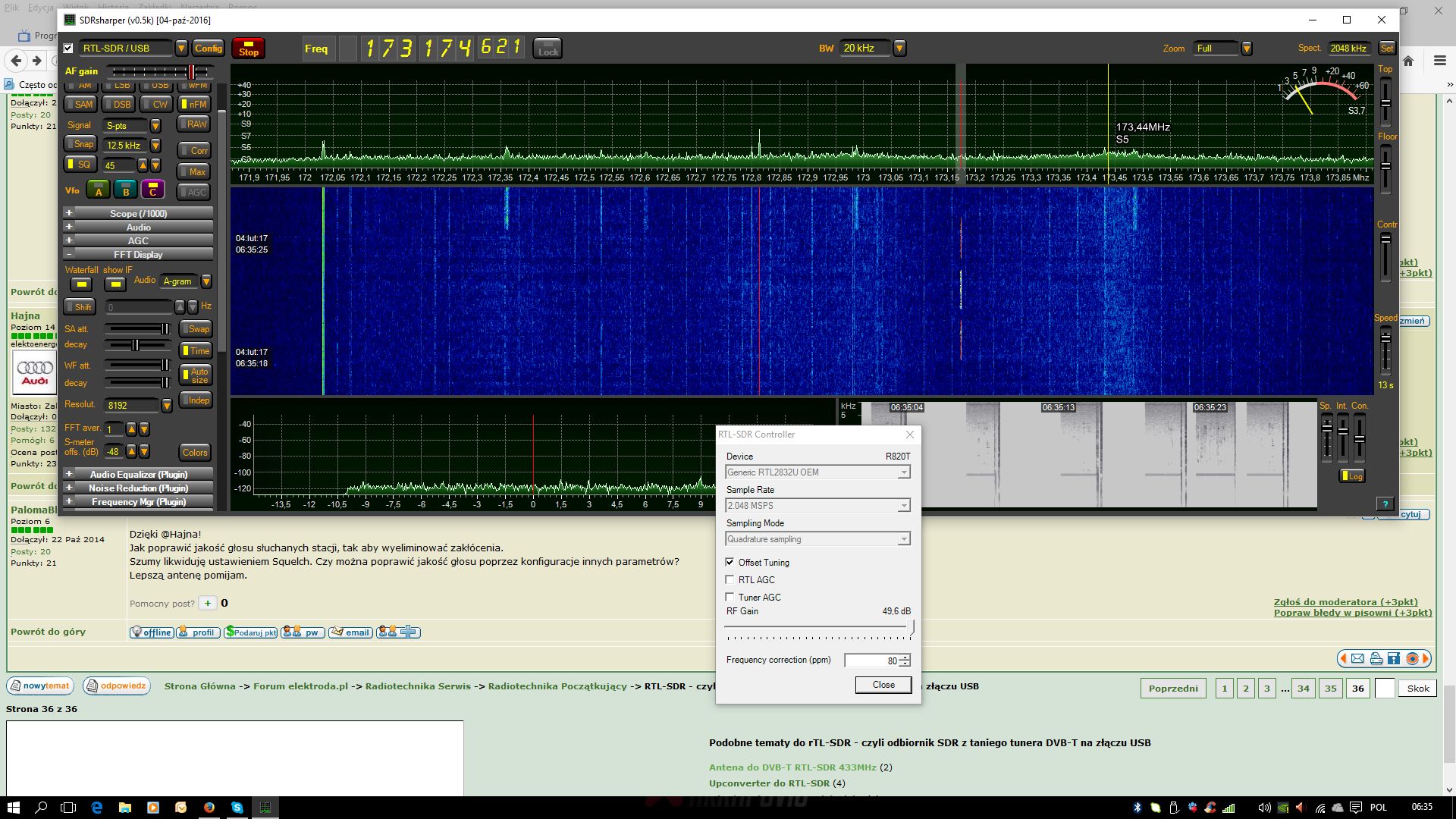

    Attached are screenshots of the SDRSharp software that I have used so far.

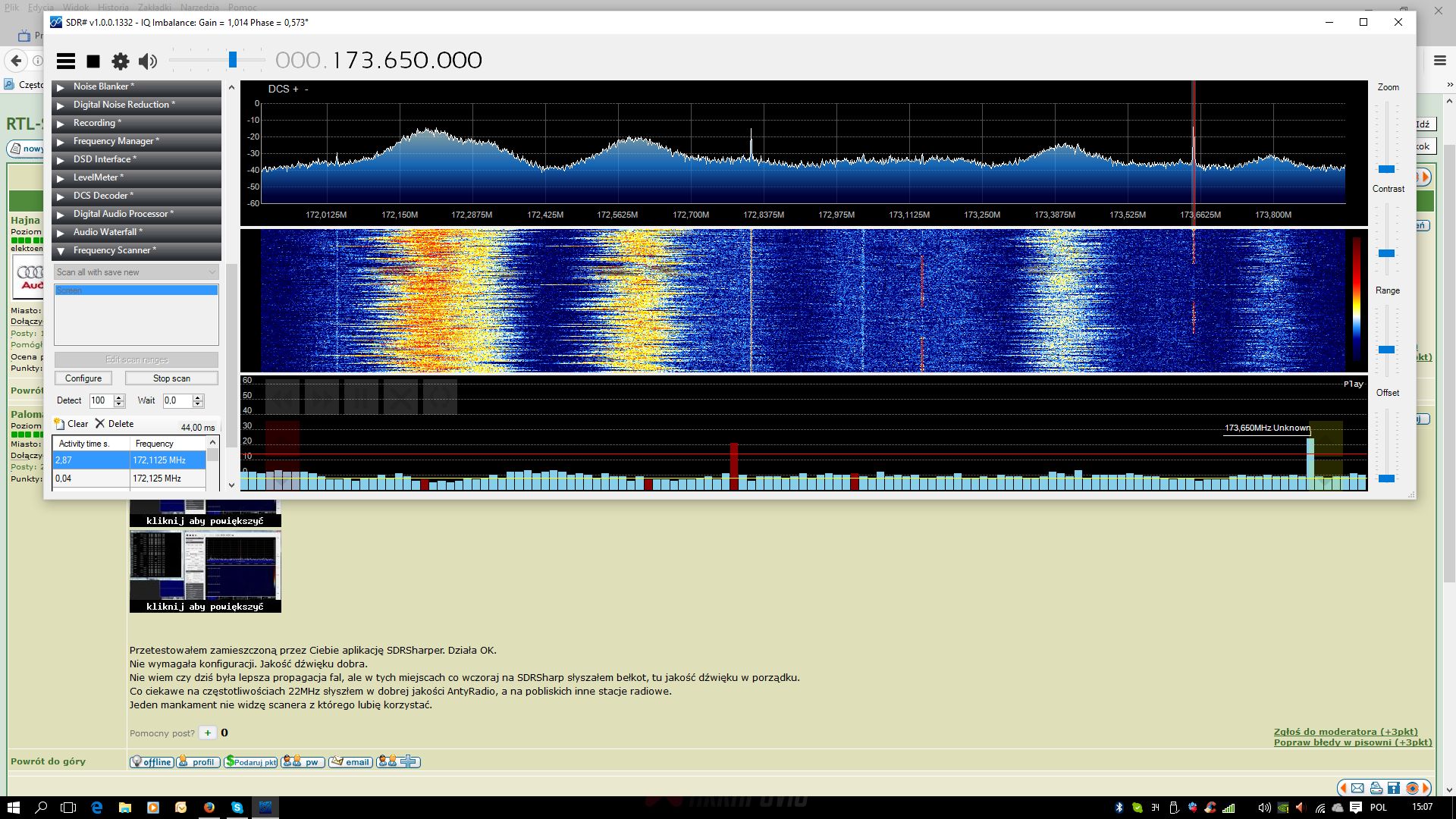

    I tested the SDRSharper application you posted. Works OK.
    It did not require any configuration. Sound quality good.
    I do not know if there was better wave propagation today, but in those places that yesterday on SDRSharp I heard gibberish, here the sound quality is fine.
    Interestingly, I heard AntyRadio in good quality on 22MHz frequencies, and other radio stations nearby.
    One drawback, I do not see the scanner I like to use.

    Well, unfortunately in SDRSharper. no scanner or plugin but there is Vfo and you can quickly switch between the 3 frequencies. In the picture of my SDR they are harmonics from the EC Zabrze chimney How to use RTL-SDR on a cheap USB DVB-T tuner for HF and 64–1700 MHz? where there are a lot of transmitters and I have 500 m to the chimney. How can you, insert your SDR file because it's nice with plugins, maybe it will be helpful for other users.

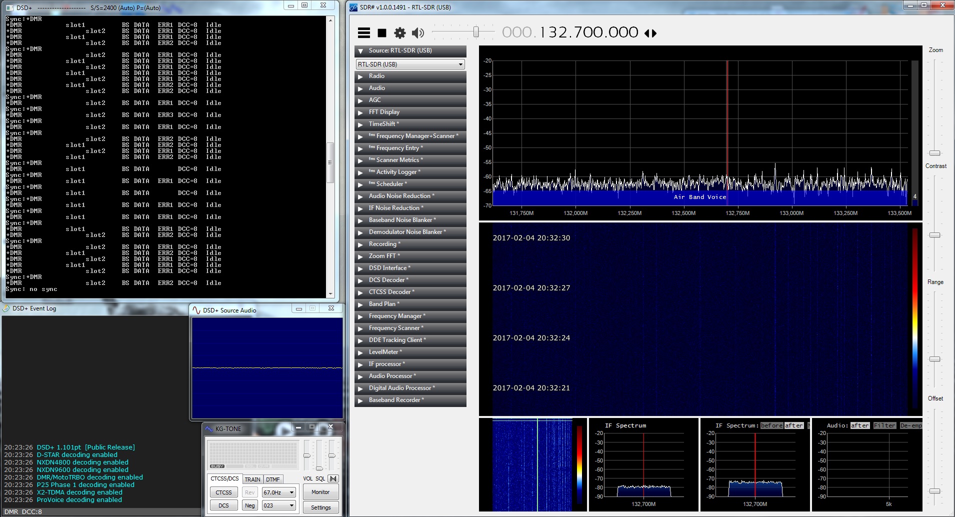

    Popróbowałem na najbliższym SR7LDD działający TX: 438,2250 MHz
    Natomiast RX: 430,6250 MHz cisza, ale pewnie krótko słuchałem.
    Niestety sypie błędami:
    +DMR slot1 BS DATA ERR3 DCC=5 MBC Header ERR11 ECC FAIL
    +DMR CACH ERR slot2 BS DATA ERR3 DCC=12 PI Header ERR11 ECC FAIL
    +DMR CACH ERR slot1 BS DATA ERR3 DCC=1 PI Header ERR13 ECC FAIL
    +DMR slot1 BS DATA ERR3 DCC=1 PI Header ERR14 ECC FAIL
    +DMR slot1 BS DATA ERR3 DCC=12 PI Header ERR11 ECC FAIL
    +DMR CACH ERR slot2 BS DATA ERR3 DCC=5 MBC Header ERR14 ECC FAIL
    +DMR CACH ERR slot1 BS DATA ERR3 DCC=5 MBC Header ERR12 ECC FAIL
    +DMR slot1 BS DATA ERR3 DCC=5 MBC Header ERR14 ECC FAIL
    +DMR slot1 BS DATA ERR3 DCC=1 PI Header ERR12 ECC FAIL
    +DMR CACH ERR slot2 BS DATA ERR3 DCC=12 PI Header ERR14 ECC FAIL
    +DMR CACH ERR slot1 BS DATA ERR3 DCC=1 PI Header ERR14 ECC FAIL
    +DMR CACH ERR slot2 BS DATA ERR3 DCC=1 Idle ERR26
    +DMR CACH ERR slot2 BS DATA ERR3 DCC=12 PI Header ERR15 ECC FAIL
    +DMR CACH ERR slot1 BS DATA ERR3 DCC=1 PI Header ERR11 ECC FAIL
    +DMR slot1 BS DATA ERR3 DCC=1 PI Header ERR10 ECC FAIL
    +DMR slot1 BS DATA ERR3 DCC=12 PI Header ERR13 ECC FAIL
    +DMR CACH ERR slot1 BS DATA ERR3 DCC=1 PI Header ERR12 ECC FAIL
    +DMR slot1 BS DATA ERR3 DCC=1 PI Header ERR11 ECC FAIL
    +DMR CACH ERR slot2 BS DATA ERR3 DCC=1 PI Header ERR14 ECC FAIL
    +DMR CACH ERR slot1 BS DATA ERR3 DCC=1 Idle ERR33
    Sync: no sync
    Zdekodowany sygnał ma taką postać jak w załącznikach.
    Powstają również pliki z rozszerzeniem src lecz nie mogę ich dodać. Forum zabrania.

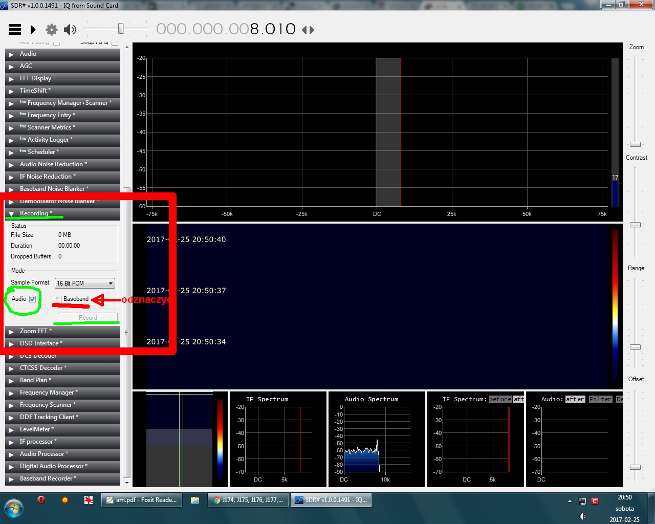

    @PalomaBlanka record a file with properties: .wav (PCM in plugin), 48kHz, 16-bit, mono.
    I mean what's humming, or the "raw" output of the drive that you are listening to.
    Use the AudioRecorder plugin as a tool. You set all options under the Configure button. You set the storage location by selecting Folder Select.
    Just let this file be a little MB, i.e. it comes from a listening session lasting more than 30 seconds.
    If you have a scanner plugin, add more interesting ranges and check what's up in the grass: https://docs.google.com/spreadsheets/d/1M34el...Udz_XY1YRo/pub?single=true&gid=51&output=html

    Use the AudioRecorder quoted by internick a few posts above. But it probably doesn't work with the new versions of SDRSharp, so use the older one, for example: THIS

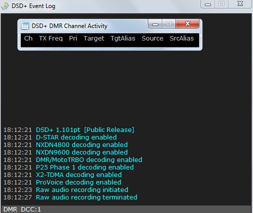

    Or simply while running DSD Plus you click the letter R while holding the shift key. To finish the recording, do the same, click R while holding shift. The recorded file is in the DSD Plus directory as wav. The description in the program window can be seen in the attached photo, it is about the last two lines of the entry start and end of recording.

    As of today, the signal from the converter is decoded by DSD + as the result files, I attach:
    03_DSD-test
    02_DSD_dmr02
    These files can be listened to later. So OK? However, I do not always hear decoded conversations during the listening session. Should it be like that? Is the quality of the attached recorded calls good?
    AudioRecorder saves files in the format recommended by @internick, i.e. wav, PCM, 48kHz, 16-bit, mono I attach a sample
    01_AudioRecorder 19-32-29 Unknown 438.225 MHz
    The file is encoded. Is it supposed to be like that? AudioRecorder should save the raw file?
    I noticed that there is often a frequency shift after the dongle is turned on and warmed up. Of course I correct it, as it had a big impact on the quality of the broadcasts listened to. Should it be so, that corrections are made each time it is started?
    The decoding problem seems to be resolved. On this repeater, which I listened to, transmissions are not very frequent, I was limited in time, that's why I wrote so rarely.
    Please explain what is this signal emitted by the relay, which lasts a few seconds and its representation in the terminal window looks like it is on.
