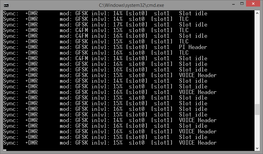

    internick wrote:
    And the second reason is that the signal is too loud in your VAC.
    In the old DSD you can see the% and if it should be 7-8%, you have 15-16%.
    Could you tell me what's going on?
    At the moment I have three versions of SDRSharp and other software that I am testing SDRSharper, rtlsdrscaner, SDRConsole. Sometimes I can get lost ;)
    What parameters on my side should I pay attention to how to configure.
    I noticed that at the same frequencies where I test, sometimes I had a very good quality of the received signal, it was converted and listened to on the fly, and not the next day.
    Probably my ineptitude and unfamiliarity with the configuration of parameters may cause deterioration of the quality of heard transmissions.

    PalomaBlanka wrote:
    ... Could you please tell me what's going on? ...
    Lower the VAV voice level a few units and record the file again. Post it here and I'll tell you if it's okay.
    Now it looks like this:

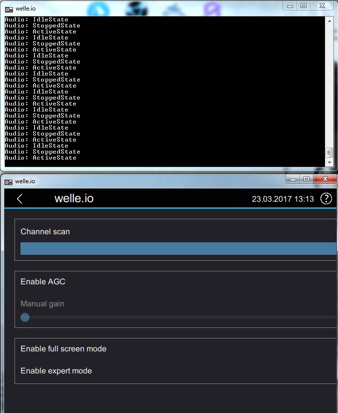

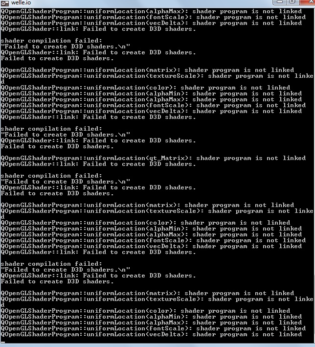

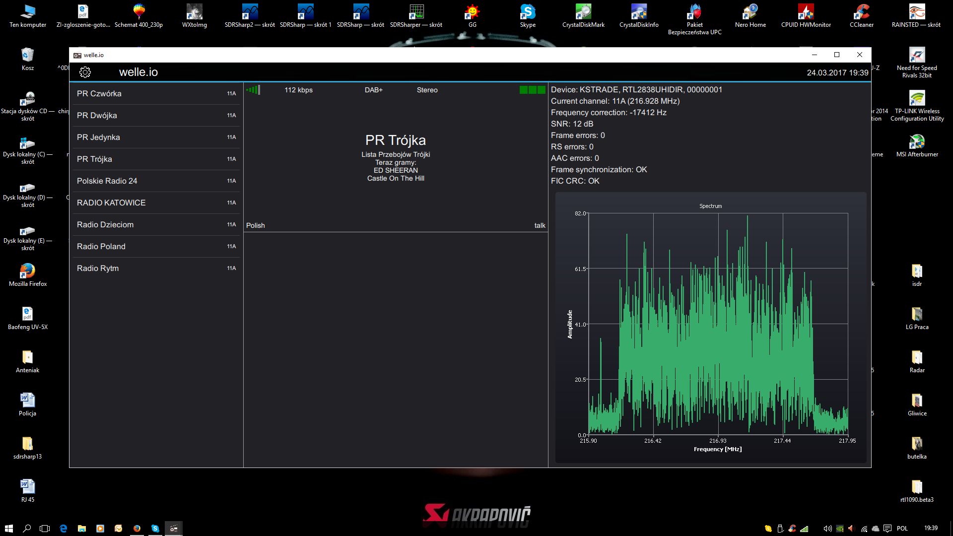

    Hello, I have a question, has anyone tested the WELLE.IO program for DAB + radio on windows 7? https://www.welle.io/
    How to use RTL-SDR on a cheap USB DVB-T tuner for HF and 64–1700 MHz?
    The first version of "20170206_welle-io-setup.exe" is there, it works ok for my friend, and I have a problem with its launch. It installed without problems, during startup, entries like in the photo pop up in the window. I will add that the graphics are integrated with intel and windows 7 64 bit.
    Maybe someone knows what the problem is.

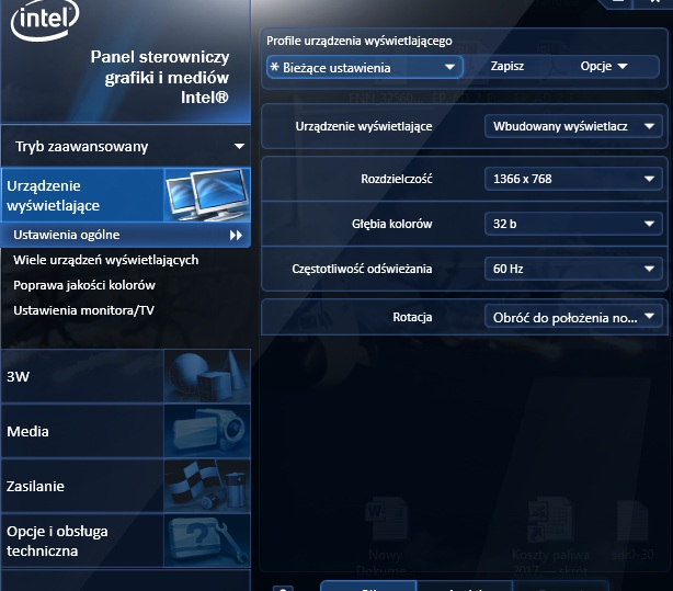

    PalomaBlanka
    Posts: 32
    @don_viking
    Reinstall the graphics drivers.
    You can try the older ones first.
    Not so long ago, I had a similar problem on a two card machine and that's how I solved it.
    The app looks promising, but it's an alpha version, so there may be problems.
    During the installation, I was screaming about errors, I ignored it and installed it anyway.
    The app starts, scans channels, but stops during playback.
    Does this indicate a weak signal?
    The screenshot is attached.
    • How to use RTL-SDR on a cheap USB DVB-T tuner for HF and 64–1700 MHz? welle001.jpg (105.73 KB) You must be logged in to download this attachment.

    Unfortunately, installing new drivers did not help and the same problem continues. From what you can see, it won't work on this graphic. Maybe the next versions will work better.

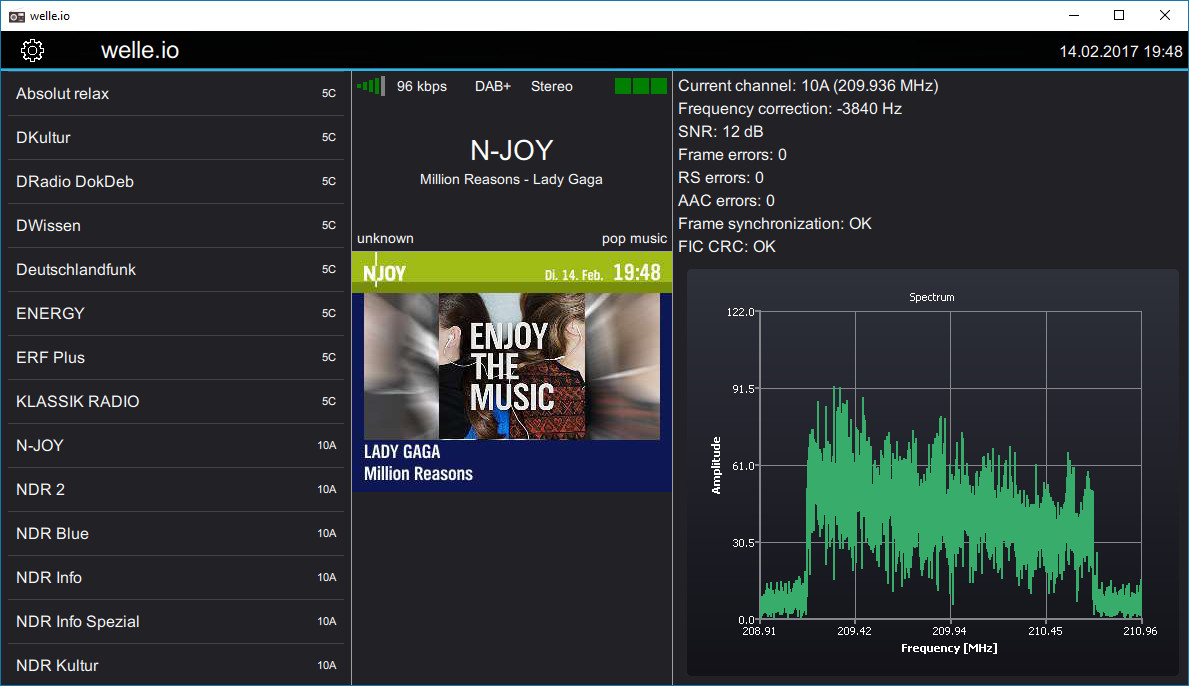

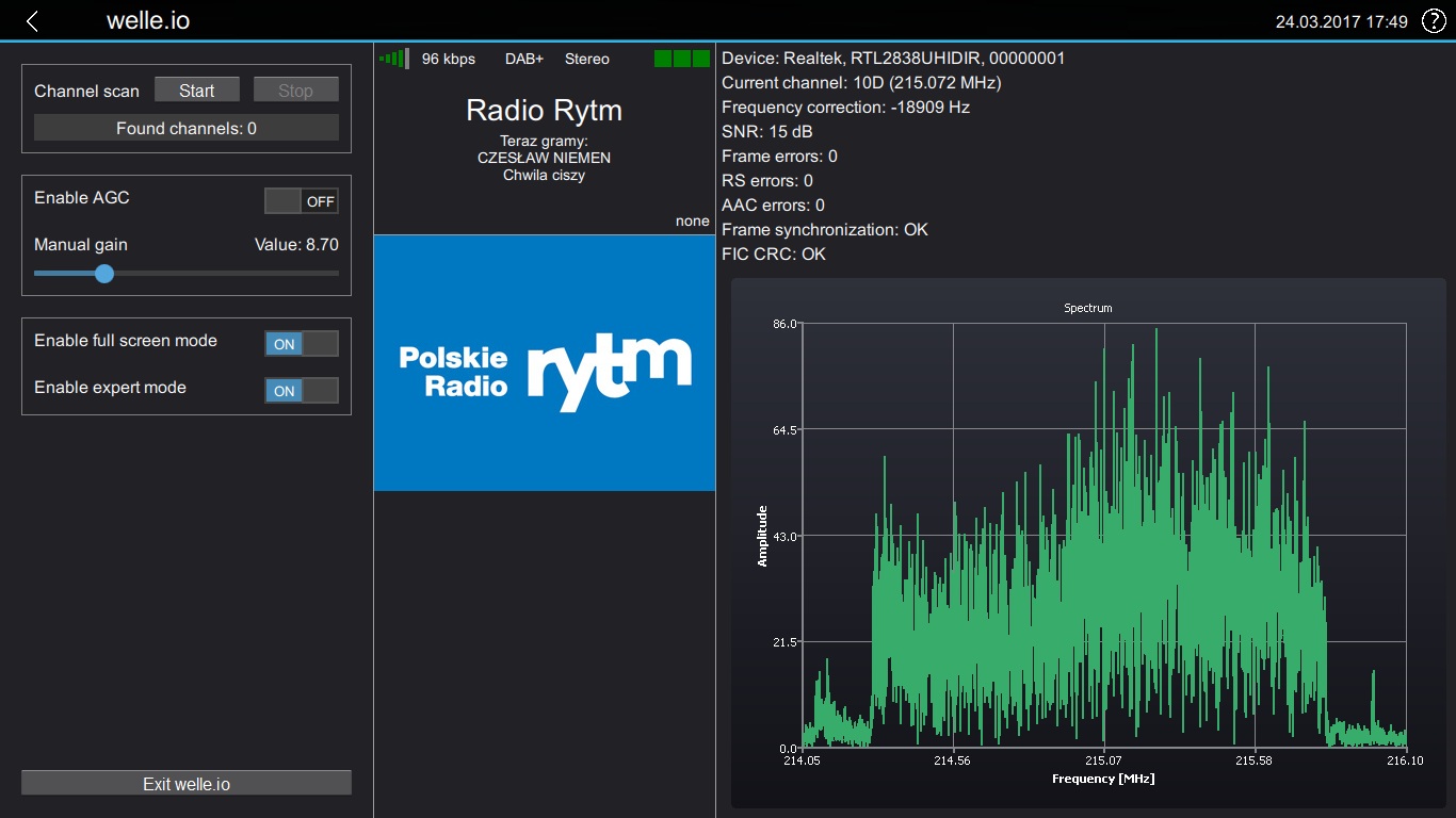

    Hello colleagues, a newer version of this program has appeared and it works great for me. I will also add that I uninstalled the graphics drivers and downloaded newer ones. I also updated DirectX and got a few versions of Microsoft Visual c ++ installed. Now the sound is better than the SDR-J and the window looks like this.
    Thank you to everyone for your help and tips here in the topic and in the news at PW.

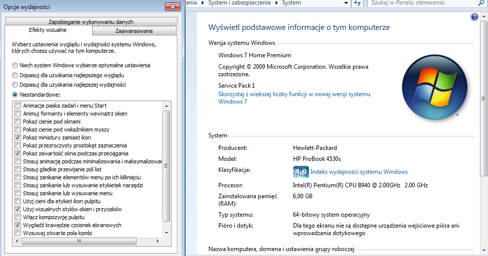

    don_viking
    Level 21  
    Posts: 562
    Help: 14
    Rate: 136

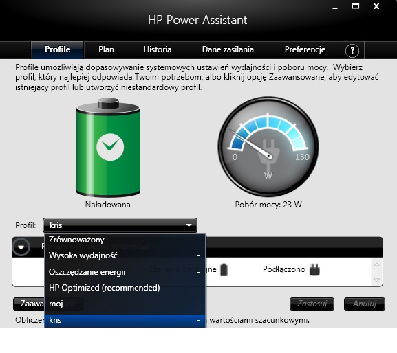

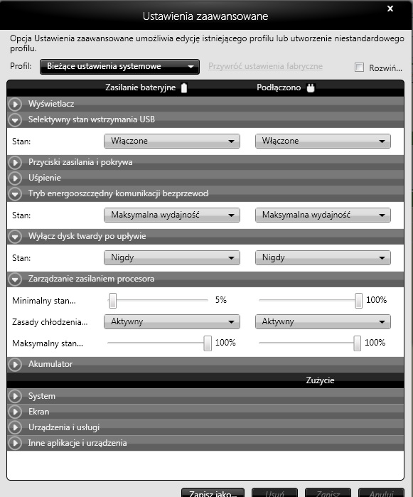

    Hello everyone, I wrote about the WELLE.IO program for DAB + radio on windows 7. https://www.welle.io/
    To all those interested in improving the sensitivity of this program, I recommend testing the rtlsdr.dll file included in the attachment. Just copy it to the program directory and replace it. This is the file from the package for the sdrsharp program extending reception to almost 2 GHz, which was once available on the network. After my tests, I noticed an improvement in the sensitivity of the program by some 3dB.
    By the way, I have another question. Does any of your colleagues have a program that analyzes the digital signal in real time, which would also show the constellation of the signal? My point is that the program should show points as in the second picture, not lines as it can be seen in the sdrangel program, second picture.
    • rtlsdr.rar (102.69 KB) You must be logged in to download this attachment.
  • #1132 16430490
    rtvstefan
    Posts: 22
    BOOM i ZONK wrote:
    @rtvstefan The question of setting probably, play Sample rate and FFT Display >> resolution
    Unfortunately, the fun with the settings did not give me a single-core 2.2G 1G graphics, that's probably not enough. Best regards !
  • #1133 16430687
    don_viking
    Level 21  
    Posts: 562
    Help: 14
    Rate: 136
    rtvstefan wrote:
    There is also the issue of setting Windows to use as little memory and CPU as possible. I also had a problem with this on Windows 7 and the HP laptop. You can see my settings in the pictures. There is also the matter of setting the power profile. I have created mine from sustainable or energy saving, I don't remember exactly. As I was doing with maximum performance, the CPU load was so high that the program crashed. The matter of trying on different options.
    How to use RTL-SDR on a cheap USB DVB-T tuner for HF and 64–1700 MHz? How to use RTL-SDR on a cheap USB DVB-T tuner for HF and 64–1700 MHz? How to use RTL-SDR on a cheap USB DVB-T tuner for HF and 64–1700 MHz?

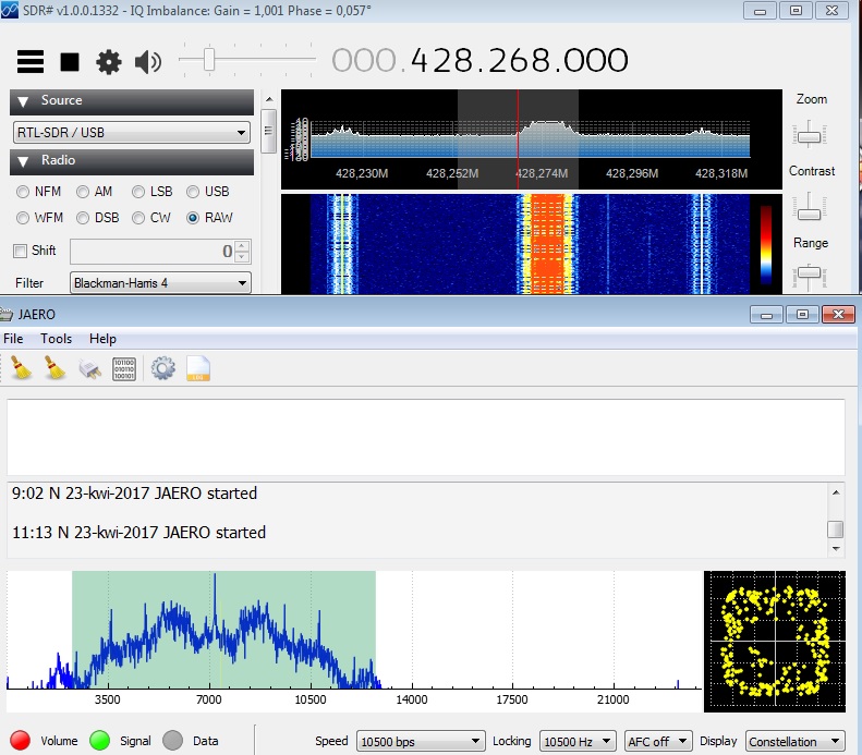

  • JAERO output mismatch and GRC fails to launch
    #1135 16444009
    don_viking
    Level 21  
    Posts: 562
    Help: 14
    Rate: 136

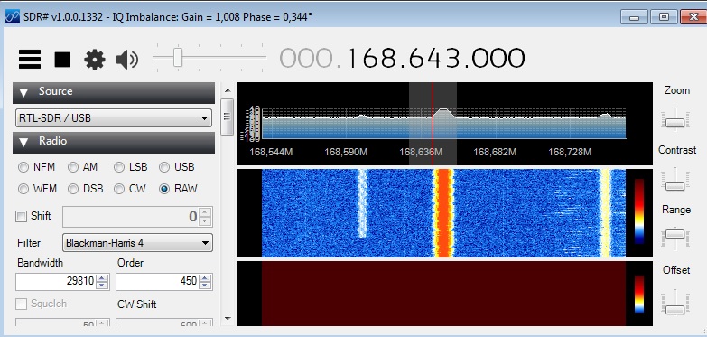

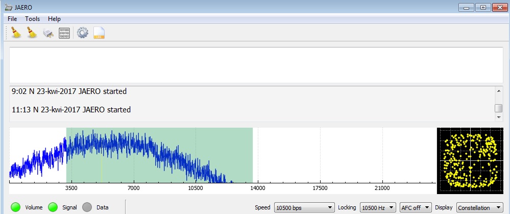

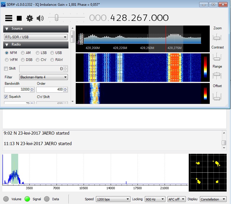

    Hello, I tested on the JAERO program in FM and RAW, but it is not what it should look like.
    Maybe colleagues would test and write how this program behaves with them. By the way, I will ask if anyone has installed GNURadio on windows 7 and if they can run GRC. For me, it does not turn on at all. Maybe someone has some ideas what the problem is, I will add that other shortcuts work properly and I can, for example, turn on the scanner.
