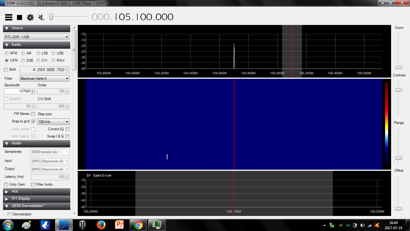

    I have a DVB-T usb tuner, I bought an adapter for it. Thanks to it, I was able to connect a previously purchased indoor antenna for DVB-T reception. The program shows me squelched at - 99 dB. Only the analogue FM radio is available for reception. Everything is fine on the wire attached to the tuner, but I do not receive anything except the FM radio. I have the tuner connected in my apartment, the antenna is not exposed to the window. What do I need to do to hear anything except the radio?
  • #1163 16598220
    yes2mike
    Posts: 3054
    Help: 258
    Rate: 322
    Click the "gear" in the upper left corner and increase the gain.

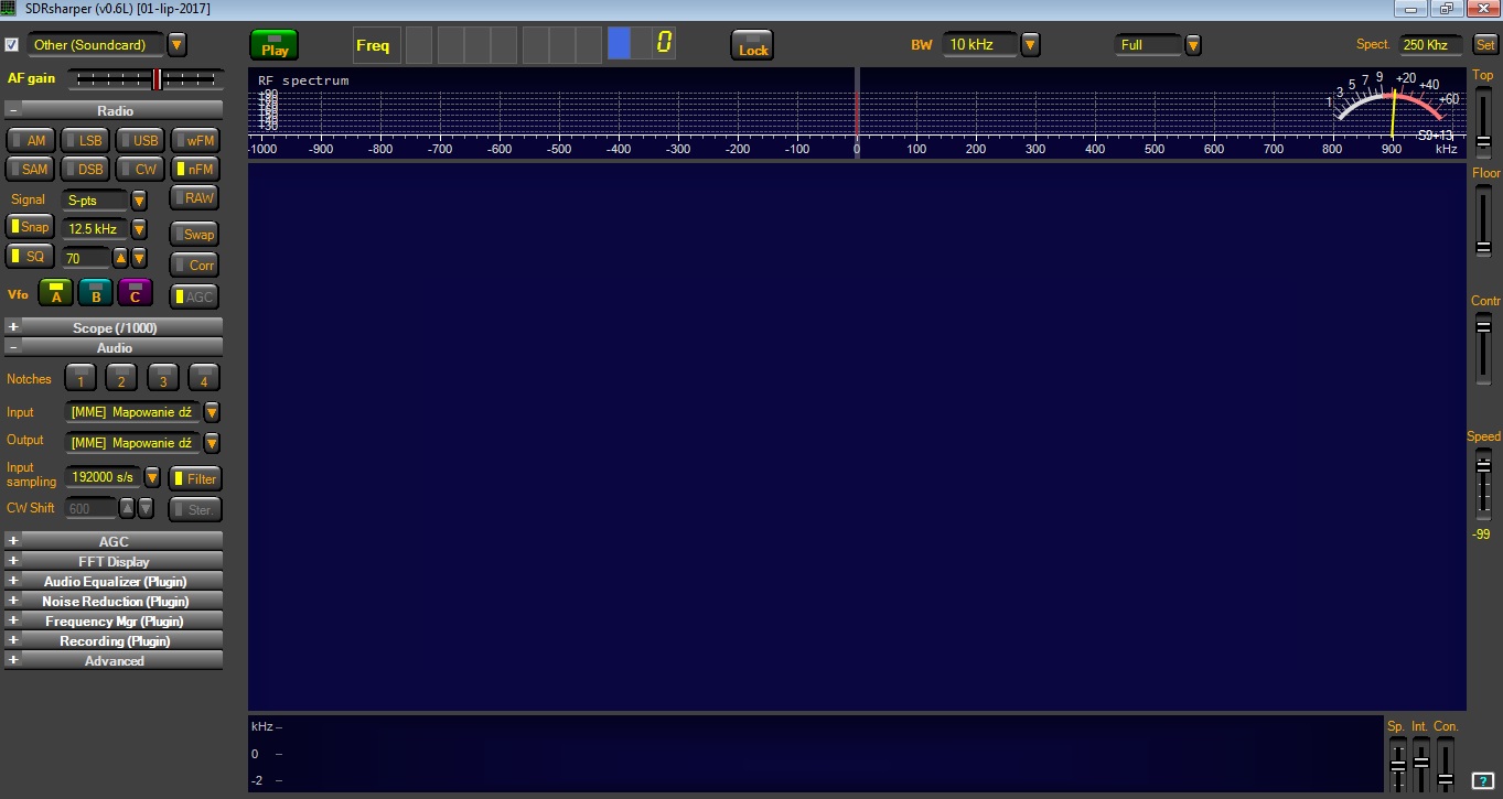

  • #1167 16616026
    Kubas
    Posts: 10
    Gentlemen, I have a problem with running SDRSharper, the program crashes during startup, I tried on several different versions and it is the same on all of them, probably something wrong with my computer, but how to locate the problem .....?

    don_viking wrote:
    The link is signed 0.5L but the version is 0.6L. You download it and you will see.
    I checked you are right.
    Although I think it's better to change the name.
  • #1169 16616412
    don_viking
    Level 21  
    Posts: 562
    Help: 14
    Rate: 136
    You have to start with the correct mask. I added an already set program in the attachment.
    • SDRSh-06l.rar (3.88 MB) You must be logged in to download this attachment.
  • #1170 16618659
    Kubas
    Posts: 10
    Thanks, I downloaded it, I will test it soon, I will let you know what came out of it.
    Unfortunately the same, ie the program won't start.
