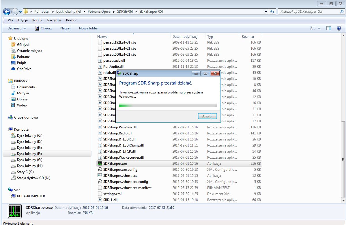

    Kubas wrote:
    Thanks, I downloaded it, I will test it soon, let me know what came out of it
    unfortunately the same, i.e. the program does not start
    Then maybe you have a problem with the tuner or the system. If you get a message during startup, upload a photo of what it looks like. And the additional question is whether the tuner works for you on other programs such as HDSDR or SDRSharp.
  • #1173 16620200
    Kubas
    Posts: 10
    Gentlemen
    RTL_SDR works on other programs without any problem SDR #, SDRConsole, HDSDR
    when starting SDRSharper there are no errors except the window that the program has stopped working,
    I tried to run in Win XP SP3 compatibility mode but the same
    maybe it needs to be run from some specific directory? I have no idea what could be wrong
    How to use RTL-SDR on a cheap USB DVB-T tuner for HF and 64–1700 MHz?
    Added after 8 [minutes]:
    I think I know what's wrong, I don't have the .net 3.5 framework because it is required
    unfortunately I will have to reinstall the system because I have a problem to install it ...

    Kubas.
    In the control panel (Add remove P ...) what are the NET Framework? Click on the blue fonts, it will open Microsoft's website with the NET F ... versions.

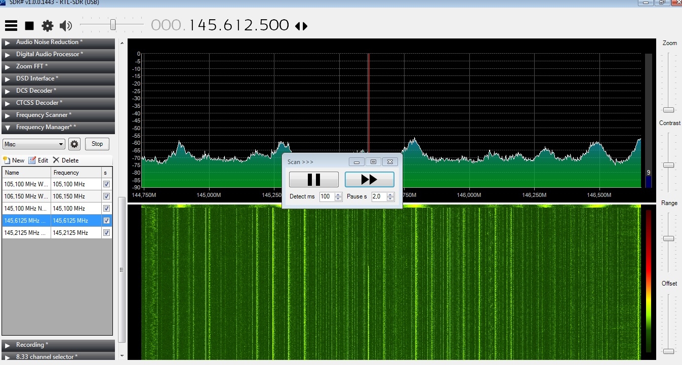

    Is there any add-on to SDRSharp that automatically switches between frequencies, e.g. observed frequencies X, Y, channel X is transmitting something and SDR automatically starts receiving it, X stops and Y transmits and SDR automatically starts receiving Y ...
  • #1182 16676578
    don_viking
    Level 21  
    Posts: 562
    Help: 14
    Rate: 136
    "Arek_v1" There is such a function. You save the frequencies in the manager, then select the frequencies that interest you and click start as you can see in the photo. In the attachment I have uploaded the sdrsharp version with most of the useful plugins. Everything works because I checked. I greet everyone.
    Alternatively, you can find something for yourself on these pages.
    http://sdrsharp.pbworks.com/w/page/62589136/FrontPage
    http://rtl-sdr.ru/category/plugin
    https://www.rtl-sdr.com/sdrsharp-plugins/

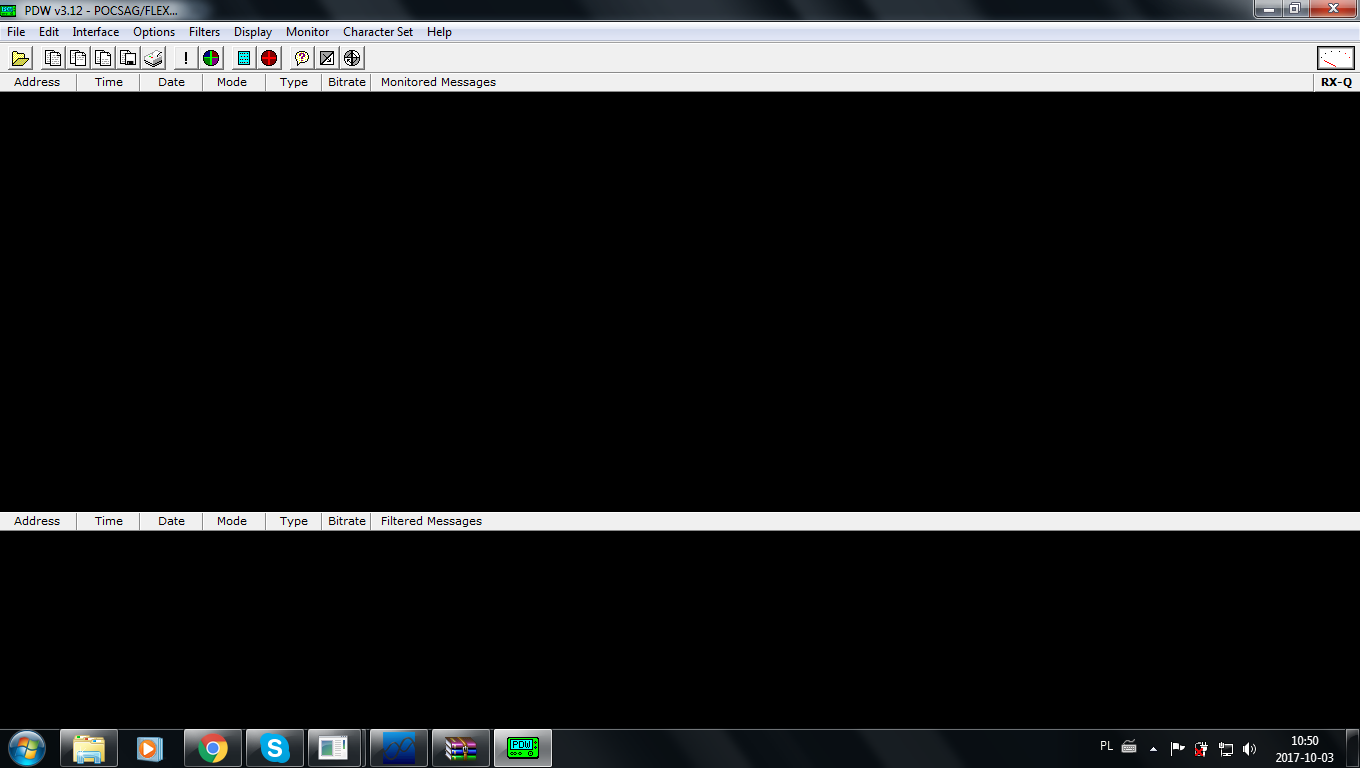

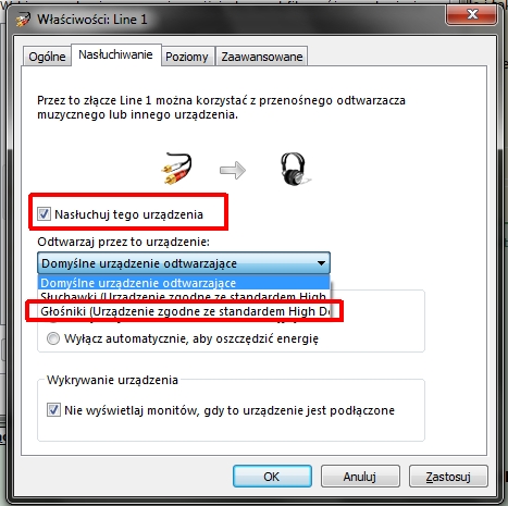

    Hello, does anyone know how to use this program? the sound will go from RTL - SDR
    Added after 42 [seconds]:
    screen here
    • How to use RTL-SDR on a cheap USB DVB-T tuner for HF and 64–1700 MHz? Screenshot - 2017-10-03 , 10_50_05.png (73.81 KB) You must be logged in to download this attachment.
  • #1191 16735009
    jdubowski
    Tube devices specialist
    Posts: 21595
    Help: 2511
    Rate: 2804
    This? What?
    The fairy is free, describe what you want to do and what. ;)
  • #1192 16735012
    patryk5c1
    Posts: 38
    I would like to decode radio signals from the so-called pagers or something like that using the PDW program
  • #1194 16735325
