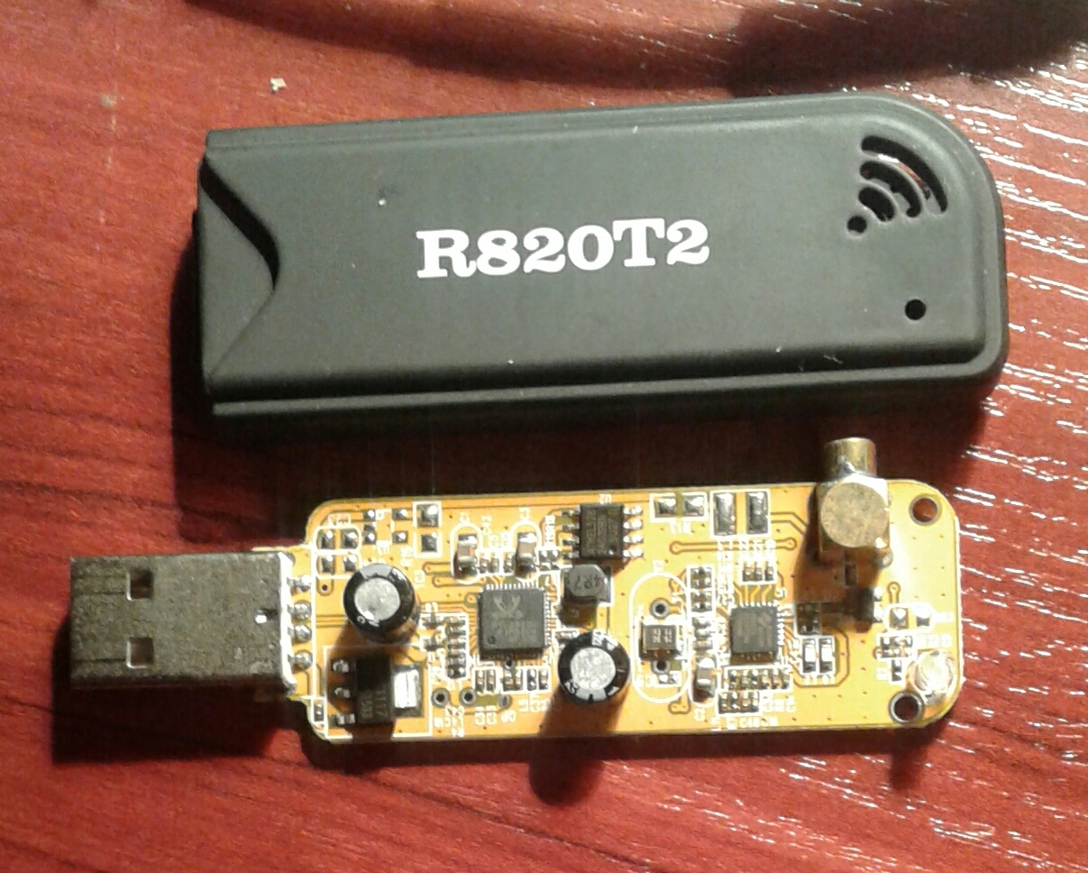

    The blue toy has the R820T2 tuner chip and the LV5TDLX has the FC0013.
    By the way, the LV5TDLX tuners are susceptible to damage caused by short circuits. I myself have burned some of them. I recommend mounting the device through an antenna separator. Signal too strong may also be a problem. Sometimes a relay operating nearby can cause these effects.

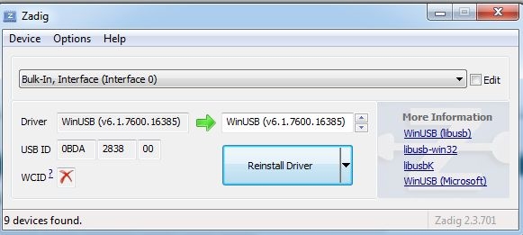

    Gentlemen, help me install rtl-sdr because my hands are dropping.
    The amateur bands do not work for me.
    I have such a thing.
    How to use RTL-SDR on a cheap USB DVB-T tuner for HF and 64–1700 MHz?
    I do the installation like this.

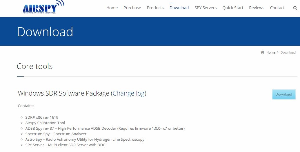

    1. On the part https://airspy.com/download/ i download this software.
    2. I run install-rtlsdr and download ZADIG
    3.In Zadig, I install drivers for BULK

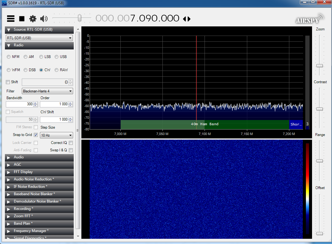

    In SDRDharp I choose the RTL-SDR (USB) device and ...... everything works but only from about 30-40MHz up.
    For example in the amateur band 40m, total silence. And the signal from the antenna is 100% because it works well on the HF radio.

    m72 wrote:
    ... amateur bands do not work for me ...
    What kind of KF converter do you have?
    Just don't write that you don't have any :) .

    unless you make a fashion for direct sampling
  • #1209 16814997
    BOOM i ZONK
    Level 22  
    Posts: 597
    Help: 21
    Rate: 73
    Click on the gear symbol and switch from Quadrature Sampling to Direct Sampling.

    99% of the version shown in the picture will not work, you have to make a hardware mod
    without direct sampling, you can work from 24Mhz - you can see a clear signal switching when you exceed this frequency

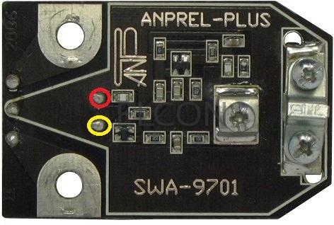

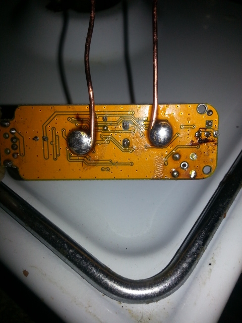

    I suggest making a good preamplifier and connecting it between the USB tuner and the antenna. I have already mentioned such a solution once because I use it myself. In order not to play with the assembly of the preamplifier from scratch, I used the SWA9701 board from the broadband antenna. The only thing I replaced were the transistors and I used them from an old cell phone, they had the symbol "R2p", it was probably BFR93A, and I removed the balun and connected the antenna directly to the output of the balun on the board (ring with a wound cable). In the photo I marked where to connect the antenna. You can still play with matching capacitors and resistors, but the effect was so good that I didn't do it.
    Yellow color of the mass
    Red main vein
    For me it works great, I receive signals that I did not receive before and I do not have to turn on the AGC, and the amplification is around 20.
    By the way, I have completed the database of programs for the sdr tuner ready to use in the topic I am promoting below.

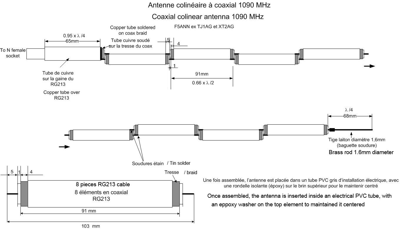

  • Even-element antenna design for 1090 MHz, 2 m, and 70 cm
    #1225 16970516
    don_viking
    Level 21  
    Posts: 562
    Help: 14
    Rate: 136
    If someone would like to make a good single-band antenna with a good profit, I recommend this diagram in the picture. I have 3 pieces, one at 1090 MHz, the second at 2 m and the third at 70 cm, all of them work perfectly. The selection of the number of elements must be individually adjusted by everyone, preferably an even number as shown in the drawings, so that the radiator at the top connects to the cable's main conductor. As for the length of the elements, there is a formula for calculating for a given frequency. I would like to add that when making an antenna for 70 cm with a certain number of elements, the antenna also receives good reception at 2 m. I don't remember how many elements it was, but when I added more, the sensitivity dropped drastically on the 2m band.
