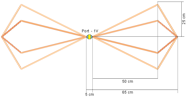

    BOOM i ZONK
    Level 22  
    Posts: 597
    Help: 21
    Rate: 73
    From simple, typically one-band antennas, I can recommend "Vertical Double Bazooka". I made 3 versions of this antenna, each from a different coaxial cable: RG58, K-15 (old Polish military 50Ohm cable) and RG6 - probably the cheapest 75 Ohm aluminum bought at Dipol 'at. I believe that the RG6 version is the most effective. It is a DC short-circuited antenna so it will pick up less static. Currently, in my opinion; it completely outclassed the simple dipole. I made it based on the calculations of the VE3SQB program (attached).

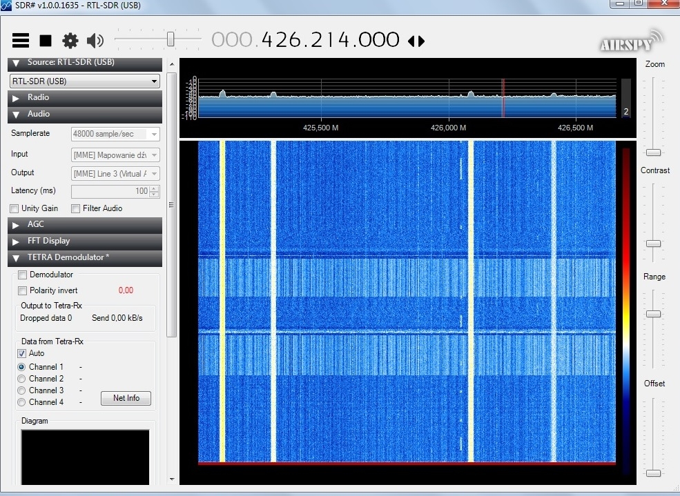

    Instead of arguing, I have a request if someone can upload the SDRSharp ready with the TETRY plugin, I can't download it for the hell, I would like to test it. Thanks in advance for the trouble.
  • #1251 16988129
    don_viking
    Level 21  
    Posts: 562
    Help: 14
    Rate: 136
    The latest version with the plugin is attached, but you need to set the ppm. And before starting the demodulator, start the "startrx" service in "msys2_shell.cmd".
    • sdrsharp TETRA.rar (1.66 MB) You must be logged in to download this attachment.

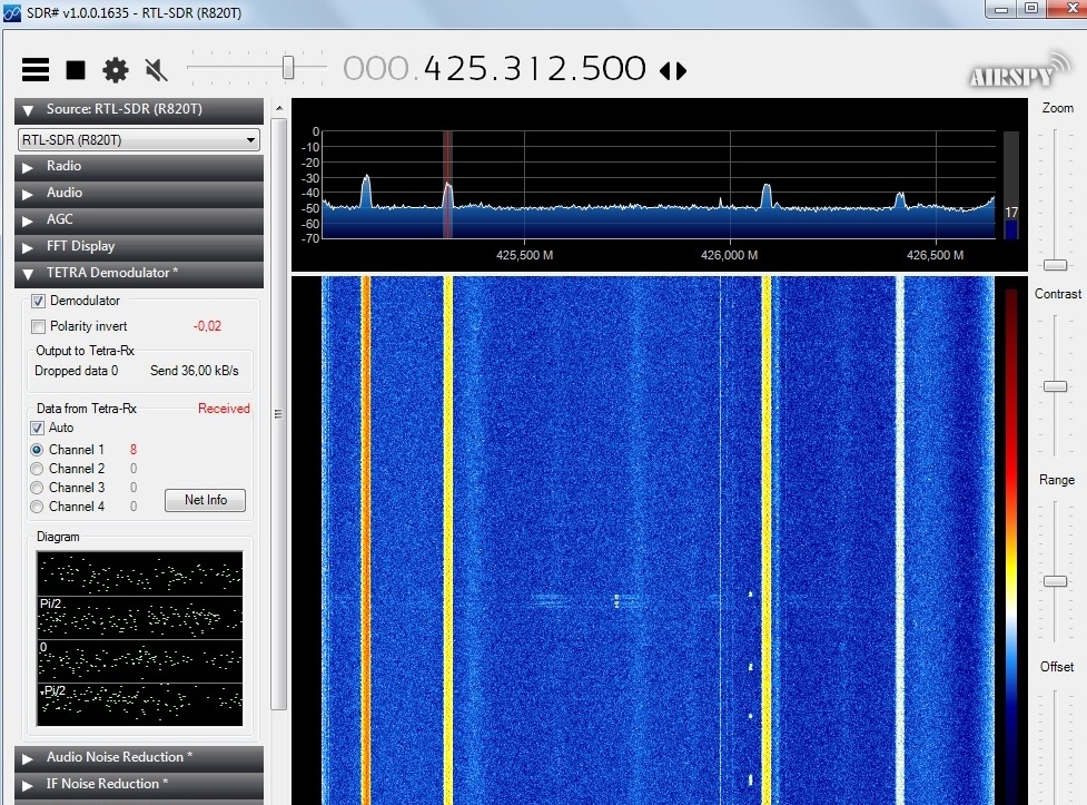

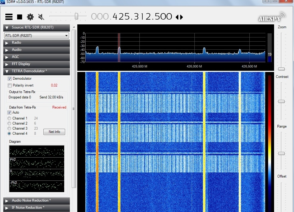

  • #1252 16988507
    tdrk14
    Posts: 27
    For me it's black magic, "you just have to set your ppm" what is this? Then I run "MSYS2 MinGW 32-bit" and enter the password "startrx" on the black field, I do enter and the message "bash: startrx: command not found" I need to explain it vaguely.
  • #1253 16988994
    BOOM i ZONK
    Level 22  
    Posts: 597
    Help: 21
    Rate: 73
    And you copied the entire contents of the "msys_root" folder to MSYS (/ usr / bin)? After copying "pacman -S socat" in MSYS console. Only then "startrx" and finally run SDR # with the plugin installed.
