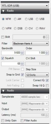

    Thank you again for your answer. I changed the city (bigger and higher "I'm sitting") so I will try to decode something, because unfortunately in my hometown there is an analog on the repeater.
    In the city where I am now, I hear something like that - could you tell me what it is and is it possible to decode it? Is it also DMR?
    Best regards.

    Hmm switchboard? So it won't do me any good?
    Oooo great! The samples will be very useful. Thank you very much!

    You need to extend your bandwidth. Preferably up to around 60KHz. You will do this either on the strip underneath the emissions or by simply extending the strip with which you hover over the transmission. The signal cannot be noisy because there will be a loss on the frames. In my region, the emergency service has switched to MOTOTRBO, you can search on 168MHz. If it growls, try to decode. At 157MHz, you can't count on decoding without gimmicks. Same on the 172-174 band. The thing is that you can only listen to the VHF 2m band and the ambulance without the combination. Forget about border guards, prison guards, CBŚ, CBA and in some cases the police. In some, because in many cities, analog transmission and MOTOTRBO are used together with the advantage of the former. There is a reason for this. Digit does not like built-up areas with their reflections and sudden signal drops very much. Paramedics complain that there was once a buzzing noise, but it was. Today, in these places, you can hear nothing - there is no communication. The radios are terribly expensive, the possibilities are like a Swiss army knife, but with one major disadvantage, if the signal starts to drop, it will be noisy, the transmission will be completely unreadable.
    Do not mislead your buddy and write such nonsense that you have to set the bandwidth to 60kHz to receive DMR frames well. On the contrary, the band should be set wide enough for a given modulation so as not to pick up noise next to it, because it also has its own audio frequency and the DSD + program will decode the modulation with errors.
    First, my friend, read exactly "what and how and with what" and then advise. Below I am giving the width of the NFM bandwidth setting. It is included in the description of the FMP program, so that the DSD + program with VAC decodes well the modulation for the given modes. You can find it in the file downloaded from the dsd + website. I would like to add that after my DMR tests in the SDRSharp program it is best to listen to narrow FM with a width of 9.5kHz.
    4 kHz modes:
    D-STAR
    DSTAR
    IDAS
    NX48
    NEXEDGE48
    7 kHz modes:
    DMR
    TRBO
    Cap +
    Con +
    TIII
    9.5 kHz modes:
    NXDN
    NEXEDGE
    NEXEDGE96
    NX96
    P25
    12.5 kHz modes
    PV
    ProVoice
    C4FM FUSION
    any other text string (analog, LTR, ...)
    Best regards and I wish you successful listening sessions. I recommend reading this topic as reading.
    https://www.elektroda.pl/rtvforum/topic3182271.html
  • #1270 16997088
    Piter K.
    Posts: 840
    Help: 21
    Rate: 44
    TRBO is officially 6.5KHz but from my experience I know that the signal goes beyond this. 60KHz may be an exaggeration, but such filters used to be used to receive various digital transmissions. There is nothing to argue about, if he set it to 60 he would surely receive the signal without distortion. Anyway, just look at the waterfall. If I hadn't seen, maybe I would have believed in paper. But I have seen and know that TRBO transmits more widely than normal transmission, analog voice transmission. If the radios have a 12.5KHz filter, it should go like this. And yet I have seen stripes close to 25KHz, I cannot assume that this is the norm. The general rule is that the reception bar should cover the entire signal band. No matter how much he has. If it is narrower, distortions will appear. In the past, I have to use this phrase, because I can see that it has changed, digital data transmission had to use a wider band than voice transmission. And yes, there were 50KHz filters, or 2X25KHz for packetradio 9600. No matter A colleague may narrow the band, maybe it will be better ;)

    Buddy, you are confusing the two basic concepts of audio transmission width and channel width. Receiving frequency with channel width, e.g. 9.6KHz with 48KHz audio transmission width. This is the basic mistake many people make. Take a look at the photo and think about what I wrote and what you write. "Bandwidth" is the width of the receive channel and it should be max 1kHz larger than the transmitted signal, ie example C4FM FUSION has a channel width of 12.5kHz you set around 13.5kHz then DSD decodes well. And "Samplerate" is the width of the received audio and is not the same as the width of the channel. Therefore, 48kHz is set there and this is the basic setting for digital modulation.

    Thank you for your comprehensive answer. Nevertheless, I believe that TRBO has a broader signal than analogue voice broadcasting in FM. This can be traced nicely on the police band. But that is not the topic. If it goes as it should, it is OK and there is no need to beat foam. Although, even on this occasion, you can learn something for which I thank you.

    Yet, regarding the received signal on the waterfall, there is no point in taking into account its width. The fact that it is visible wider in the spectrum does not mean its natural channel width. Simply by SDRSHarp, reflections are visible with strong signals. For comparison, in the photo you have a strong and weak signal transmitted on the same frequency and the same bandwidth. I consider the discussion on this closed to be closed. Best regards.
