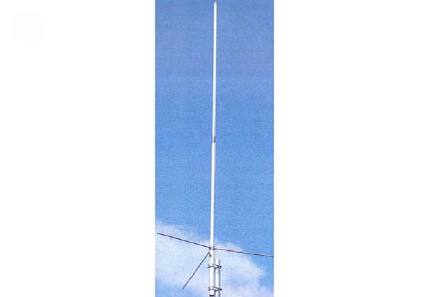

    In my opinion, GUMISIU is best to buy a Japanese for a "base".
    How to use RTL-SDR on a cheap USB DVB-T tuner for HF and 64–1700 MHz?
    DIAMOND X-6000 - Basic VHF / UHF / 1.2GHz Antenna
    https://www.inradio.pl/sklep/producent/2015-0...95573/44/anteny-vhf-uhf/anteny-bazowe-vhf-uhf
    The Diamond X-6000 antenna is a base solution for three amateur radio bands. The 2m band in the antenna has an electric wavelength: 2x5 / 8? with a gain of 6.5dB, while the UHF band - 70cm has already 5x5 / 8? and works with a gain of 9dB, while the 23cm-1.2GHz band has a gain of 10dB and consists of 6x5 / 8?. The whole X-6000 weighs 1.8 kg and is windproof up to 50m / s. The full length of the Diamond x6000 antenna is 3m and can operate with powers from 60 to 100W. The antenna is made of two sections that are folded for transport. Simple design for radio amateurs who do not need a long antenna but consider high efficiency in operation.
    The X-6000 antenna is a compact type for electrostatic voltages, and made in DJS for easy installation and water resistance.
    Technical data of the base antenna DIAMOND X-6000
    Band: 144/430/1200 MHz
    Gain: 6.5dB (144MHz), 9.0dB (430MHz), 10.0dB (1200MHz)
    Max. power: 100/100 / 60W
    Length: 3.05m
    Weight: 1800g
    A: to the wind: 50m / s
    Type: 2x5 / 8? / 5x5 / 8? / 6x5 / 8?
    Connector: N
    If someone prefers to have more profit, I recommend DIAMOND X-7000, but this one is 5m long ?? ......

    Rate: 555
    @ neo386 and you vouch for the correct reception apart from the resonance of this X6000.?
    There have already been complaints about the X300, X510 that they are deaf beyond the dedicated frequencies, so it will be similar here.
    But ... I did not have, I did not measure, I only warn you.

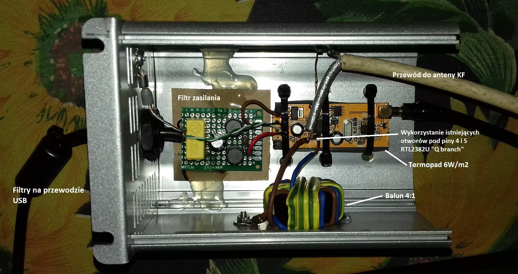

  • Paraffin-oil cooled SDR receiver enclosure modification
    #1302 17345563
    Arek_v1
    Posts: 124
    Help: 7
    Rate: 25
    I would like to show the modification of my sdr receiver, the receiver is tightly closed in the box (the box is double to make the terminals outside) the receiver is closed in the inner box and it is flooded with paraffin oil, thanks to which the receiver itself is much cooler, the usb outputs have been introduced thanks to the holes in laminate and the antenna cable was led out through a copper tube into which the core of the antenna cable (wire and plastic insulator) was glued.
    How to use RTL-SDR on a cheap USB DVB-T tuner for HF and 64–1700 MHz? How to use RTL-SDR on a cheap USB DVB-T tuner for HF and 64–1700 MHz?
    30cm of cable and nothing

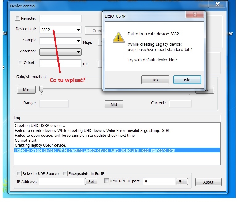

  • #1310 17439012
    marian1981.02
    Unitra equipment specialist
    Posts: 11268
    Help: 989
    Rate: 756
    Can someone help me run this?
    I installed according to this http://ywd.pl/projekty/odbiornik-sdr/
    And an error pops up:
    I have such a tuner
    I think it's about the "Device hint" window, but I tried to enter differently there, for example, the tuner model and nothing helps.
  • #1311 17439135
    internick
    Level 36  
    Posts: 3081
    Help: 273
    Rate: 555
    This is the first time I see it.
    I do that. Give it a try.
    I connect the tuner. Windows tightens its drivers. If there is no Internet connection, I add the drivers from the disc.
    I replace the driver with Zadig: http://sq6net.blogspot.com/2014/07/instalacja-rtl2832u-i-sdr-na-windowsie.html
    (points 1-6 you let go)
    And you have the latest Zadig here: http://zadig.akeo.ie/downloads/zadig-2.4.exe
  • #1312 17439211
    marian1981.02
    Posts: 11268
    Help: 989
    Rate: 756
    But it won't do me any good by itself. I have to have this ExtIO RTL.DLL because it is the driver that performs the replacement.
    What you provided in the link, nothing works there anymore. Fuck ... it is. I have a driver CD but everything is there but not what you need unless I'm blind and can't find it.
  • #1313 17439242
    internick
    Level 36  
    Posts: 3081
    Help: 273
    Rate: 555
    You do too much.
    Do what I wrote, i.e. if you have the Internet, he installed it himself and treat it with Zadig.
    If not installed, point him to the CD and after he will install Zadig.
    And the fact that, for example, in SDR Sharp you can not see it because it is for E4000, these are classic and modified .dll libraries.
  • #1314 17439249
    marian1981.02
    Posts: 11268
    Help: 989
    Rate: 756
    I did so and when I ran SDRSharp, it pops up that there are no drivers.
  • #1316 17439294
    marian1981.02
    Posts: 11268
    Help: 989
    Rate: 756
    What you entered pops up to be in the wrong format.
  • #1317 17439304
    internick
    Level 36  
    Posts: 3081
    Help: 273
    Rate: 555
    I just downloaded, unpacked it, and it works, so there's probably something wrong on your side.
  • #1318 17439317
    marian1981.02
    Posts: 11268
    Help: 989
    Rate: 756
    It doesn't work for me. I don't know what is, I'm not an IT specialist.

How do I add HF direct sampling without removing the tuner?
On R820T boards, wire a 1:10 transformer to RTL pins 4-5, select “Direct Sampling Q” in SDR#. This keeps VHF/UHF intact [Elektroda, BOOM i ZONK, post #13914702]
