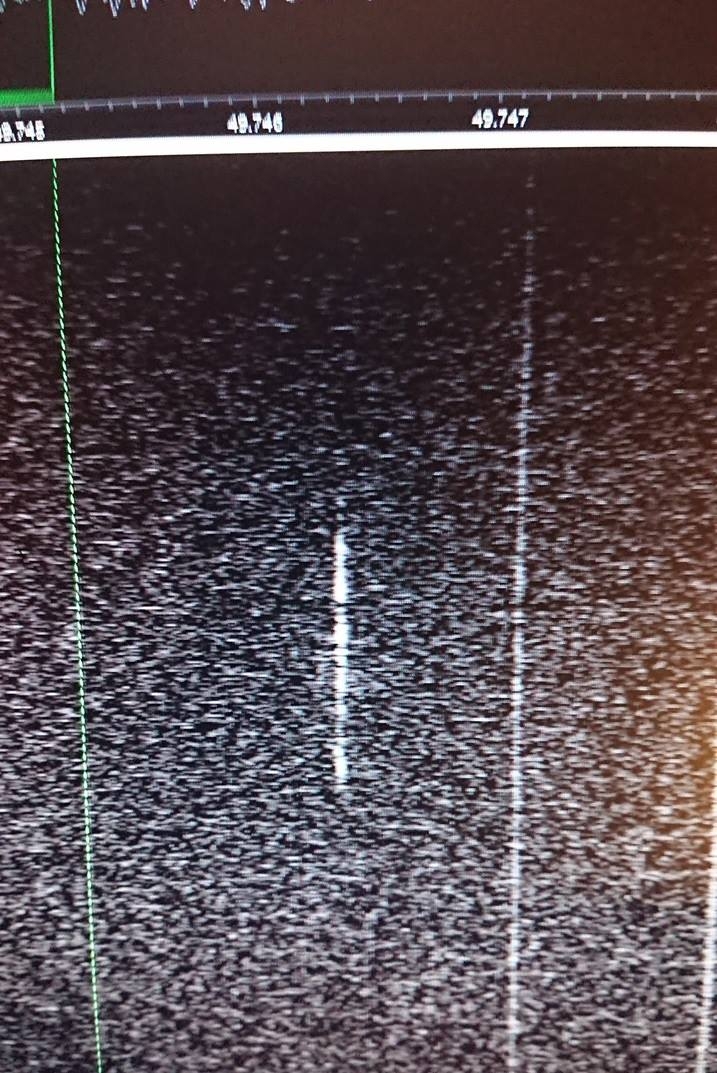

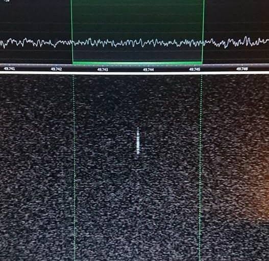

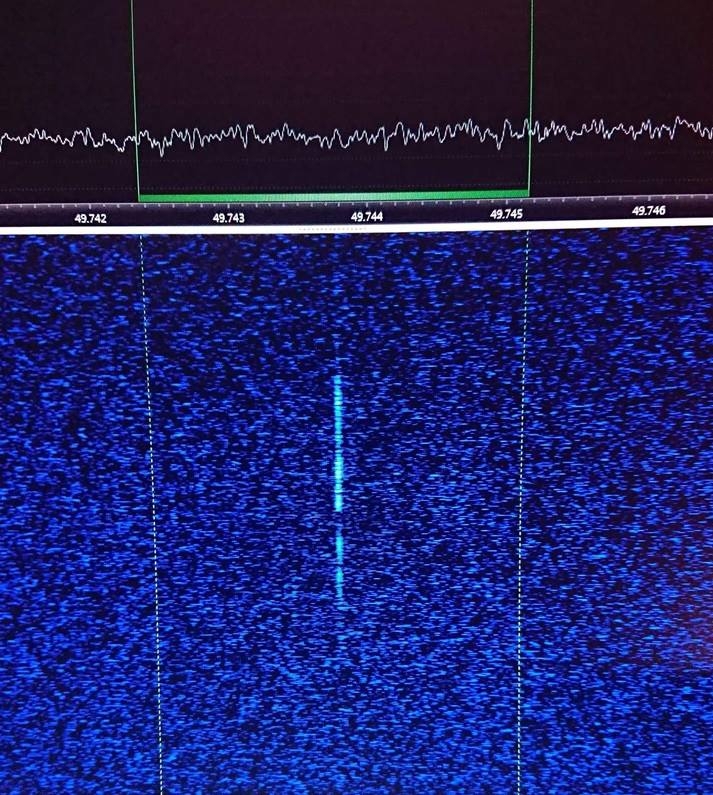

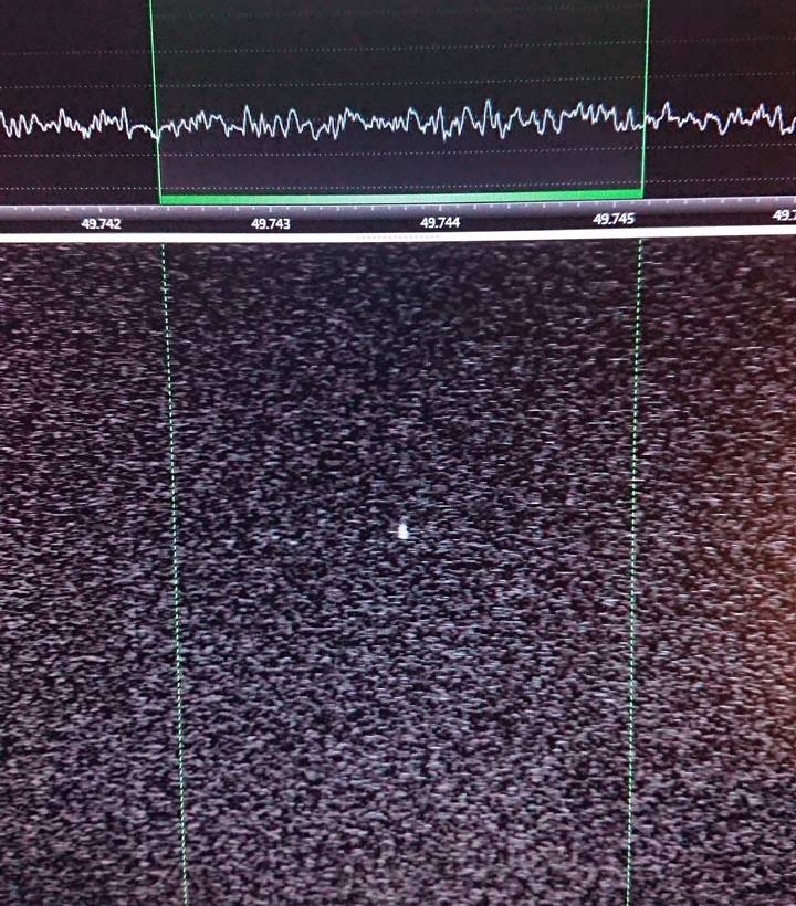

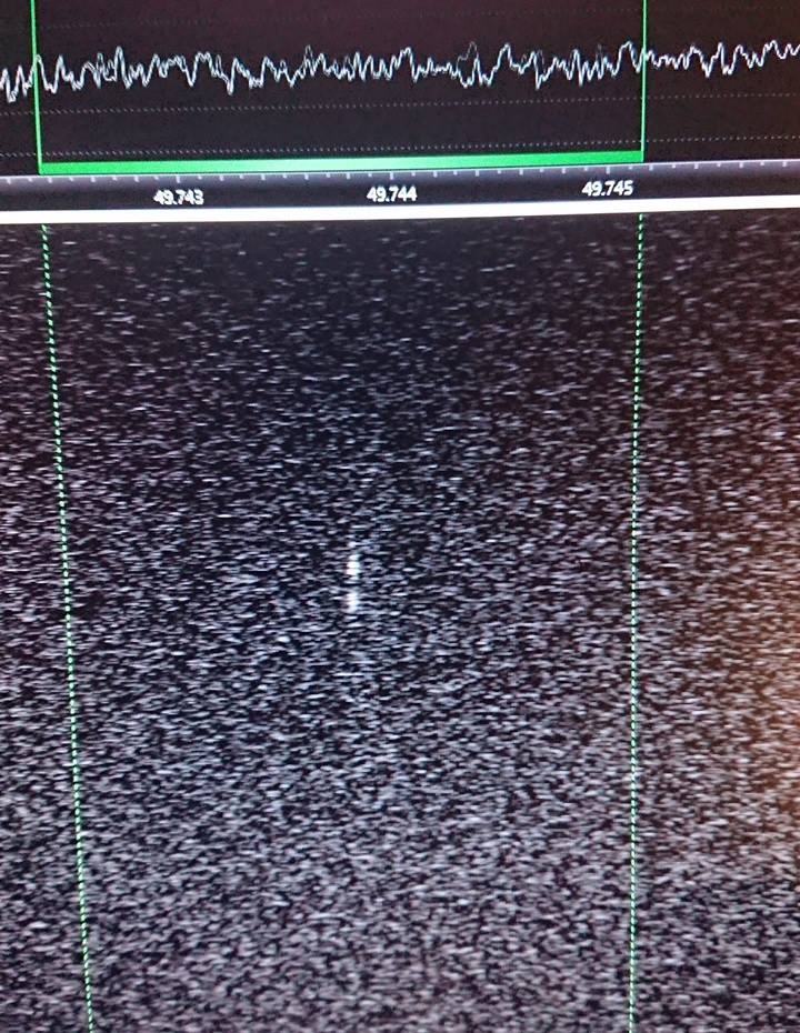

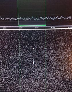

    Gentlemen, how are you with the radio receiving of the falling meteors? Apparently, it is bad with the transmitters of the eastern neighbors and it is hard to catch anything. Do you have any other solutions? Geminids are fully flying, and I received nothing in the east direction and USB frequency 49.5 million
  • #1332 17631799
    Łukasz Gorzelski
    Posts: 312
    Help: 7
    Rate: 20

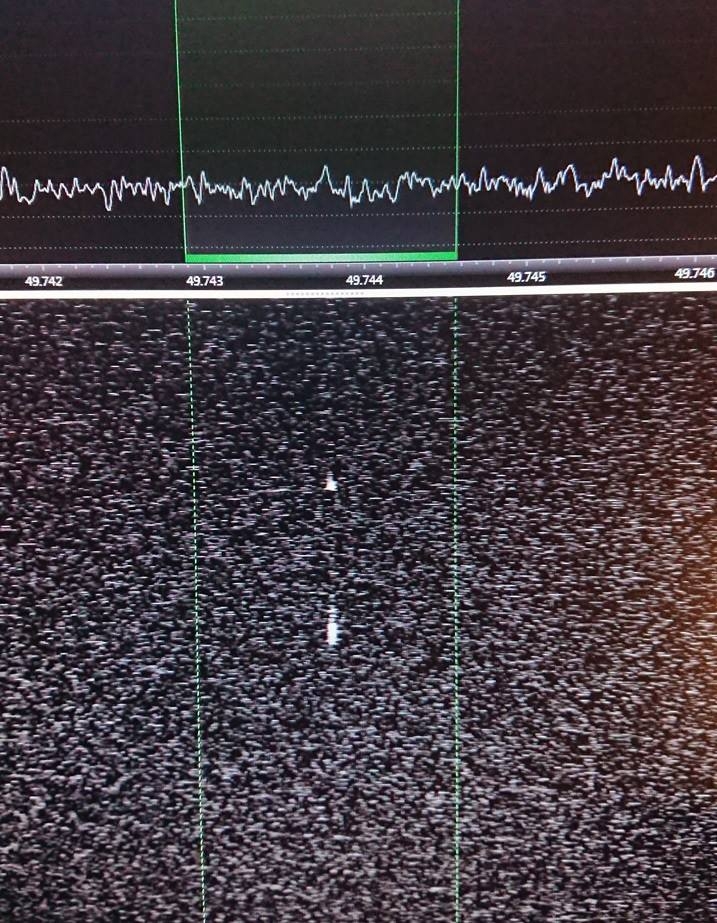

    And yet it is not bad. I set the antenna properly, the appropriate configuration of the RTL device and it works. It is a fact, without the help of the HROOFT program, but directly from the SDR console. In addition to the visual "showing" of the meteors, you can perceive the sound at the same time. As a colleague said, "the sound is literally cosmic".
    Did you also try to pick up meteor echoes?
    I am attaching selected traces. How to use RTL-SDR on a cheap USB DVB-T tuner for HF and 64–1700 MHz? How to use RTL-SDR on a cheap USB DVB-T tuner for HF and 64–1700 MHz? How to use RTL-SDR on a cheap USB DVB-T tuner for HF and 64–1700 MHz? How to use RTL-SDR on a cheap USB DVB-T tuner for HF and 64–1700 MHz? How to use RTL-SDR on a cheap USB DVB-T tuner for HF and 64–1700 MHz? How to use RTL-SDR on a cheap USB DVB-T tuner for HF and 64–1700 MHz?

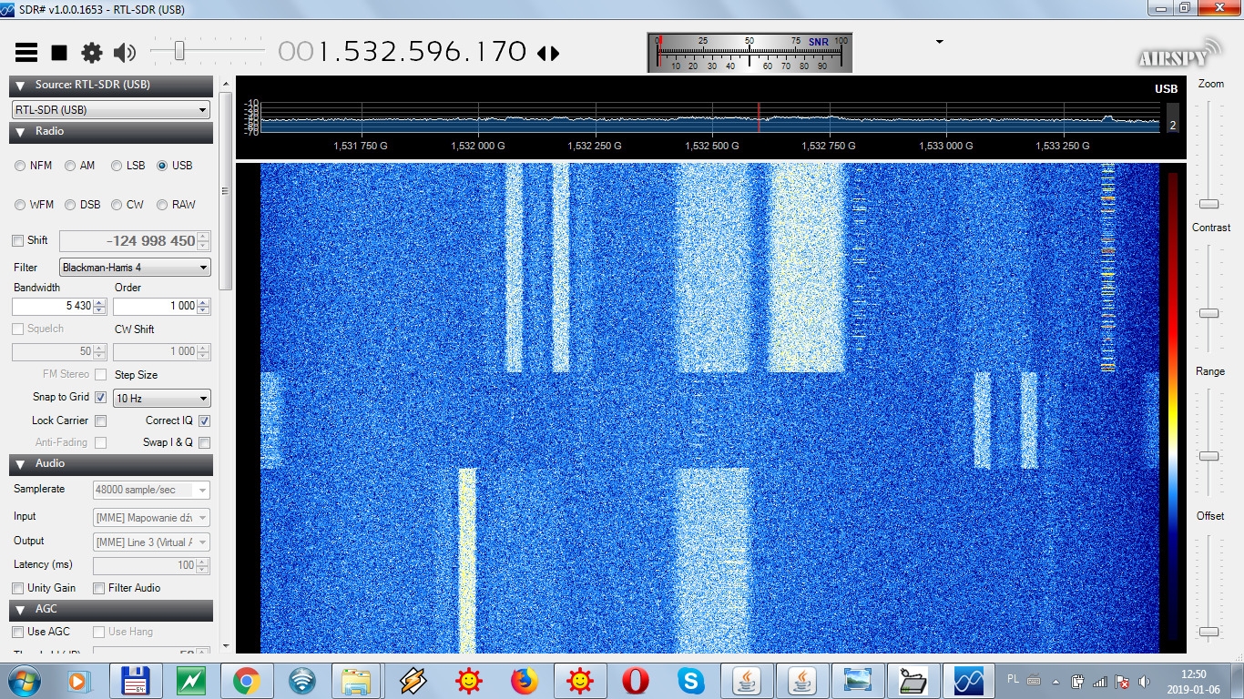

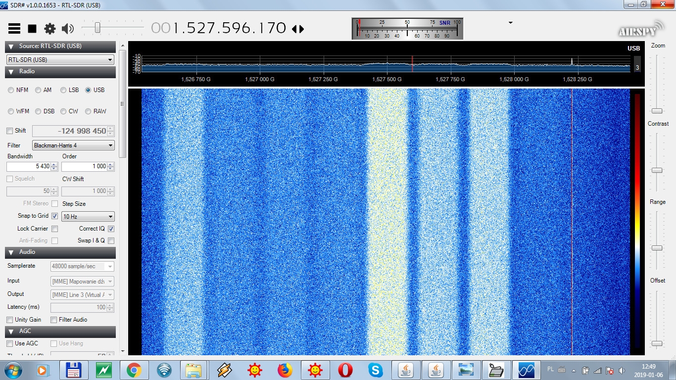

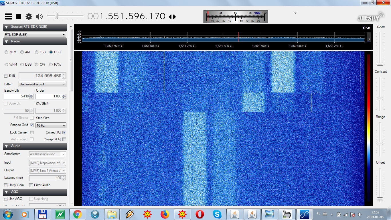

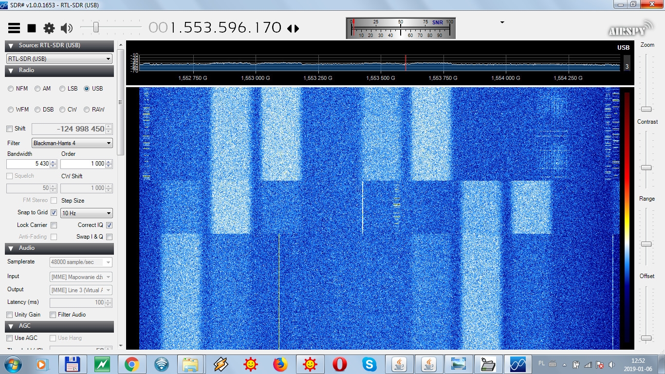

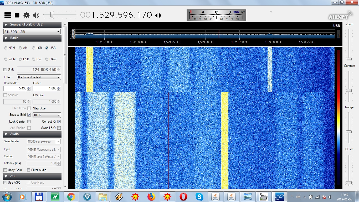

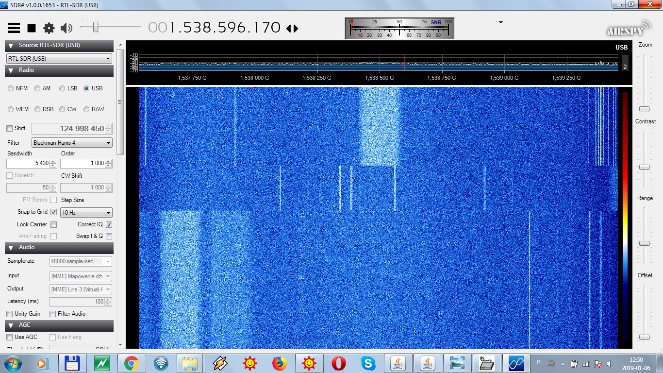

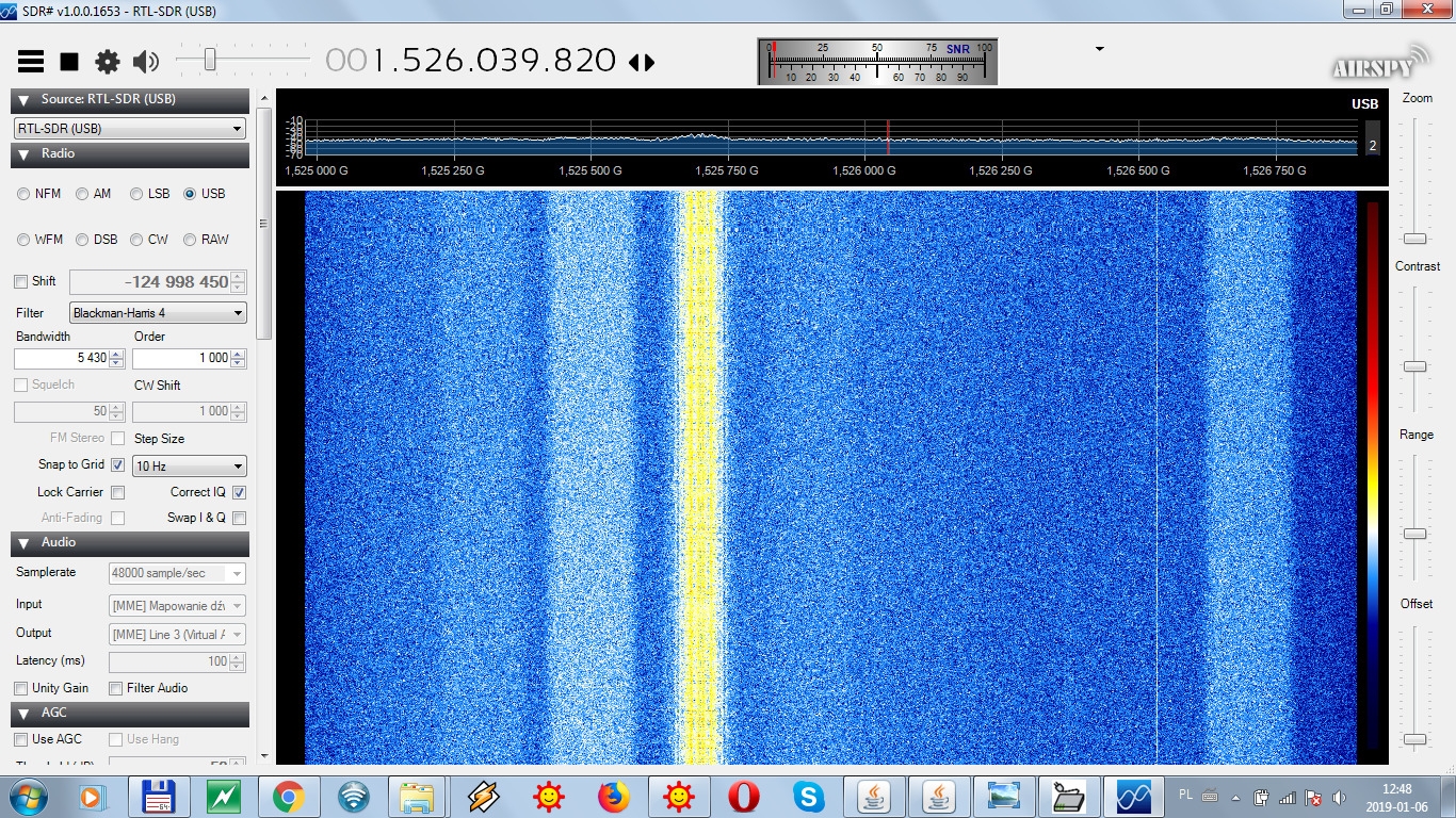

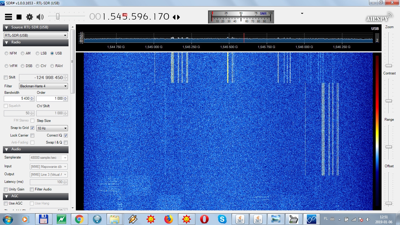

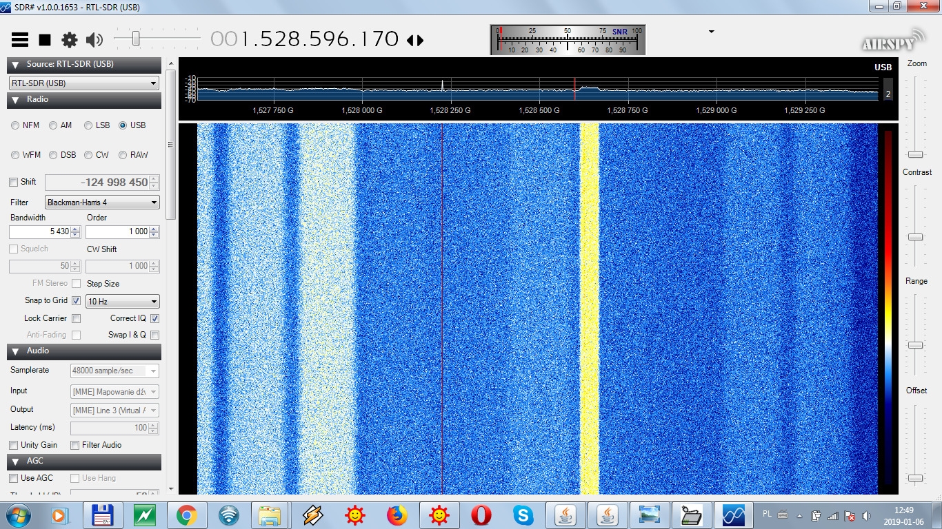

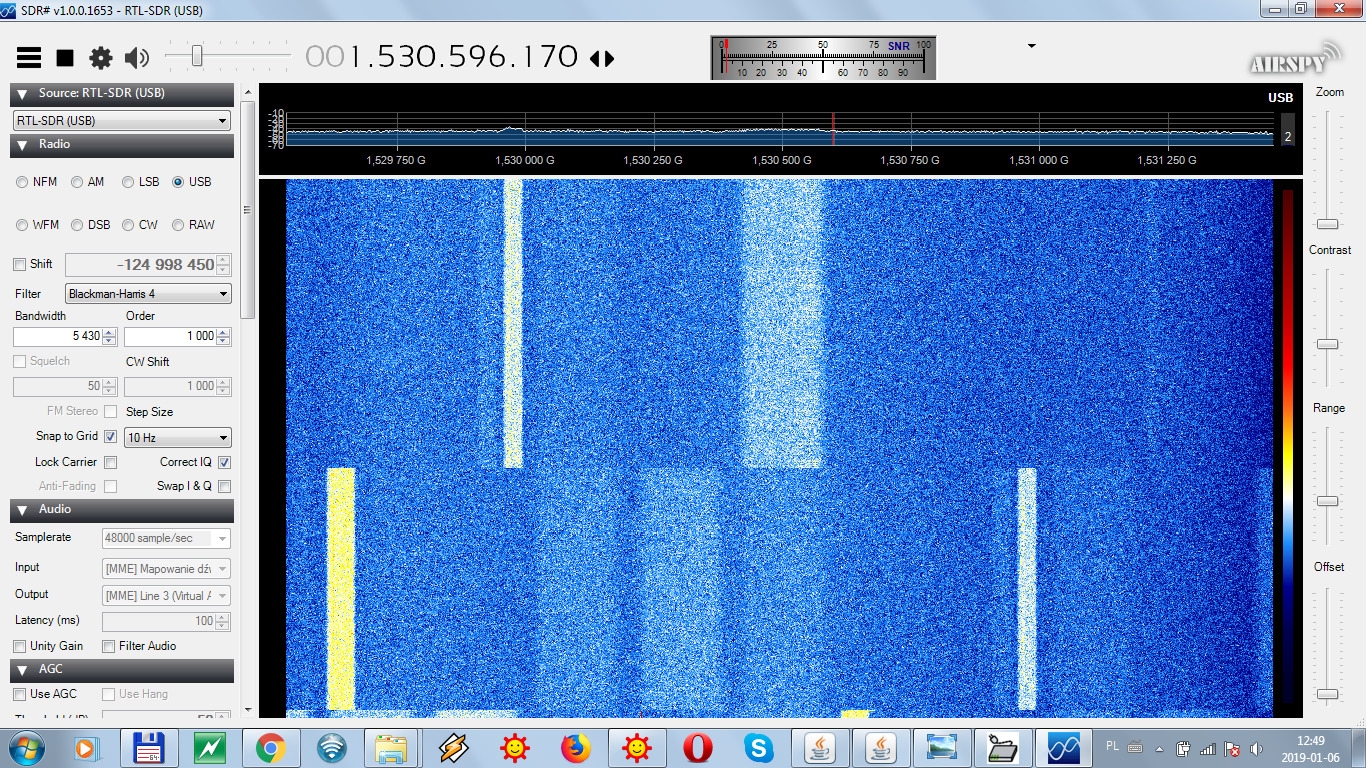

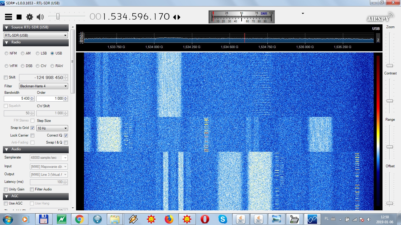

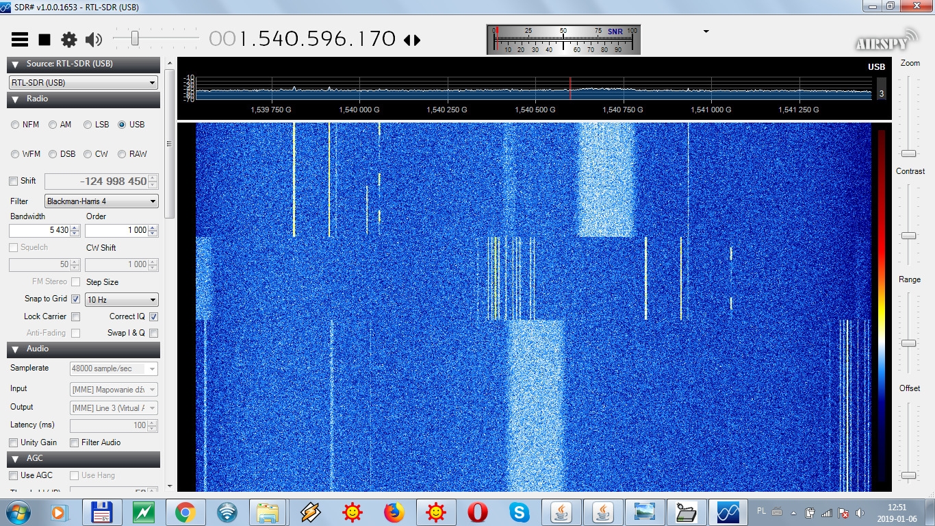

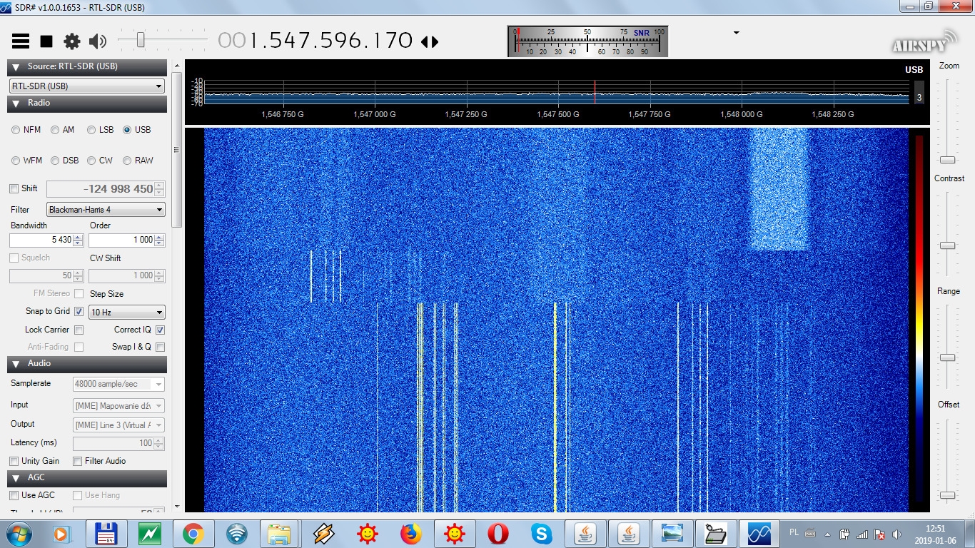

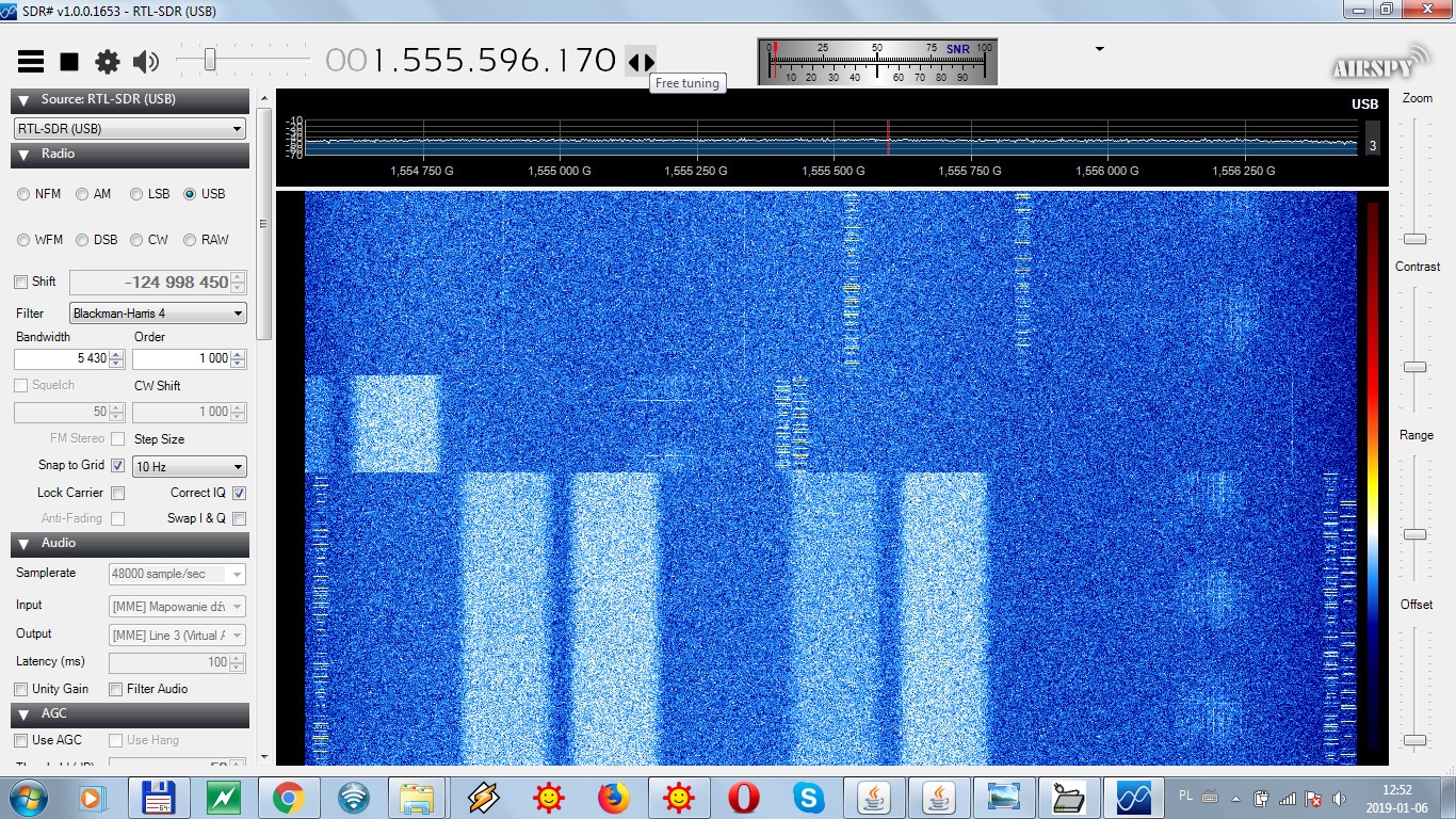

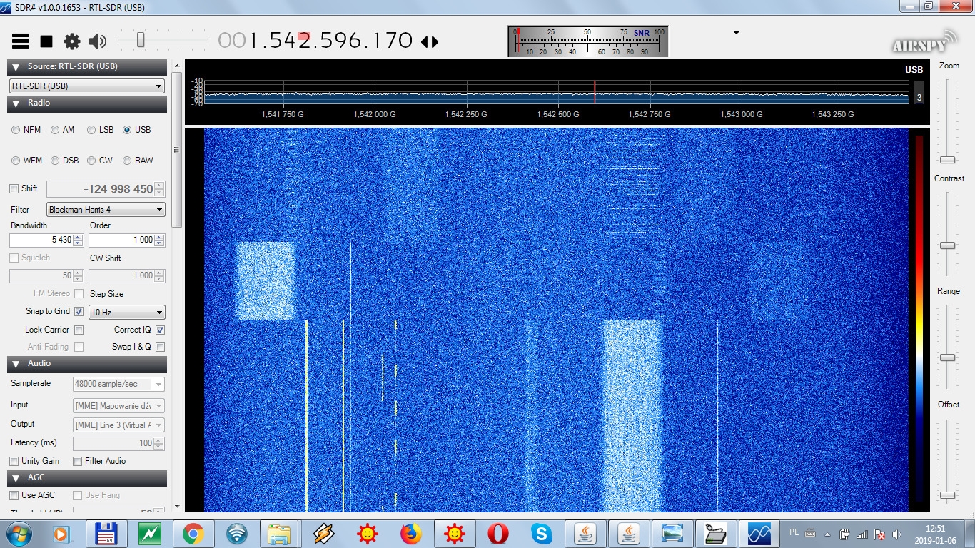

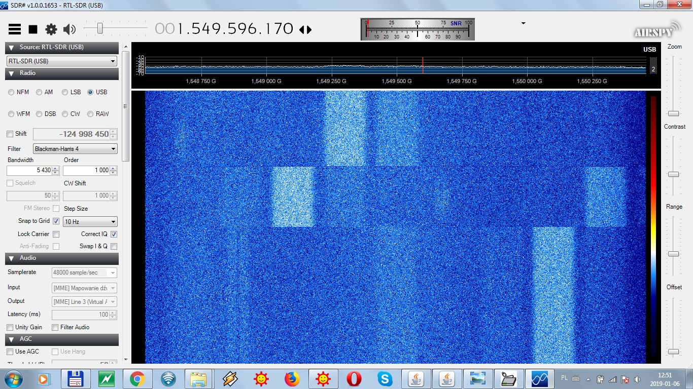

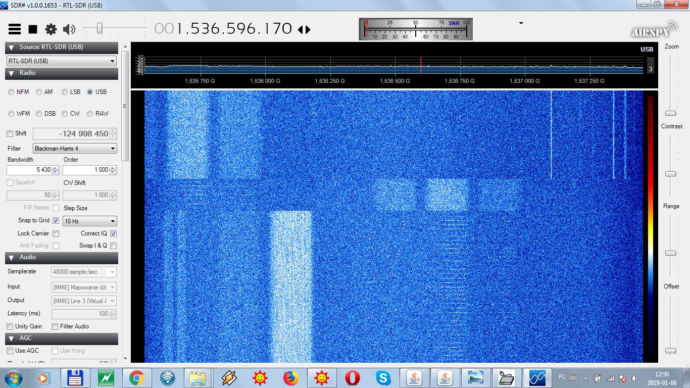

    Hello everyone and I wish you all the best in the New Year. Recently, I tested the design of the QFH antenna for GPS frequency as described on this website. http://jcoppens.com/ant/qfh/fotos_gps.en.php
    It turned out that it works very well at the 1540MHz frequency. I recommend everyone to test this antenna, if someone does not have the original one from the VAISAL probe, he can do it as described on the page above. I would like to add that I had two FP6L amplifiers connected. One about 30 cm behind the antenna in it I desoldered the choke at the input so that the voltage would not go to the antenna because it is short-circuited, another meter in front of the tuner and set it in the TUNER AGC options. The effects can be seen in the photos below
    How to use RTL-SDR on a cheap USB DVB-T tuner for HF and 64–1700 MHz? How to use RTL-SDR on a cheap USB DVB-T tuner for HF and 64–1700 MHz? How to use RTL-SDR on a cheap USB DVB-T tuner for HF and 64–1700 MHz? How to use RTL-SDR on a cheap USB DVB-T tuner for HF and 64–1700 MHz? How to use RTL-SDR on a cheap USB DVB-T tuner for HF and 64–1700 MHz? How to use RTL-SDR on a cheap USB DVB-T tuner for HF and 64–1700 MHz? How to use RTL-SDR on a cheap USB DVB-T tuner for HF and 64–1700 MHz? How to use RTL-SDR on a cheap USB DVB-T tuner for HF and 64–1700 MHz? How to use RTL-SDR on a cheap USB DVB-T tuner for HF and 64–1700 MHz? How to use RTL-SDR on a cheap USB DVB-T tuner for HF and 64–1700 MHz? How to use RTL-SDR on a cheap USB DVB-T tuner for HF and 64–1700 MHz? How to use RTL-SDR on a cheap USB DVB-T tuner for HF and 64–1700 MHz? How to use RTL-SDR on a cheap USB DVB-T tuner for HF and 64–1700 MHz? How to use RTL-SDR on a cheap USB DVB-T tuner for HF and 64–1700 MHz? How to use RTL-SDR on a cheap USB DVB-T tuner for HF and 64–1700 MHz? How to use RTL-SDR on a cheap USB DVB-T tuner for HF and 64–1700 MHz? How to use RTL-SDR on a cheap USB DVB-T tuner for HF and 64–1700 MHz?
    Best regards.

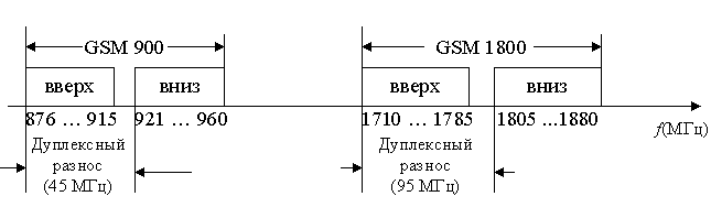

    pldi
    I mean I set the settings in SDR-SHARP by. the link from Youtube and the SDR-Sharp catalog with new settings I transfer to e.g. a pendrive / CD / DVD Having SDR-pa, I upload to another PC-et / Lap
    GSM attachment, portal cxema.ru
    • How to use RTL-SDR on a cheap USB DVB-T tuner for HF and 64–1700 MHz? 2-24.gif (3.3 KB) You must be logged in to download this attachment.
