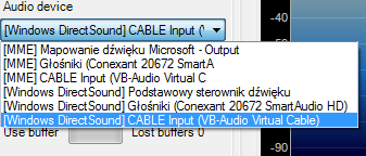

    Ukasiuuup
    Hello everyone,
    Can any of my colleagues advise me what is wrong with my configuration, that DSD does not decode DMR for me?
    I am attaching a few photos from my configuration and the error I am seeing.
    How to use RTL-SDR on a cheap USB DVB-T tuner for HF and 64–1700 MHz? How to use RTL-SDR on a cheap USB DVB-T tuner for HF and 64–1700 MHz? How to use RTL-SDR on a cheap USB DVB-T tuner for HF and 64–1700 MHz? How to use RTL-SDR on a cheap USB DVB-T tuner for HF and 64–1700 MHz?
  • #1377 17831790
    internick
    Level 36  
    Posts: 3081
    Help: 273
    Rate: 555
    You pick on the microphone, and Vac comes out. This is how it is supposed to work.
    Besides, I don't prefer to "sew" DSD into this plugin. And there will be people like me here.
    You definitely need to change the Output to 1, because these are the speakers.
    And the rest I do not know how is configured there.
    Besides, Step is not 10, but 12.5. Bandwith is not this one either.
  • #1378 17831815
    Ukasiuuup
    Thanks for the hint.
    How should the bandwidth parameter be set?
    Did I choose the virtual cable correctly?

  • #1379 17832114
    internick
    Level 36  
    Posts: 3081
    Help: 273
    Rate: 555
    The optimal bandwith for a given system is here: https://www.rtl-sdr.com/tag/signal-identification/
    In the case of DMR, it is 10,000 Hz.
    I don't know if you chose VAC correctly or not, because it depends on how you configured it.
    If, according to this: https://www.elektroda.pl/rtvforum/topic3182271.html, it should be Line3.
    I am set like this:
    a) Audio
    - samplerate: 48,000
    - input: [MME] audio mapping Microsoft - Input
    - output: [MME] Line3 VAC
    b) DSD Interface:
    - you check Enable aux audio output
    - the output level slider between the second and third bar
    - audio device: [MME] Line3 VAC
    And then I run .exe DSD
    Pros:
    - nothing growls from the speakers, because here the sound itself is decoded
    Minuses:
    - the analog should be listened to through KG-Tone - if you leave it running while decoding the digit, it will be a drone of the digit
