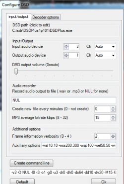

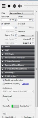

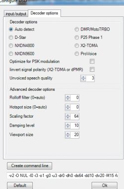

    Ukasiuuup
    I changed and now I have such a situation that still a mistake.
    How to use RTL-SDR on a cheap USB DVB-T tuner for HF and 64–1700 MHz?
    How to use RTL-SDR on a cheap USB DVB-T tuner for HF and 64–1700 MHz? How to use RTL-SDR on a cheap USB DVB-T tuner for HF and 64–1700 MHz?
    What else can I improve?
  • #1382 17832338
    internick
    Level 36  
    Posts: 3081
    Help: 273
    Rate: 555
    This is because you did not follow the basic advice, i.e.
    - we are listening on Line3, you have Line1 active - to improve the VAC settings, as well as the Windows settings according to the link: https://www.elektroda.pl/rtvforum/topic3182271.html
    - the output should be loudspeakers, i.e. device 1
    - you do it unnecessarily from the DSD plugin. Paste it again, but do not configure anything except turning on the audio and moving the slider between the 2nd and 3rd bar. Run DSD yourself from .exe

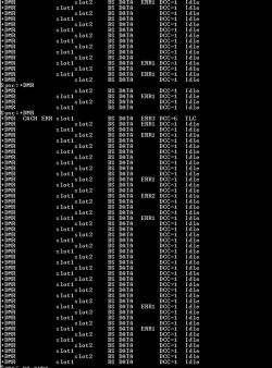

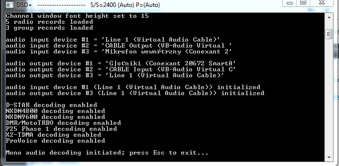

    Ukasiuuup
    And the continuation of problems.
    I changed, I run DSD.exe
    How to use RTL-SDR on a cheap USB DVB-T tuner for HF and 64–1700 MHz? How to use RTL-SDR on a cheap USB DVB-T tuner for HF and 64–1700 MHz? How to use RTL-SDR on a cheap USB DVB-T tuner for HF and 64–1700 MHz? How to use RTL-SDR on a cheap USB DVB-T tuner for HF and 64–1700 MHz? How to use RTL-SDR on a cheap USB DVB-T tuner for HF and 64–1700 MHz? How to use RTL-SDR on a cheap USB DVB-T tuner for HF and 64–1700 MHz? How to use RTL-SDR on a cheap USB DVB-T tuner for HF and 64–1700 MHz?
  • #1384 17832522
    internick
    Level 36  
    Posts: 3081
    Help: 273
    Rate: 555
    Please turn off unused devices as advised by my friend don_viking.
    Also replace the DSD plugin with one that will have default settings, i.e. no track, etc.
    It does not set itself up at all. I will repeat a third time. You have the correct voice level, audio output, so forget about configuring it and check only enable aux audio.
    Manual DSD does the rest.
    And I can see it's okay.
    The repeater sends frames, e.g. so that the radios log in while roaming to stronger stations. And that's what the picture shows.
    Previously, you had a conversation on an amateur repeater only that it didn't go over the speakers.
    And mistakes? What antenna are you using?

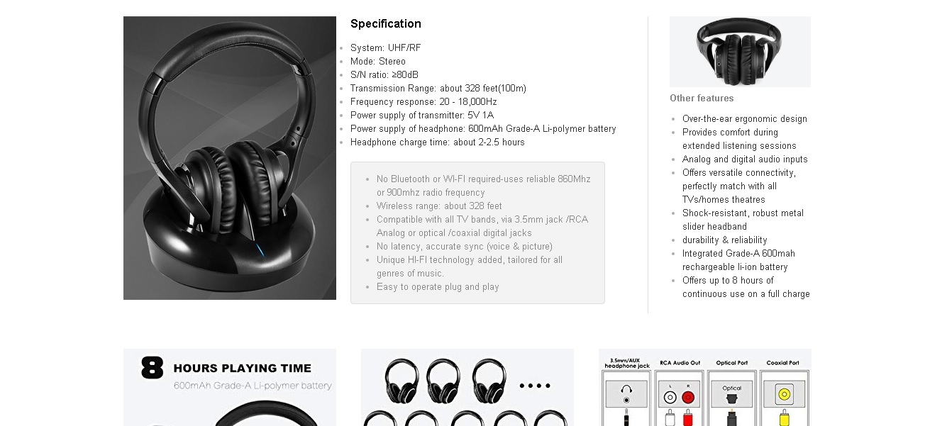

    At the frequency of about 862-863 MHz (WFM modulation), using the antenna, I receive TVN24 audio (without picture). At first I thought it was a breakthrough from one of the cable TV stations, but after checking it turned out that none of them has this channel in the offer of analog TV and on such high frequency.
    Where could this signal come from?

    @mrqpa
    863-865 MHz these are the so-called electronic baby monitors, AV senders and wireless headphones.
    These are the so-called classes 1/48 - Link
    Directive attached.

    At first I was thinking about a wireless microphone and an electronic nanny (the neighbors upstairs have a small baby), but it must be NFM modulation. This device works all the time and broadcasts TVN24 audio all the time, it's strange.

    Like a colleague Hektar Zahler he said there are devices that transmit stereo audio in the 860 MHz band and use wide FM for this. In this case, it will likely be the stereo headphones link below and a photo of the offer. Usually the cheap versions have regular wide FM in the 860MHz band, not a digital 2.4GHz broadcast over bluetooth. It can also be broadcast to wireless speakers.
    https://www.amazon.com/Headphones-Wireless-Transmitter-Charging-Compatible/dp/B07MKFCHWS

    However, I would bet that for unknown reasons, the cable TV transmits analogue TVN24 audio. When I still had a cable, I received this signal on the proverbial wire, and now I have to put the antenna out the window. In addition, this signal is 24/7 since I have a dongle (less than 3 years) and there is always TVN24. Therefore, with these speakers and headphones it is probably not a good lead.
    On other things, someone in the neighborhood is using PLC transmitters and it is virtually impossible to listen to signals in the frequency range down to around 70 MHz. You can see how the amplitudes of the interfering signals increase as the link is used more intensively, the sound then more wheezes and "farts". Actually, I can forget about listening to CB radio and the amateur bands 40 m / 80 m.

    You yourself wrote in this post that it will not be cable because you checked and none of it is on offer. He doesn't understand what you are writing and what you are changing your mind about and why. Or are you just interested in earning points for posting in a topic? But ok, I don't go into it and I'm not interested in it.
    Best regards and I wish you successful listening sessions.

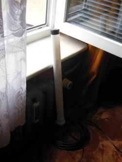

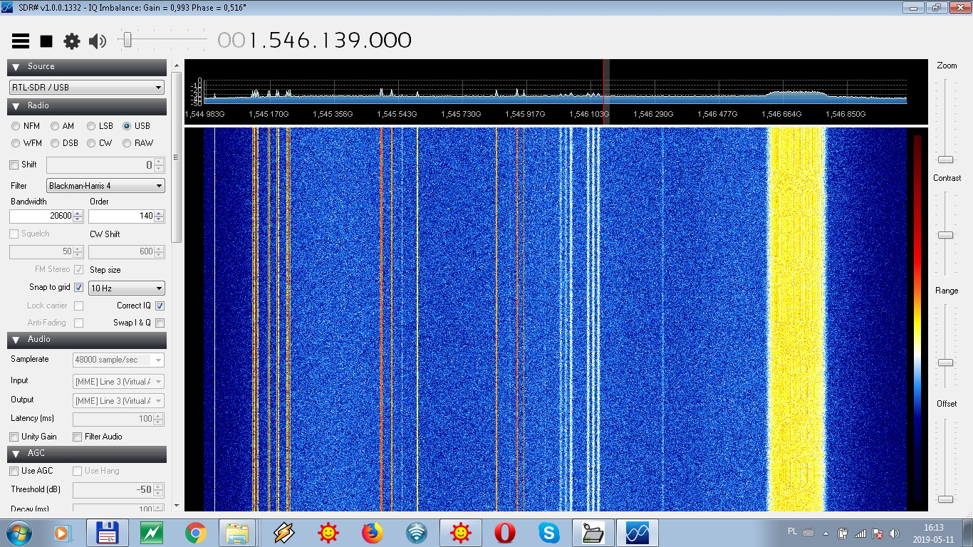

    Hello. Once upon a time, I included a description in this topic regarding the reception of a signal with a frequency of 1500MHz.
    https://www.elektroda.pl/rtvforum/topic2353101-1320.html#17681243
    Now I am adding a diagram of the antenna from the VAISAL probe GPS receiver, which I found on the network. The only error in the drawing is the direction in which the antenna elements are bent.
    The direction of the bending of the elements is shown in the photos on the page below.
    http://jcoppens.com/ant/qfh/fotos_gps.en.php
    Today, with full cloud cover and the antenna in the room, I had very strong signals visible in the photos on this antenna. How to use RTL-SDR on a cheap USB DVB-T tuner for HF and 64–1700 MHz? How to use RTL-SDR on a cheap USB DVB-T tuner for HF and 64–1700 MHz?
    Here are links to interesting programs
    http://jontio.zapto.org/hda1/jaero.html
    http://www.tekmanoid.com/egc.shtml
    https://bitbucket.org/scytalec/scytalec/src
    Description of the sdrsharp plugin here
    If anyone has any interesting programs for receiving signals on this frequency, he can add some links.
    Good luck and good reception.
    Recently, I did a little modernization on the antenna. You can see the changes in the photos. Behind the antenna there are 2 cable sections connected by a barrel, the first is H155, the second is RG58. I tried to connect the antenna to the amplifier with different lengths of different cables, but this combination was the best. Most likely it is about a filter or choke between the antenna and the amplifier. Then I have an Amplifier connected as you can see in the picture, then about 10 m of H155 cable, then another amplifier and about 1.5 m of H155 cable to the separator and tuner. The antenna is still facing south in the room in front of the window, but I added a sheet metal screen behind the antenna, in this case a chocolate lid. The effects are satisfactory. In the sdrsharp program, of course, only "AGC Tuner" is selected.
    How to use RTL-SDR on a cheap USB DVB-T tuner for HF and 64–1700 MHz? How to use RTL-SDR on a cheap USB DVB-T tuner for HF and 64–1700 MHz? How to use RTL-SDR on a cheap USB DVB-T tuner for HF and 64–1700 MHz? How to use RTL-SDR on a cheap USB DVB-T tuner for HF and 64–1700 MHz? How to use RTL-SDR on a cheap USB DVB-T tuner for HF and 64–1700 MHz? How to use RTL-SDR on a cheap USB DVB-T tuner for HF and 64–1700 MHz? How to use RTL-SDR on a cheap USB DVB-T tuner for HF and 64–1700 MHz? How to use RTL-SDR on a cheap USB DVB-T tuner for HF and 64–1700 MHz? How to use RTL-SDR on a cheap USB DVB-T tuner for HF and 64–1700 MHz? How to use RTL-SDR on a cheap USB DVB-T tuner for HF and 64–1700 MHz? How to use RTL-SDR on a cheap USB DVB-T tuner for HF and 64–1700 MHz? How to use RTL-SDR on a cheap USB DVB-T tuner for HF and 64–1700 MHz? How to use RTL-SDR on a cheap USB DVB-T tuner for HF and 64–1700 MHz? How to use RTL-SDR on a cheap USB DVB-T tuner for HF and 64–1700 MHz? How to use RTL-SDR on a cheap USB DVB-T tuner for HF and 64–1700 MHz? How to use RTL-SDR on a cheap USB DVB-T tuner for HF and 64–1700 MHz? How to use RTL-SDR on a cheap USB DVB-T tuner for HF and 64–1700 MHz? How to use RTL-SDR on a cheap USB DVB-T tuner for HF and 64–1700 MHz?
