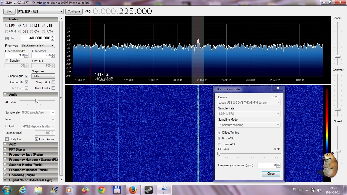

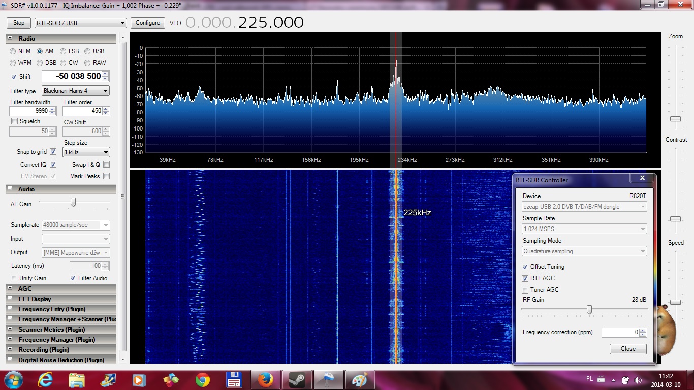

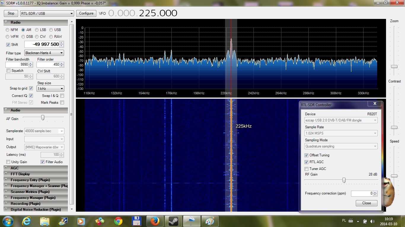

    Hello forum members and please help :) ,
    I bought a receiver containing RTL2832U and R820T from this website:
    http://www.aliexpress.com/item/PAL-IEC-Input-...eiver-Wholesale-Free-Shipping/1128993167.html
    I looked inside and in fact, this Realtek and tuner are sitting there.
    I used the sdr-install script to download everything. The drivers - I think - were installed without any problems using the zadig.
    SDR Sharp starts and starts receiving normally when RTL-SDR / USB is selected.
    The good news ends there :(
    Either I am doing something wrong or this receiver is completely deaf? I test it on the included, small antenna, but having a radio with a clean short cable at 102.9 MHz next to it, I expected to see any signal on this frequency.
    And it looks like this:
    How to use RTL-SDR on a cheap USB DVB-T tuner for HF and 64–1700 MHz?
    However I set the frequency, there is always this weird pin in the middle and virtually no other signals (after listening to the 'pin' there is silence). I checked the antenna included in the kit with an ohmmeter: it seems to have no problems such as broken wire or shorted to ground.
    Am I doing something wrong or maybe I got a slapped card?
    best regards

  • #154 13319590
    Tailsy
    Posts: 92
    Help: 14
    Rate: 57

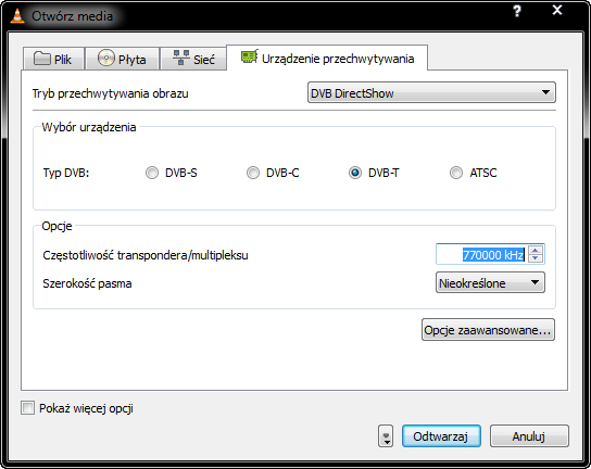

    I installed the default drivers and software and doesn't seem to find any program :( . The antenna is definitely OK, because the stationary tuner receives no problem.
  • Restore DVB-T by replacing Zadig with tuner drivers
    #155 13319726
    sb8gapi
    Posts: 65
    Rate: 36
    Please uninstall the drivers installed by Zadiag as DVB-T cannot be received on them.
    Control Panel -> Device manager -> libusb (Win usb) devices -> (Bulk-In Interface (Interface 0))
    https://obrazki.elektroda.pl/8636425700_1390579977.jpg
    Reboot the computer without the USB tuner on the computer.
    Installing the driver from the CD included with the tuner (newer systems - Windows 7 and 8 should install the appropriate driver themselves - it should be in Sound, video and game controllers. My name is: DVBT / DAB TV Stick, but the name may be different depending on the model tuner.)
    Sometimes I had a problem with the app that came with the tuner, but it is possible to check the DVB-T reception after installing the drivers in VLC.
    https://obrazki.elektroda.pl/54_1275560990.png
  • Replacing drivers did not restore DVB-T reception
    #156 13319842
    Tailsy
    Posts: 92
    Help: 14
    Rate: 57

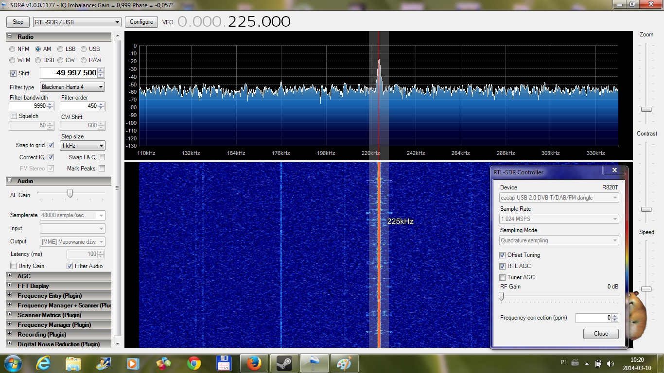

    I couldn't permanently remove these installed drivers (they just kept coming back). I simply replaced the driver in the world with this one from realtek.
    At the moment it looks like this:
    After trying the 658000Khz and 666000Khz frequencies (it seems that the antenna is aimed at Sławobór or Koszalin), VLC is silent. The included Presto PVR program also found nothing ...
  • #157 13329294
    sb8gapi
    Posts: 65
    Rate: 36
    Looks like a broken tuner. I suggest checking for 100% certainty on another computer or with a friend.
    The aforementioned Presto PVR makes it possible to receive FM radio (88-108 MHz).
    Does it also search for radio stations?
    A working tuner should easily receive DVB-T digital TV and VHF radio stations, and after installing the driver for SDR by Zadig, there is also the reception of different frequencies in HDSDR or SDR Sharp, or other SDR program working with the tuner on RTL2832U.
  • #158 13333858
    zabex
    Level 22  
    Posts: 684
    Help: 50
    Rate: 52

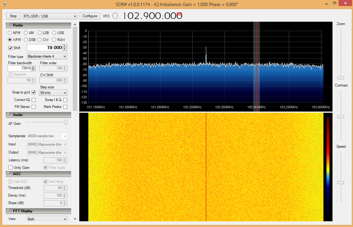

    Col. l0ud first of all, please show what the tuner settings look like after clicking the "Configure" button in SDR # or just click and set the gain, preferably immediately on "Tuner AGC"
    When it comes to this (as he called it) "pin", select "Correct IQ" and read how the software receivers work and a colleague will find out where it comes from.
    Please do not compare the sensitivity of this receiver to an ordinary "FM radio" because it will always be smaller, especially on the original "pseudo" antenna.
    PS By the way, I will ask (since my friend was already taking apart his dongle) what kind of tuner system is in it?

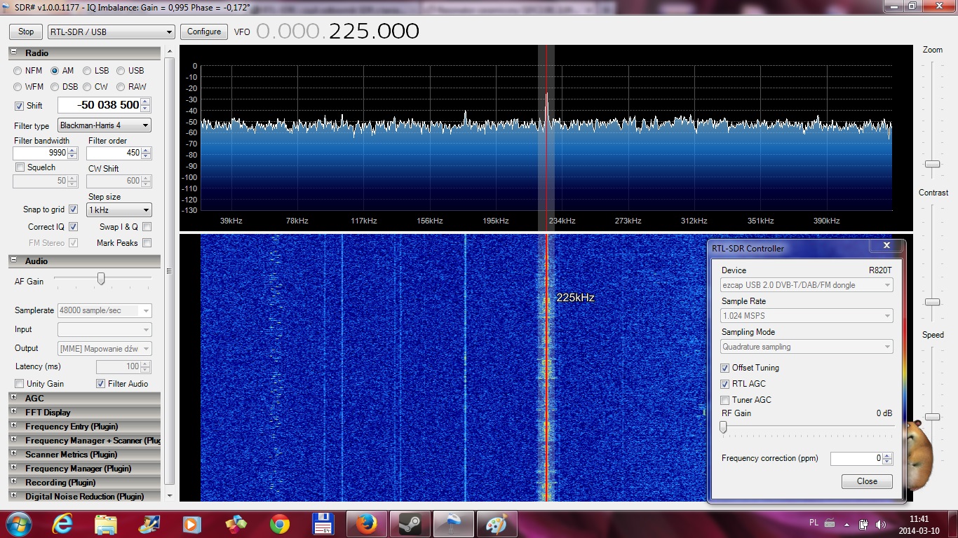

    I would like to clarify the answer of my friend "gods". The sensitivity does not depend on the generator.
    I built some converters on TA7358AP (LA1185) and noticed the following relationship.
    At the beginning I had one converter with a 50 MHz quartz generator and another with a 40 MHz quartz resonator. There was more sensitivity on the one with the generator, as I wrote. Only then did I not know what it depends on.
    After several days of testing with various generators and quartz resonators, I came to the following conclusions:
    The frequency of the generator was 10 MHz higher than the frequency of the quartz resonator, so it was therefore more sensitive
    But it is not greater because there is a generator in the circuit, only the sensitivity depends on the frequency of the used resonator or quartz generator. It does not matter much for the sensitivity whether the converter circuit uses a generator or a resonator only its frequency. The lower the frequency of the resonator or generator (of the same frequency), the lower the sensitivity, and the higher the frequency of the generator or quartz resonator, the greater the sensitivity.
    I tested resonators and generators at frequencies from 25 MHz - to 50 MHz - for 25 MHz the sensitivity is very low, the converter only picks up very strong stations.
    for 40 MHz it is much higher, for 50 MHz it is even higher (as shown in the attached screenshots).
    The best results were obtained for the frequency of 40 MHz (optimal ratio of sensitivity and gain) and when there was a quartz resonator in the converter circuit.
    At 50 MHz, the sensitivity is higher, but also the interference is greater. I was not able to buy a quartz resonator with two terminals and used it with three, and therefore the SDR Sharp in Shift has -50 038 500, because it has two more capacitors connected to the center terminal in a common housing with quartz.

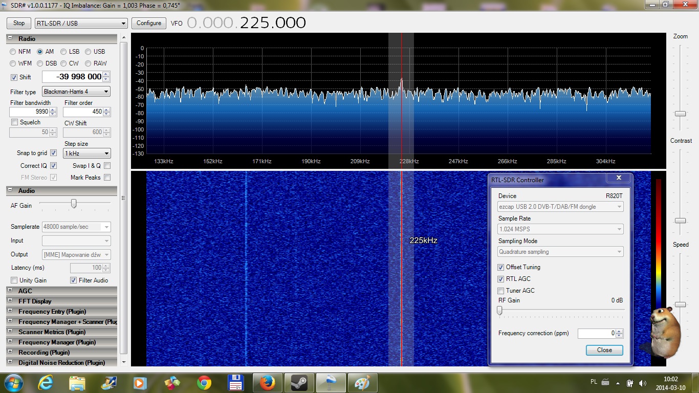

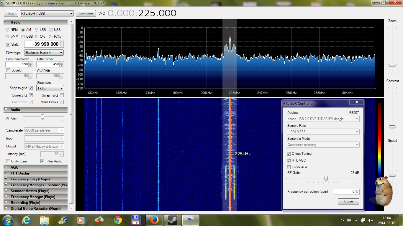

    Updated on April 20, 2014
    I bought 50 MHz SMD quartz resonators and for TA7358 for Shift 50 MHz it was necessary to connect a 20-40pF variable capacitor in series with the resonator to adjust (may not be needed, but it depends on the specific IC and manufacturer).
    Generator 40 MHz PR I 225 kHz RF Gain 0 dB
    Generator 40 MHz PR I 225 kHz RF Gain 28 dB
