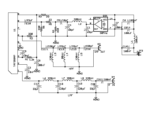

    Hello, I also made this UP converter s TA 7358 and the whirring is not sensitive, but it is whirring, I have s Xtalem 40 MHz.

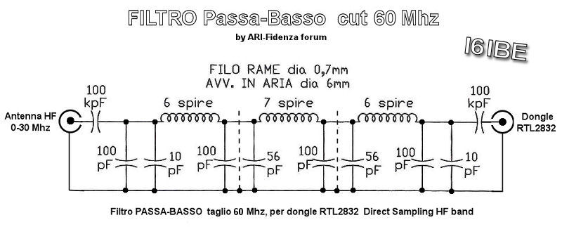

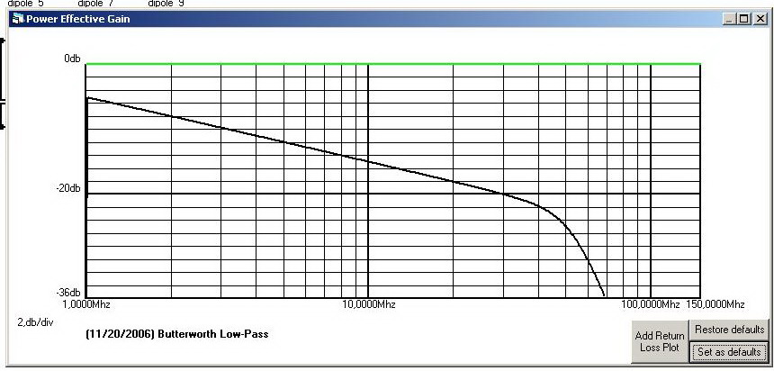

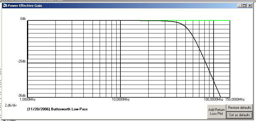

    Let someone who knows more about the topic of the low-pass filter for the converter from this scheme:
    How to use RTL-SDR on a cheap USB DVB-T tuner for HF and 64–1700 MHz?
    At the input there is "Rf Gain" in the form of a potentiometer and after it begins a filter that cuts above 30mhz.
    There is one "but". This filter has the correct characteristics as long as it is deprived of this capacitor at the 10nf input.
    The layout simulated in the program for designing such filters showed that it gets terrible.
    without this capacitor at the input it is ok:
    I am not a radio alpha and omega, so let someone expert in the subject say here, because it turns out that a lot of people build faulty systems with a silencer at the input instead of a filter.
    Nowhere in the diagrams of this type of filters have I seen a capacitor in this place.
    Check it out because I may be wrong due to lack of knowledge, but if not, it's time to dump that cond.

    How did you simulate it? You ensured the source and load impedance (probably 50? ;) ?
    This capacitor should be a short circuit for the RF frequency.
    Instead of a potentiometer, it is better to use a 50? regulated attenuator.

    50R in and out impedance set.
    If I reduce the value of this capacitor, it starts to get nice.
    It is possible that I am performing the simulations incorrectly.

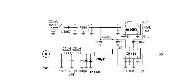

    I simulated this LPF in the same way:
    and without this 100nF at the input of the filter is beautiful and sharp and with this capacitor it shows me that I will not hear anything because the attenuation is in full range.
    Out of curiosity, I will probably fire up such a system under a tuned generator and see how it behaves.
    I find different versions of these filters on the net. Without this conda at the input and with:
    I guess I'm doing the simulations wrong. How do I swap this capacitor and the 50R resistor responsible for the impedance, it is ok.
    Time to talk to someone smart ;)

    Question for those who did la1185 / la1186 / ta7358 converter with quartz instead of generator.
    Didn't you get quartz on the fundamental frequency?
    In this converter, the quartz should work at a frequency higher than the lowest received by the SDR, in my case f> 24MHz.
    What I wouldn't put under the scalak, it oscillates at 9-15MHz.
    So far, I have successfully assembled KF to SA612 (ne612) converters using a 50MHz generator. I wanted to compare the TA7358 chip with quartz but as you can see there are difficulties.
    Of course, you can add a system from several elements that will excite such a quartz on the 3rd overtone or put a generator there and everything will be great, but I saw that you were doing this set on quartz without such combinations.

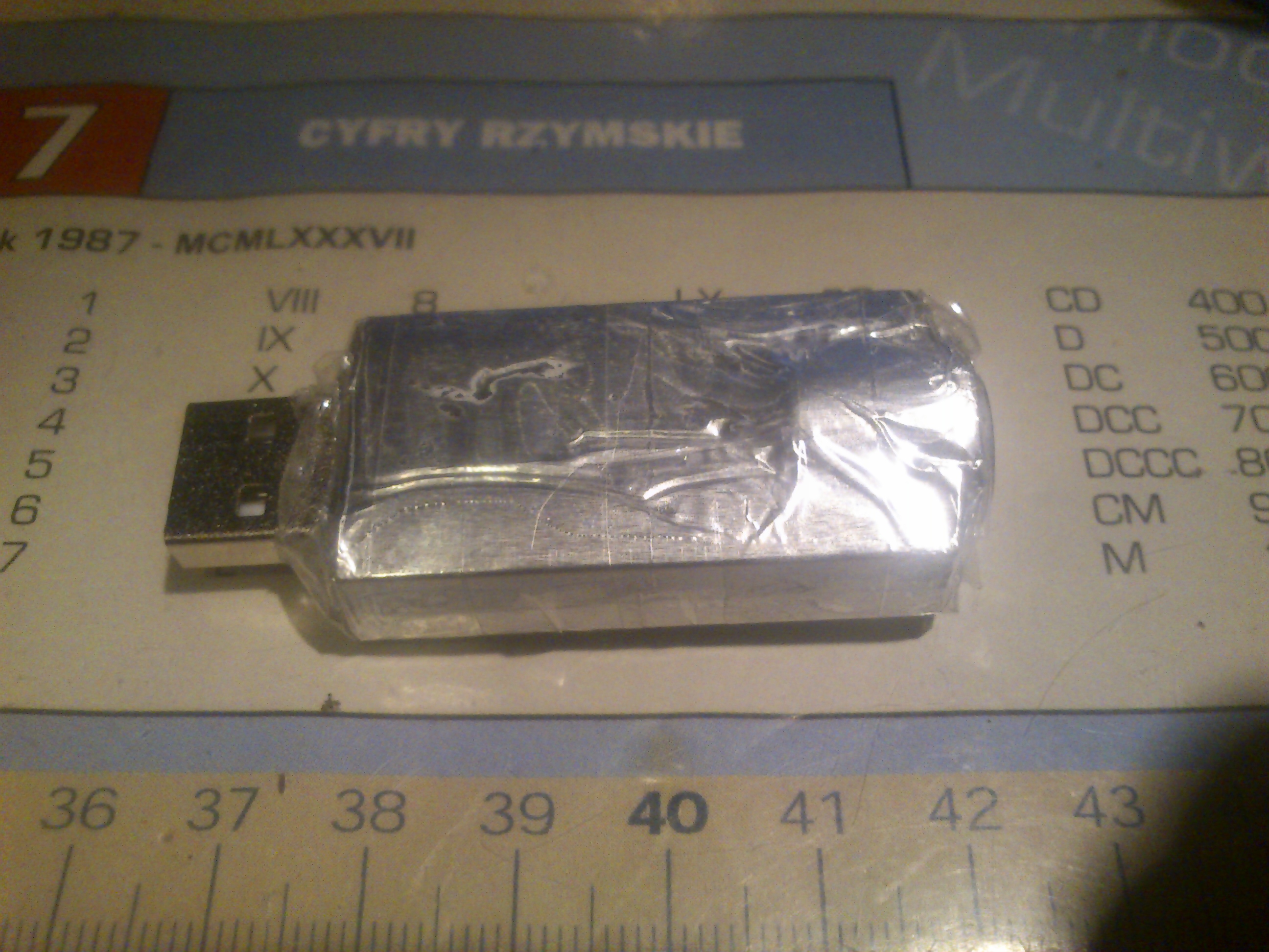

    I have a problem with the tuner itself. When it warms up, the RTL SDR freezes. It helps to connect temporarily and connect after a while. It seems to me that the tuner is overheating and breaks communication even though the system does not see the problem. Have any of your colleagues faced a similar problem?
    In terms of noise, it is brilliant to wrap the tuner with aluminum foil and connect it to the housing of the USB plug, in addition, I have a ferrite filter (5 turns) on the cable and power the tuner not from USB, but an external power supply from which I also power the converter.
    This allows you to get rid of these "teeth" in the band.

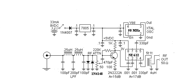

    I currently use MINI WHIP pa0rdt and recommend experiments with this antenna.
    A silicone tube, a stopper from the top for the deodorant and the bottom closure from the original "plunger" from the silicone tube. A 2.5-meter mast of PVC water pipe, all fixed on the roof of a two-story block. It perceives it better than the LONG WIRE which was before, mainly due to the lower amount of interference.

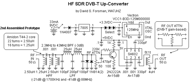

    Below is a typical converter circuit with a built-in, simple preamplifier.
    Link

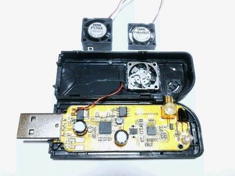

    Frequency drift is one of the negative effects of heating up the tuner electronics. The second thing to consider sometimes is noise increase.
    Here: Link
    There is a mention of this and a comparison of the noise of a heated and cooled tuner.
    I myself wonder if I should solder small heat sinks on the underside and sink it in a can of oil ;) How about a peltier module?
    Heating electronics is also a greater failure rate, silicon likes coolness :)
    But you can also like this:
    As for the frequency floating itself, those who bother it released quartz and replaced it with a temperature-stabilized generator. A cheap and effective solution

    For Methyl, can you give a schema of this KF to SA612 (ne612) converter using a 50MHz generator, if you have checked that I would try it and I don't have to search on the net.
    Thanks Jarda
  • #239 13637741
    methyl
    Posts: 183
    Rate: 32
    The easiest way is to do this and it will work ok:
    Better to give like this:
    And best as in the original:
    By putting an attenuator at the output of the converter, preferably in any of these cases.
  • #240 13637856
    OK2STO
    Level 20  
    Posts: 260
    Help: 36
    Rate: 52
    Thanks for schematics.
    Will try.
    Jard
