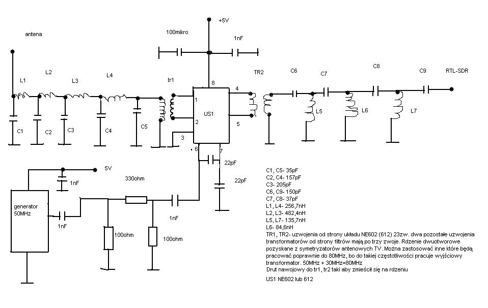

    I made a few NE602 or 612 converters in a symmetrical configuration, because it has a gain by 3db greater than in a non-symmetrical system. Symmetrical has 3K input and output resistance. I made the adjustment to 50ohm on transformers with a ratio of 7.75: 1. Two-hole cores obtained from baluns of television antennas. Of course, you can use other cores that will work in the range of up to 80MHz, for that at the input of the low-pass filter and the output of the high-pass. Both filters designed in RFSim99 to suck from the net for free. For this 50MHz generator. I recommend it works great. The whole structure complies with all the rules in this field. It is about matching the resistance, which is important because hardly anyone matches the impedance of the mixer to the impedance of the filters. Here you can see what the correct fit of the NE602 cube looks like in various configurations. If anyone wants, I can draw a diagram, but just download the application of this cube and everything will be clear.

    If you can find some time, please outline your converter circuit with input and output circuits.
    I would like to do and compare how it works. I have some problems here due to possible lack of matching to the mixer. Maybe this will be the golden mean :)
    And the program, or actually filter design programs, is currently testing but instead of getting clearer, a lot of question marks appear ;)

    Here is a diagram of my project. For the filter coils, I only gave inductances, but this can be easily converted with a calculator for converting inductance to turns, winding length and coil diameter. How to use RTL-SDR on a cheap USB DVB-T tuner for HF and 64–1700 MHz?
    Filters designed for 50? I / O resistance. The high-pass filter has been calculated for the cut-off frequency of 47MHz. At this point it has -3db attenuation, and the input or low pass filter has a cutoff frequency of 31MHz, here it has -3db attenuation.

    Thanks for the diagram. I will put it together for sure, maybe even today and let you know about the effects here.
    While the impedance of the mixer and tuner is clear and it is easy to transform it with a suitable circuit, what should be done with an active antenna of the "Mini Whip" type
    Do you think that when designing the low-pass input filter, its impedance other than 50R should be taken into account? And how much of this antenna actually has this resistance seen from the side of the system?
    I am asking because while playing with the filter simulations, you can clearly see that by connecting a different "load" to the input than the 50R for a given filter which had a nice flat characteristic, it becomes uninteresting and according to what is shown on the chart, the filter should be recalculated for this other antenna. This also applies to most of the antennas used by users here, i.e. a piece of wire with an impedance not closer to each other. How to consider it whether to take it into account at all or simply agree to losses by mismatch.
    It is also possible that I am thinking wrong, maybe someone will explain to me?

    Each antenna is connected via a cable, usually 50?, so the TRX is not converted to other input resistances, but you only need to adjust the cable and the antenna to the TRX. So I am trying to do TRX to the standard resistance. What if someone did not have a suitable antenna and used a cable other than 50? And dismantled the radio to adapt it to the existing antenna system :D . The radio is to have 50 ?, and the antenna system needs to be adjusted, although when it comes to the reception itself, some major mismatch will still pass. If you want to send on a random wire, buy yourself a kilogram of tips, because you will burn them, and as they say, you will fly from the window to the yard :D . In the case of these converters, you will listen to a lot with about 10m of wire, but such wire should be connected via the antenna cable anyway, because the antenna must be away from the computer, TV, etc. Otherwise there is terrible "shot" and it is difficult to catch distant stations, especially at 1.8 and 3.5MHz. It is also worth powering the converter from a transformer power supply, not from USB or, for example, a 5-volt phone charger, because it is very humming.

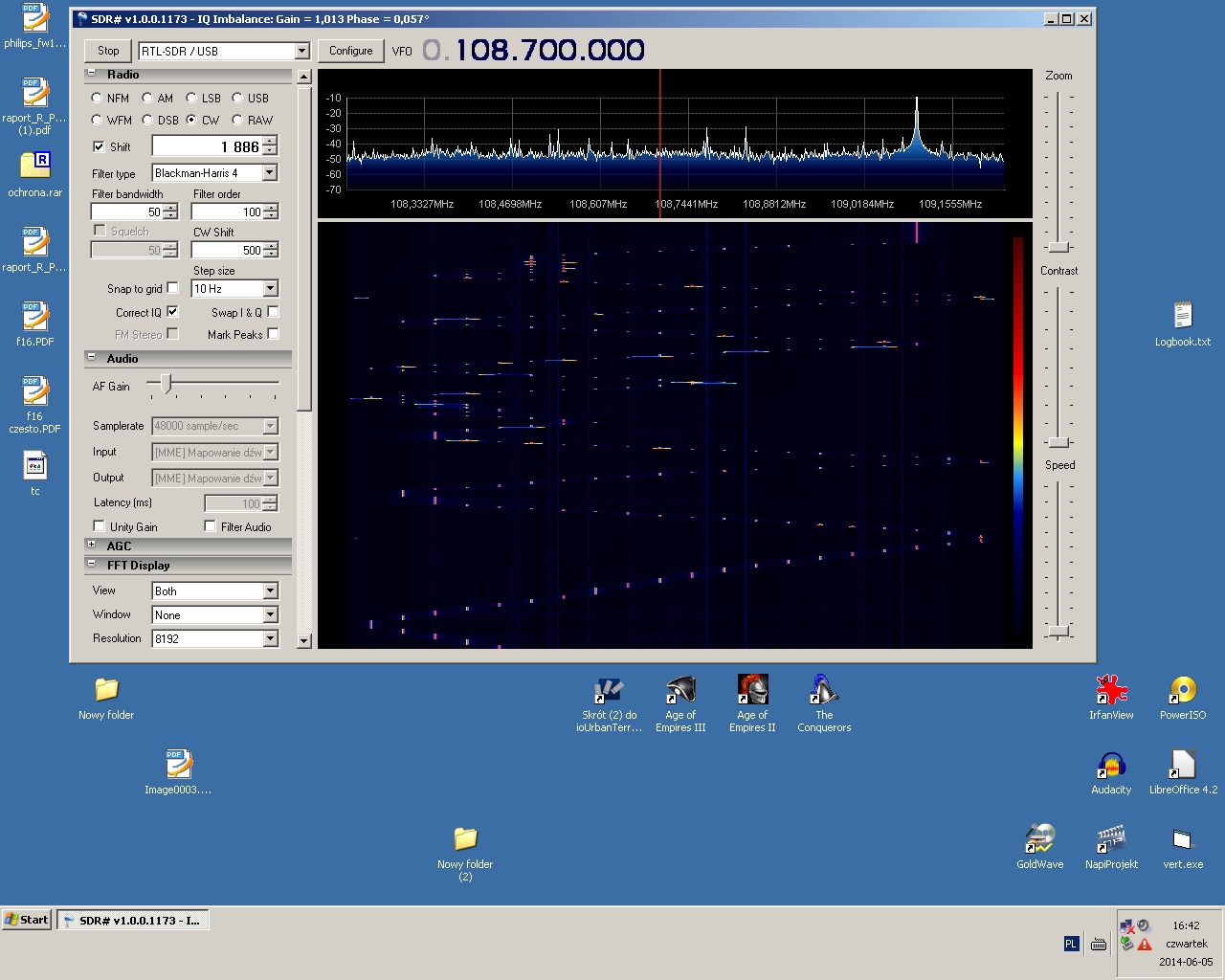

    As a curiosity, it gives a screenshot of the "tracking" frequency of the heterodyne / oscillator of the Philips mini-tower tuned every 50KHz :) . I believe that there was no antenna in the antenna socket and the sensitivity of the SDR was at a minimum ... After all, I know which radio stations the neighbors are listening to ...
  • #260 13682506
    methyl
    Posts: 183
    Rate: 32
    It's nice to see how the heterodyne is retuning. I recently saw a signal from a wireless mouse by accident. It turned out that it works at 27MHz and draws nice signals on the waterfall when it is working.
