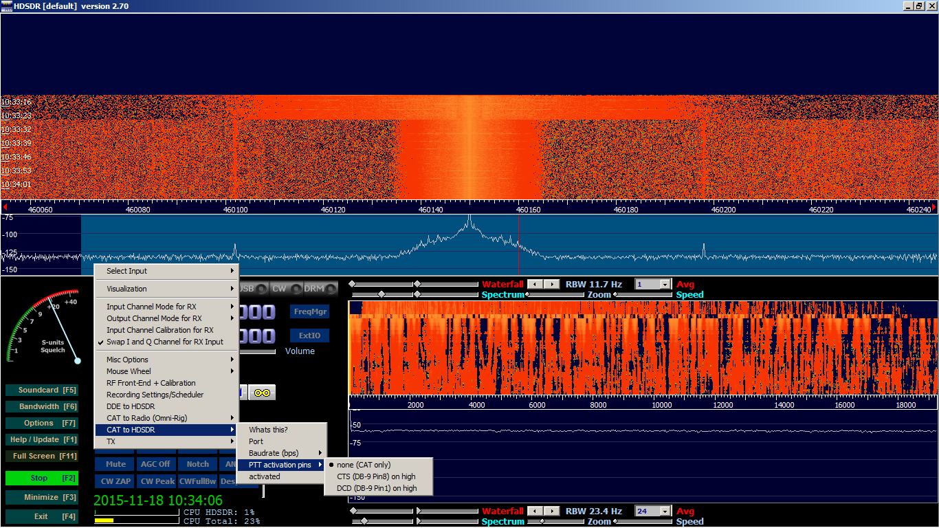

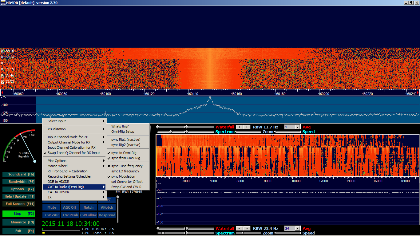

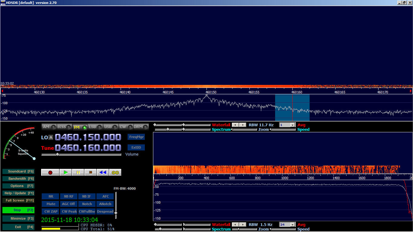

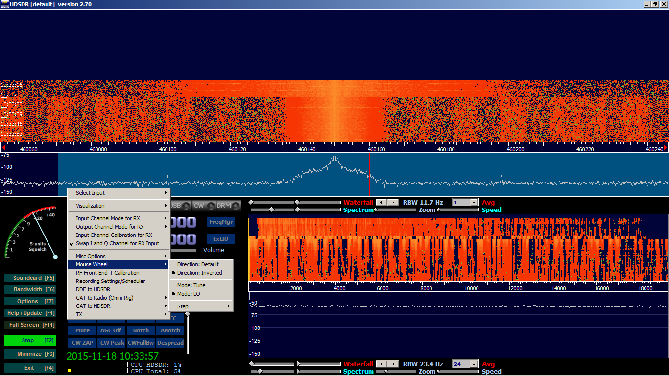

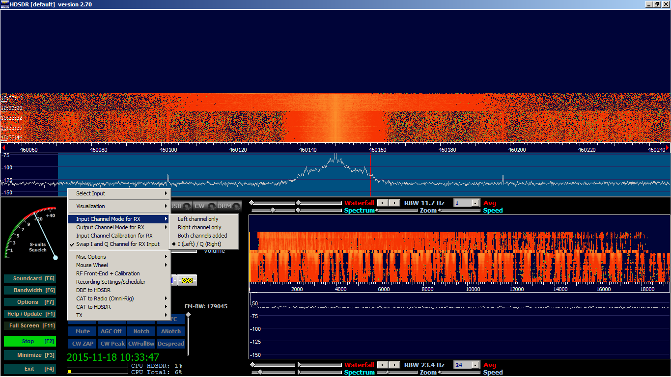

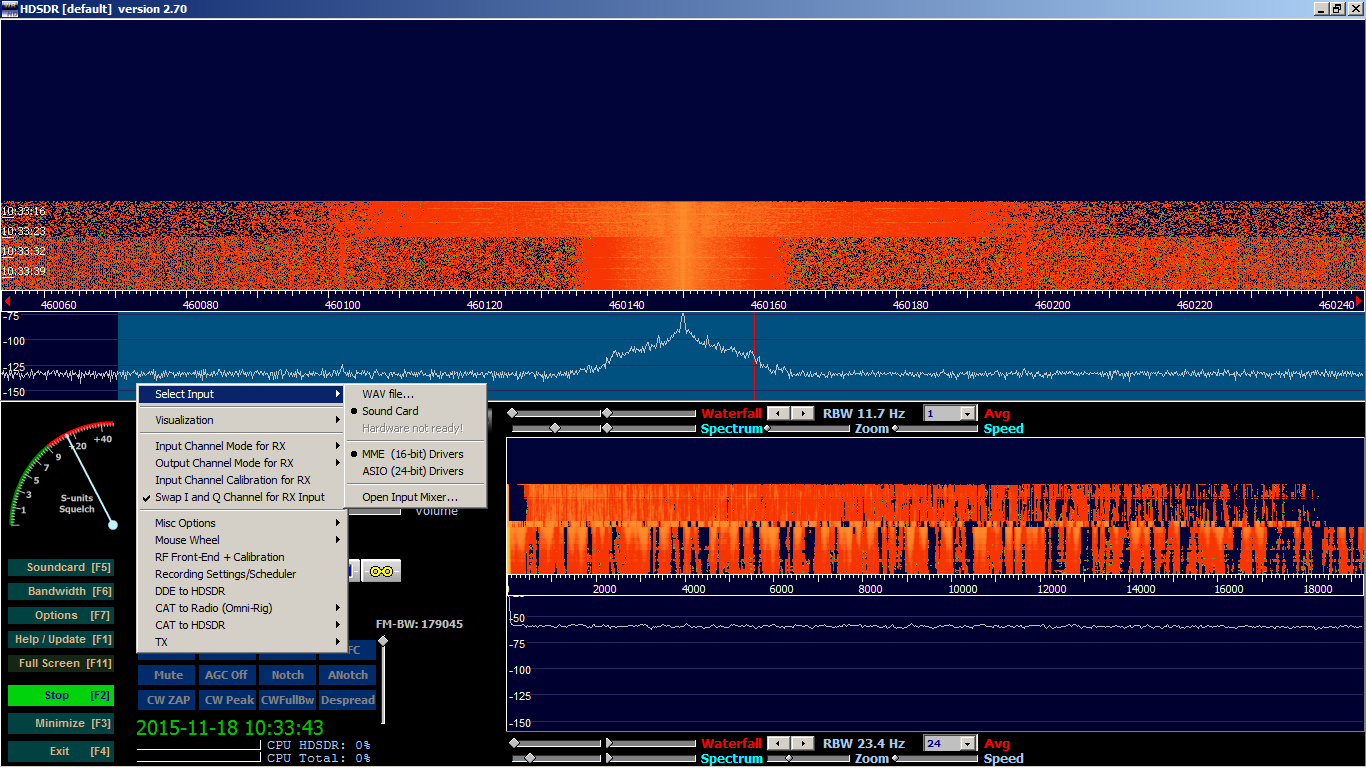

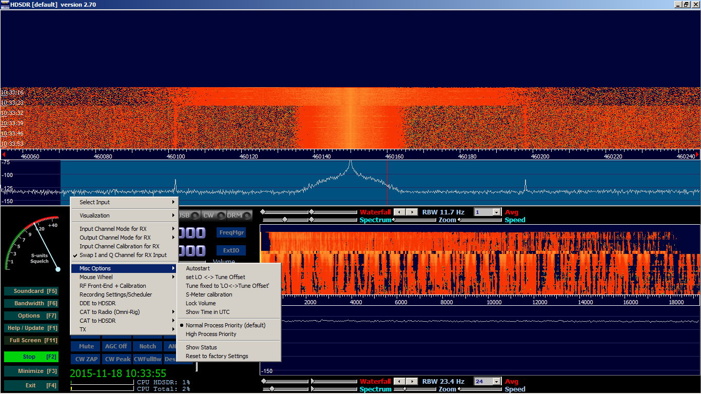

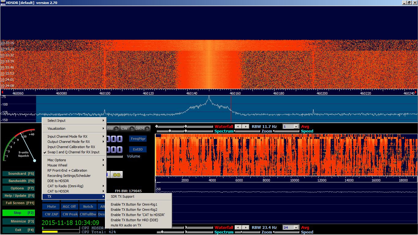

  • #646 15161655
    don_viking
    Level 21  
    Posts: 562
    Help: 14
    Rate: 136
    My friend tiqi first, write what program you use to receive this radio, you probably listened to the radio with bad modulation and wrong bandwidth setting, so you had a "tragic reception". Secondly, in the band from 28 to 34 MHz, harmonics from the 86-108 MHz band are often heard with these tuners due to the strong transmitters and this is normal. As for transmitting on one frequency and receiving on another, it is nothing else than a traditional repeater or "cross band". I recommend reading the forums for hams about the basics of radio communication. The width of the channel is always dependent on how the services are set and it is differently 6.25, 12.5, 25Khz. As for the antenna, I recommend a dipole or an ordinary quarter, there are schematics to look for.
    Descriptions in English can be translated at http://pl.pons.com/t%C5%82umaczenie-tekstu
    Or whole pages
    https://translate.google.pl/?hl=pl
    By connecting the tuner directly to the port, you can accidentally damage the port, a well-shielded extension cable is recommended. When connecting, pay attention to which port you have the least interference. In my case, there is no disturbance at one port, and at the rest they were different.

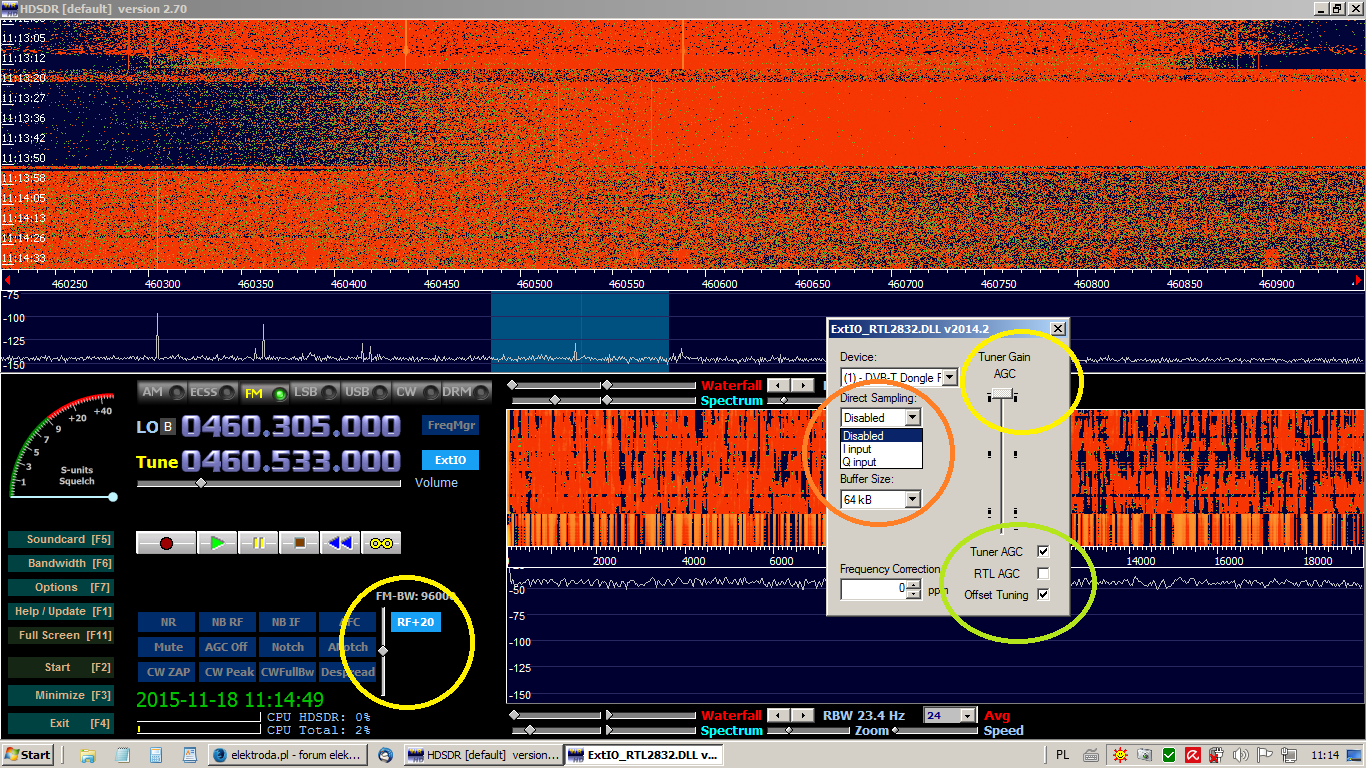

  • #647 15161721
    tiqi
    Posts: 93
    Rate: 26

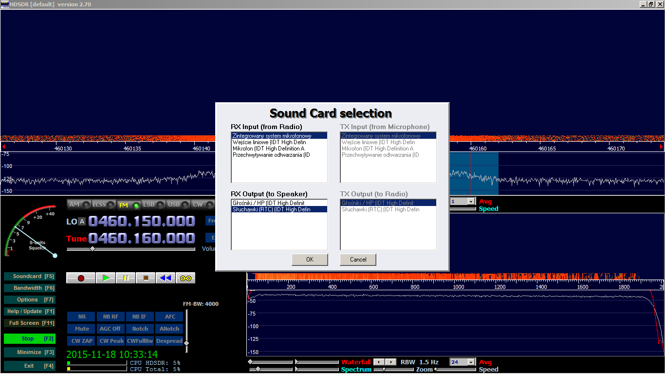

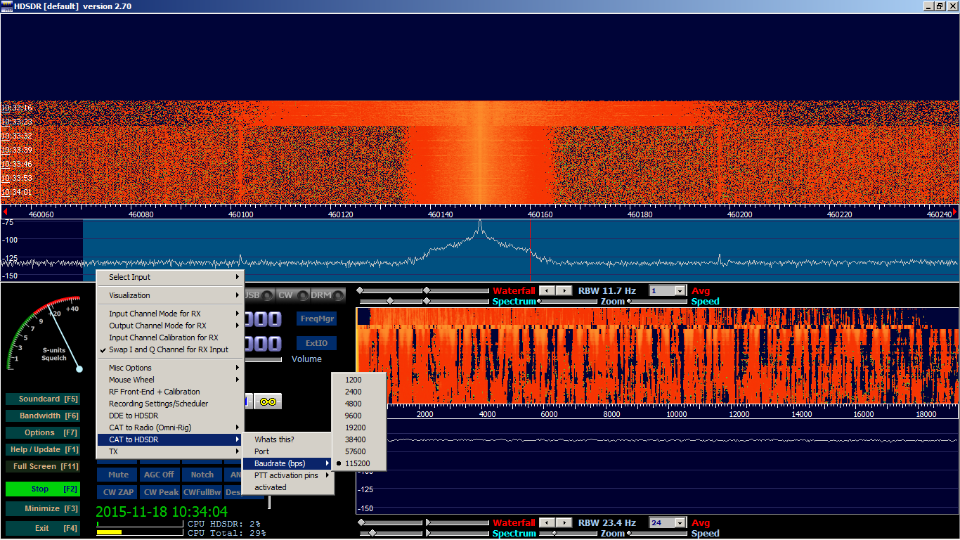

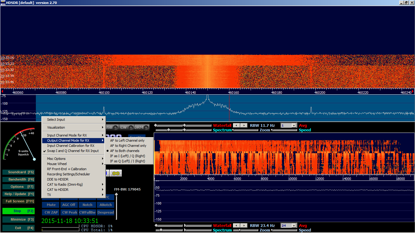

    Man, I already wrote somewhere what I use. Probably in a different thread, so I repeat the entry:
    The program is HDSDR version 2.70 running under Windows 7 x64.
    It's okay, but for example, yesterday I couldn't catch anything. Barely. Before yesterday, I had a DVBT antenna set on the balcony. Antenna with an impedance transformer with a filter and a tee on the cable. You could hear something, but it was so quiet! My speakers (headphones) are of very good quality (TDK Japan), the laptop is set to max. volume, all sound card settings to max. volume, but callers are heard so softly that I often don't understand what they are saying. Yesterday I decided to put together a different antenna from DVBT (ATZ long directional) to disconnect from the TV installation. I led everything with a 75oHm cable because I was already 50oHm short. Without the balun. Unfortunately, nothing can be heard, although the antenna is 4x larger than the previous one. Today I will build a different antenna.
    I present screenshots of the program and settings:
    How to use RTL-SDR on a cheap USB DVB-T tuner for HF and 64–1700 MHz?
    How to use RTL-SDR on a cheap USB DVB-T tuner for HF and 64–1700 MHz? How to use RTL-SDR on a cheap USB DVB-T tuner for HF and 64–1700 MHz? How to use RTL-SDR on a cheap USB DVB-T tuner for HF and 64–1700 MHz? How to use RTL-SDR on a cheap USB DVB-T tuner for HF and 64–1700 MHz? How to use RTL-SDR on a cheap USB DVB-T tuner for HF and 64–1700 MHz? How to use RTL-SDR on a cheap USB DVB-T tuner for HF and 64–1700 MHz? How to use RTL-SDR on a cheap USB DVB-T tuner for HF and 64–1700 MHz? How to use RTL-SDR on a cheap USB DVB-T tuner for HF and 64–1700 MHz? How to use RTL-SDR on a cheap USB DVB-T tuner for HF and 64–1700 MHz? How to use RTL-SDR on a cheap USB DVB-T tuner for HF and 64–1700 MHz? How to use RTL-SDR on a cheap USB DVB-T tuner for HF and 64–1700 MHz? How to use RTL-SDR on a cheap USB DVB-T tuner for HF and 64–1700 MHz?
    I used this article: http://sq6net.blogspot.com/2014/07/instalacja-rtl2832u-i-sdr-na-windowsie.html
    but for me, point is not working. 14 and 18 of this manual because I was looking for files from the article via google (the article is no longer active) and maybe something is simply missing. Today I am planning to: http://www.genesisradio.com.au/GSDR/
  • #648 15161805

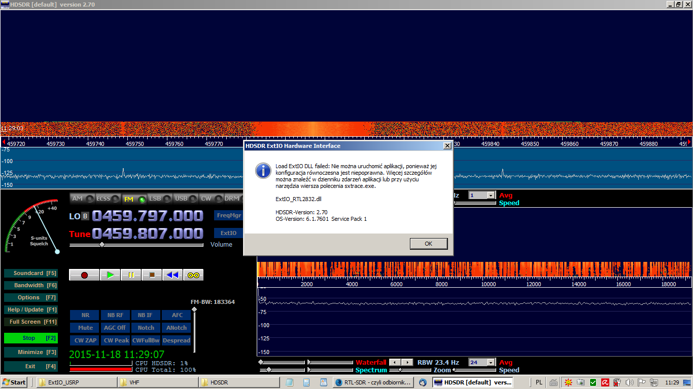

    Click on the "ExtIO" box to the right of the frequency and make a screenshot. From what it looks like you have an inactive window, which is probably why your program is not working as it should. Or if you want, go to this post earlier, I threw HDSDR programs there and SDRSharp below. You unpack, turn it on and they work if you have replaced tuner drivers.
    https://www.elektroda.pl/rtvforum/topic2353101-600.html#15098919
  • #649 15161821
    tiqi
    Posts: 93
    Rate: 26
    That's what I was about to ask and I even made a screenshot with what I don't understand. And so:
    in the field marked in red I have to have DISABLED because the rest of the functions mean that the receiver does not receive anything, not even the FM radio.
    I marked with yellow the parameters that I must have set to max. their values because reducing them causes the receiver to go silent.
    Green marked options that I do not understand, but turning off RTLAGC causes the receiver to turn off. He picks up but everything is distorted.
    Soon I will go to the link you provided and install other files.
    Oh, the buffer only works at 64kB and an attempt to adjust it causes silence in the speakers.
    I would like to add that my biggest problem at the moment is the lack of knowledge of the frequencies on which the mower is definitely transmitting. In truth, I found some municipal services, but there is no chance to set up the equipment on it. Apart from modulation, they also broadcast something encoded, which causes such noises that it is impossible to listen to it.
    Unfortunately, the substitution ended with an error. I will try to install the entire program.
  • #650 15161867
    don_viking
    Level 21  
    Posts: 562
    Help: 14
    Rate: 136
    Do not replace files, just download the program, unpack and turn it on. Simpler for you would be SDRSharp a few posts above are packed and thrown. The service was also described in this topic, you must read the previous posts.

  • #652 15161954
    ArturAVS
    Moderator
    Posts: 26416
    Help: 2303
    Rate: 7832
    Low modulation is the result of the setting. It should be NFM, not FM. Regular radio stations broadcast in FM.
    Each radio transmits on a narrow band (NFM).

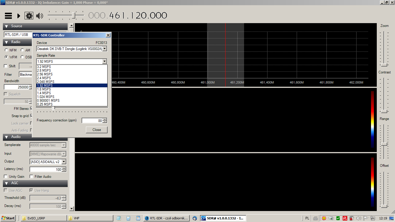

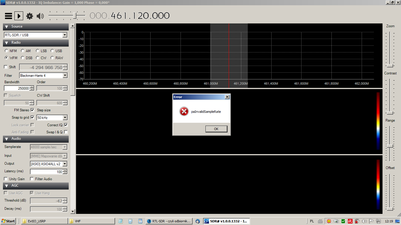

    I'm testing Sharp right now. The FM radio is loud and clean. I tried to listen to pow. 450MHz and it's still very quiet. I guess it's the antenna thing. I also tried to set something up and messed it up. I switched SampleRate to the highest (SDR received the best on it) and unfortunately now I have this:
    no matter what value I set. Error crashes from highest to lowest.
