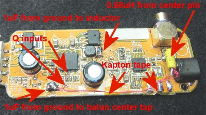

    Both capacitors have been desoldered and the antenna is connected experimentally to one of the two inputs. I even made a loop of about 300m of cable and connected between I and Q by shorting. Of course, something is always picked up there, but still, through the upconverter, I had much better performance. Fact, I did not try the broadband transformer. Do you think you would settle the matter?

    I and Q are the differential inputs of the ADC of the RTL system. The next pins are: 1-I + (positiv), 2-I- (negativ), 3-GND, 4-Q + (positiv), 5-Q- (negativ) !! If you connected the antenna to I and the ground to Q, no wonder that it does not work ... Again, I repeat again: tuners based on R820T / T2 chips do not use the Q input !! Link
  • RTL-SDR HF modification with diplexer and separate antenna input

    You can buy a version of the tuner with a generator instead of quartz and there is already a prepared output for the HF antenna. The description is on the page below.
    How to use RTL-SDR on a cheap USB DVB-T tuner for HF and 64–1700 MHz?
    http://www.rtl-sdr.com/modifying-an-rtl-sdr-by-adding-a-diplexer-to-receive-hf-and-vhfuhf/
    The HF input can be put on a separate socket and both HF and VHF antennas can be connected, and we switch only in the dongle settings of the band we want to listen to, switching between Direct sampling Q and Quadrature sampling.

    For those who did not play direct sampling, the information that apart from the galvanic separation and impedance matching in the form of a properly wound ball-una hit, one should use bandpass filters, especially above 14 MHz. Due to the way this connection works, from 0 to 14.4 MHz is tolerable and above 14.4 MHz the eggs start because there are signals from above 14 and below 14 MHz mixed together.
    I've seen this mess with my own eyes and I wouldn't recommend it without filters :)

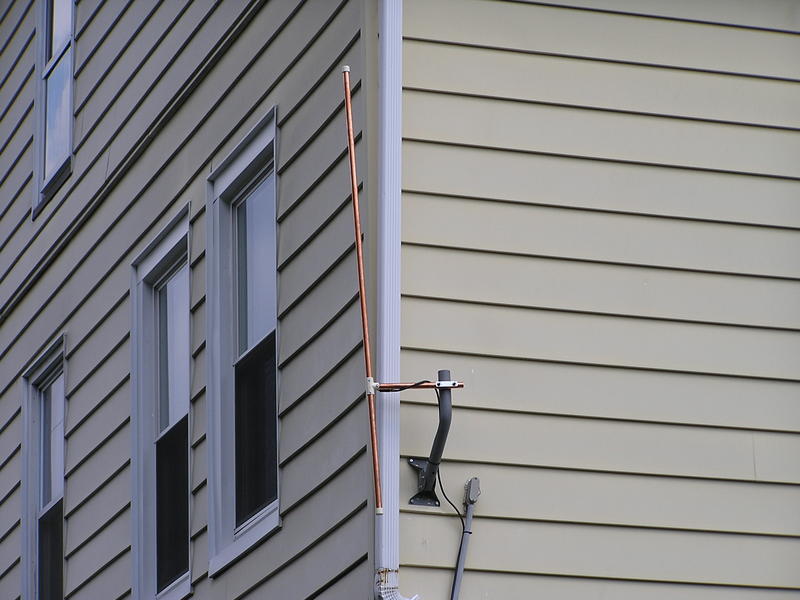

    I built such an antenna some time ago - Off Center Dipole Antenna How to use RTL-SDR on a cheap USB DVB-T tuner for HF and 64–1700 MHz? .
    with asymmetrical arms with a built-in symertizer.
    My current scanner runs on such an antenna Link
    except that the vertical arms of the antenna are hidden in PVC pipes (to protect against the vagaries of the weather) and additionally stabilized inside.

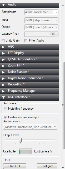

    Ask colleagues if anyone tried to play with Edacs but on one SDR from this link
    http://users.vline.pl/~pewusoft/sdr/how.html
    I mean the SDR itself with two plugins
    1. AUX VFO
    2. SerialController
    I tried to upload these plugins several times but I still have an error
    If any of my colleagues has such an SDR, I will gladly take it.
    Regards, Krzych

    To decode EDACS tracking, you do not need to combine anything, you normally turn on sdrsharp and UNItrunker decodes. I added sound samples in the attachment, just turn them on and play them on Virtual Audio Cable. The first file is EDACS48 and the second is EDACS96. And I will add that I have sampling set to 48000 in VAC and in sdrsharp, not like in link 96000.
    • rec1028-000928.wav (2.05 MB) You must be logged in to download this attachment.
    • rec1028-002526.wav (693.81 KB) You must be logged in to download this attachment.

How do I add HF direct sampling without removing the tuner?
On R820T boards, wire a 1:10 transformer to RTL pins 4-5, select “Direct Sampling Q” in SDR#. This keeps VHF/UHF intact [Elektroda, BOOM i ZONK, post #13914702]
