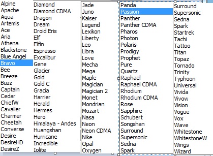

    I have HTC Sensation S-OFF and I cannot calibrate the screen after replacing it with a new one, i.e. I have a problem with unlocking and when it unlocks it works normally
  • #199 12520880
    MefistoNT
    Posts: 26
    I have PG58DIAG and HTC-ANDROID-GOLD_CARD files on the card or something else
  • #200 12520886
    hacker_ice
    Posts: 871
    Help: 36
    Rate: 101
    It's not that you have files for your HTC that's ok but the img for the card has to be different!
    Apple Surgery
    Śląska, Bargły, 42-262 | Company Website: https://applesurgery.com.pl
  • #201 12520889
    MefistoNT
    Posts: 26
    and you can make me an image for this HTC
  • #203 12520900
    MefistoNT
    Posts: 26
    and how can i check the code name, and the card is Kingston 2 gb
  • #204 12520914
    hacker_ice
    Posts: 871
    Help: 36
    Rate: 101
    You have to find it on the net, e.g. Wildfire S is BUZZ, and e.g. HTC Touch Pro 2 is Rhodium. Mi pada net, so you need to find something like this, write it and it will generate a goldcard
    Apple Surgery
  • #205 12520929
    MefistoNT
    Posts: 26
    they write on the net that it is the name Pyramid
  • #208 12521319
    hacker_ice
    Posts: 871
    Help: 36
    Rate: 101
    Unfortunately, I don't have the X-Clip and it's actually a Pyramid and I don't have it in the list

    .:aspire:.
    Posts: 608
    Help: 53
    Rate: 62
    hacker_ice wrote:
    p Wildfire S is BUZZ, and for example HTC Touch Pro 2 is Rhodium.
    Wildfire S is Marvel and Buzz is just Wildfire.
