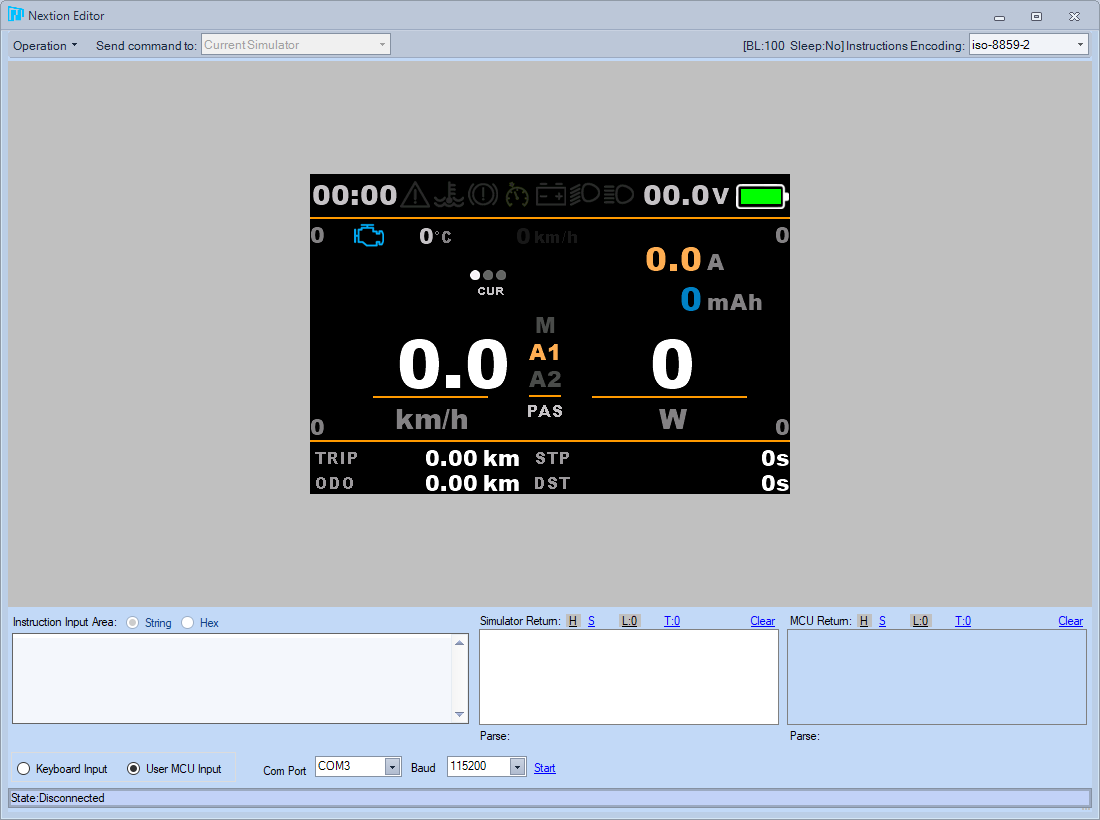

    Is it possible to simulate a specific display in the Nextion Editor?
    I'm making a field layout for a large display that's on the way :) , let's say I have a * .HMI file, I enter the editor in DEBUG and I would like to see what is on the Nextion 7 "display on the computer screen. I will not use touch, in DEBUG I have a static image and I would like to see what Arduino will do on the real display.
    Everything is fine with the program itself, but at 2.4 "without a magnifying glass I can not cope and on the computer screen I have a very good approximation of the display size.
  • #193 18735931
    Slawek K.
    Level 35  
    Posts: 3015
    Help: 259
    Rate: 1299
    click on Debug, then at the bottom of the User MCU input page, select COM, baud and click Start.
    Of course you connect arduino to COM, and anything normally arduino would send is Nextion, you will see on PC and values will change. You can also see thongs and bugs, great thing, I recommend it.

  • #194 18736016
    PiotrPitucha
    Posts: 2658
    Help: 201
    Rate: 423
    That's exactly what I do and nothing happens :(
    I wonder if there are any limits to the transmission speed, I have the display at 115200, Arduino Mega at 9600 because I read somewhere that the debug must be at 9600 and nothing :( .
    I'll try to change the display to 9600.
    Thanks
    Ps. I found the original program on which I used to debug, the display still does not work, but the connection is established and HEXy in the windows fly :) .
    Apparently some function is bothering with debugging, I will comment on individual tasks until the connection is established, because the serial definitions in both versions of the program are identical, just like nexconfig.h is unchanged

  • #195 18736116
    Slawek K.
    Level 35  
    Posts: 3015
    Help: 259
    Rate: 1299
    Don't use debugs in nexConfig.h
    Just act as if you had a PC program instead of a connected LCD Nextion. Baud in arduino must be identical to LCD.
    On the start page, on the LCD side, in the Preinitialize Event tab set the parameter:
    bauds = 115200
    Of course, while entering the speed you want, set arduino for Serial identically.
    It must work as long as you are sending data to Nextion in the correct format.
