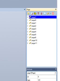

  • #39 17433984
    nebari
    Hello Mr. Krzysztof
    Some time has passed since our discussions on YT - I had a long break from working with the project but I am going back to continuing the topic. After changing / rearranging the pages (order), problems with which I am not able to deal with have broken down. The clock, lamps and thermometers flickered nicely and it was over :-( . The project generally concerns the controller / controller of the aquarium in a slightly expanded version.
    The driver options include:
    - control of two PWM channels with indication of the time of day of lamp operation (LED lamps)
    - temperature control and fan control (two channels) - animation of the fan operation on the panel when one of them is turned on,
    - measurement of the pH value and with the appropriate kH introduced, calculation of the value of carbon dioxide in the water Co2,
    - of course the current date and time,
    - fertilizer dispenser control.
    The whole in the one-channel version works on the arduino nano and the 20x4 LCD display, but there is no possibility of setting parameters from the display position only in the program and the need to reload the program to arduino, which is tiring and cumbersome.
    And now my heartfelt request to the experts from arduino and Nextion displays to help me embrace the subject, because I do not know how to handle it anymore.
    In the connection, I put the file for the display, my model is: NX3224T024_011. The Arduino to be operated is the MEGA 2560 version.
    Of course, if someone sees the use of such a project, I will be happy to share it, but let it work :-( .
    below the skech for arduino:

    So on quickly :
    Code: C / C++
    You have declared page 1 and then page0.nX, remove page0 in front of the numeric field name, check if these nX are on page 1 and if the IDs match the project in Nextion editor.
    Greetings
  • #41 17435112
    nebari
    rs6000 wrote:
    So on quickly :
    Code: C / C++
    Greetings
    Unfortunately, it is because first page 0 was created, which was the main page, and only at the end I made the start page, which was page 7 and when I changed the order in the page window, page7 is now with ID 0 and page 0 has ID 1 as in the picture below.
    Anyway, in this version everything was about adding and rearranging numeric fields, the text ID numbers of these fields have changed so I changed them in the code and has been sneezing ever since.

    But you have the wrong objects declared:
    Code: C / C++
    1 parameter is the page number on which the object is located
    2 parameter is the ID of the object on the given page
    3 parameter is the name of the object
    so if the page number is declared 1 then n1 cannot have page0 in front like you did: page0.n1
    It should be like this (assuming n1 is on page 1 and its ID is 16):
    Code: C / C++
    Attach the HMI file from Nextion it will be verifiable.
    Greetings
