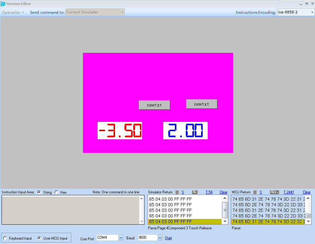

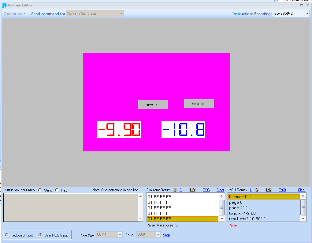

    The case turned out to be more complicated than I expected.
    If we use the ObjTXT.setText ("text") function in the program quite intensively; this is a very complicated matter. first things first.
    After starting arduino we have something like this:
    Video tutorial displays NEXTIONPrzechwyty..nie.PNG (23.09 kB)You must be logged in to download this attachment.
    in the MCU return window you can see that arduino sends bkcmd = 1 and according to the documentation it should be 2.
    Video tutorial displays NEXTIONPrzechwyty..ie2.PNG (13.1 kB)You must be logged in to download this attachment.
    In setup you can force it with the command:
    Code: C / C++

    You can see that it "eats" the data from the input buffer.
    after pressing the button on the display, the display sends to arduino e.g. 65 04 03 00 FF FF FF
    Video tutorial displays NEXTIONPrzechwyty..ie3.PNG (24.91 kB)You must be logged in to download this attachment.
    ie the info about a keystroke goes to arduino but gets swallowed up by the setText () function.
    The solution is, for example, displaying the temperature, e.g. every 2 seconds. Well, this is a solution called "bypass technologies" :D
    I guess these libraries should be reworked a bit because they are not perfect.
