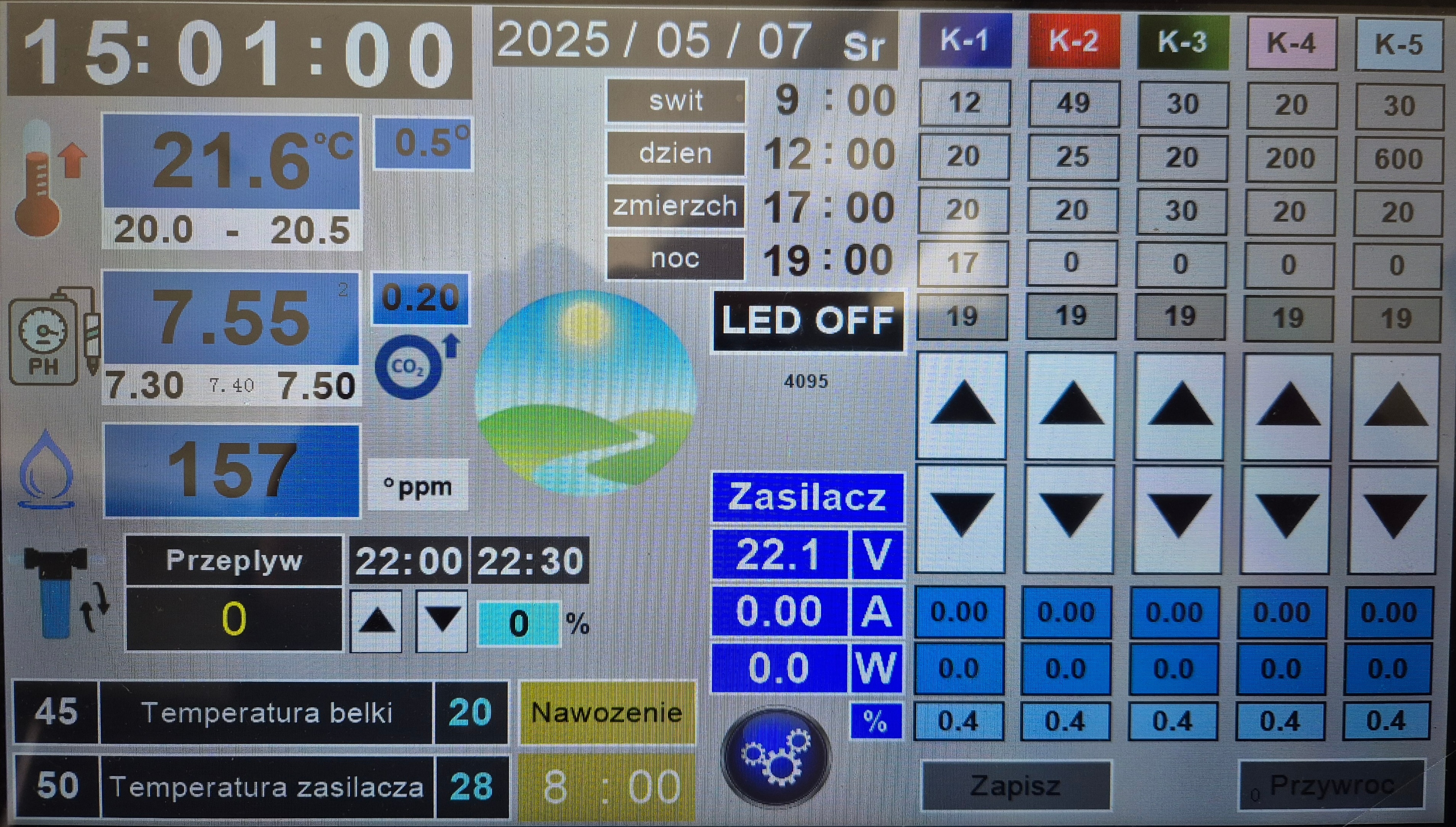

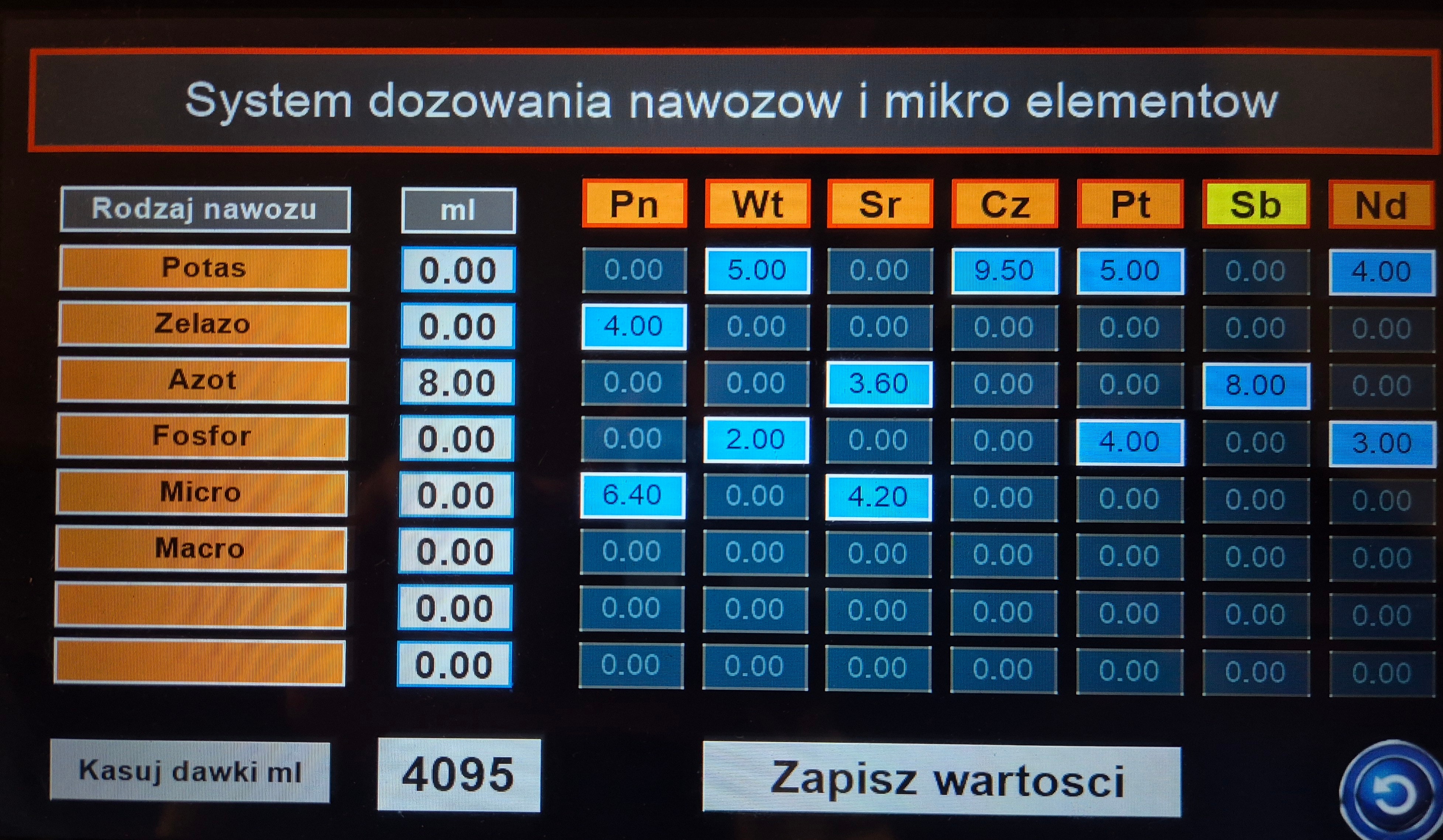

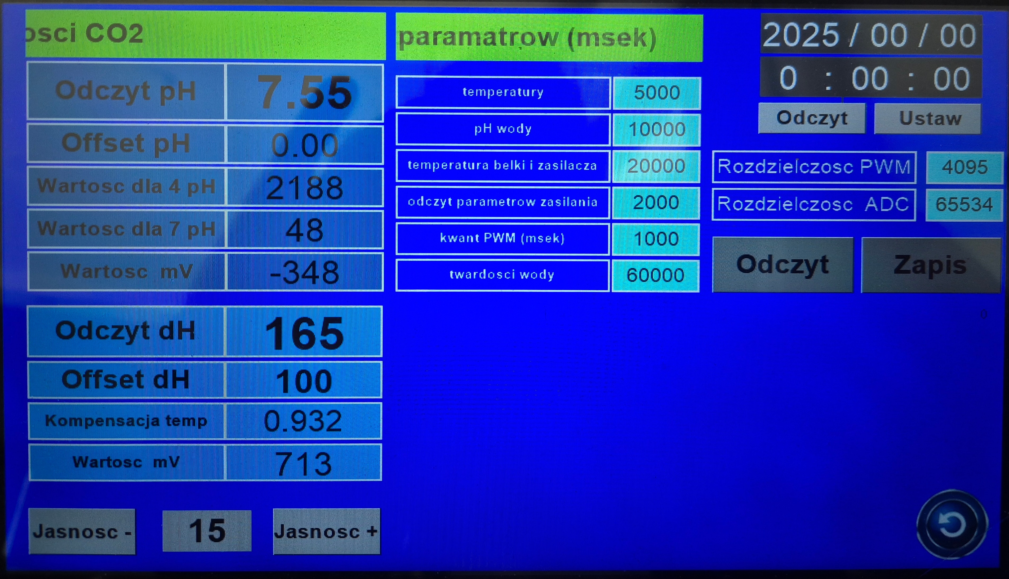

    #274 21542198
    spektra
    Posts: 332
    Help: 10
    Rate: 60
    Welcome.
    Back on Elektroda after a very long break. I have started to follow the topic of this display. I have already committed several projects on it. I am currently working on a project for an aquarium controller - led beam 8 channels controlled by 12 bit PWM, time of day, reading pH, dH, water temperatures, power supply, beam, power monitoring of individual channels, 8 channel fertiliser dispenser, UV lamp control, external filter monitoring and control.
    However, I have a small conundrum, namely - how to read from the arduino (Mega 2560 MINI) the number of the currently loaded page on the NEXTION display ?
    Thank you and best regards
    • Video tutorial displays NEXTION 20250507_150140.jpg (2.76 MB) You must be logged in to download this attachment.
    • Video tutorial displays NEXTION 20250507_150124.jpg (3.82 MB) You must be logged in to download this attachment.
    • Video tutorial displays NEXTION 20250503_213133.jpg (2.09 MB) You must be logged in to download this attachment.
  • #275 21542229
    spektra
    Posts: 332
    Help: 10
    Rate: 60
    I have just figured out how to do this.
