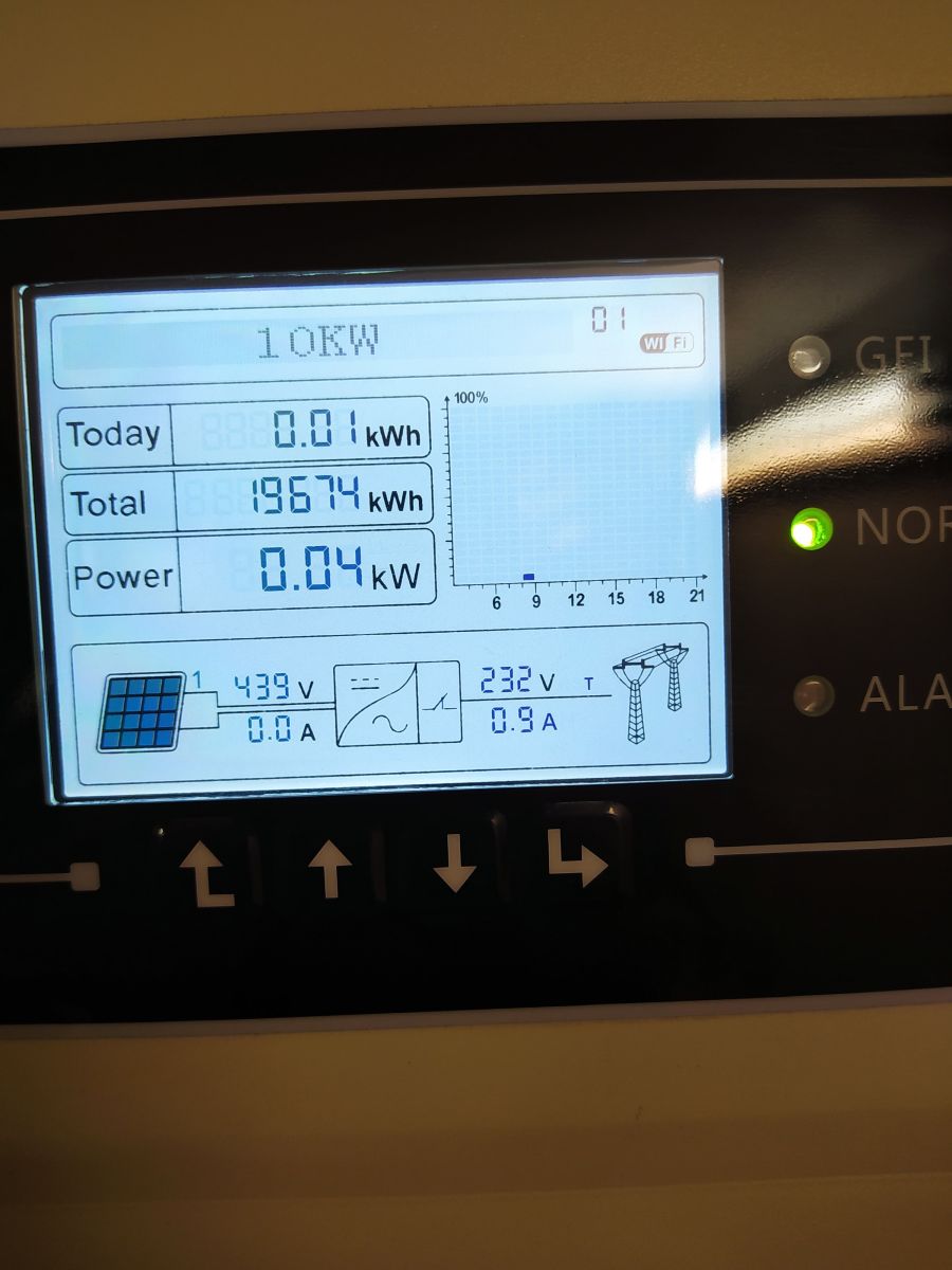

    Hello :)
    SOFAR 8.8KTL-X (9.92kW in panels) switched with SW3 jumpers from position 1100 to 1011,
    it should be 11kW, and it is
    SOFAR 8kW PV Installation: Opinions, Durability, Failures & Experiences with Inverters
    Curiosity. I don't think they even produced one in the KTL-X category.
    It doesn't bother me, we'll see the sun come.
    Edit.
    Maybe that's good because SOFAR 11KTL-X has a rated power of 10kW at the AC output, and
    the maximum is 11kW.
    greet
    At the neighbor's 11 KTL-X there is 10 kW.
    it should be 11kW
    After all, 8.8 also shows 8kW, not 8.8.
    It's OK.

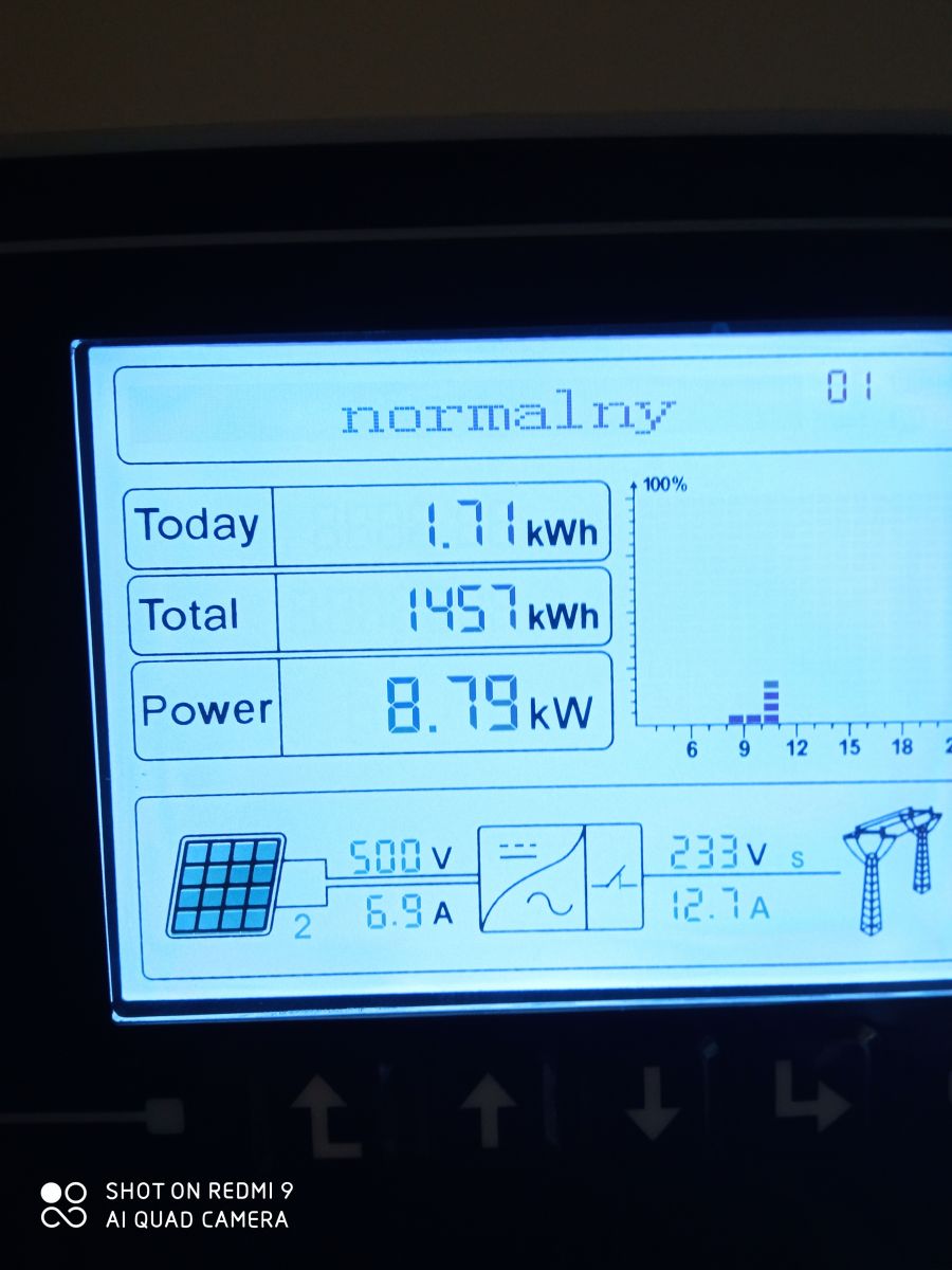

  • #1041 19806334
    pejan 123
    Posts: 18
    Please
    From this it only follows that the instantaneous power indication on the inverter is overestimated ... but as you see it.
  • #1042 19806346
    leon3029
    Posts: 25
    Rate: 9
    I have to worry you because these kW on the meter were flying like crazy.
    Supposedly, the weather will be on Sunday, I will take a photo, I will write the meter with PGE and after the whole day I will give you how much it has done and whether it is overstated or not.

    leon3029 wrote:
    I have to worry you because these kw on the meter were flying like crazy.
    Do you have an independent meter somewhere? Like so, disconnect almost everything in the house, when the inverter shows values well over the power of the panels, and then see some output is temporary.
    The inverter shows you 1kW more than the nominal power of the panels - it is over 10% ... It is unlikely that the panels have real power that much greater ...
    Tailoring

    prose
    Level 36  
    Posts: 3031
    Help: 172
    Rate: 846
    Nothing is deceiving, it just lets more power of the panels through, and in my case, the temporary production often shows over the power of the panels. I have mounted under the counter and everything is correct, no distortions.
  • #1046 19807257
    tom.pk
    Posts: 252
    Help: 11
    Rate: 54
    Please
    And when was this photo taken?
  • #1047 19807311
    leon3029
    Posts: 25
    Rate: 9
    Hello exactly on December 3rd. Lublin area of Biłgoraj. Today I pack 8,200 but I'm away to take a photo. It's supposed to be sunny tomorrow, so around 1 p.m. I will click a photo for Tomaszki to believe it :)
    A colleague prose has already exposed all the breweries for him because thanks to him I have such performance.
    greetings
    greetings
    Please click two photos - one is the voltage and current of PV1 on the display and the other for PV2.
    This photo of what you did shows PV2 - 500V and 6.9A, which is about 3.45kW of power from this string ...
    In that case, the second one must be producing at least 5.34kW at the time of taking the picture.
    tailor
