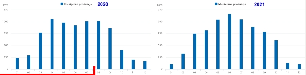

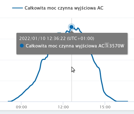

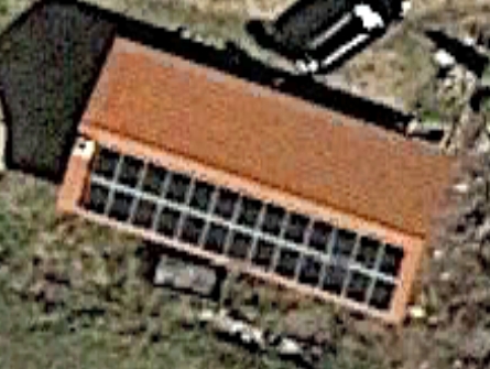

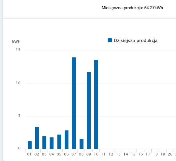

    leon3029 wrote:
    Someone with similar parameters, let him compare and give a tip how much he did to him, it will be indicative for those who press, that it distorts the inverter
    Current!
    How do you do that...???
    I have a SOFAR 8.8KTL-X, and 26 panels (3 years old) 310Wp = 8.060 Wp. Zero shadow, azimuth 200? or almost noon.
    In January, until today I have 54.27 kWh, and today at noon the maximum was less than 3.6 kW.
    I don't know where you live, but I live in Greater Poland - 52.4 degrees N wide.

  • #1056 19812788
    krawietz
    Posts: 273
    Help: 10
    Rate: 45
    Probably doesn't.
    Personally, I think that the power indications on the AC side are simply wrong due to the different design of the inverters up to 6kW and from 8kW.
    The readings on the DC side will probably be correct and they reveal how much can be squeezed out of this inverter switched with jumpers.
    Anyway, you don't need pictures of the display. Just go to the inverter monitoring page and view historical data on the output power and DC powers on each of the strings. If the AC power is greater than the sum of the DC power, it will be known that the data is given with an error. This, of course, does not exclude the possibility of producing over 6.6kVA, but we will not find out how much of it is realistic from the inverter.
    If the AC measurement is overstated it will likely be overstated for each production. The distortion percentage should be constant.
    Krawietz
