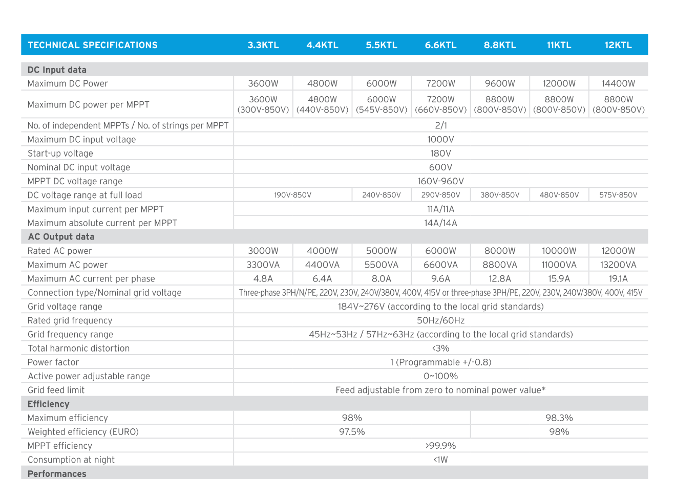

    lary504 wrote:
    If you connect the inputs in parallel, the current will be half the input. Although the g3 sofar is probably 13A, it will not exceed.
    Exactly, the current is distributed over two inputs, moreover, many manufacturers recommend connecting both inputs despite connecting 1 string.
    Added after 3 [minutes]:
    caged wrote:
    that is, panels in one string and one MPPT is probably the best solution, and the other MPPT will be for the expansion of the installation because I plan to do so.
    No, one string and both MPPTs connected in parallel.
    caged wrote:
    And how much can I fasten so that it does not cut? For now, I will give you one string and if something is then I will divide it into 2 equal.
    6.6kW has a max MPPT of 850V, you already have almost 800, so only one panel can be added.
    16 panels in two are not enough again. Then there will be only ~ 320V on 1 string, which will be on the border of 'full load' page 17 pdf.

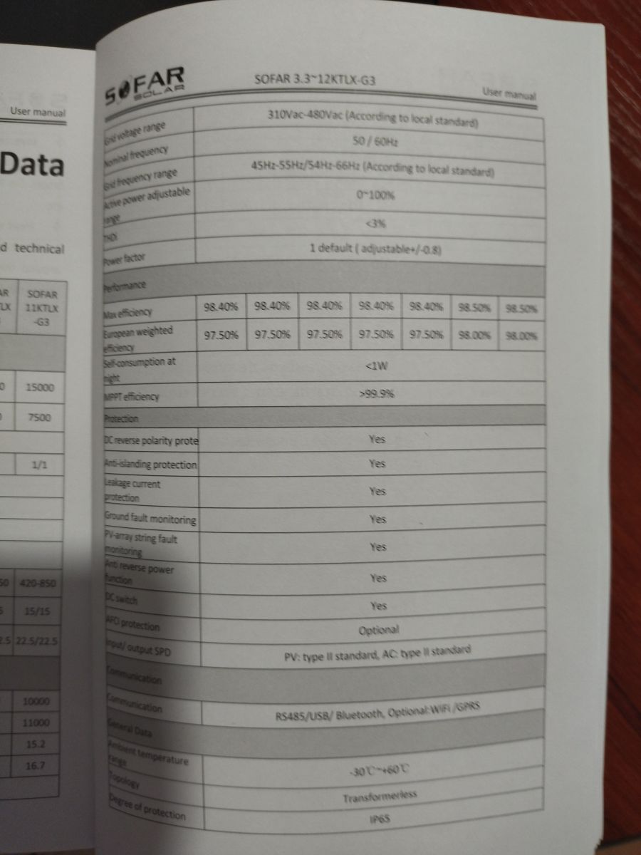

    Well, by this the max is 11A. SOFAR 8kW PV Installation: Opinions, Durability, Failures & Experiences with Inverters
    I have already given pdf a file before, and here it is about connecting
    rokbok wrote:
    Maybe 1100V though, unless we are looking at different datasheets.
    You are looking wrong, max input voltage is 1000V and MPPT is 850, in the second photo it shows.

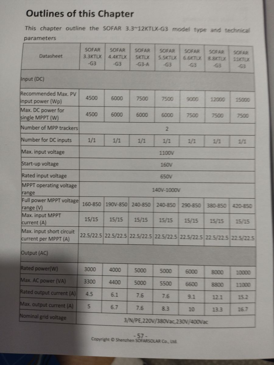

    Check the datasheet of the SOFAR 6.6KTLX-G3 inverter given by @caged, below I present the screenshot for the second time.

    Janusz_kk You pass KTL-X to Sofar and he has KTL-X G3 and has 13A and 1100V

    Ok, I did not notice, which does not change the fact that the manufacturer recommends connecting MPPT in parallel as they are unused, which I gave in the second screenshot.
    And the full MPPT range is also 850V, as I can see, so it can still give max 15 panels in a string.

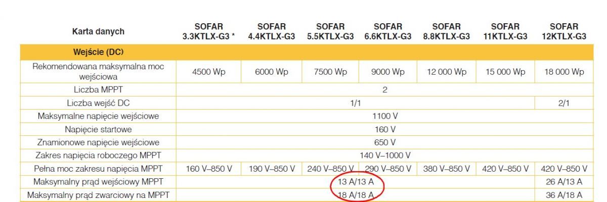

    Here is a photo from the catalog card of what I got with the inverter SOFAR 8kW PV Installation: Opinions, Durability, Failures & Experiences with Inverters SOFAR 8kW PV Installation: Opinions, Durability, Failures & Experiences with Inverters

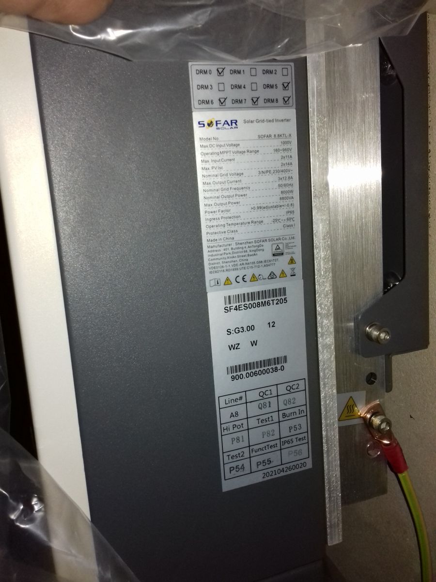

    I read in the topic about the different versions of the software. Can someone tell me which one I have? Does this label show it?

    After all, it writes to you, max 11A, 950V MPPT, as I read correctly from this poor photo.

  • #979 19724454
    prose
    Level 36  
    Posts: 3031
    Help: 172
    Rate: 846
    From the G3.00 sticker. And on the display in info.
  • #980 19726254
    binio1111
    Posts: 188
    Rate: 35
    Ok. Thanks. I was confused by this sticker because the thread mentioned the V versions ... and here is G.
