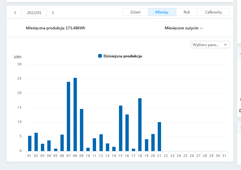

  • #1088 19835233
    leon3029
    Posts: 25
    Rate: 9
    Krzychooo
    Hello. I paste my January production to yesterday. I will add that I do not allow the panels to snow on my broom :)

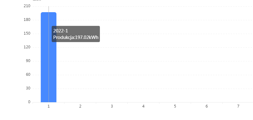

  • #1089 19835539
    Janusz_kk
    Posts: 5702
    Help: 216
    Rate: 1431
    I have 190kWh, 9kW PV, but the mountains and the 'swallow' in the middle of the roof cover me a bit.
  • #1090 19835663
    Krzychooo
    Posts: 141
    Rate: 30
    leon3029 wrote:
    January production until yesterday
    Prego.
    As I wrote above, 8.060 Wp, 200?, 30? tilt, no shade, but also sweepers ... :D

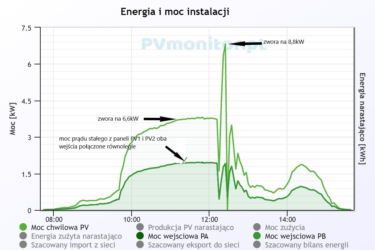

  • #1096 19836258
    adamvfr
    Posts: 130
    Rate: 16
    I have, among others, Sofara 8.8 and I was surprised that at 6.5Kwp it works loud and is quite warm, although I checked the charts it is max 54st. and usually 50st. but compared to the 3.6 single-phase it is warm and loud, I also have a Sofara 3.3kw G series? this one is also loud and very warm.
    Leon3029
    If you don't see a big distortion, it probably beats that much, because you know you need to take into account auto consumption.
    But still check it for a while with a clamp meter, because it's unbelievable.
  • #1097 19840240
    leon3029
    Posts: 25
    Rate: 9

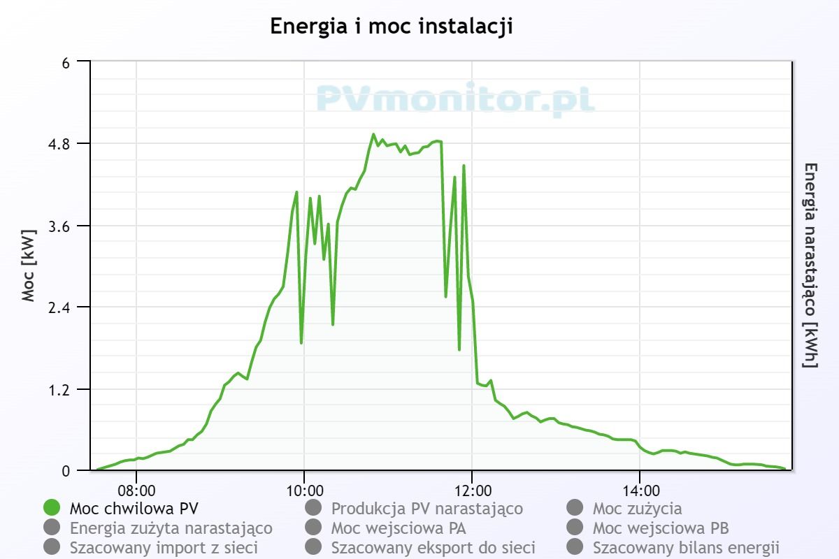

    Hello. Today I did the test because I couldn't stand it :)
    I changed the jumper at noon because the beautiful sun in Lubelskie had 6.6 all the time doing full and a flat graph, i.e. the inverter was cutting it off. I came back at 8.8 patched 8.2 then I went on and at 11 or 10kw I set and the same 8.1 to 8.3 did, I have nothing more to check and probably will not because the conclusion that, however, does not distort the Sofar quite so.
    The daily production today is 27kw on the inverter on the meter 23, so it may be because the central heating pump, electric kettle and the refrigerator were overloading the network.
    We will see how the sun will fly above February and March what will happen :)
  • #1098 19840928
    radar1967
    Posts: 22
    Leon3029, count the power that the panels give for direct current, i.e. PV1 and PV2 according to the formula P = U x I, voltage times the current that the inverter shows for direct current from the panels, sum these powers and you have the power that the panels give, if the DC power from panels is equal to or slightly lower AC power at the output of the inverter, everything is correct, the inverter reflects what it shows, but if the output power for AC as shown by the inverter is much higher than the power that comes out of the total power on the panels, it is simply the inverter shows erroneous overstated data, which you will find out after receiving the settlement from the power plant.
  • #1099 19841292
    Marksrz
    Posts: 552
    Help: 38
    Rate: 129
    The DC power cannot be equal to the AC power because the inverter would have to be 100% efficient
  • #1100 19841844
    radar1967
    Posts: 22
    I know that it cannot be equal to 100%, the efficiency of my colleague leon3029's inverter is, according to various sources, 97.5%, I wrote to suggest how to approximate whether the inverter shows the truth and lies without measuring devices.

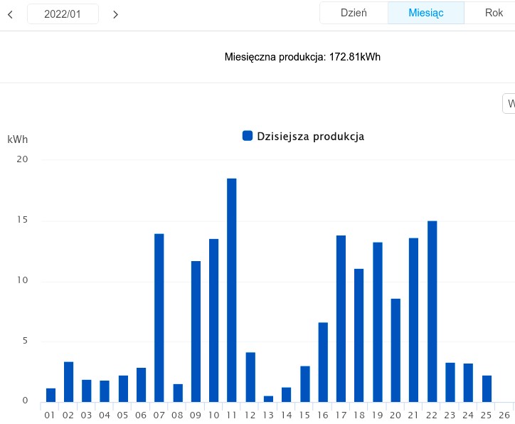

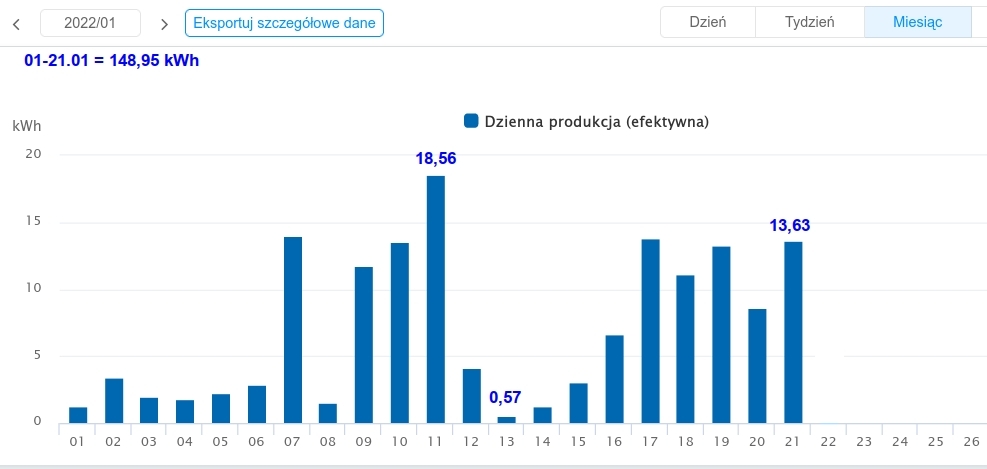

  • #1107 19842823
    Krzychooo
    Posts: 141
    Rate: 30
    prose wrote:
    I am 35 degrees and the snow will not fall by itself, but I have a farm building, it can be moved quickly and the production goes in January and today I have SOFAR 8kW PV Installation: Opinions, Durability, Failures & Experiences with Inverters With 6.3 kWp
    A miracle normally.
    I also have a farm building, elevation 200 °, inclination 30 °, SOFAR 8.8KTL-X without combination and 8060Wp in panels.
    And January production up to today 172.8 kWh without clipping and no breakdowns.
    There was bryndza for two days, because there was snow, and I did not have the strength and the will to fight it. There were also a lot of clouds, so it wouldn't be much.
    How do you explain that?
    Of course, Legnica is 135 km closer to the equator :D but without exaggeration. The weather in this part of Poland is rather similar, i.e. with you and with me.
    I check often because I have a family with PV nearby.
    Can you show a monthly chart like mine?

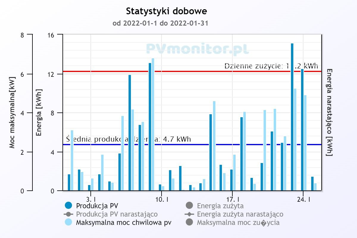

    radar1967
    Posts: 22
    Please, my inverter is an original 5.5kW sofar set on 6.6kW jumpers. production this month 114kWh
    Graph from 01/09/2022 when I was playing with jumpers, switching to 8.8kW
  • #1109 19843010
    krawietz
    Posts: 273
    Help: 10
    Rate: 45
    You can clearly see what is happening here, with the indications on the AC side when switching to 8.8.
    Suddenly they grow rapidly with no increase in power on the DC side.
    Krawietz
  • #1110 19843079
    radar1967
    Posts: 22
    I will add graphs of currents.
