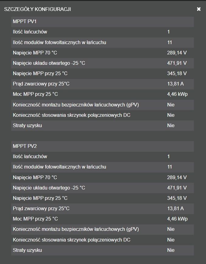

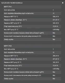

    Please check the correctness of the modification of the photovoltaic installation. I currently have 22 Suntech STP405S-C54 / Umhb panels connected to the Sofar Solar KTLX-G3 inverter. Panels connected in two lines (strings) connected to the inverter into two separate MPPT sockets. The inverter in the settings for an independent input. The voltage on each MPPT is approx. 345 V at 25 degrees C. Due to the fact that the rated input voltage for this inverter is 600V, I would like to change the connection of these panels to 22 pcs in series, connect to two shorted MPPT inputs and switch the inverter mode to parallel input. I used a calculator from one of the well-known companies and from these calculations it follows that such a configuration is possible (in the attachments there is a screenshot of the current and planned connection)
    One thing that worries me is that the maximum DC power for one MPPT of the inverter is exceeded, which is 6000W, but the connection here will be with shorted MPPT.
    Does such a change make sense and will it increase my energy gain and possibly by what order of magnitude? I asked the Sofar Solar service about the correctness of this modification, but there is no answer yet.

    borgen wrote:
    One thing that worries me is that the maximum DC power for one mppt of the inverter is exceeded, which is 6000W, but the connection here will be with shorted mppt.
    If you switch them to parallel connection it will be ok, nothing will be overloaded because both mppt will work together.
    You have good parameters, from the very beginning you had to combine into one string. It will be good and even better because the inverter efficiency will be higher.

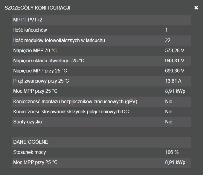

  • #1236 19983330
    dddmmm
    Posts: 14
    I would like to ask you to check the operation of my 9.9 kWh photovoltaic plant, which produces very little energy. Currently, I have 22 Jinko 450W Half Cut / Perc panels connected to the Inverter Sofar 11 KTL-X inverter, ground installation, south-facing, open area without shading. In April, the best production is 37.66 kWh. Panels connected in two strings connected to the inverter with two separate mppt sockets. On average, the voltage at each mppt is approximately 370-410V
    Maybe someone will tell you what I should check, one of the problems is probably too high voltage in the network, so I will try to involve Tauron, but I do not know if this is the only problem.

  • #1237 19983564
    Janusz_kk
    Posts: 5702
    Help: 216
    Rate: 1431
    You have too weak an inverter for these panels, 450W have a max of 13A and an inverter 11A and here it cuts once, two too few panels per string, according to the table, the full power voltage is why the inverter is 480V and this is not what your panels will achieve, here it cuts a second time, hence such and no other results. This is how you buy items rather than pick them.

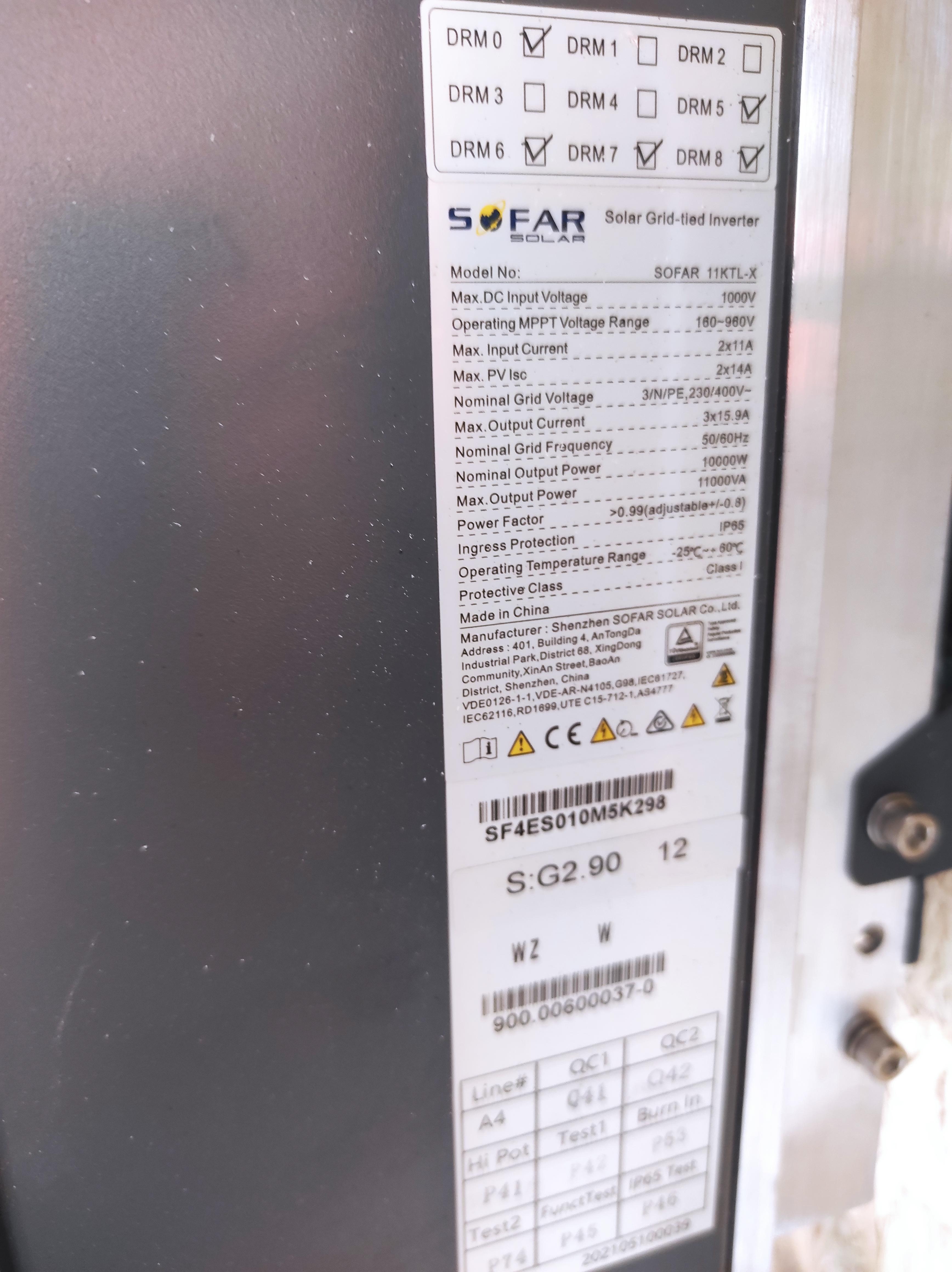

    dddmmm
    Posts: 14
    I have checked the invoice once again that I have a Sofar 11 KTL-X Inverter, nothing else is there. I bought the whole set at PVGroup from Chorzów, they had good opinions on the Internet and they were close, I live in Silesia. I contacted the Sofar service regarding the connection and they said that I should connect the panels on two strings. I wonder what to do now?
    Added after 8 [minutes]:

  • #1240 19983999
    Janusz_kk
    Posts: 5702
    Help: 216
    Rate: 1431
    What is not surprising to me, they deal with inverters and not with the selection of equipment for the installation. Who did the installation for you?

  • #1242 19984052
    Baqo
    Posts: 233
    Help: 11
    Rate: 83
    dddmmm wrote:
    I have checked the invoice once again for the Sofar 11 KTL-X Inverter,
    Check the nameplate of the inverter.

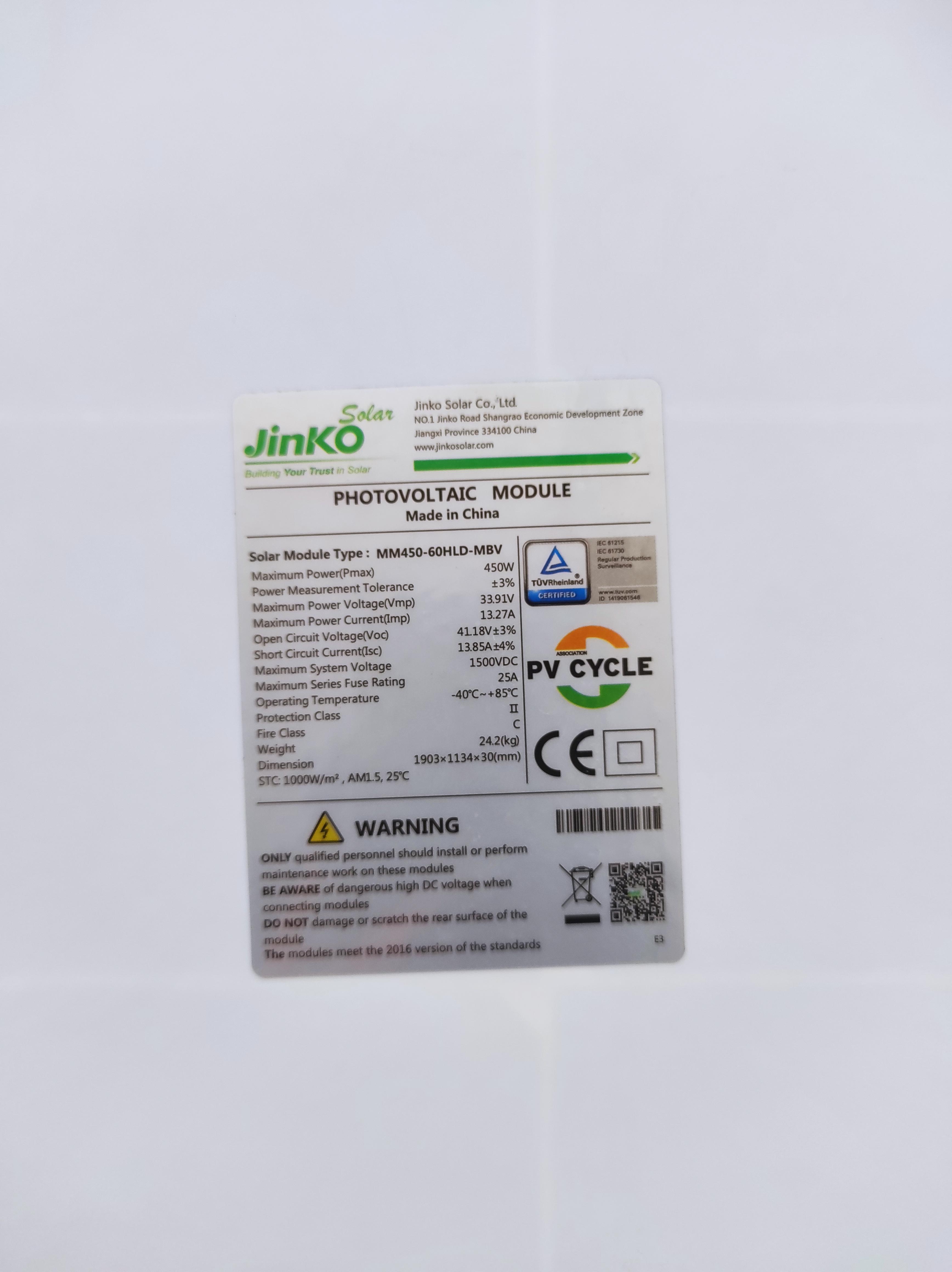

  • #1244 19984117
    dddmmm
    Posts: 14
    I attach a label from panels and inverter

  • #1246 19984141
    lary504
    Posts: 35
    The inverter has a 2X11A input, your panels max over 13A. I would combine the panels into one string and use a splitter from one string to two inputs. Then it will not cut your electricity. Oh, and changing the input type to parallel. But, in order not to be fun, you will have the voltage, like now, it is probably about 800V, which is a lot, but still within the range. The problem may be with frost in winter, I do not know if it will not exceed the permissible voltage. But I would check that later. The best solution would be to replace the inverter so that you have 14A at the input, but if it is not an option, I would do as above.
  • #1247 19984182
    dddmmm
    Posts: 14
    Thank you very much for the hint, I wrote a complaint to the PV Group just now because they chose the inverter for the panels, we'll see what they will do. I will probably wait for an answer, min. a week and then will try to do what you say although I have to find some local expert to try to fix this as you suggest.
    Maybe you can recommend someone who is a specialist in this field and works in Silesia, specifically in Sosnowiec or its vicinity?
  • #1248 19984226
    Janusz_kk
    Posts: 5702
    Help: 216
    Rate: 1431
    dddmmm wrote:
    I bought the whole set, inverter, panels and other elements from them, only then I bought 6 mm cables and additional security. The installations were connected by an electrician from Tauron
    So what, the store sold you what you wanted, the electrician connected and there is no designer who will design and calculate all the components.
    dddmmm wrote:
    Should he then attach the panels to one string? As I mentioned, the Sofar website advised to use two strings.
    So connect them in series and set the parallel connection in the inverter settings for mppt. It is true that you have a bit too many panels and it is on the border of the inverter because I get 1034V, but hopefully there will be no frost after -25 degrees :)
  • #1249 19984297
    dddmmm
    Posts: 14
    Janusz_kk wrote:
    I will do as you say, but I did not buy what I wanted, only a ready set recommended by the seller, I know it completely and relied on the seller, as I wrote earlier, I chose one that had good opinions. And what will happen when there are big frosts, unfortunately such frosts happen several times a year?
  • #1250 19984322
    Janusz_kk
    Posts: 5702
    Help: 216
    Rate: 1431
    Frost -25 has been gone for a long time, and what will happen, the open circuit voltage will increase, i.e. in the morning when there is no sun yet and the panels already give the voltage, it will be higher than normal, the colder the higher, when the threshold is exceeded, the inverter will crash the overvoltage error, as it grows further it may damage the inverter. But when the sun shines, the inverter will start working (unless it is wrong) and then the voltage will drop under load. as I counted, your voltage will not exceed 1100V, which is the maximum for the inverter.

    xury
    Automation specialist
    Posts: 7074
    Help: 877
    Rate: 1487
    Does anyone know what the files on the card named "." Are for (8 spaces, a period, 3 spaces) and how to read them?
  • #1253 19984451
    Janusz_kk
    Posts: 5702
    Help: 216
    Rate: 1431
    dddmmm wrote:
    so I don't have to worry about damaging the inverter?
    Nobody will give you a 100% guarantee, but according to these data, everything should be ok.

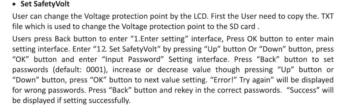

  • #1258 19985396
    jjj111222333
    Are Safety parameter files available for the 11KTL-X (not G3) models??? My country settings set the voltage too high for the Low Voltage tripping.
    The manual talks about copying a TXT file into the SD card before changing SafetyVolt parameters. Does anyone have access to the TXT file??? Why is this file such a secret???

  • #1260 19985562
    Janusz_kk
    Posts: 5702
    Help: 216
    Rate: 1431
    dddmmm wrote:
    Maybe you can suggest how to do it?
    Open this file with the manual, preferably on a laptop, on page 41 you have buttons and a description, press 1 on the left (menu)
    and use the arrows to the 1st setting and right (ok) you enter, then the arrows to the 9th position set the mppt again ok and with the arrows you change from 'independent' to 'parallel', approve ok and exit 'menu', 'menu', ' menu 'I don't think he should ask for a password and as he says, select 0001 with the arrows and confirm with approx.
