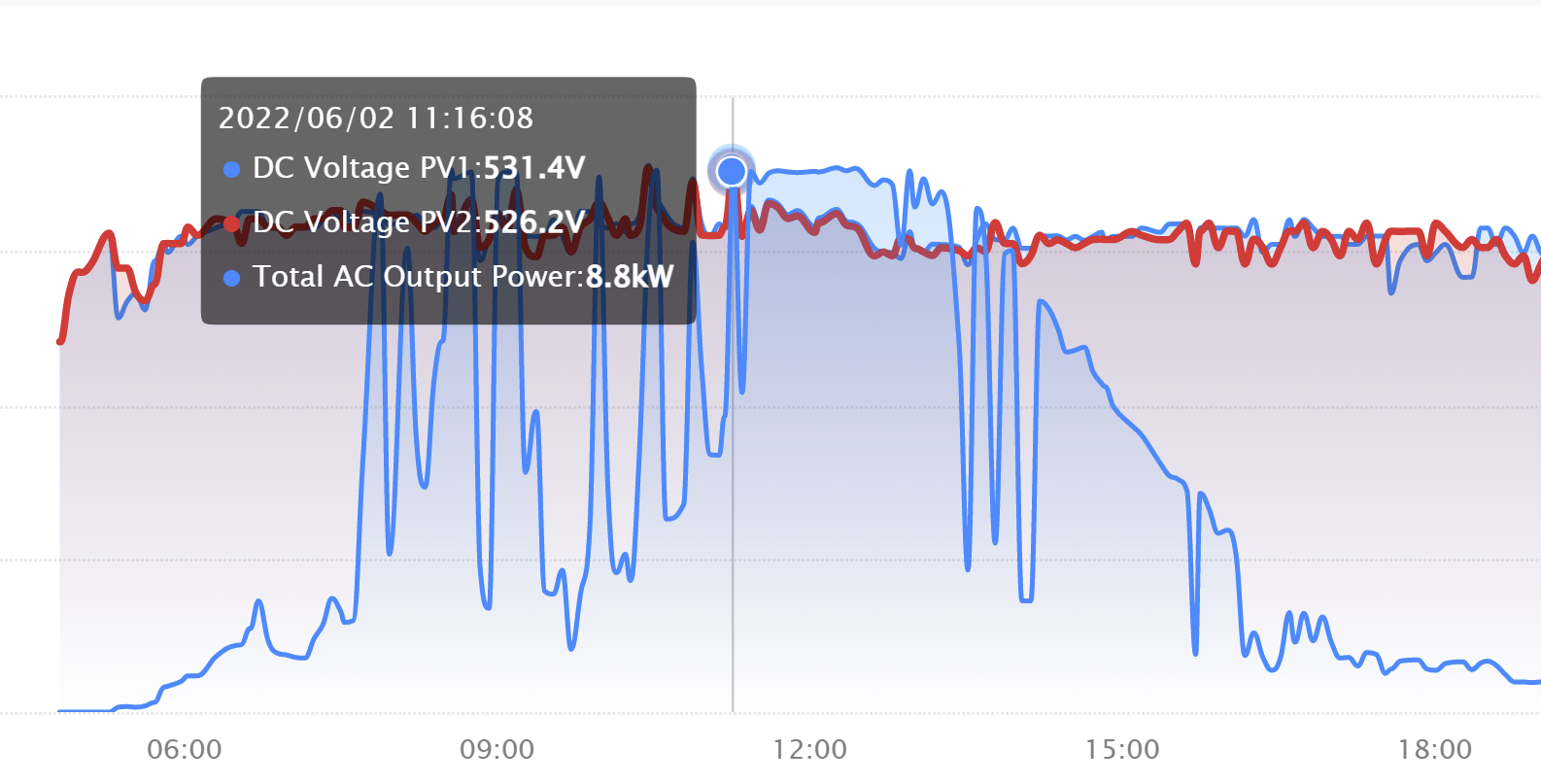

    It seems that when it is a cloudy day, the inverter cuts the power for short moments when the sun comes out from behind the clouds because on the module chains the voltage from the nominal Pmax 492V jumps to about 532V.
    SOFAR 8kW PV Installation: Opinions, Durability, Failures & Experiences with Inverters
    But in the case like today, when the whole day is sunny, the voltage does not reach the Pmax level, are the modules warmed up so much? Or maybe the inverter in the vicinity of the maximum power, to which it gradually comes, selects the operating point strangely?
    The recorded highest is about 484V, ie about 10% below the voltage from yesterday.
    Would he get anything more? Probably yes, but not much. On the next sunny day, I will unplug one string near the maximum power and check how much the inverter is able to squeeze out of half of the modules.
    Roof angle 40 degrees, south-east direction.

    kosmos99 wrote:
    Just note that the manufacturers recommend oversizing, so there can be no complaint or lack of professionalism.
    Why do you write that the 8.8 model will not handle 10kW panels when the manual says that the maximum power of the panels is 12kW.
    The manufacturer recommends (recommendation is not a requirement!) Oversizing because it is known that with 10kWp we will not get 10kW and the installation often does not have an optimal location (azimuth etc.) and hence the recommendations.
    Practice shows that since 8.8kW cuts with well-lit 10kWp modules, it is not optimal, although the maximum efficiency is achieved for several days a year, mainly in spring.
    12kW is the RECOMMENDED maximum power, with certainty due to the current-voltage protection. With poor elevation or azimuth NE and 20kWp, it will not be too high.
    Oversizing might still make sense, if the difference between the inverters was not in the range of PLN 200-400.
    Once the installer wanted + 2kPLN for the 2kW more power, then it made sense because mostly the truncations are negligible.
    If it cuts every day for a few hours, for me it is an assembly error (200 PLN / 2kW = 100 days of return).
    Added after 40 [minutes]:
    The panels lose their parameters with increasing temperature, e.g. -0.35% Pmax / ° C, where NOCT = 45 ? 2 ° C. When heated above 70 * C it can be even ~ 10% Pmax.
    Therefore, if it cuts even in summer, it will "cut" in spring all the more.
    For me, at 10kWp max in peak it was ~ 12.5kW (April 7),> 11kW happens often, while in continuous operation it rarely exceeds 10kW.
    Now in summer it reaches 9.8kW, and on very hot days only slightly above 9kW (June 3).
    The inverter 8.8 would cut this evenly almost daily.
