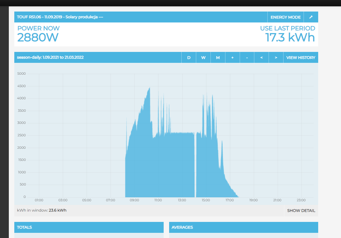

    After adding 3 panels, I had a problem.
    From the beginning. I have a 4.4KTL-X inverter and initially 9 525Wp panels were connected to it, the installation was installed in July 2021 with my own "hands". The inverter immediately reported as 6.6 (factory jumpers were in position 1101), so I thought about further expansion with another 3 panels up to 6.3kWp, which I also did last Saturday and here was the problem. Namely, the installation is fully metered and the solar power meter yesterday at noon started showing 2.6kW power, the inverter reported 5.2kW. Measurements of DC currents (approx. 11A divided into two inverter inputs, voltage approx. 490V) and AC (approx. 8A on each phase, voltage approx. 240V) confirmed the indication of approx. 5.2kW. Today it is similar, the indication from the 5.8kW inverter, from the 2.9kW sub-meter. Up to the power of 4.4kW, the indications are identical, after exceeding this power, the sub-meter starts to lower the indication, even though the power on the inverter increases. It looks as if the inverter is generating reactive power, even though it is set to 1, the sub-meter is counting the active power.
    Anyone have any idea what this could be about?
    Below is a chart of yesterday's production from the sub-meter.

    @frobek Check inverter temperature as it may be limiting production, and you had one shutdown due to high voltage.

    The temperature does not exceed 40 degrees, the inverter is outside under the panels, it is mounted on the ground, and I did it myself when measuring AC currents. The strange thing is that the phenomenon starts to occur when the magic 4.4 kW is exceeded.

    The strange thing is that the phenomenon starts to occur when the magic 4.4kW is exceeded.
    Maybe it is not the sub-meter that is lowering, and the inverter set incorrectly to 6.6 has different conversion factors and distorts. After all, it's 4.4KTLX and not 6.6?
    There is no additional load outside the layout?

    Then set it to 5.5 and see what happens then.

    But from the current measurements with a clamp meter, the meter is lying. I have one string, the measured current was approx. 11A at a voltage of approx. 490V DC.
    The program version on the sticker is 2.30, but the inverter shows 2.01.
    And it's not that nobody lies, but the inverter, after exceeding the threshold 4.4, gets the wrong algorithm to work (6.6) and produces max. 2600W AC?
    I would start with the correct setting of the inverter so that it identifies itself correctly.

    I changed the settings to 4kW, tomorrow we will see what it will be like. The indications from the inverter and in the application are as if it was actually produced today at a peak of approx. 6kW.
    Does anyone have such a "wired" inverter but with an external energy meter for comparison? If it wasn't for my external counter, I would jump to the ceiling with happiness that everything is super cool.

    I had the meter and indicate the production of 2 x as much as on the inverter, it turned out that the meter was broken. It is best to check on the ZE meter.

    I checked the meter readings for yesterday and I have this:
    Data from the Tauron counter:
    Downloaded from the network: 47kWh
    Total input: 22.7kWh
    Energy consumption by the house from my sub-meter (calibrated meter, repeatedly checked with the indications of Tauron): 58.5kWh
    Energy production from my sub-meter: 24.7kWh
    This means that the house consumed a total of 58.5kWh, including 47 from the grid and the rest 11.5kWh from PV.
    So PV had to produce 22.7 (feed-in) plus 11.5 consumed by the house, for a total of 34.3kWh. The application shows the production of 35.4 yesterday, so almost to the point. The conclusion that my sub-meter is distorting something or it is as I suspect that the inverter produces reactive power invisible to my meter, but counted by the Tauron meter and the inverter. It is important that the installation works with a power of 6kW and the Tauron meter "sees" :)

    When the tauron meter sees it is correct, it is lying under the meter.
    There is no such thing, an ordinary reactive power meter does not count, but it can be stupid. The inverter starts to produce reactive power when it comes close to the voltage limit and also in a very narrow range. You can read the reactive power from the tauron meter, these are positions from 6.8.0 and 7.8.0 but I can bet there will be zeros there.
