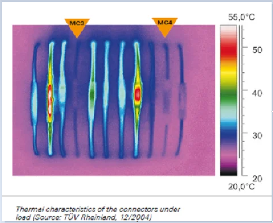

    At 11, two are heating up, maybe they were dirty or underpressed? And what kind of test is this, because the photo itself is not enough.

    Krzychooo
    Posts: 141
    Rate: 30
    Janusz_kk wrote:
    On 11, two are warming up, maybe they were dirty or underpressed?
    And that's what "all two", underpressed, dirty, etc. are all about.
    Janusz_kk wrote:
    And what kind of test is it anyway, because the picture itself is not enough.
    What do you not understand?
    In the photo it is (it is written) that this is a photo from the German TÜV (Rheinland) test from December 2004,
    consisting in checking the temperature of individual connectors under load with a thermal imaging camera.
    There were 11 pieces in total, MC4 and MC3.
    That's what I read from the "picture alone"...
  • #1376 20301651
    Janusz_kk
    Posts: 5702
    Help: 216
    Rate: 1431
    maybe start with yourself, what results from this test.
    But what producers and how mixed up because that's what it's all about.
    You are smart as a gimbus, do you know what types or manufacturers of connectors have been mixed up or how they have been soiled?
    Not? If not, then you know where to put it.
    There are over a million installations in Poland, maybe two of them burned down and as you can see, the fire appeared in the attic and not under the panels on the roof, which would mean faulty workmanship in the attic box.
    And from this test it would appear that every week there should be several PV fires in our place, and there were not. So the test sucks. The fact that there are films showing burnt connectors also does not prove anything because they were either tense or lying in the water.
    I will tell you one more thing, try to buy the same connectors as used by the panel manufacturer because only then you have everything compatible, good luck.
