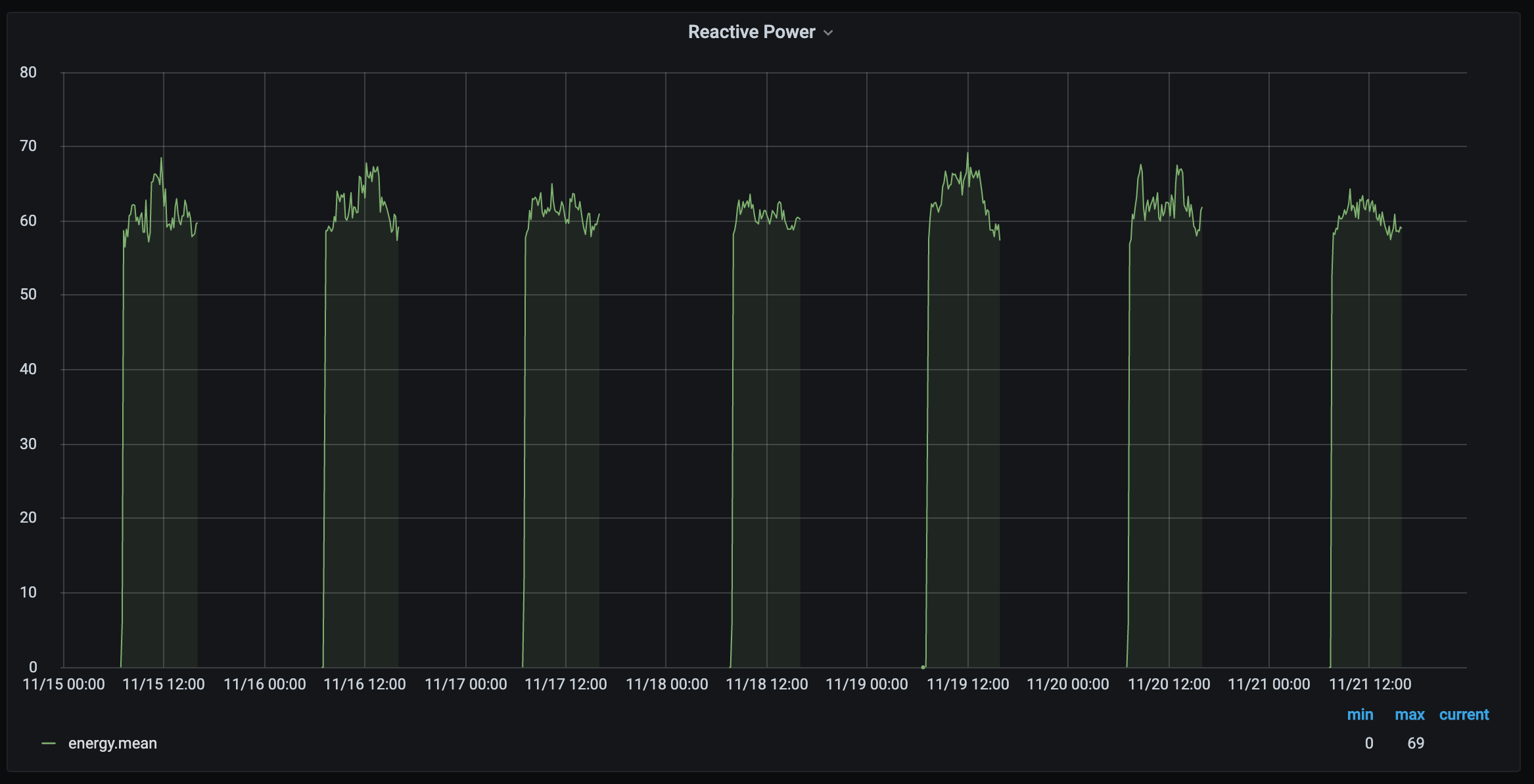

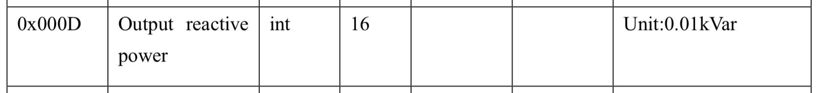

    Have any of you worked out where to read such a parameter as reactive power? or power factor? while the inverter is running.
    For example, Fronius makes it possible to read applications
    These are quite important parameters and it is worth knowing what they look like because sooner or later we can start paying for reactive energy (hopefully not), especially capacitive energy - the inverter produces a lot of it.
    Reactive power can be read on an ongoing basis via RS485 using the Modbus protocol:
    SOFAR 8kW PV Installation: Opinions, Durability, Failures & Experiences with Inverters
    And the power factor can probably be calculated from the formula?

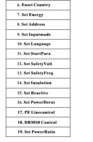

  • #305 19060265
    rydzyk673
    Posts: 54

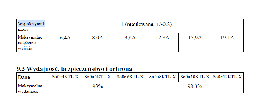

    In the inverter manual you can see that the power factor has an adjustment range. the only question is whether this regulation takes place automatically? the current value can be viewed in the info => power Factor system
    Can someone give what the settings from 15-19 mean?
    19- it seems to set the power factor.
    I am sending an interesting link to illustrate what is going on with reactive power and power coefficient https://www.youtube.com/watch?v=F4dmc5S_f-Q
    EDIT:
    I have just checked and under item 19 "power ratio" there are 3 submenus: under excitation, power factor, over excitation.
    So there is something to play in case of need.
    For now, I leave it as it was at the factory - that is, the coefficient is set to 1.00
    I also tested the MPPT scan settings (off by default), for testing I set it on with a time of 1 minute, covered one PV panel with a sheet of cardboard and observed the reaction speed and yield drops. I can say that I did not notice any difference in favor of the MPPT scanning enabled.

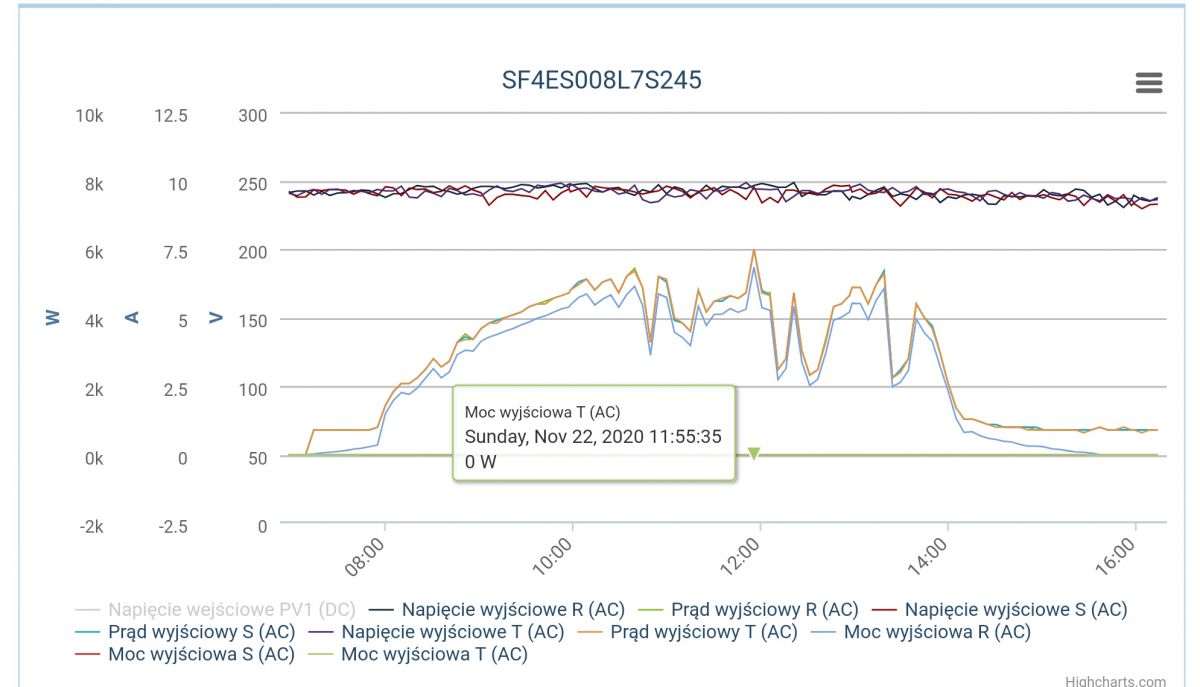

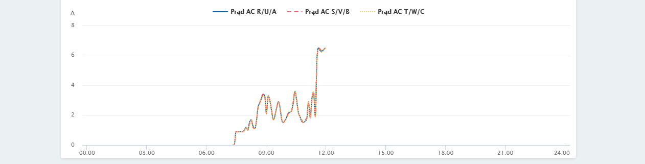

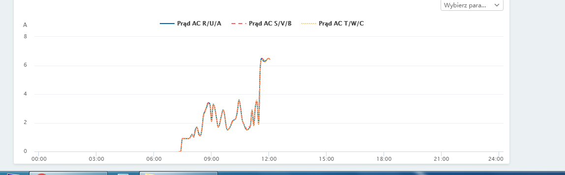

    Hello colleagues. I have been producing on Sofera 8.8 for a week. I am confused about 3-phase production. Solarman shows me the voltages and currents on each phase. I only have power in one phase. What is going on?

  • #307 19063491
    theo33
    Posts: 849
    Help: 78
    Rate: 320
    It has always been like this and there are probably some deficiencies in the software, note that this power on R is total after AC
  • #308 19063555
    lmax
    Posts: 19
    I noticed, although I had doubts. Looking at the graphs it looks like I was giving power on one phase. Can the production and consumption of individual phases be checked in the OTUS 3 meter? If not, are there any ways to control it?
    For me it is like this.

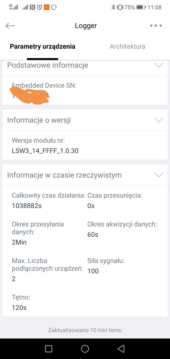

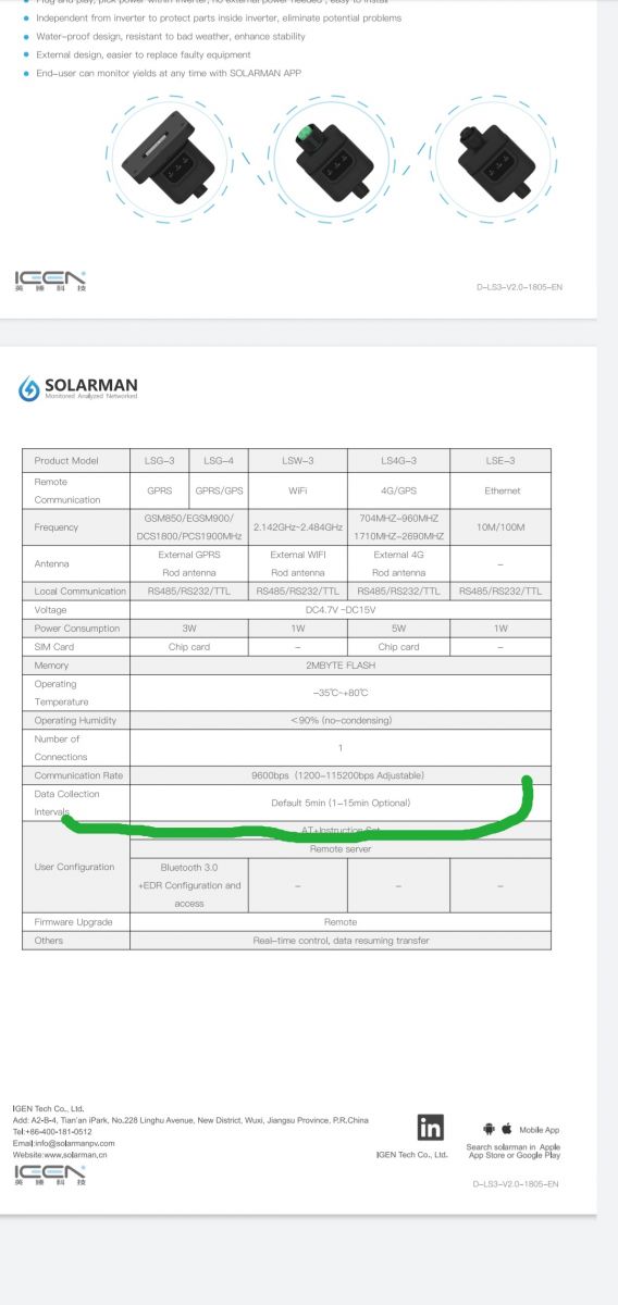

  • #316 19066461
    maxdax
    Posts: 106
    Rate: 14
    Strange because the description says default 5min (optional 1-15min)
  • #317 19066472
    theo33
    Posts: 849
    Help: 78
    Rate: 320
    Where it is? you can indicate such a record

    It should be on the wifi page but there is nothing to settings for data transfer.
  • #320 19066548
    maxdax
    Posts: 106
    Rate: 14

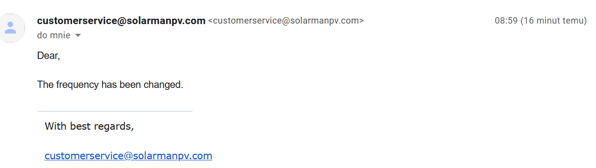

    I found information that I need to write an e-mail to customerservice(_at_)solarmanpv.com with the logger's serial number and they will change it.
  • #321 19066750
    theo33
    Posts: 849
    Help: 78
    Rate: 320
    Even on the pro.solarman website, when viewing the logger, there is only information that "Data transfer period : 5 Min"
    • SOFAR 8kW PV Installation: Opinions, Durability, Failures & Experiences with Inverters lsw3.png (137.44 KB) You must be logged in to download this attachment.
    Write it - we'll see if it's true.
  • #323 19067658
    maxdax
    Posts: 106
    Rate: 14

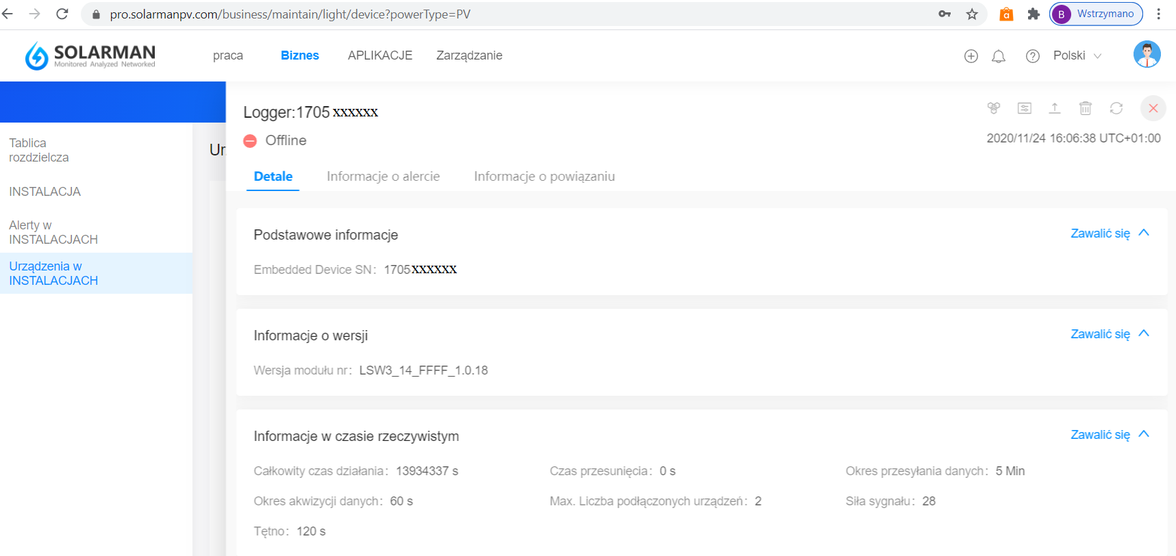

    Added after 17 [minutes]:

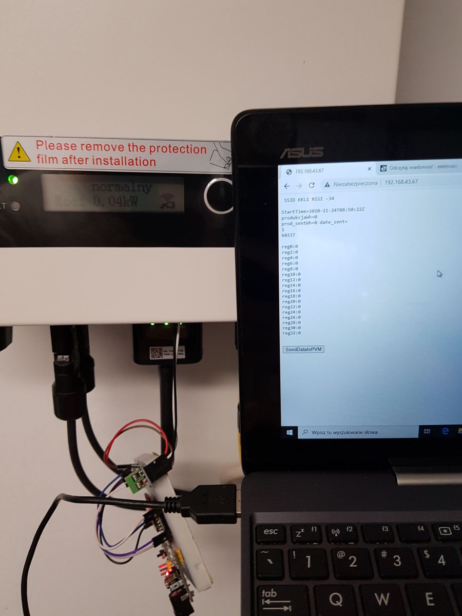

    Does anyone download data from the inverter. Sofar Solar 3.6KTLM-G2 grid inverter, or Sofar Solar 2700 TL via rs485, Do you need to change any settings in the inverter to establish a connection.
    I have a 9600 baud rate converter connected and there is a connection icon on the inverter display, SOFAR 8kW PV Installation: Opinions, Durability, Failures & Experiences with Inverters but no data is downloaded from the inverter.
    It does not send anything by itself, you have to ask the MODBUS protocol. You only need to know the unit number, which should be = 1
  • #329 19073312
    rakmo
    Posts: 53
    Rate: 24
    starob wrote:
    I'm trying on the basis of this, a colleague is using sofara 8.8 and it works for him.
    https://www.elektroda.pl/rtvforum/topic2734786-2010.html#18691057
  • #330 19075599
    starob
    Posts: 1088
    Help: 128
    Rate: 137
    It comes down to the same .. made a Modbus Wifi bridge. It may not work for you due to different register addresses of the inverter. You need to adjust the program for your inverter.
    Enter the appropriate values for:
    Serial.write (1);
    Serial.write (3);
    Serial.write (0);
    Serial.write (12);
    Serial.write (0);
    Serial.write (1);
    // CRC
    Serial.write (68);
    Serial.write (9);
    I am sending to my thread https://www.elektroda.pl/rtvforum/topic3698233.html
    there you will find addressing info.
    I noticed that there are two ways to address, and maybe you have the latter :)
    ..ps I took a moment and it looks like it's rather good.
    Maybe you have a problem on the RS side (e.g. wires swapped)?
    The mentioned projet is as I wrote modbys:
    Serial.write (1); - no. driver
    Serial.write (3); - function number 3
    Serial.write (0);
    Serial.write (12); - register address 12- 0x000C that is "power"
    Serial.write (0);
    Serial.write (1); - one register
    // CRC
    Serial.write (68); - checksum
    Serial.write (9);
    This program that you linked is not what you see in the photo - are you mixing something?
