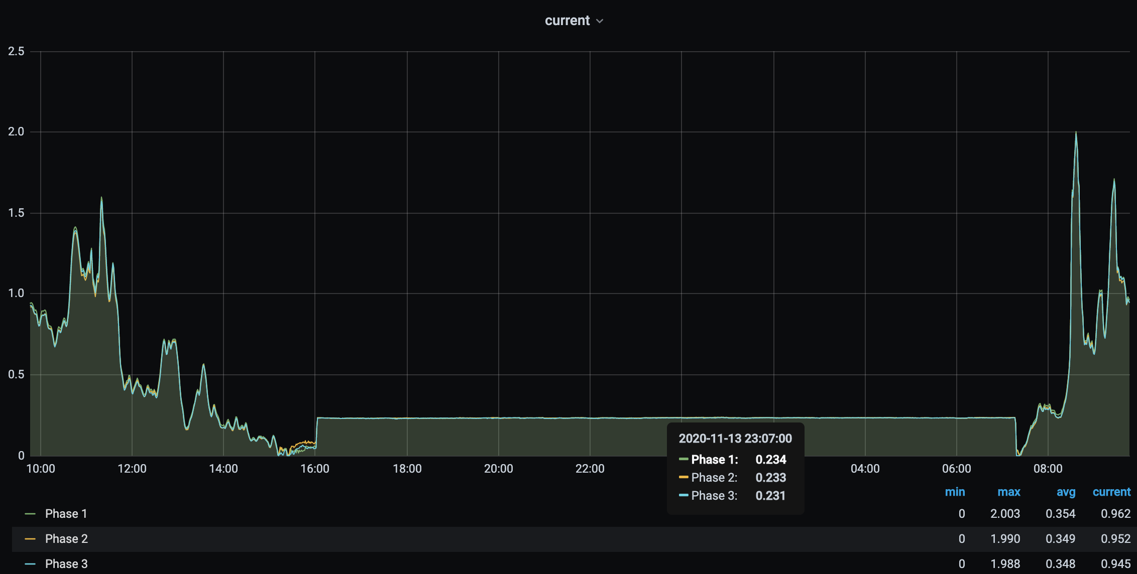

  • Inverter reports about 0.9 A idle phase current
    #295 19042677
    Emi_B
    Posts: 24
    wilk125 wrote:
    In addition, I measured the current on each phase, at rest (as there is no PV power supply), on each phase it is about 0.2A, active power 0W (from the sub-meter), immediately after starting this current slightly increases because it gives active power, but the solarman and the data after modbus show about 0.9A on each phase, is this an error in measuring this current by the inverter? How does it look like with you? Earlier, there were probably no such indications of currents, or I did not pay attention.
    Similarly for me:

Why does Solarman show 0.9 A per phase even at 0 W?
Firmware ≤ V2.30 reports reactive standby current as active. Real clamp-meter reading is ~0.2 A; ignore the dash-board figure until a patch arrives [Elektroda, wilk125, post #19038447]
