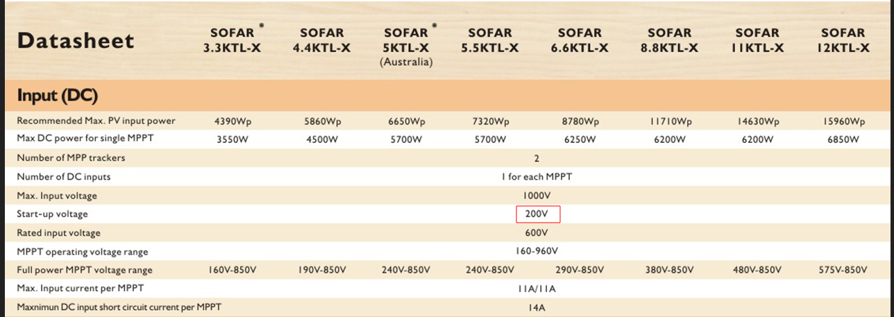

    Since the panels collapsed, the inverter starts and goes out. I have an error in the log
    HwAuxPowerFault alarm details
    Suggested solution of turnOFFthe "DCswitch"
    From the last state I have:
    PV1 101.20V
    PV2 101.30V
    There is quite a lot of snow, about 20 cm on the panels.
    Is it normal ?
    Unfortunately, I cannot remove snow from the panels. Is it possible to get rid of this on / off when the panels give too little power for the inverter's operation?

    I also had this error code recently on Jan. 19 so normal.

    I have the same. I turned off the inverter until the snow came off the panels. Anyway, you have it written in the solution: Turn Off DC switch - turn off the inverter.

    ..I recommend you to ignore it if it results from a known reason.
    This error occasionally also appears in the morning.

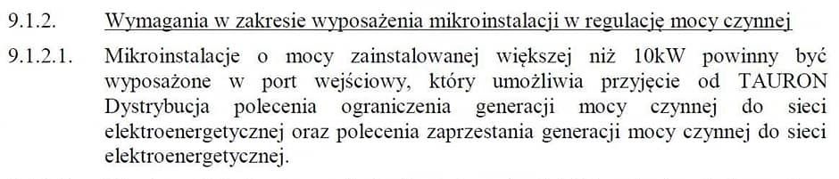

    Hello. I have a question for users or experts of Sofara hybrid inverters, my model is HYD 5000-ES. I am interested in how this inverter behaves during a remote shutdown by the power industry. Does its operation completely stop or does it switch to EPS emergency power mode, as in the event of a power outage? It would be best if only exports were stopped, but it's probably a beheaded dream. I am slowly connecting this inverter to the home network and at this stage I can still modify something, and I could not read this information in the manual.
  • #374 19229531
    3301
    Posts: 2100
    Help: 224
    Rate: 868
    This remote shutdown applies SOFAR 8kW PV Installation: Opinions, Durability, Failures & Experiences with Inverters installations above 10 kW
  • #375 19229930
    marucha79
    Posts: 180
    Rate: 24
    Maybe I was wrong. Is it not the case that every inverter connected to the grid must turn off when the frequency or voltage exceeds the limit value, which is used by the power industry when there is an undesirable overproduction of energy from PV installations, including small ones?
  • #376 19229972
    3301
    Posts: 2100
    Help: 224
    Rate: 868
    The sofar itself limits the power when the frequency or voltage approaches the set values, and when it exceeds, the inverter automatically switches off and remote limitation or regulation for power below 10 kW has not yet been taken into account
  • #377 19229995
    marucha79
    Posts: 180
    Rate: 24
    Thank you, it simplifies things a lot.

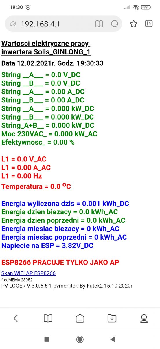

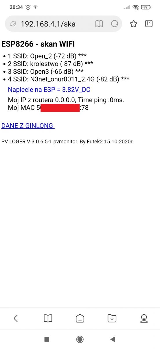

    I have an embarrassing situation;
    after uploading the BIN file named ESP8266_WiFiWebServer_65-1_RS485_SOLIS_GINLONG_UP_WWW_CON.bin to ESP8266-12E
    as part of the configuration at 192.168.4.1/config, I enabled communication with the home WiFi network
    The same action performed on ESP8266-01 does not allow communication from the local network even though ESP is visible in it.
    Could this situation be caused by reduced memory resources in ESP8266-01 (ESP8266EX)?
    In both situations, WiFi scanning works fine.

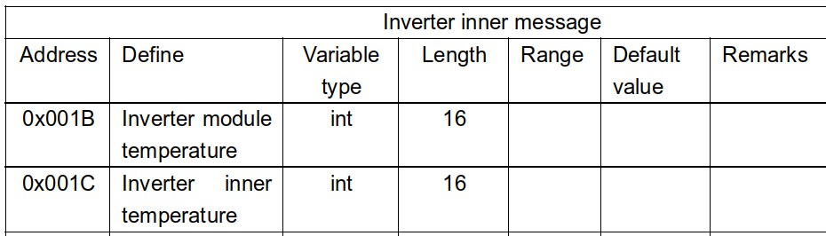

    Krzychooo
    Posts: 141
    Rate: 30
    DEFENCE wrote:
    Does anyone know from which MPPT, if there are two, the inverter takes data regarding the temperature of the panels ??
    And on what do you base your knowledge (certainty) that it does it?
    For example, according to the RS485 communication protocol, only the temperature of the inverter is displayed
    (probably a sensor on the motherboard) - address 0x001B and the temperature inside the inverter - 0x001C.
    I have not found (or can not find) information about the temperature of the panels there.
    Anyway, how can it be combined with a whole bunch of different panels on the market if even inverters do not have somehow
    exactly (so far) standardized protocols?
    On my panels (ZNSHINE ZXM6-TLD60-310), I also don't see any thermocouple or other sensor.
    As far as I know / it seems, there is normally no information between the panel and the inverter about the temperature
    panel. Maybe it would be useful, but if it is not, apparently not.
    I'm wrong?
    I know about different panel cooling systems (water, air, passive), but this applies to rather large ones
    industrial installations, where a decrease in efficiency by a few percent (due to temperature) gives high values
    power and hence losses for investors.
    In small prosumer installations it seems to make no sense (economically).
    • SOFAR 8kW PV Installation: Opinions, Durability, Failures & Experiences with Inverters dane.jpg (42.31 KB) You must be logged in to download this attachment.

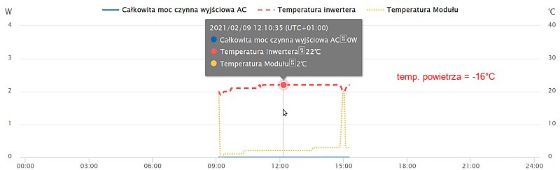

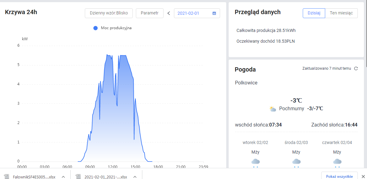

    Krzychooo
    Posts: 141
    Rate: 30
    DEFENCE wrote:
    I take from the Device ---> History -> function there is the temperature of the inverter and panels. Which on frosty days looks right ...
    Well, that's right, but the question is "module / module" in this case really a panel?
    Check out the picture in the previous post where it specifically mentions about "inverter module temperature " .
    In my opinion, it is about some "module" of the inverter, more crucial and important, but of course I can be wrong.
    I also base my theory on my own observations. I have an inverter in my garage, where the temperature is now
    is fixed at 0-1 degrees (measured remotely with DS18B20) and from this very value every day
    starts my graph in SOLARMAN and then it is exactly correlated with the internal temperature of the inverter.
    It was like that a few days ago (09.02) when it was -23 degrees outside at night and in the morning during take-off
    of the inverter around -18 (there was no production then).

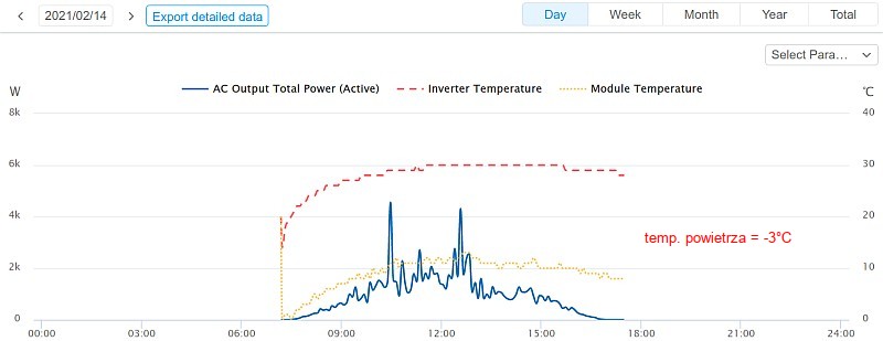

    Below you have a zero production chart from February 9, when the panels were covered with about 12 cm of snow,
    and the outside temperature ranged from -16 to -10.
    If the panels had these +2 degrees, as the "module" temperature graph says, all the snow would flow down to me in an hour.
    And it didn't move at all.
    I also attach today's chart (in English), which shows what is happening with clean panels,
    foggy weather and an air temperature of about -3 degrees at noon
    And how to explain it?
