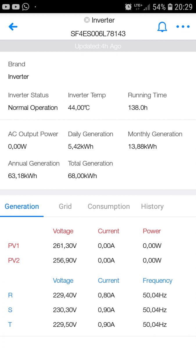

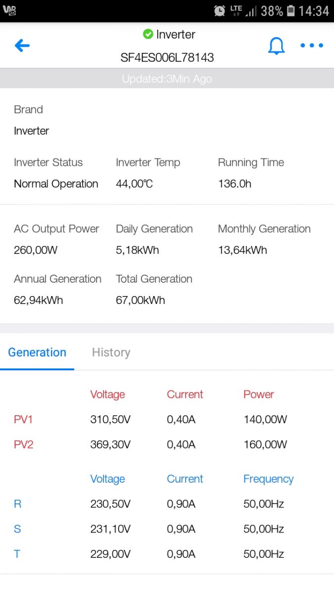

  • Inverter shows idle phase current and reactive power
    #257 19030488
    wilk125
    Posts: 912
    Help: 17
    Rate: 44
    It is the same with me, the sun is like this now.
    Added after 9 [minutes]:
    I have strange current parameters on all 3 phases (6.6 KTL-X inverter), i.e. with virtually zero power (evening, morning-right after start), it shows about 0.8A on each phase (drops from solarman), reading the data via modbus the reactive power shows about 0.6kVar.
    As the power grows, this reactive power drops, at about 2.5kW, the reactive power was 0.3kVar.
    In addition, I measured the current on each phase, at rest (as there is no PV power supply), on each phase it is about 0.2A, active power 0W (from the sub-meter), immediately after starting this current slightly increases because it gives active power, but the solarman and the data after modbus show about 0.9A on each phase, is this an error in measuring this current by the inverter? How does it look like with you? Earlier, there were probably no such indications of currents, or I did not pay attention.

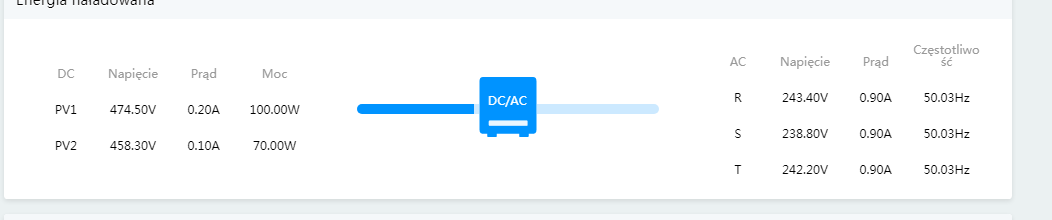

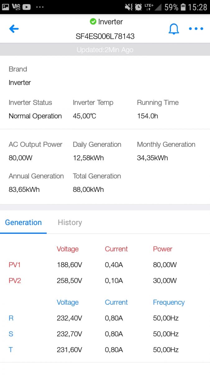

    wilk125 wrote:
    I have strange current parameters on all 3 phases (6.6 KTL-X inverter), namely with virtually zero power (evening, morning - right after start) it shows about 0.8A
    For example, now I have 100W production and I have 0.9A at each phase.

  • Low-power current readings may be inaccurate; asks firmware version and update s
    #261 19032369
    wilk125
    Posts: 912
    Help: 17
    Rate: 44
    Grucha383 wrote:
    So, like with me, probably they do not have the accuracy of the measurement at low power. Do you have the latest firmware?

  • #263 19032765
    macgaw
    Posts: 55
    Rate: 13
    I have a Sofara 3.3KTL-X and I can also confirm "strange" 0.9 A current at zero production.
    It looks like "this type has it". Measurements above 1A seem correct.
