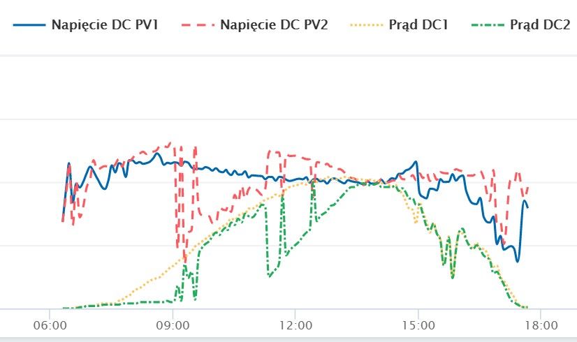

  • #440 19309554
    waldemarstachowski
    Hello, please help me
    Sofar Solar 8.8KTL-X FW v.2.30 does not want to cooperate ;) with Tigo
    Current state:
    Two strings of 10 panels each, elevation and azimuth, all types - LR6-60OPH-345M
    Reference PV1 string unshaded (in the analyzed time interval from start to 2:20 pm)
    String PV2 dormer initially covers 5, 4, 3 panels from 11:15 shaded one panel remains until 13:20 (only this panel connected via Tigo)
    Until 5, 4 or 3 panels are shaded, Tigo works sensational, the problem is when the shadow remains only on the last panel from Tigo.
    Already at 10:45 PV1 = 2400 PV2 = 2000
    Until 11:15 PV1 = 2600W PV2 = 2300W
    After 11:15 PV1 = 2600W power drop PV2 = 890W and so selects the maximum power point, i.e. not optimal and it was supposed to be optimal ;) .
    Before connecting the Tigo
    Until 10:45 the maximum power on the PV2 did not exceed 250W with PV1 = 2300
    only in the range of 10:45 to 11:00 PV1 = 2300W step PV2 = 2000W
    Sofar settings:
    Independent PV inputs
    Scanner on every 5 minutes
    Information gained:
    The Sofar Solar headquarters in Poland does not know how to bite it
    Tigo distributor mhh impossible
    Experienced installers admit that there are problems in cooperation between Sofar and Tigo opty.
    Thanks in advance for the suggestions to solve the problem, maybe someone has encountered such a problem

  • #441 19309880
    AT PRO
    Level 25  
    Posts: 645
    Help: 63
    Rate: 189
    waldemarstachowski wrote:
    Sofar settings:
    First, disable scanning completely and see what happens.

No. The capacitors charge when DC rises above 180 V, then discharge if current is < 20 mA; this soft-start repeats without affecting lifespan [Elektroda, rydzyk673, post #19035241]
Why does Solarman show 0.9 A per phase even at 0 W?
Firmware ≤ V2.30 reports reactive standby current as active. Real clamp-meter reading is ~0.2 A; ignore the dash-board figure until a patch arrives [Elektroda, wilk125, post #19038447]
Edge case: can the inverter fail after a breaker trip?
Yes—one 8.8KTL-X died after a 16 A AC breaker opened; display stayed dark despite correct DC voltage, requiring warranty swap [Elektroda, gotycki1, post #18771167]
How to auto-run a 1.5 kW boiler only on surplus PV?
Install a PR-energised relay with the inverter’s CT loop; set closure above 4.5 kW export so the heater engages only in excess production [Elektroda, 3301, post #19053070]
